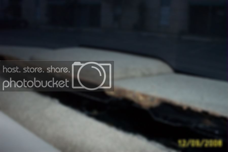

I have an e46 sedan also just knock the metal plate it is only tack welded on in 6 spots and does not serve a purpose so make a ski pass I did it to my car u will need a mini sledge or a mini bfh and a chisel and 5 mns

Just realized amps are mounted behind the ski pass blocking it. I guess I will go with 1000 watt amp what is everyones take on JL 1000/1 vs PG 1200.1 vs Alpine PDX 1000.1? Maybe I will cut out some metal in the deck to port.
I would not cut any metal out since e46's are notorious for having chassis flex and tearing out the rear subframe and the ski pass is precut the plate has 6 tiny spot welds you can tap the plate out with a hammer and a screw driver......
