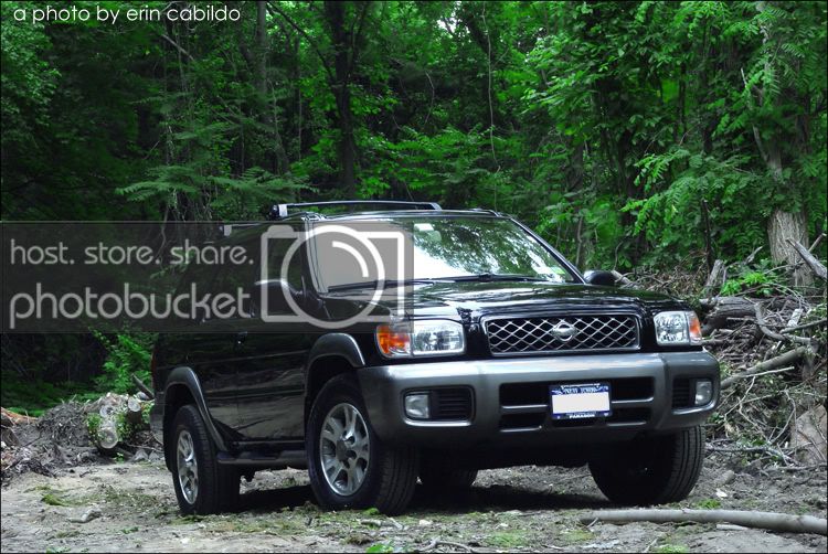

Would it look like this? or similar right
imo that would be better then painting the outside of your lights.
not all teh chrome *sigh*

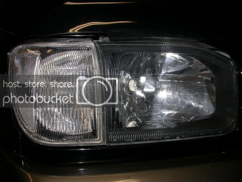

black out the inside looks alot better. i had tint covers on my lights with HIDs and i couldnt see anything. ditched the covers and blacked out the crome in side. easy as pie. pop those lights in the oven at 325 on a cookie pan with a cooling rack on top of it with a layer of tin foil then put the lights on it then leave in for 10 mins. use a flat head screw driver to gently pry the lense off. if it doesnt come off easy press what you took off back on and put in the oven longer.
Before:
After:
my headlights are blacked out like ^^^, but the part that actually reflects the light was left alone
i would take a pic, but it is 10 degrees outside and i am in my scoobydoo boxers
tinting the whole inside of the housing wouldnt be the best idea because it would dim your lights as well
