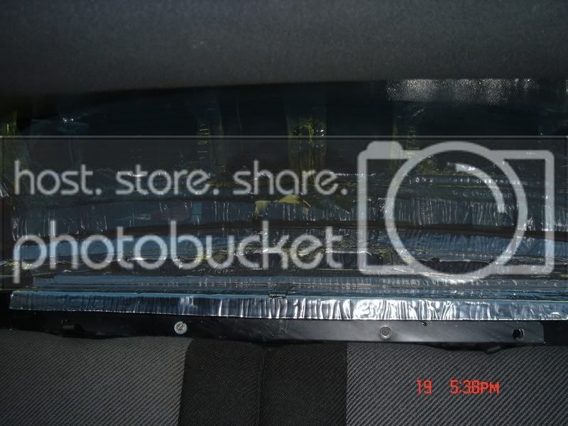

If you take a look in the middle of my rear deck there are two rectangular areas cutout between the speaker holes. And then obviously a carpeted foam overlay sits on top of the deck when put back together. Since so much air is coming through I thought cutting into the overlay would allow more air from the trunk to come through into the cabin. This not only allowing more sound through but possibly reducing rattles from air being trapped in the trunk with nowhere to go.

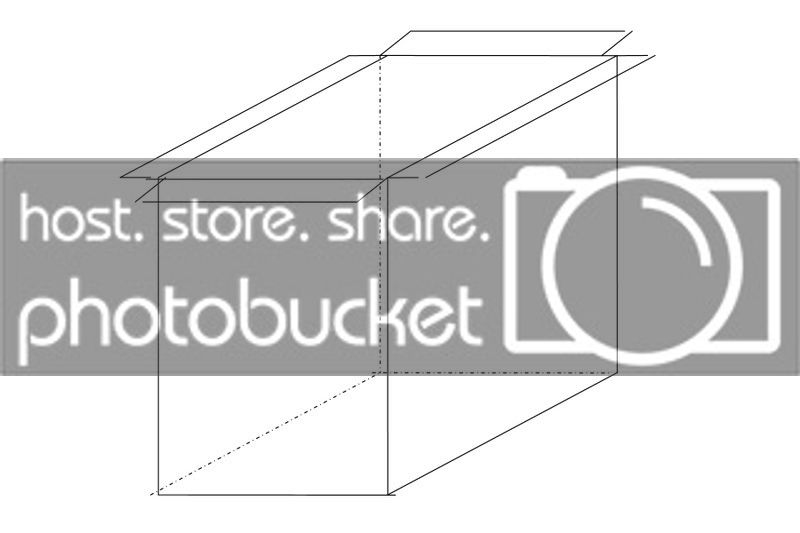

My questions is if I make some sort of port that drops into the overlay and down to the bottom of the metal deck will this affect sound? We talk about port tuning on boxes all the time...but is there trunk tuning //content.invisioncic.com/y282845/emoticons/uhoh.gif.c07307dd22ee7e63e22fc8e9c614d1fd.gif//content.invisioncic.com/y282845/emoticons/laugh.gif.48439b2acf2cfca21620f01e7f77d1e4.gif Or will it just let the air from the box pass through. I don't see it being a problem but I was curious about what some of you guys thought Here's a rough idea of what I plan on dropping through the deck. I figure this would be simple way of doing it.

I've heard of porting thorought the rear deck before. It is my understanding that people build the box so the woofers fire up or back and the ports extend from the top of the box to the holes in the rear deck causing the air to hit the back glass and go forward. Don't know how this would sound and I could be wrong but it would seem that this would almost make your trunk car into a hatchback. By that I mean that the bass is going straight up into the glass and forward rather than to the back of the trunk first.
well one general rule of sub boxes is that the port and sub should be on the same plane. if you were to do anything but put the subs in so they fire through the rear deck, it will probably have some serious cancellation. if you really want to give this a try, you might have good results if you put the subs firing forward with your back seats down and the port through the rear deck

I would be concerned about cancellation--- like when you face your sub forward in a trunk and the "echo" waves cancel the primary freq from the sub.
we need to get some of the pro's in here to know for sure.
