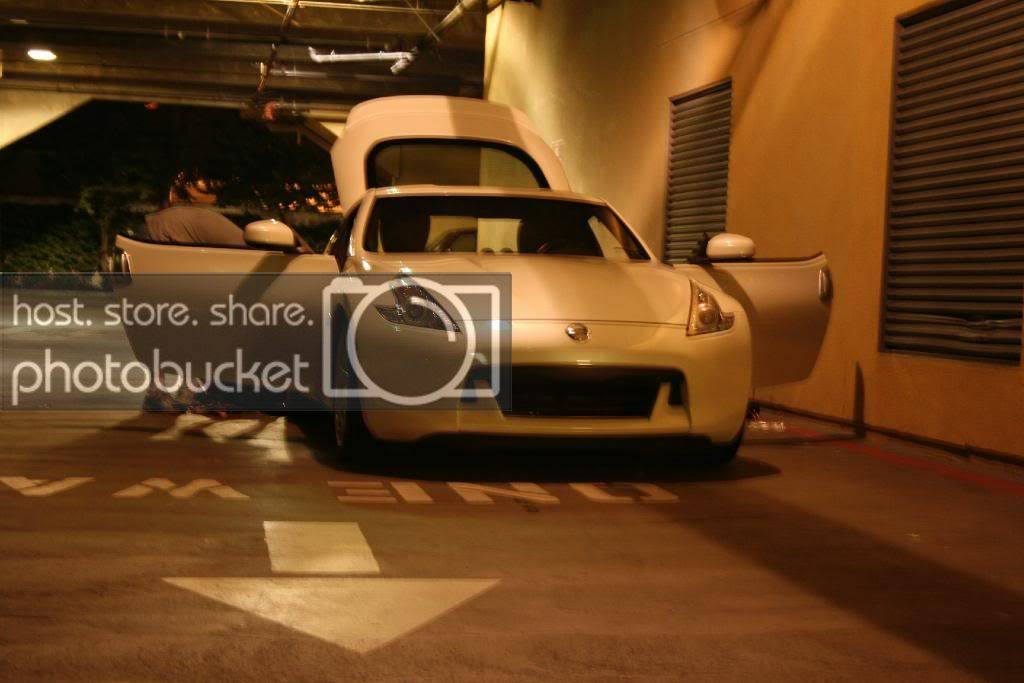

The Ride

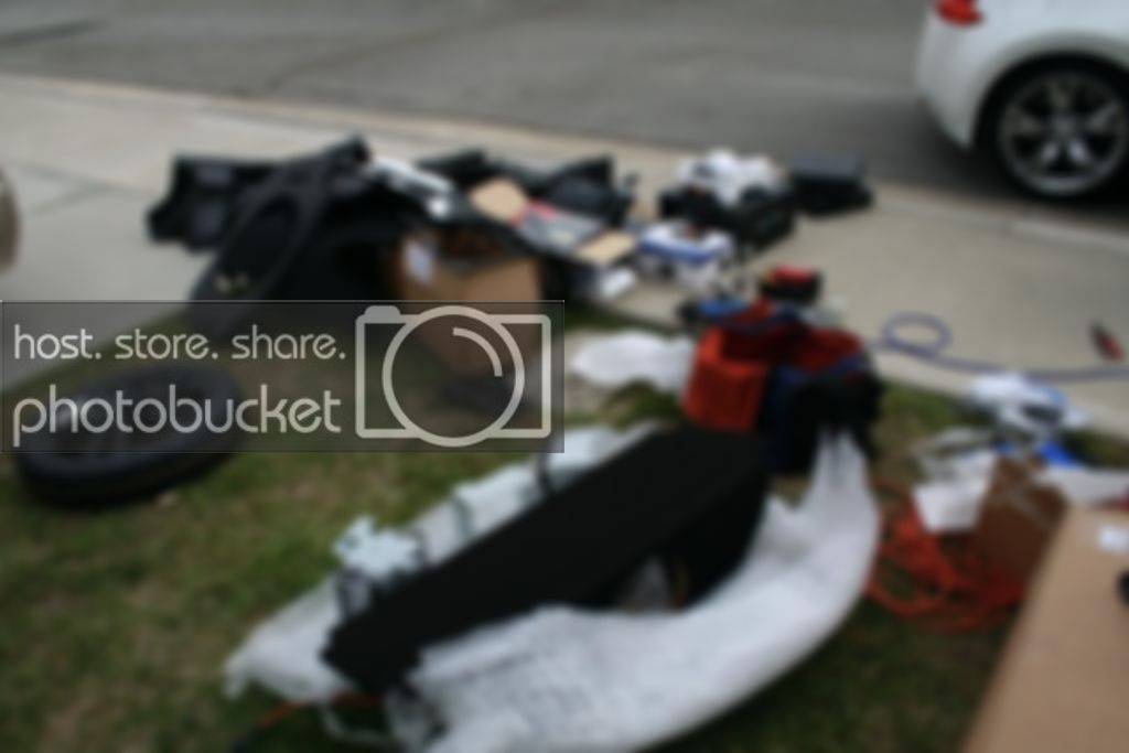

The loot

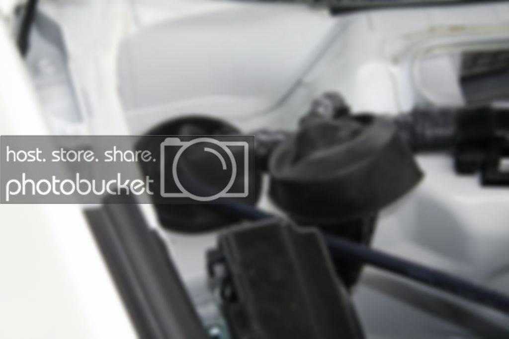

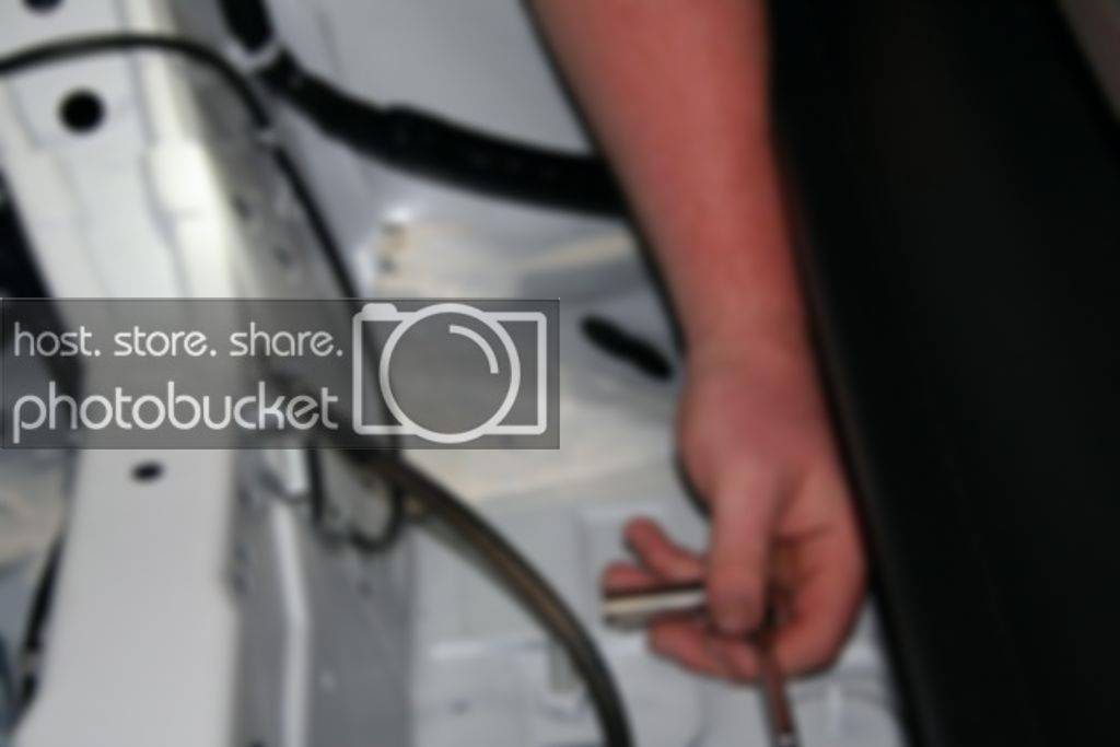

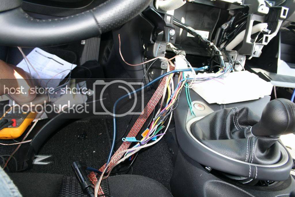

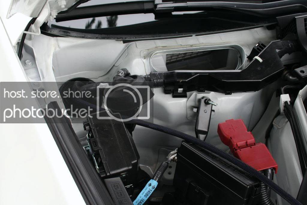

Power wire ran threw stock grommet takes a bit of time but can is the best place for it.

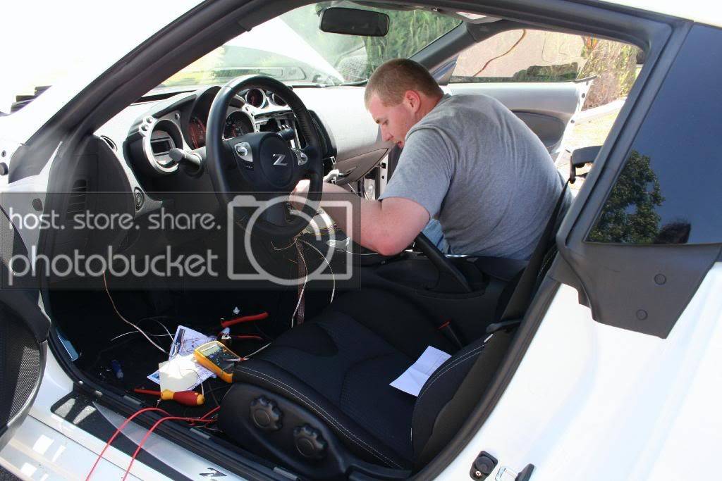

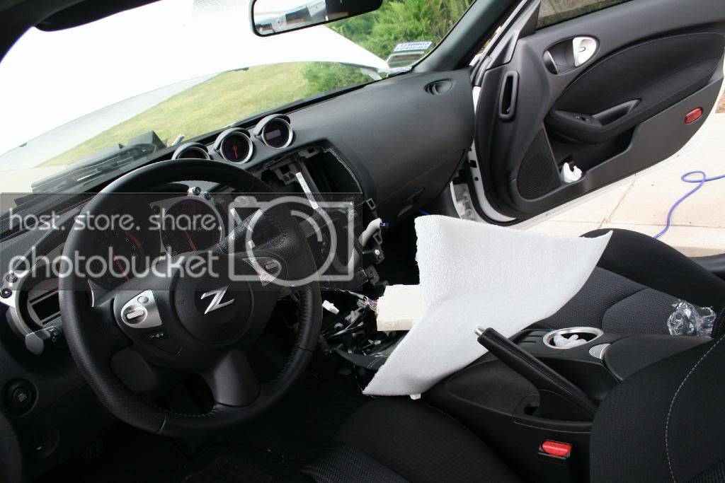

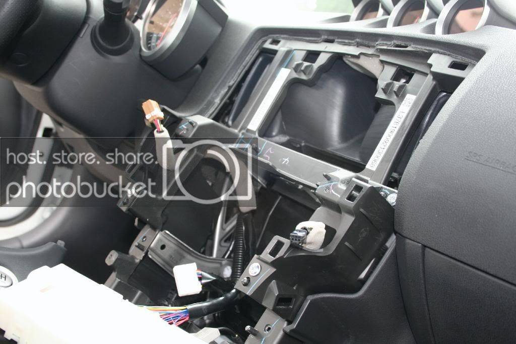

Dash apart and head unit mounted to brackets.

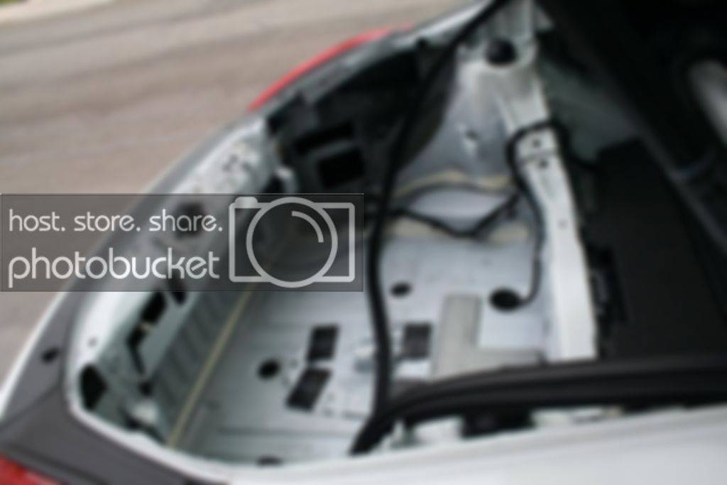

Time to take apart the trunk

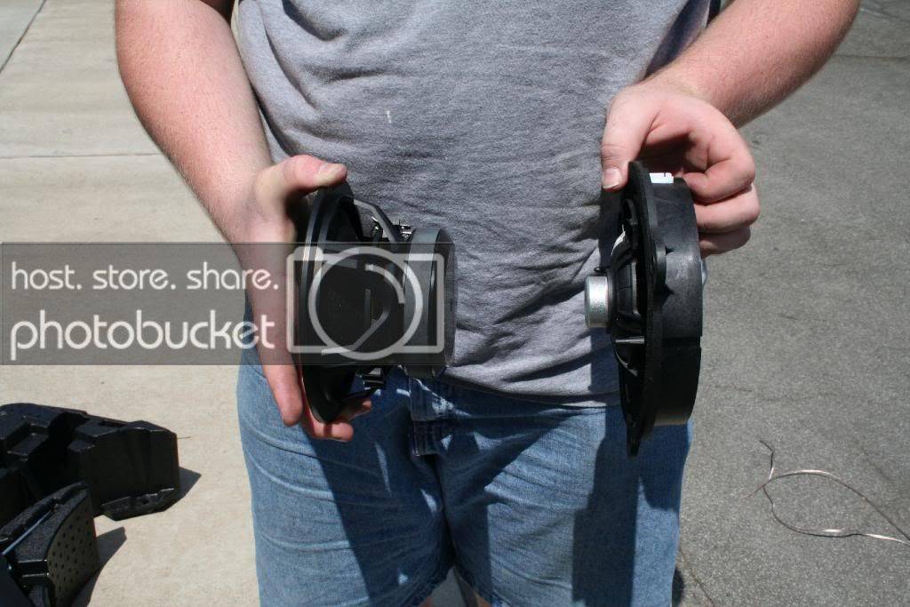

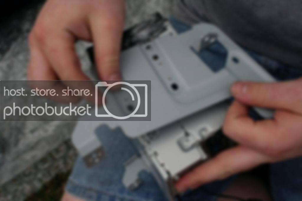

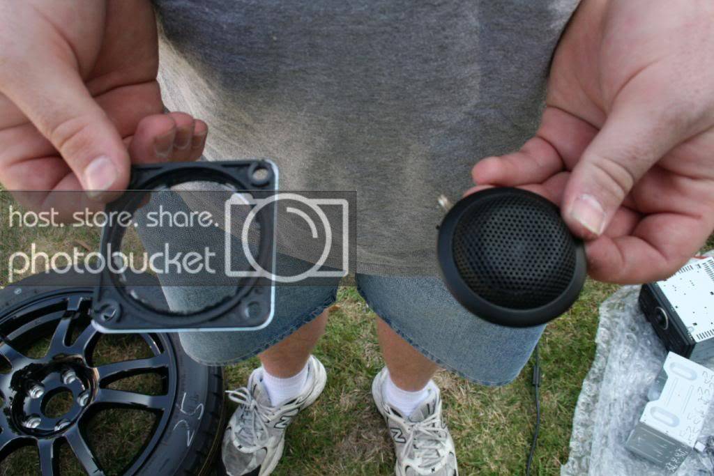

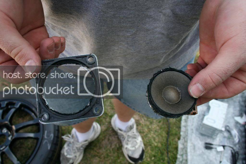

Factory tweeter and modding time. Using a dremel I shaved and trimmed out the factory tweeter.

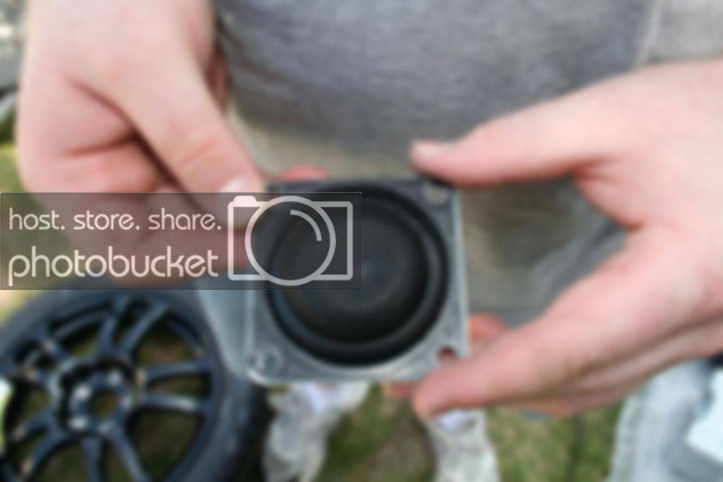

The new ID tweeter

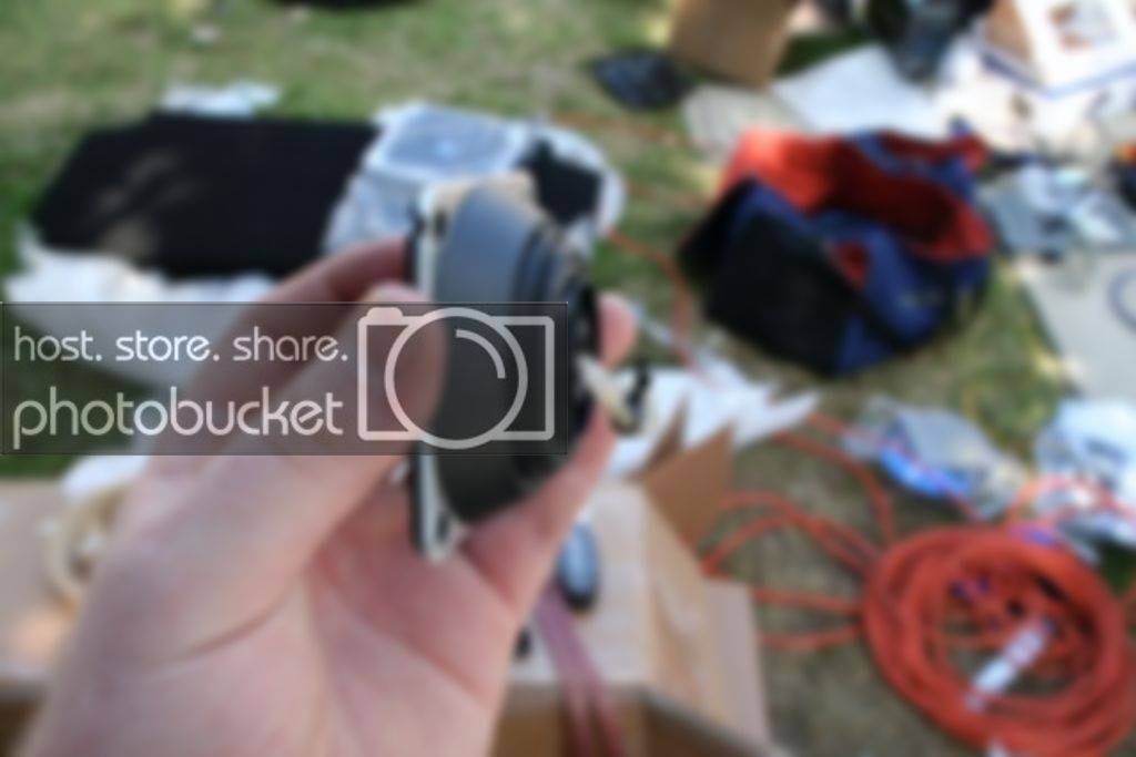

Almost looks like it belongs there hu?
The back end
Hmm almost like some sort of super tweeter

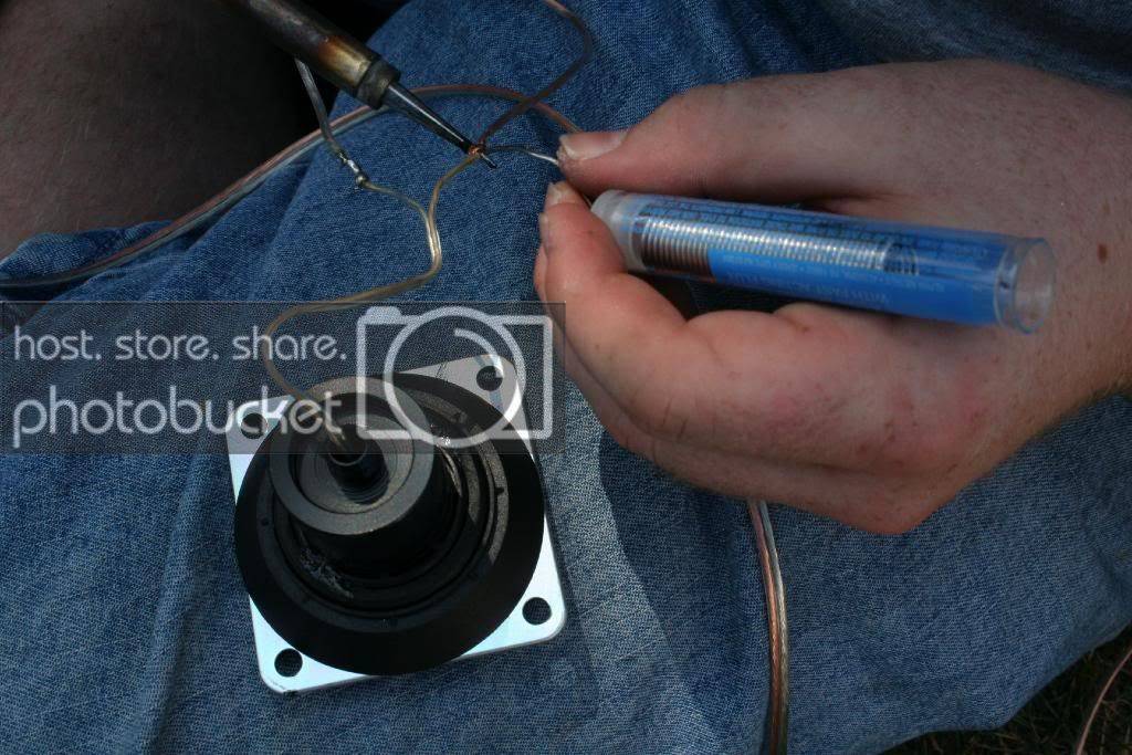

Solder up the wires!

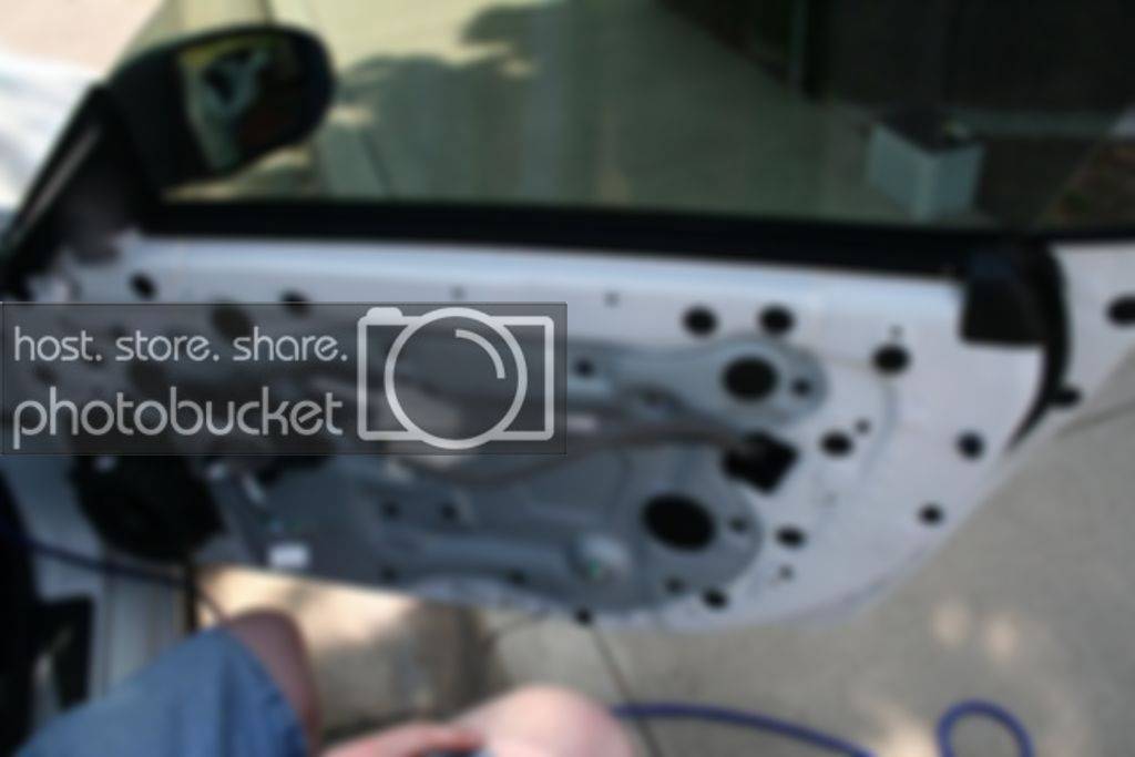

Door panels off
This is why factory is no good LOL

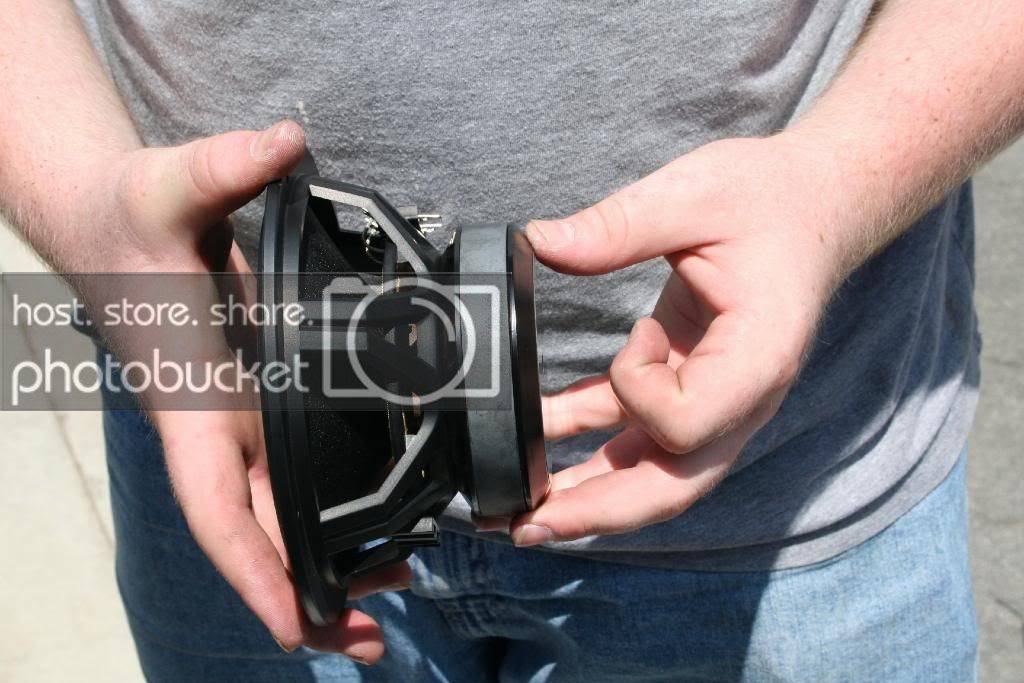

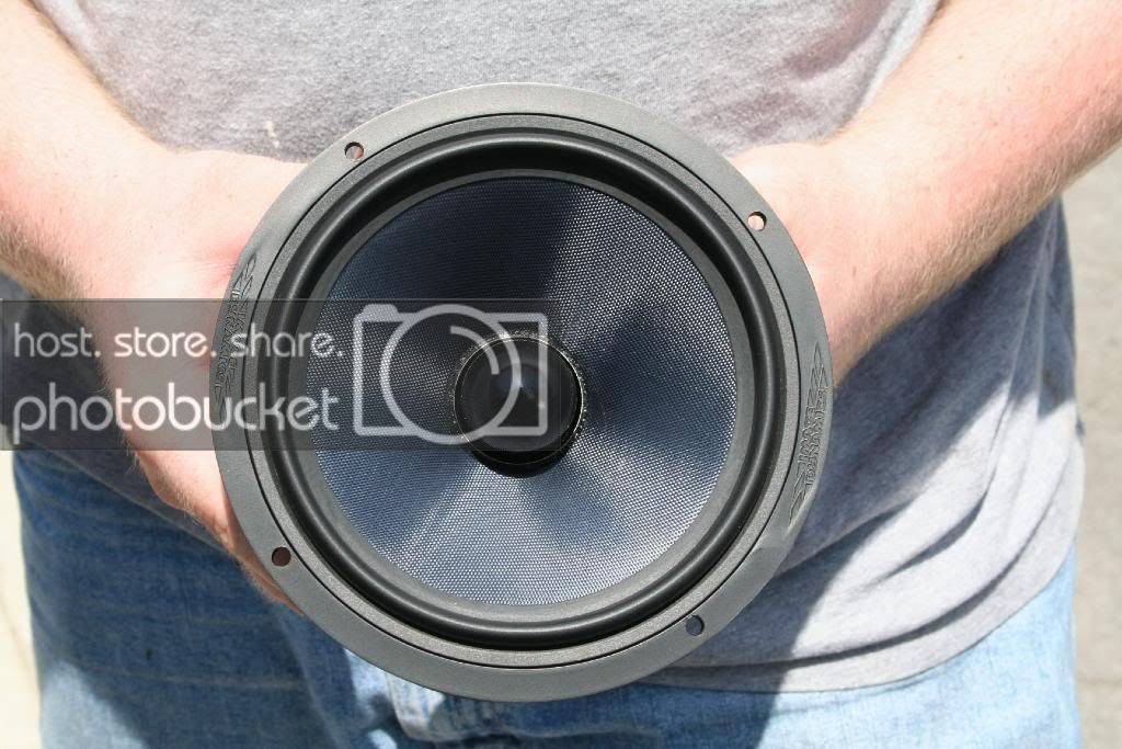

The ID cxs components the woofers need 3 inches of clearance for the magnet.

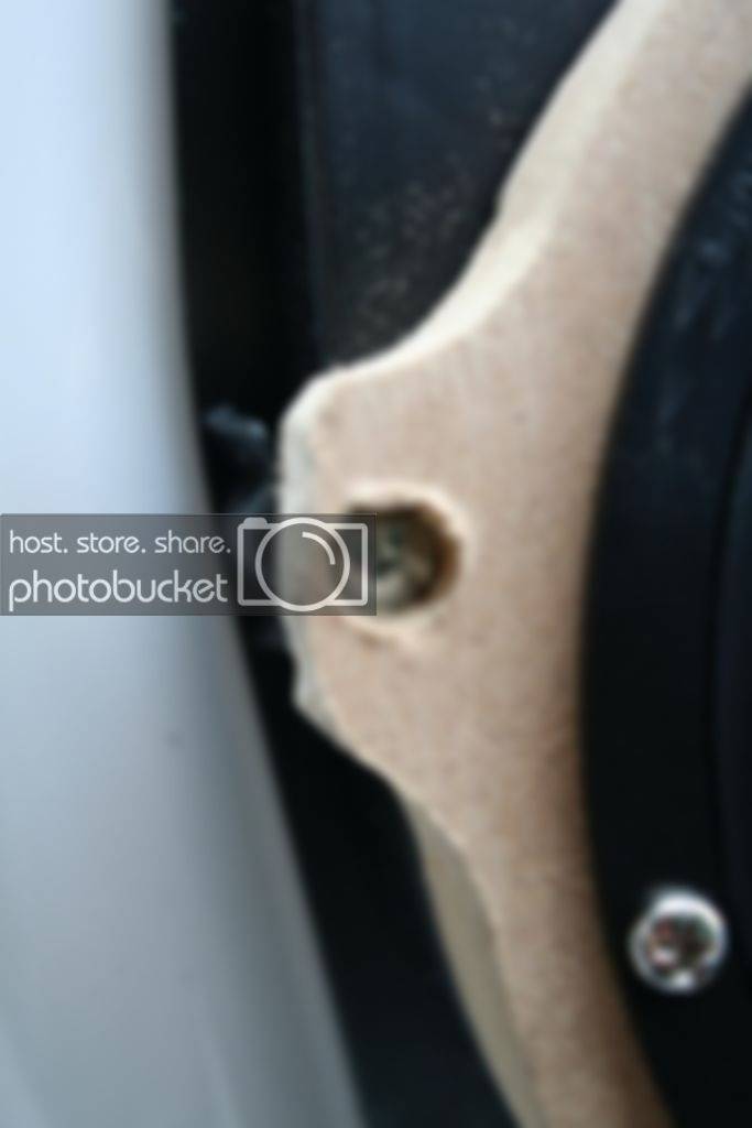

Using the z closure spacers and installing them with some bigger bolts you can fit just about any speaker in your door, just as long as you shave some of the ring off were the bolt goes the door panel fits perfectly with a good amount of clearance.

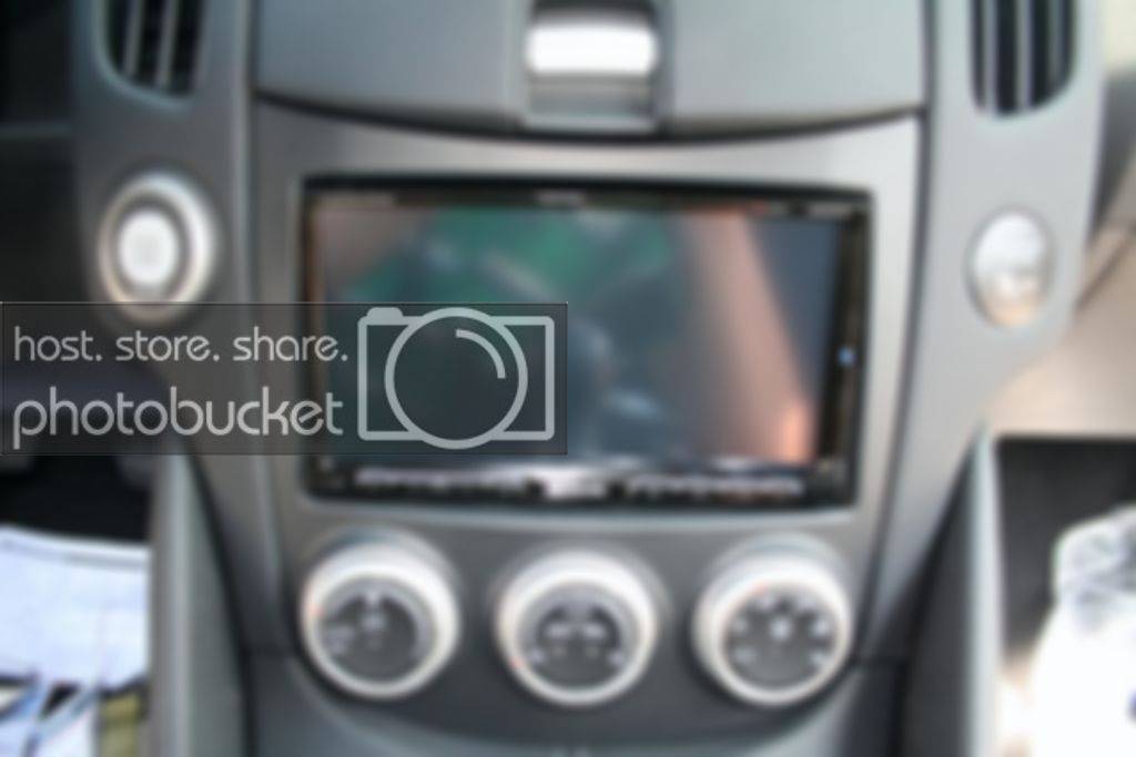

Head unit installed

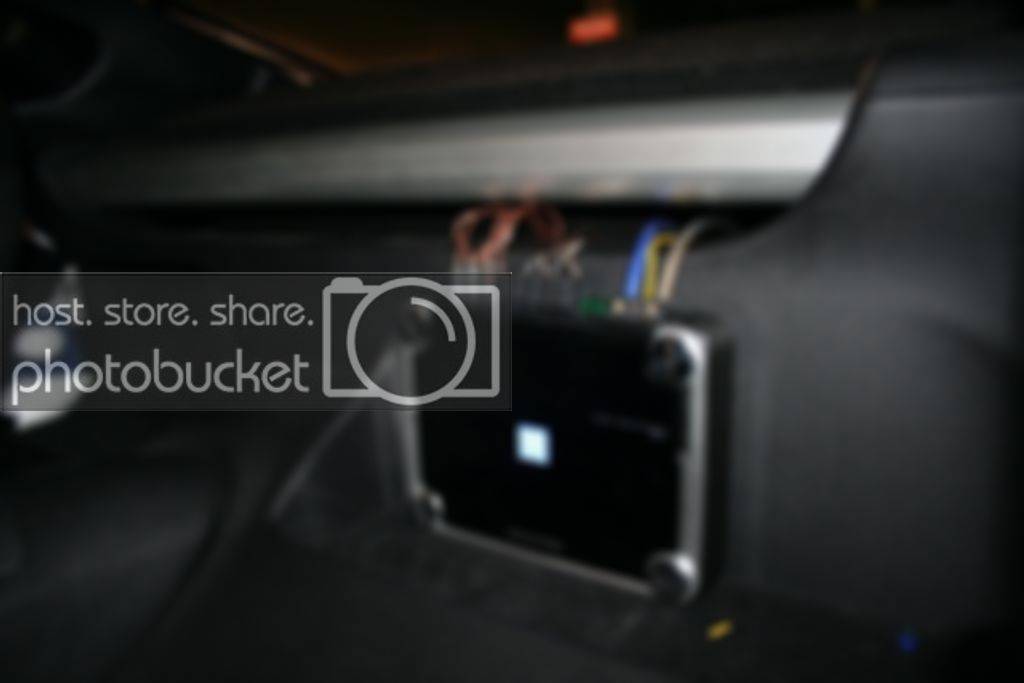

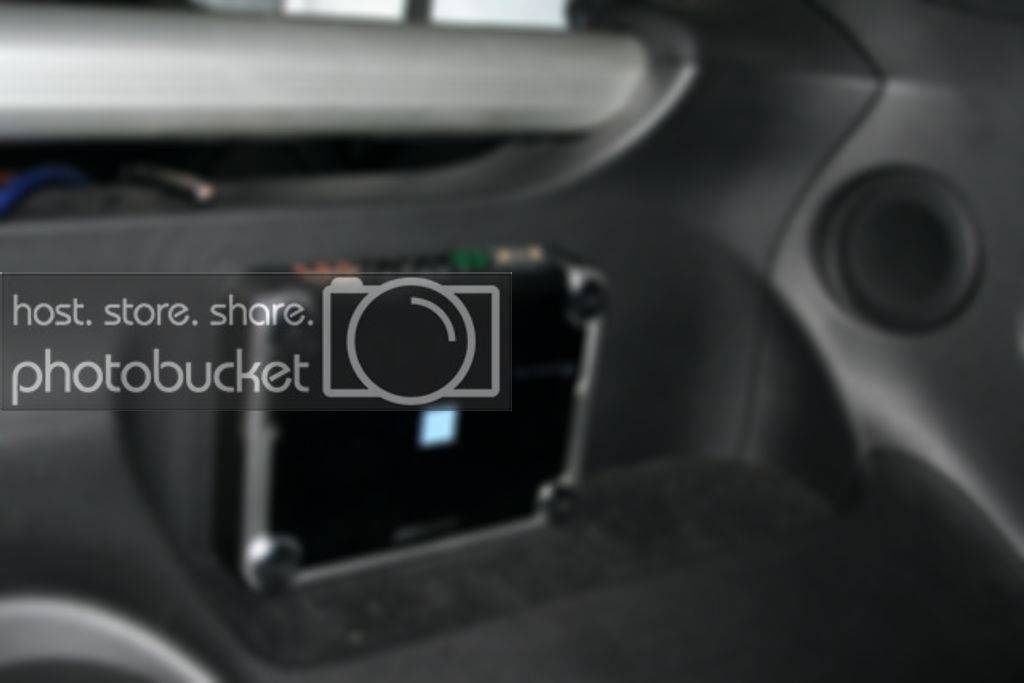

Amp mounted

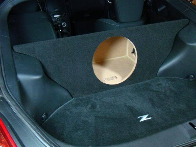

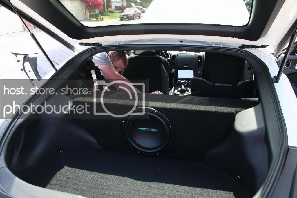

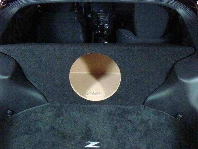

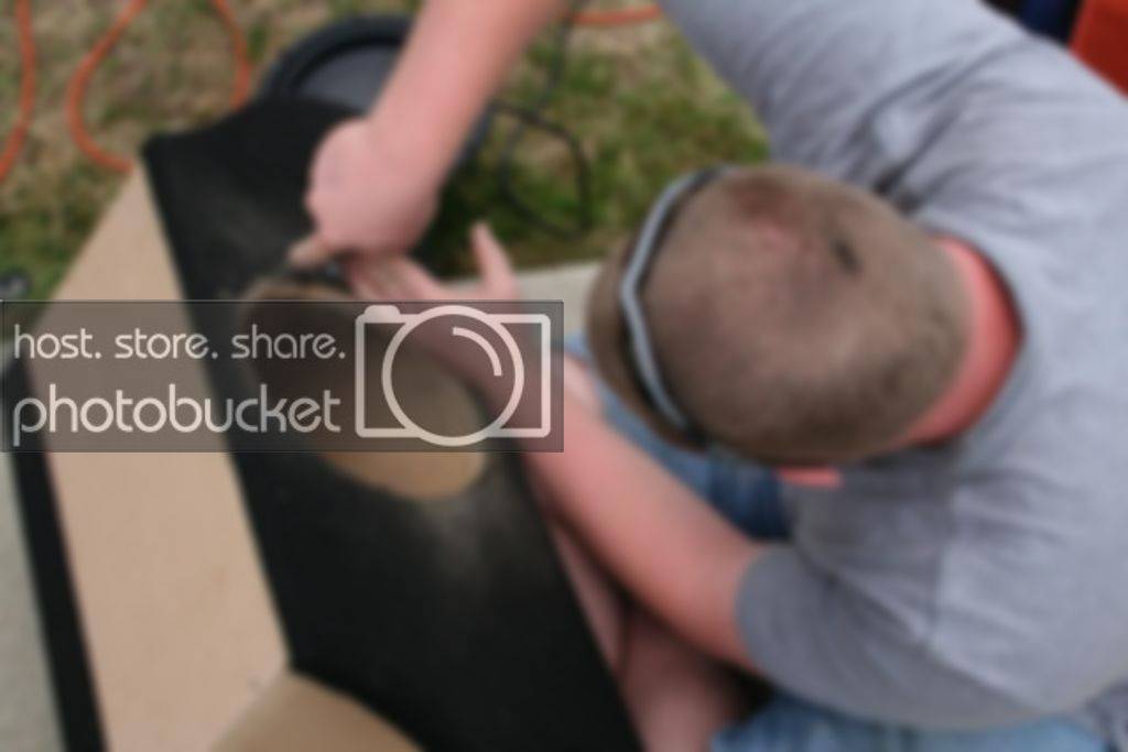

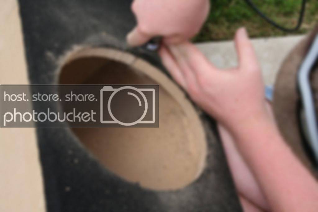

Next morning the sub box had to be trimed for the bigger ID Q sub but it was worth it.
