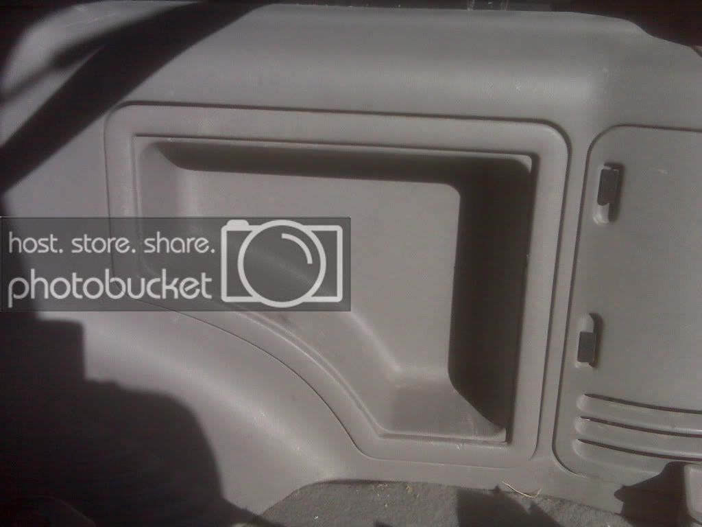

This is the pocket i will be building off of. Its on the passenger side behind the 2nd row seat.

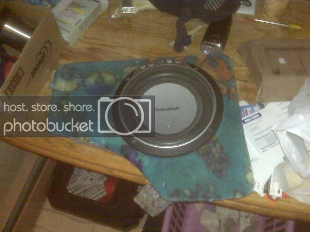

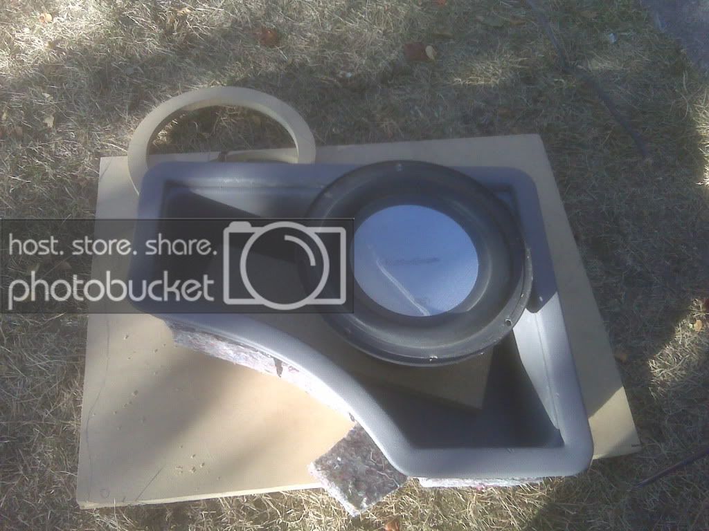

Fitting the sub.

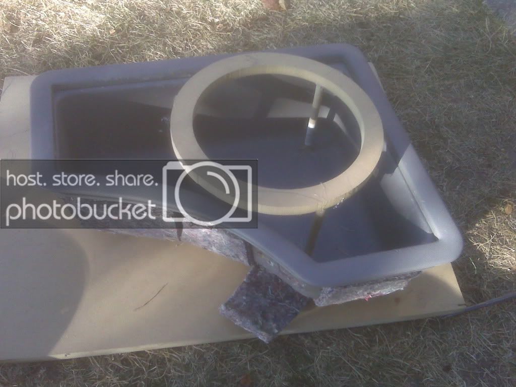

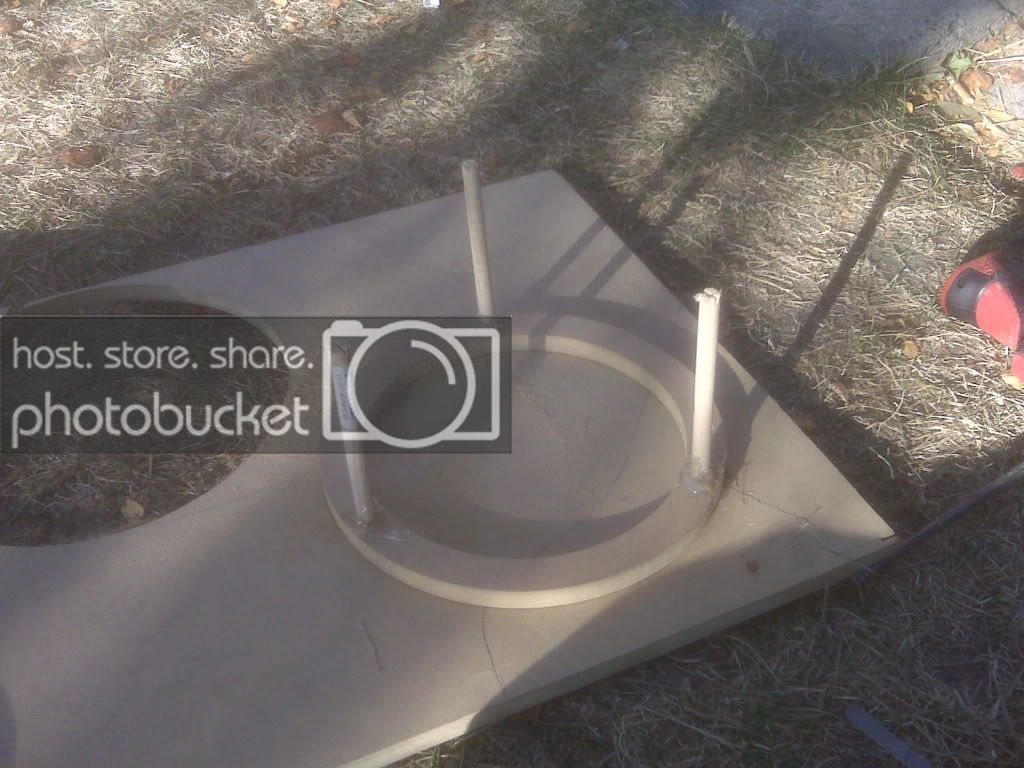

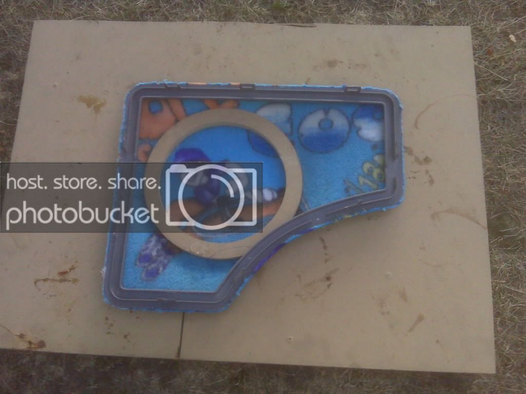

Ring and dowels.
Gluing down the ring.

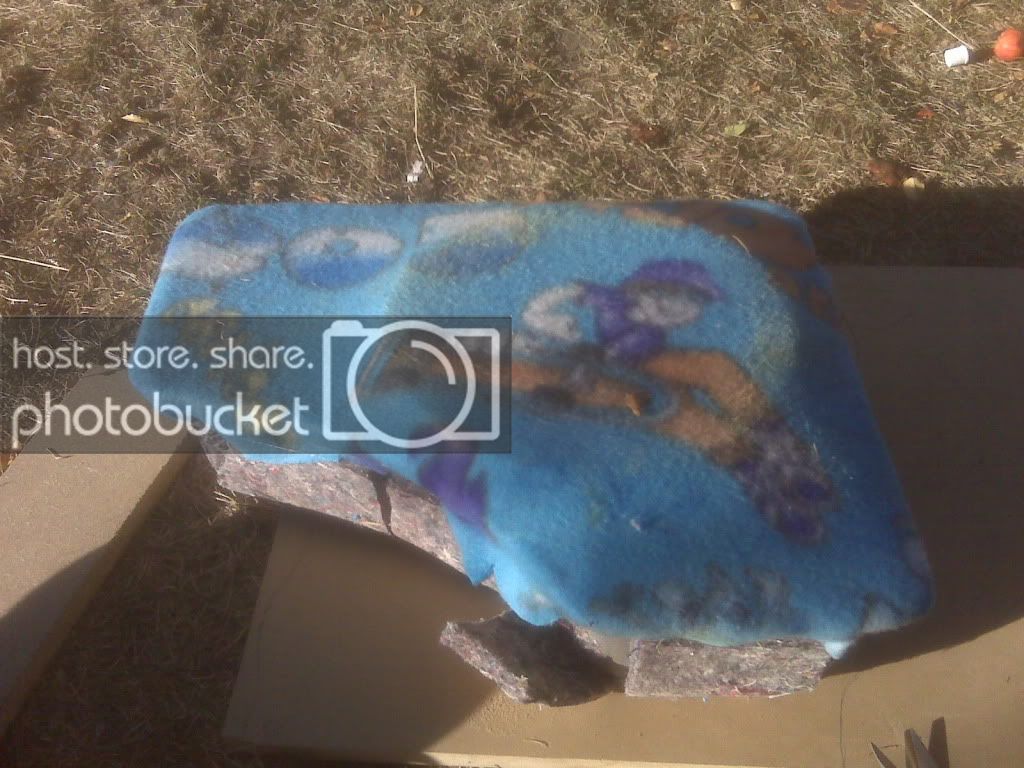

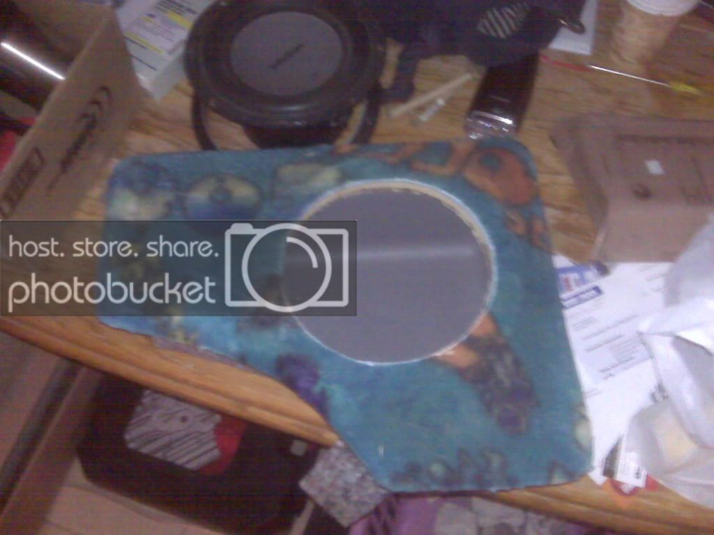

Stretched the fleece.

Are you planning on mixing the resin on the colder side so you don't melt/warp the factory plastic? The downside to doing so is that the resin takes a lot longer to cure.
What did you use to attach the fleece? Staples? Hot glue?
Hot glue
Yes sir. Its going to take forever to cure, its been cold today

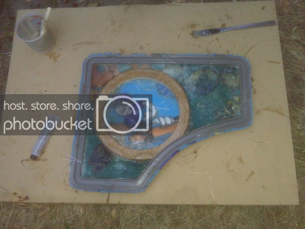

Backside of the face
Couple layers of glass

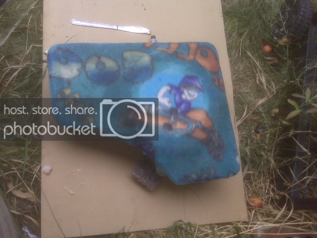

Cut out the face
Test fitting

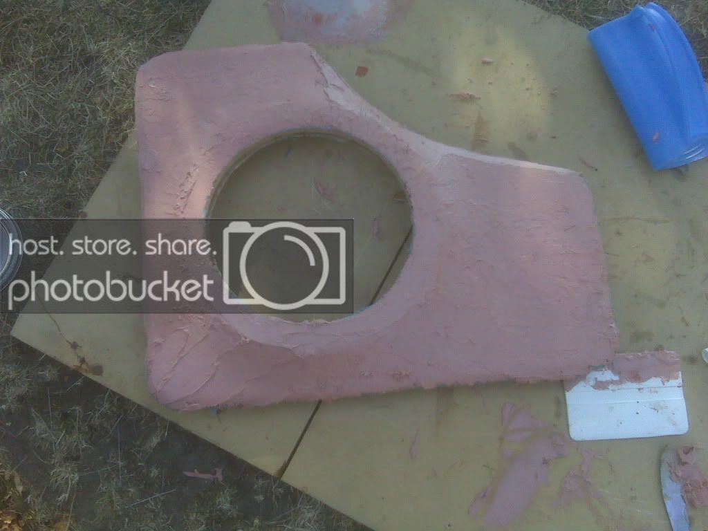

Filler, now time to sand.....
