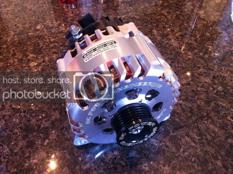

Received word today that my DC Power alternator will be shipping out on Thursday (Feb 12, 2013) and should be in my hands by the following Friday.
I guess I know what I'll be doing next weekend (for that 20 min anyway), there will no longer be excuses not to finish panels and the sub box with the power now there!
For a quick look at the product ordered and referenced previous (DC Power - 300SPX)
With this alternator, the dual battery set up, and a 100% zero gauge main power and ground - I should have enough power

It finally arrived a week and a half ago, I just havent had time to install it yet.
Really is a great looking piece, it's too bad it's going to be under a closed hood.
I will get to installing this within the next month, if I ever get to the amps and speakers..............
