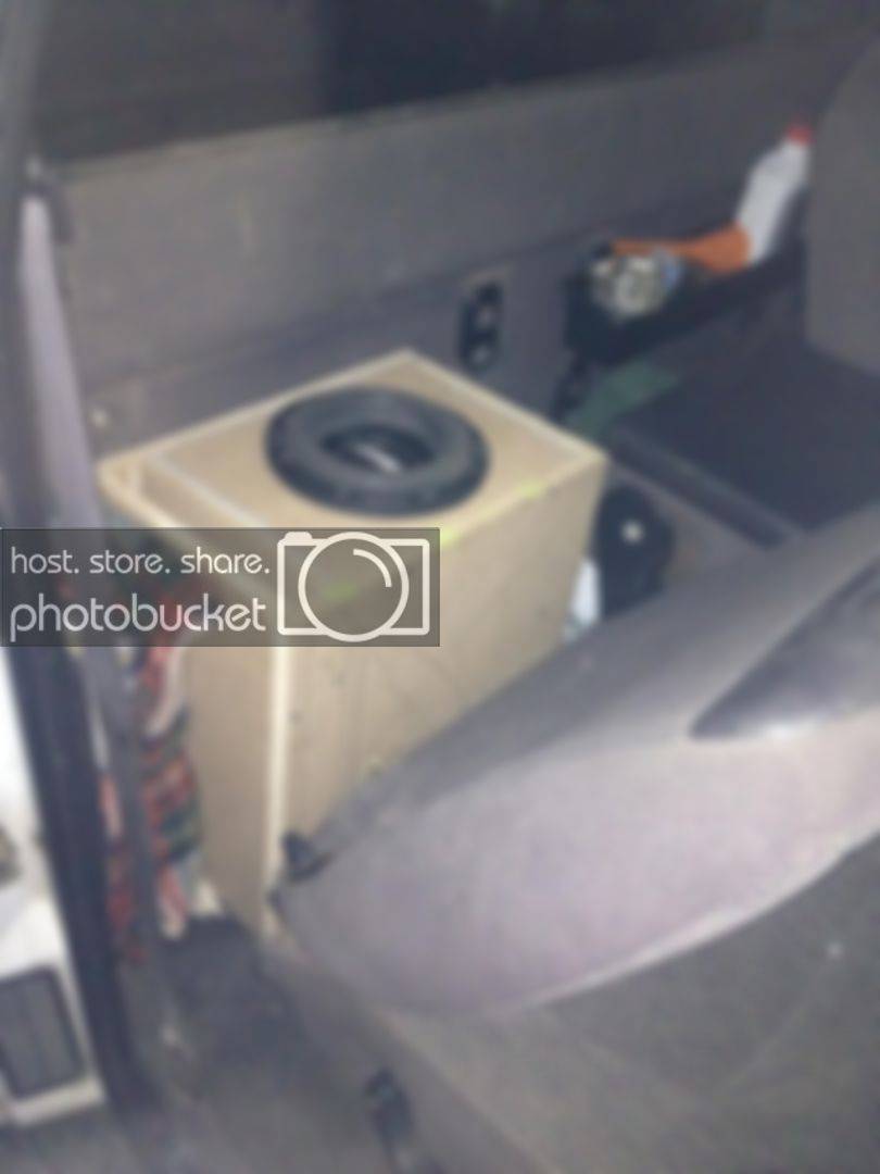

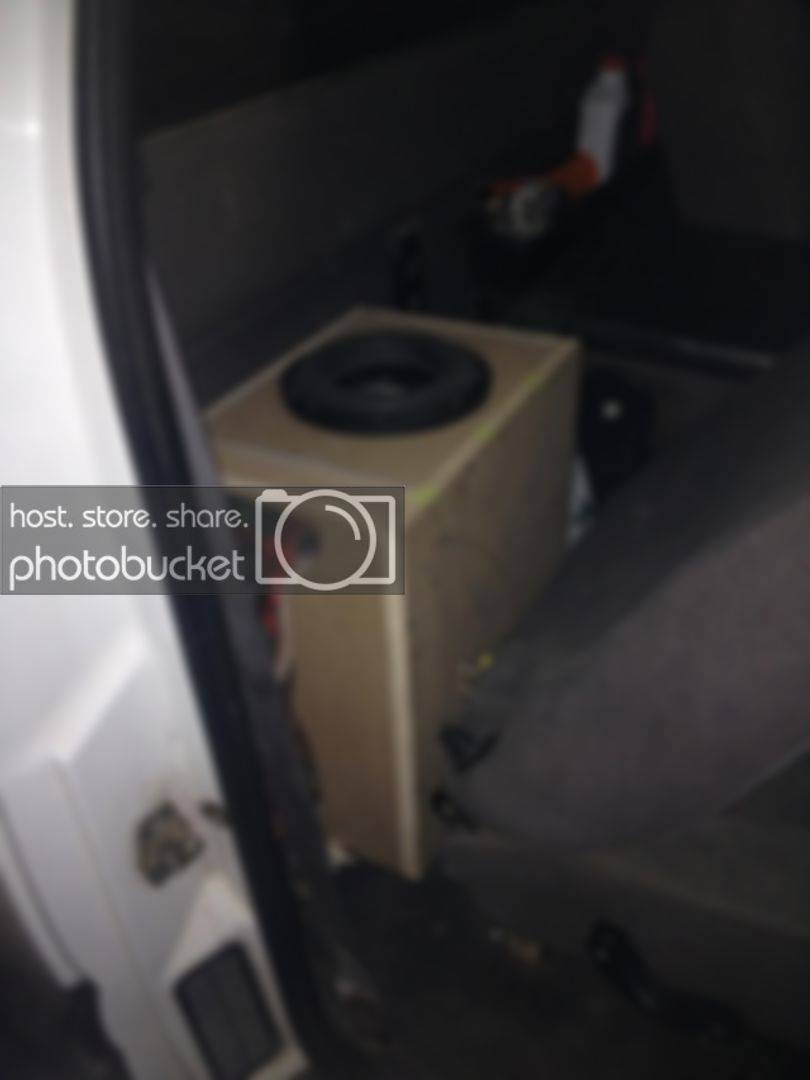

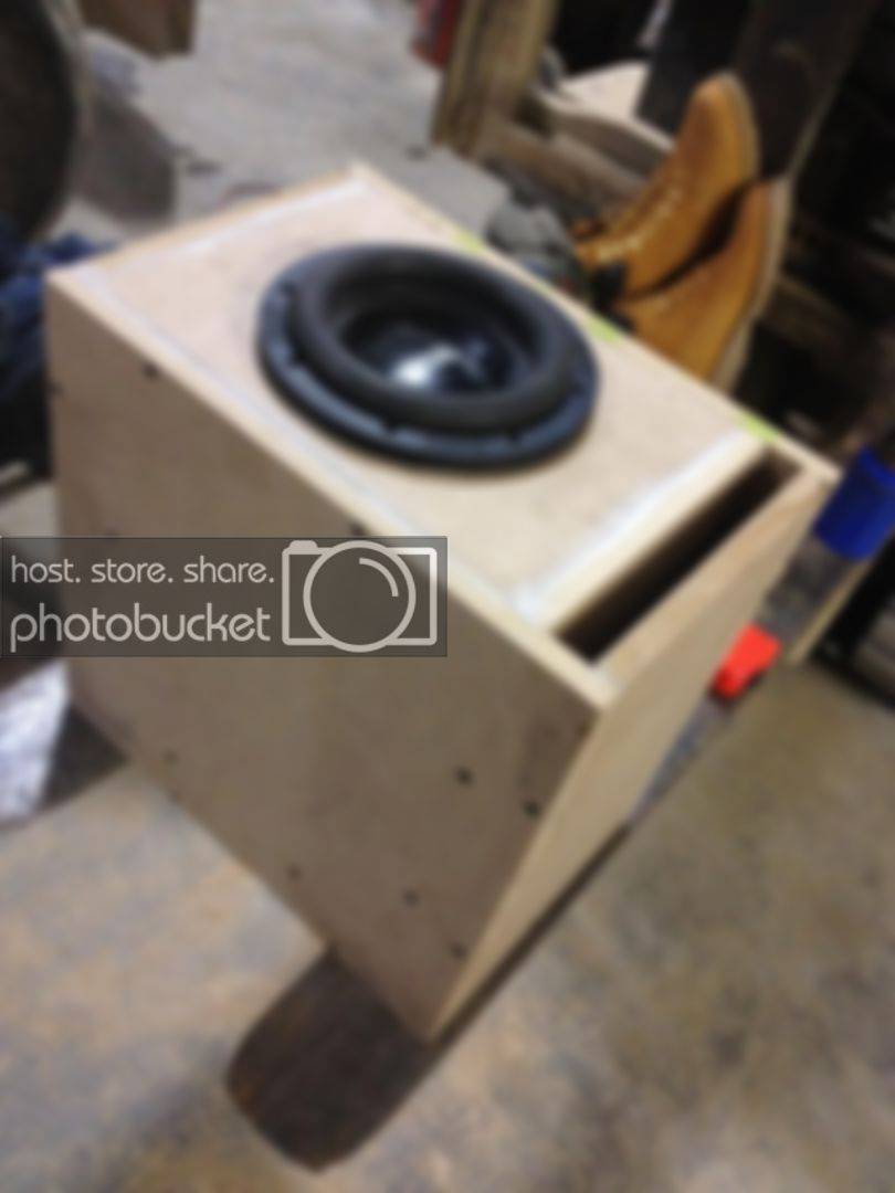

I built the box on the sundown website and had both the sub and port facing the drivers side, it sounded good in the drivers seat but awful on the passenger side. I pointed the sub and port upwards next and it sounds awesome in both seats. I cant believe the noise that this little 8 makes. I would highly reccommend this sub to anyone considering it, the box makes all the difference.

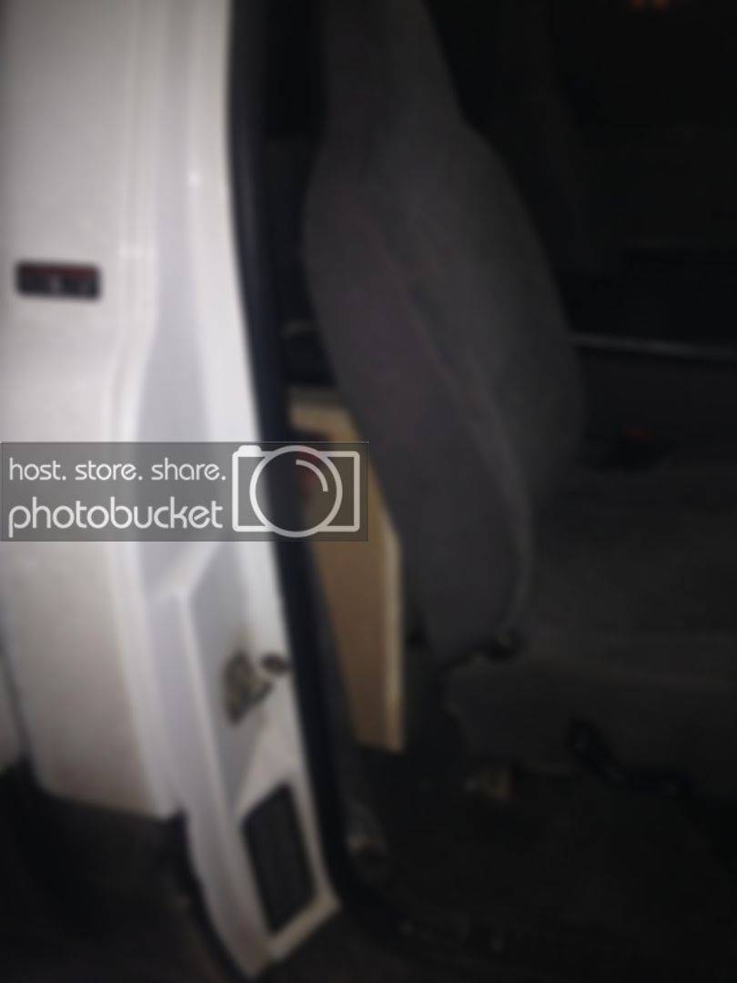

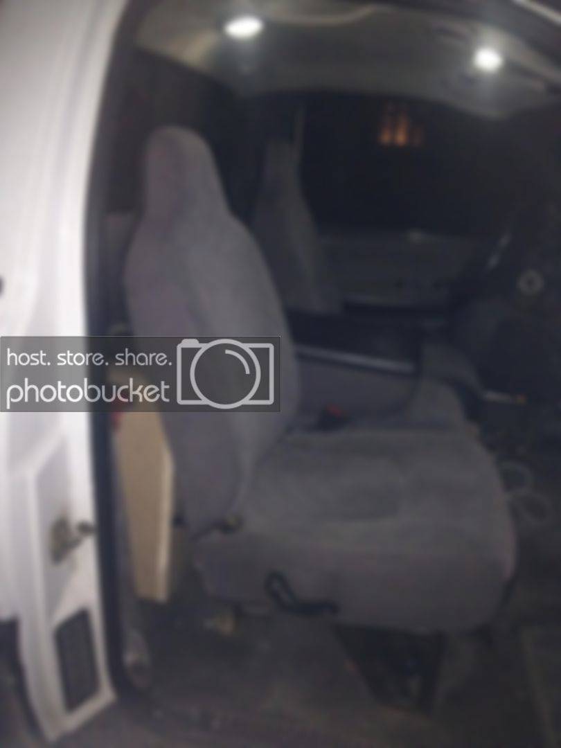

It was a tight fit but I think it'll do for now. The passenger seat sits back just as far as my seat normally does so I think its alright.
