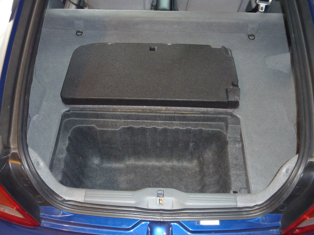

Picture of rear cubby

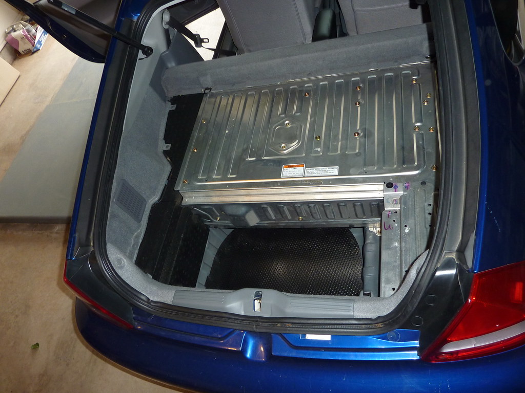

Liner Removed
This is where my sub/subs will go.
oh man, thats a prime sub location haha yeah 2 10s sealed should give you some nice output. If you want something crazy, you can do a single beefy 10 ported. Either way, its gonna load off the rear hatch and have a nice horn effect going on for some free dbs.
