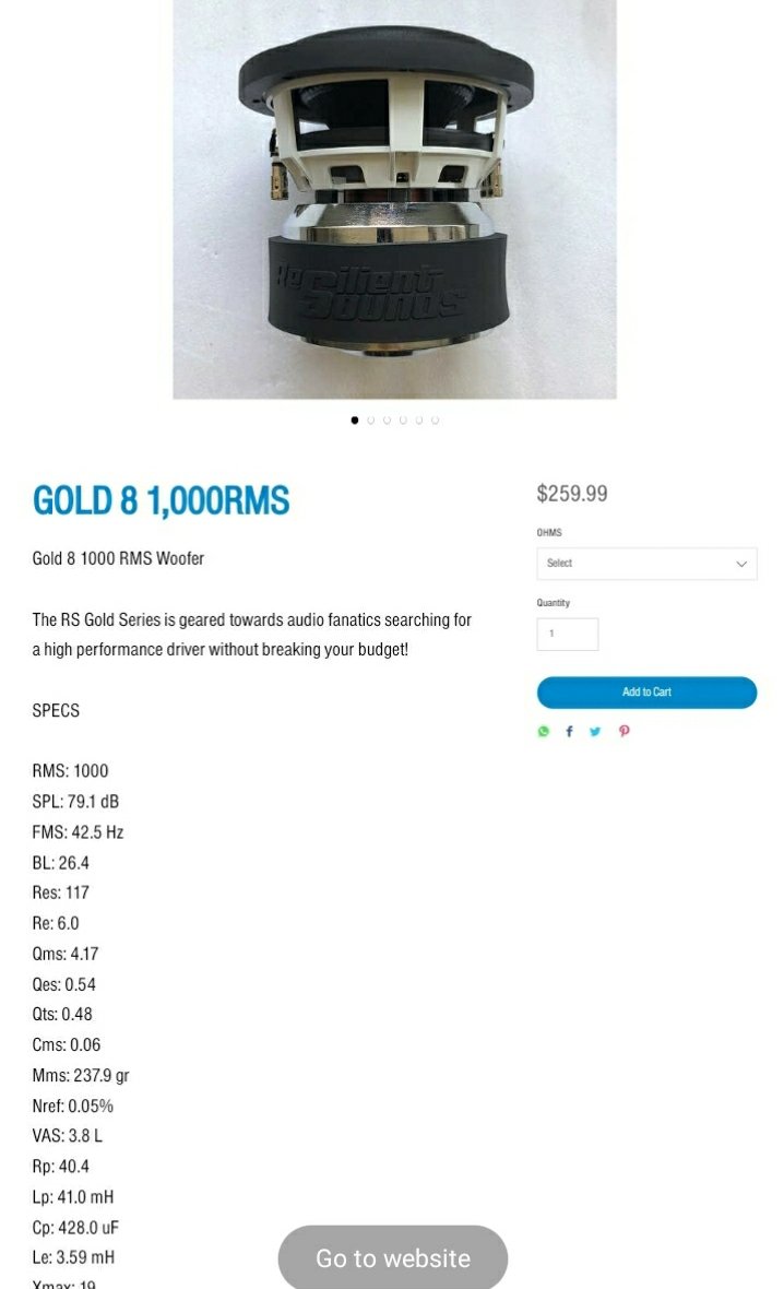

The F8L’s look very beefy.
You should see the Resilient Sounds Gold 8. 300 ounce magnet. Beast mode.

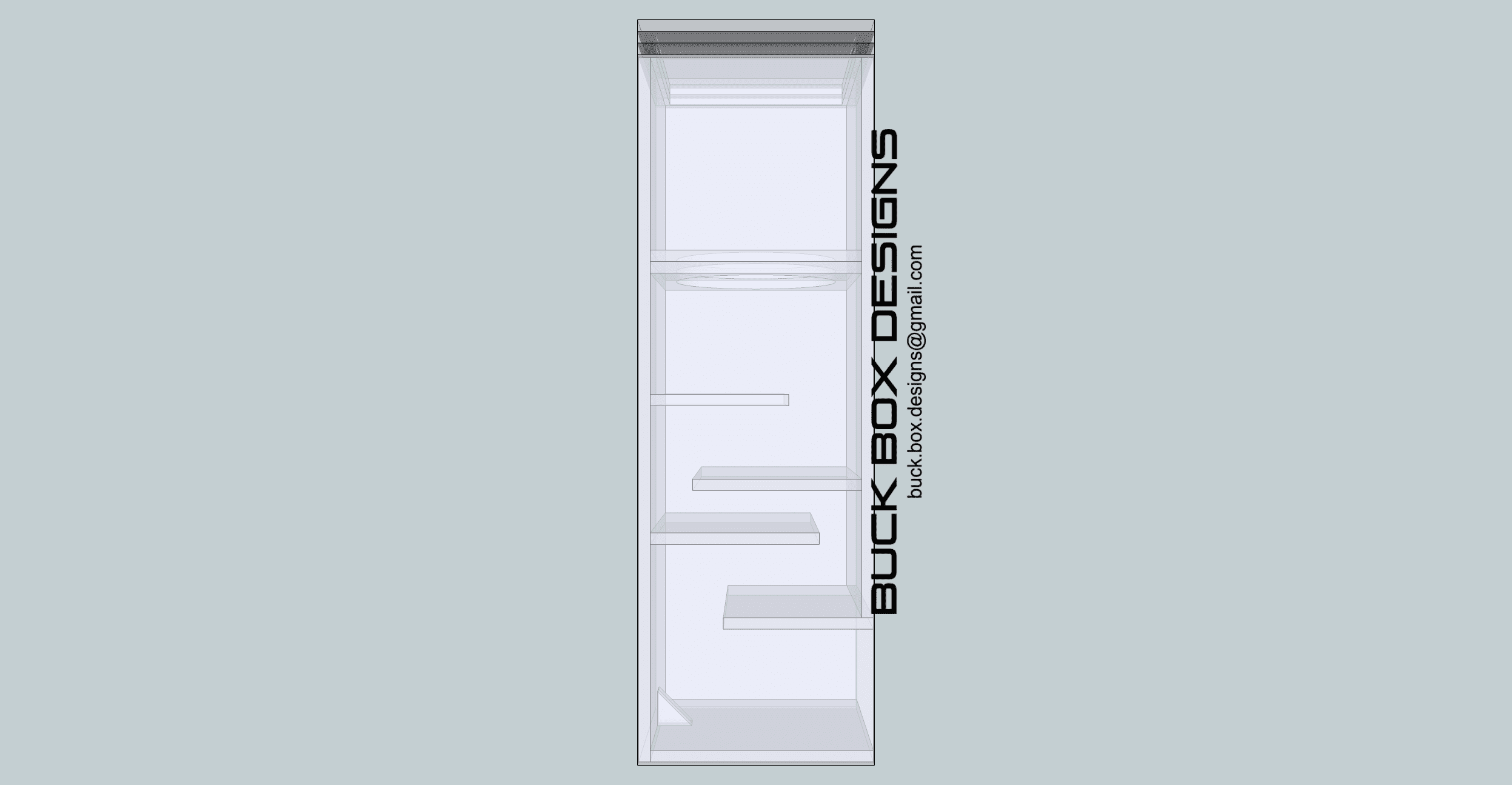

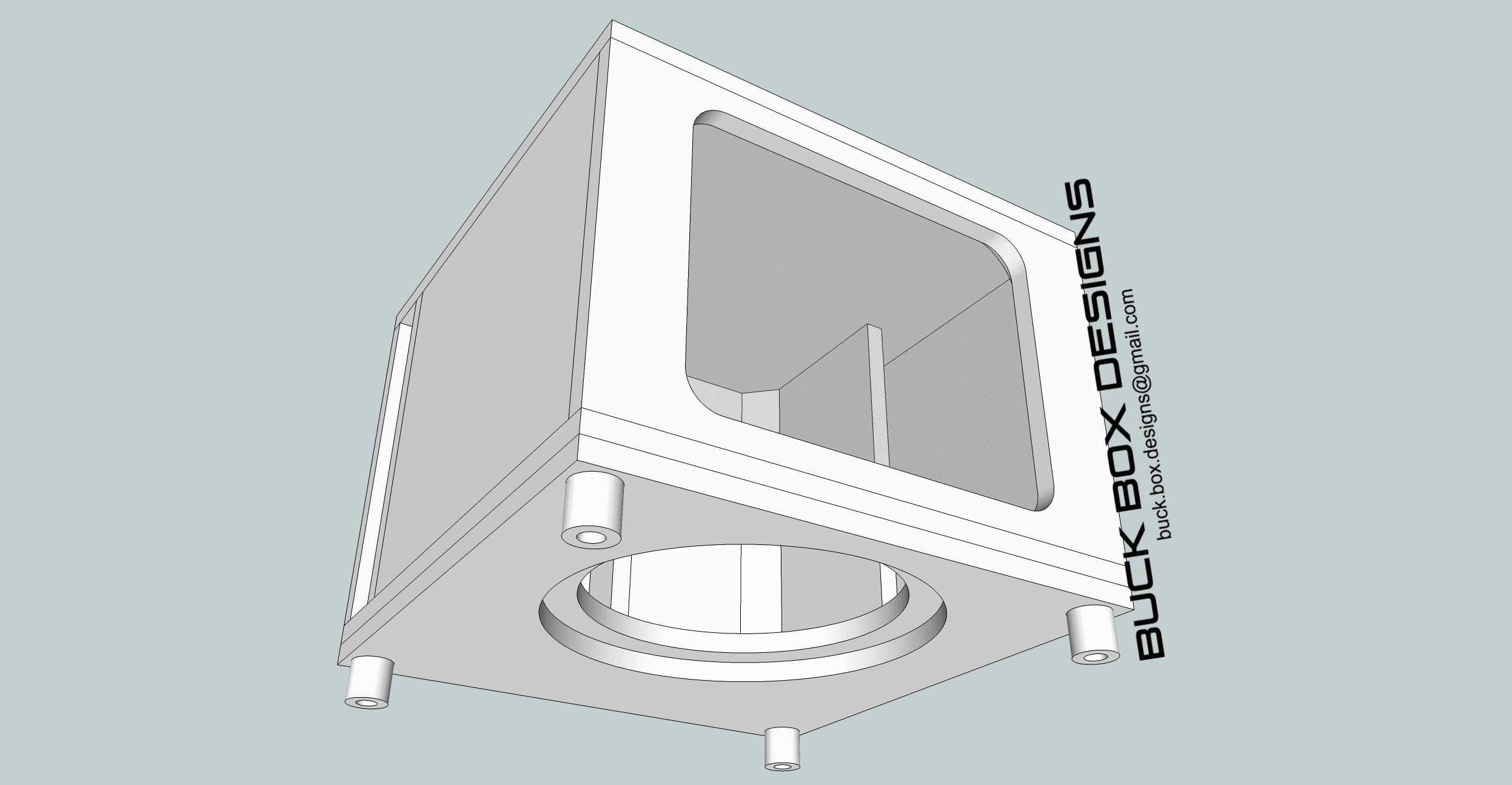

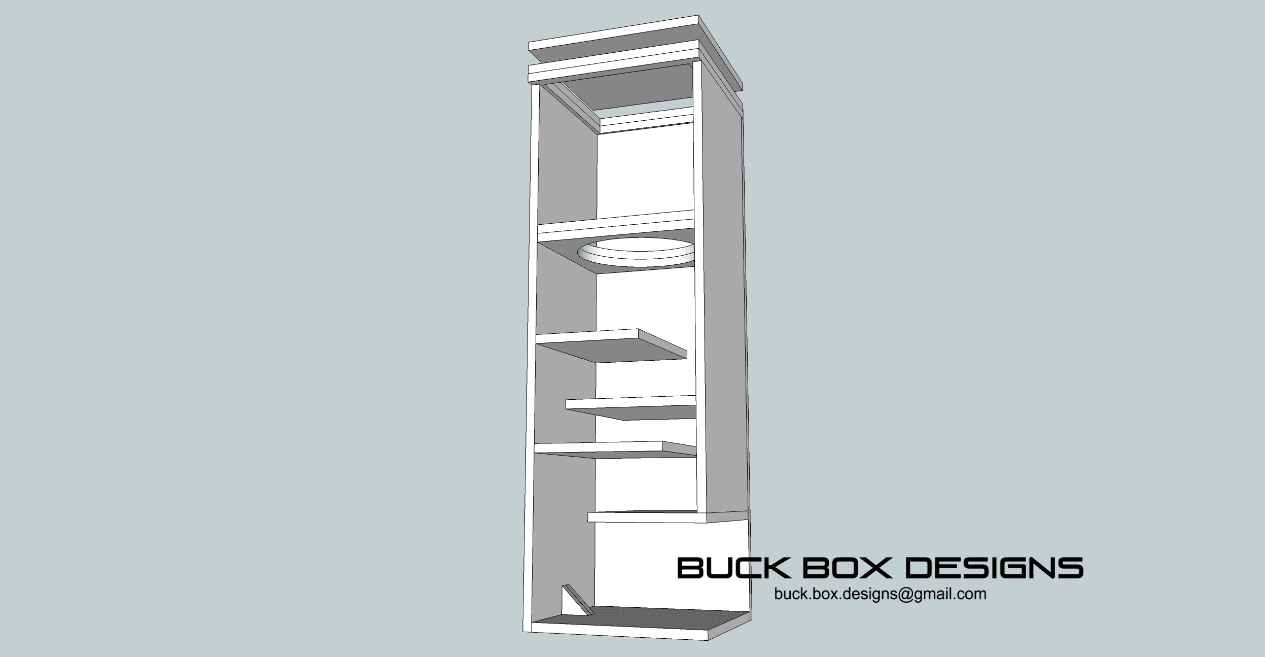

Skar VXF 12 sealed-horn-like hybrid going in a large semi truck sleeper cabin.
This is tuned and shape for music. It's difficult to get good pressure and smooth sound out of a sub box in a cabin this large. So, this style box is my attempt to create a somewhat decent bandwidth musical enclosure that will somewhat smoothly pressurize the cabin and keep the subwoofer cone under control.

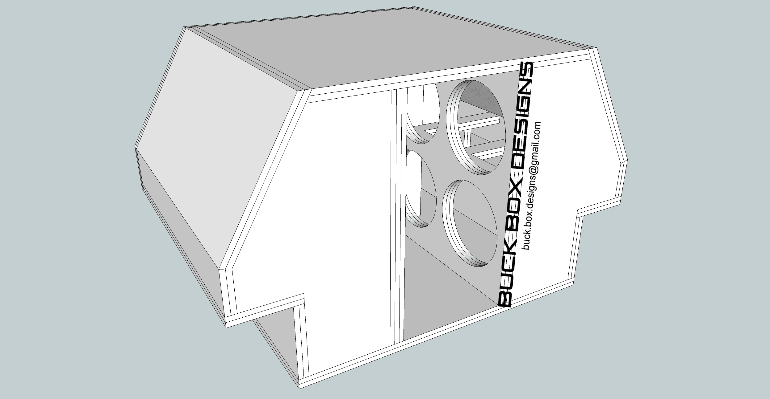

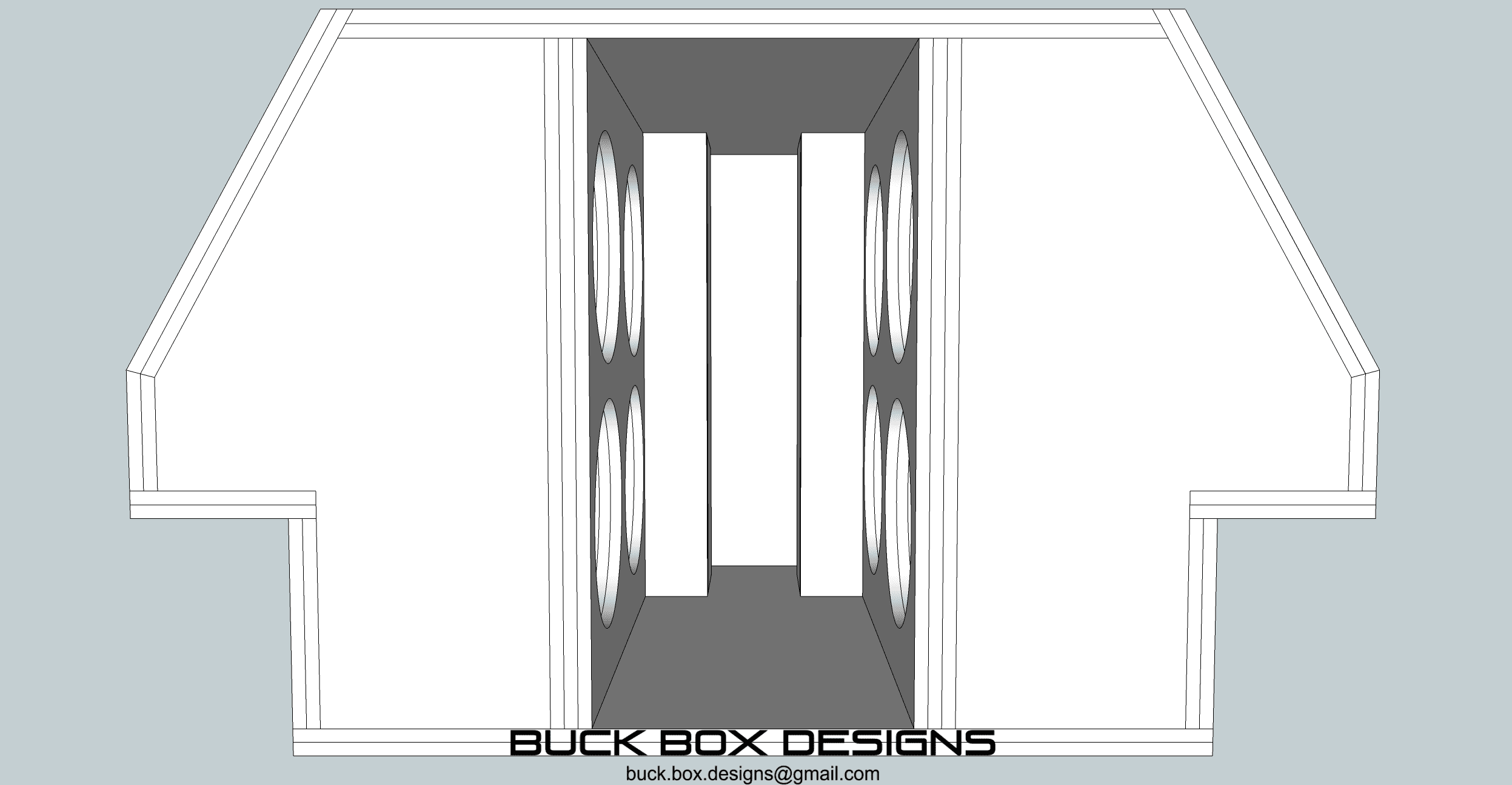

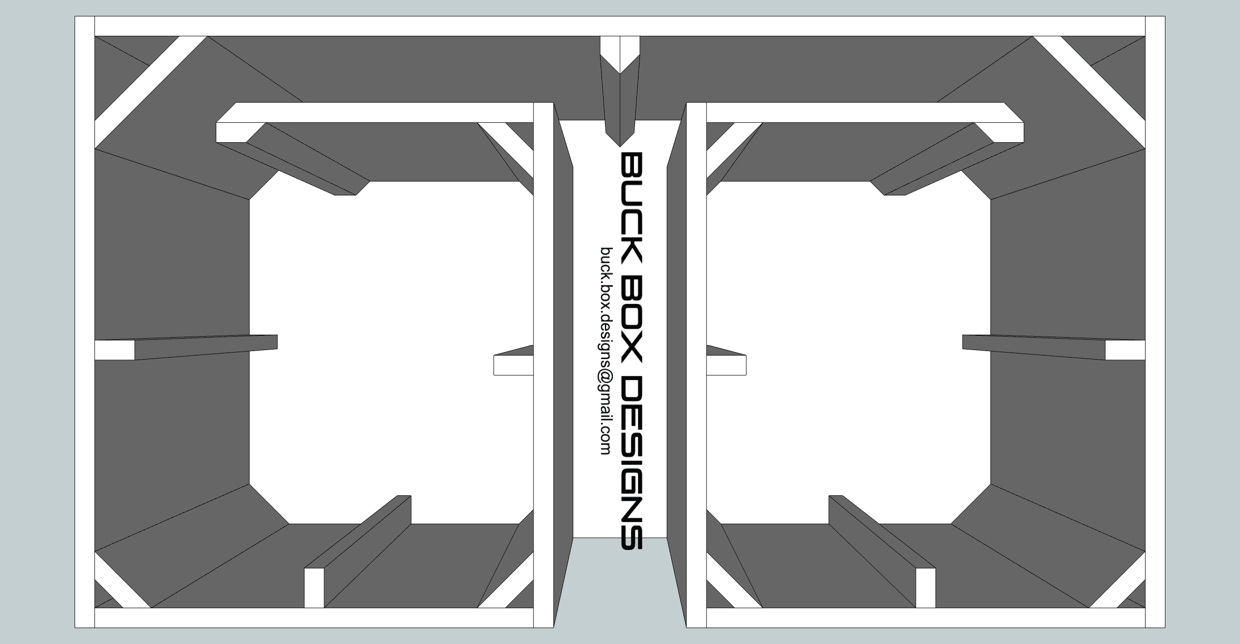

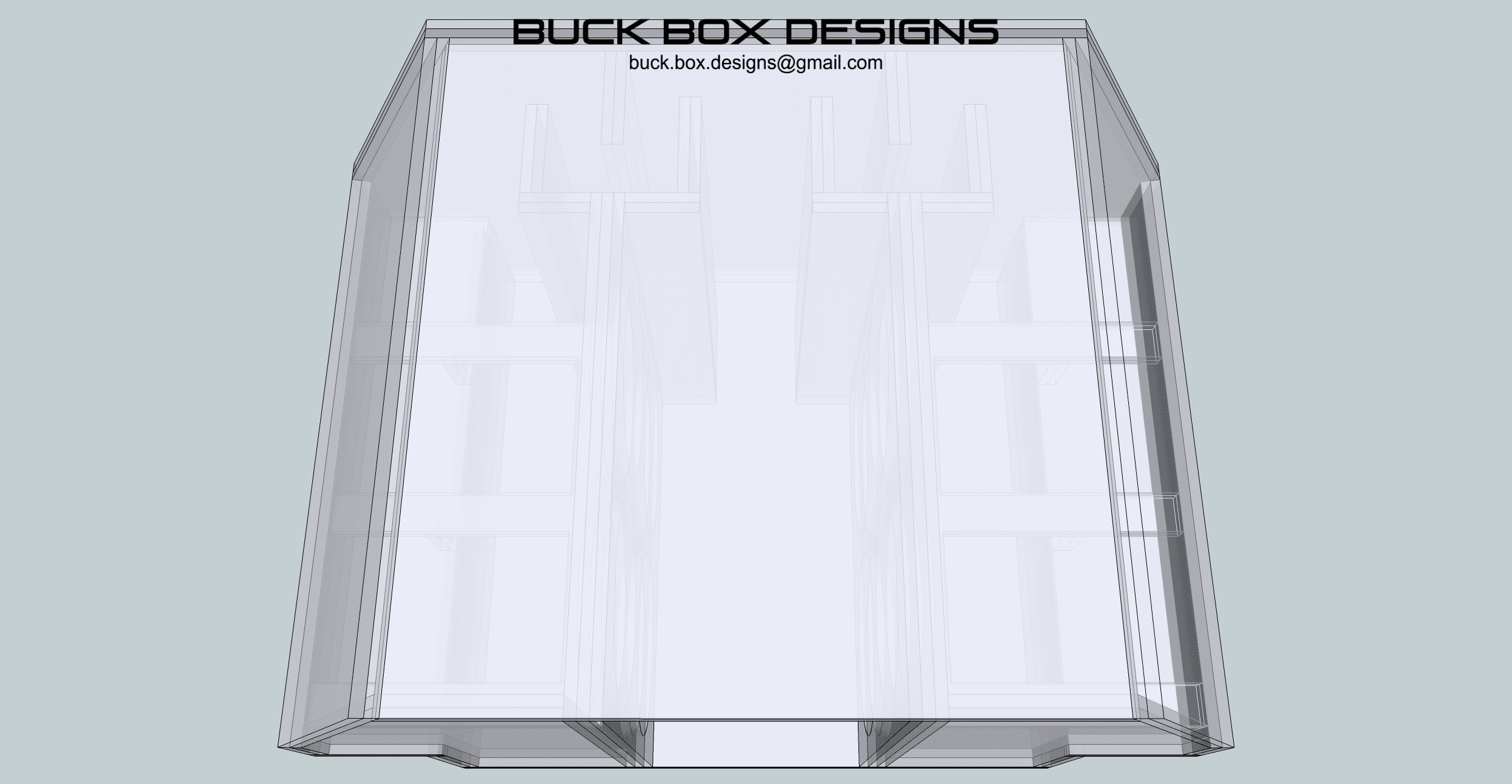

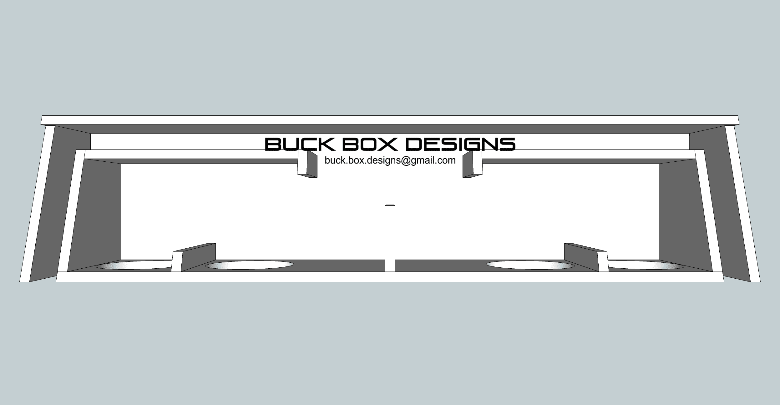

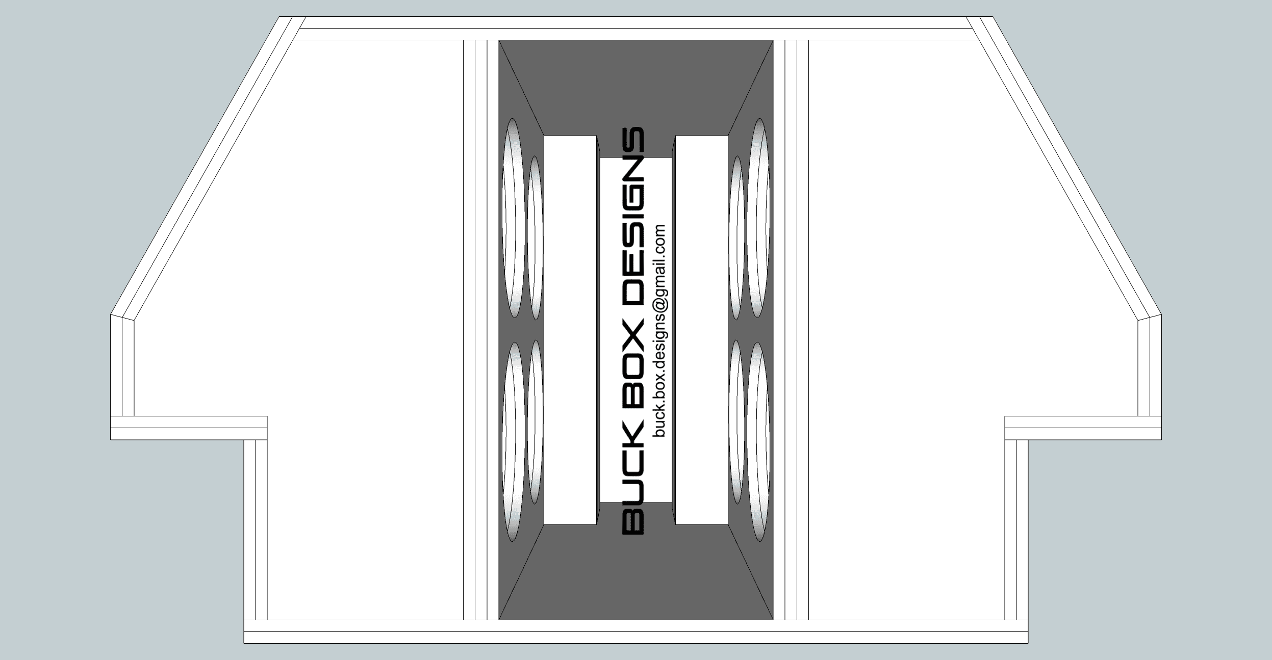

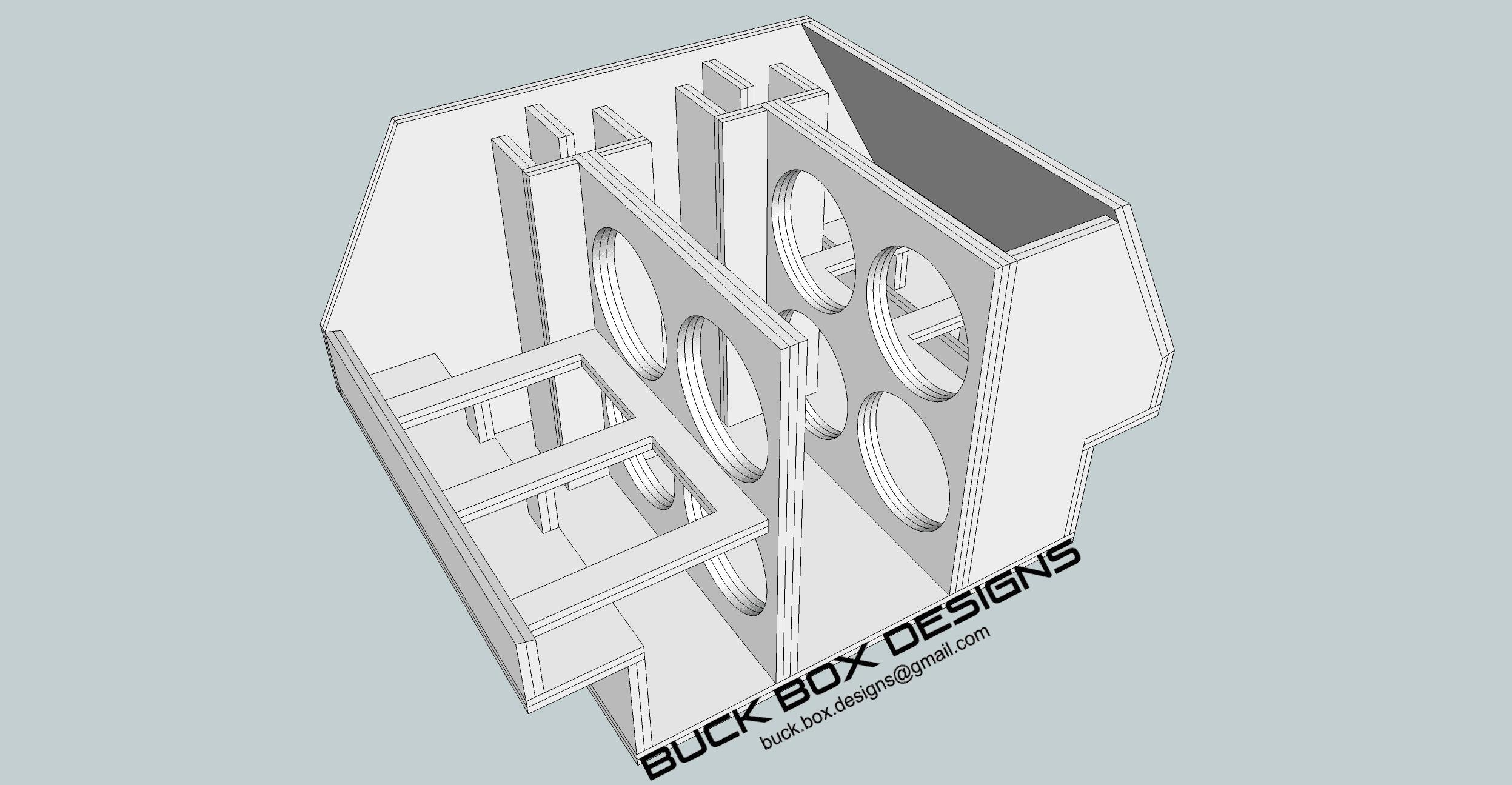

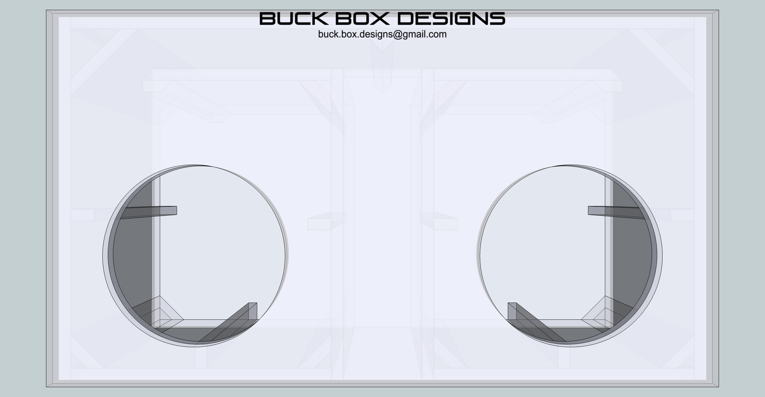

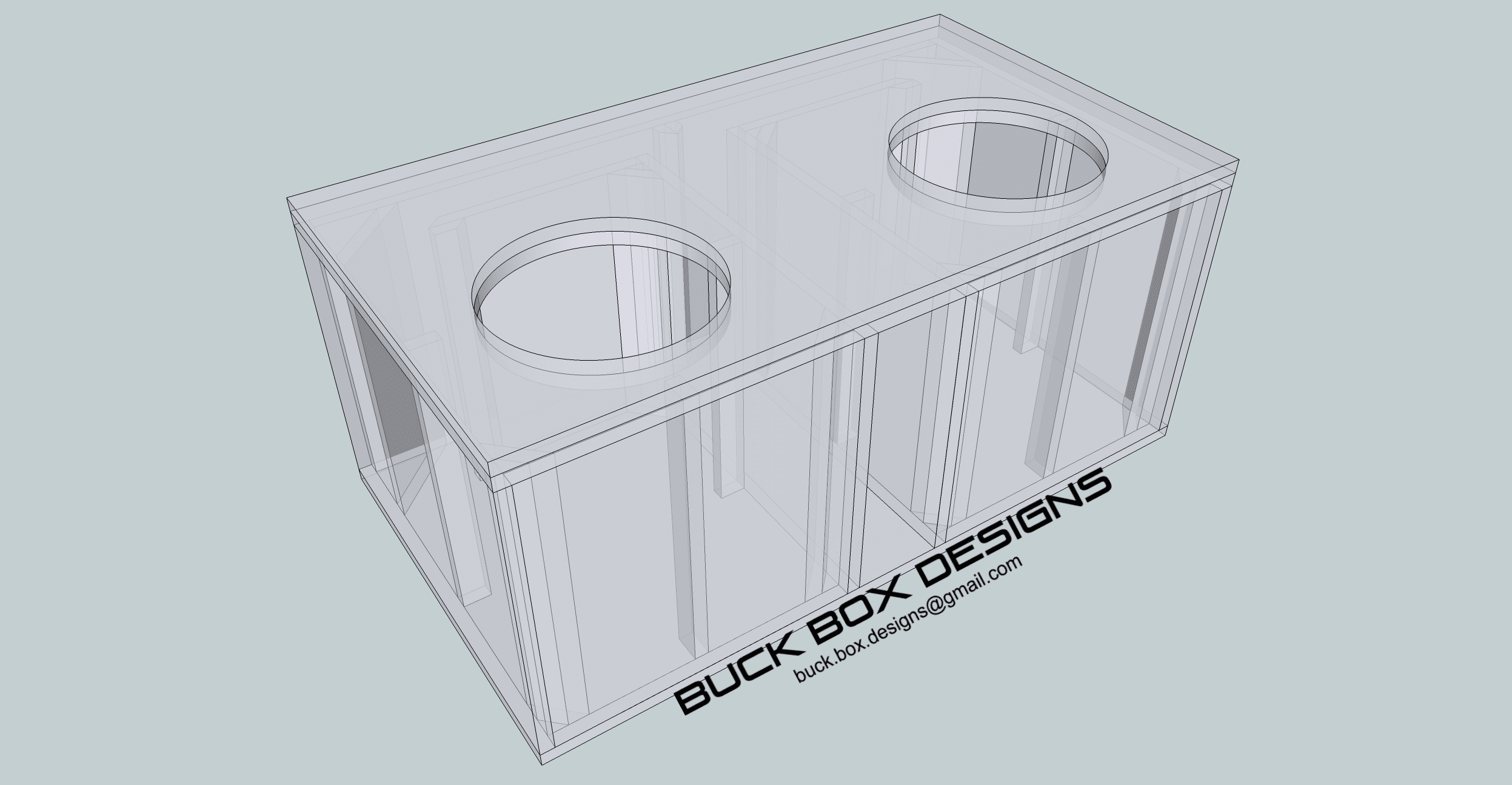

Super duper stuffed clamshell design, tuned very low. This box will have a good bit of extra strength work going into it, when it comes to internal bracing, just it won't be wood. This is a C-Pillar wall, believe it or not.
