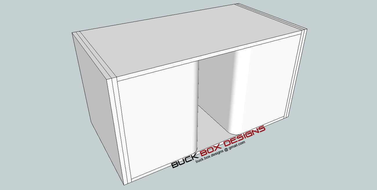

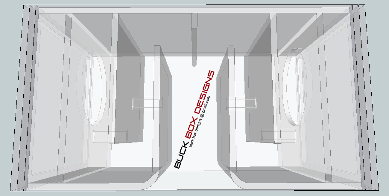

It's not that big of a deal. I was trying to figure out how many cubes should I be shooting for with 4- VFL8D2's. I think I'm going to shoot for 4.5 before port and speaker displacement. Sbooting for 32-35 hz.
It's really net that I would comment on. That tuning is probably where it needs to be, depending on what you want. I can't find any t/s or info on them. I'd think they would be around .75-1 cube net per woofer. If you can find me a manual to it, I'll let you know.

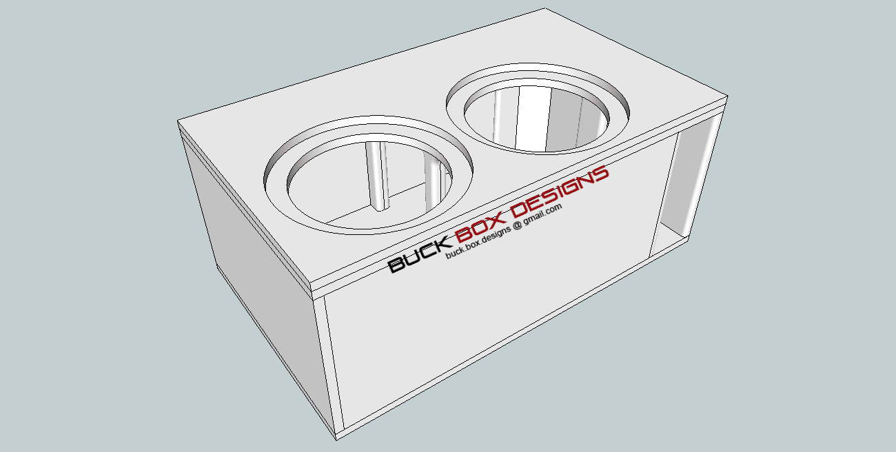

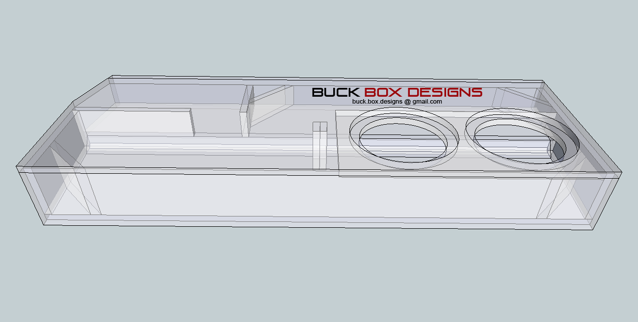

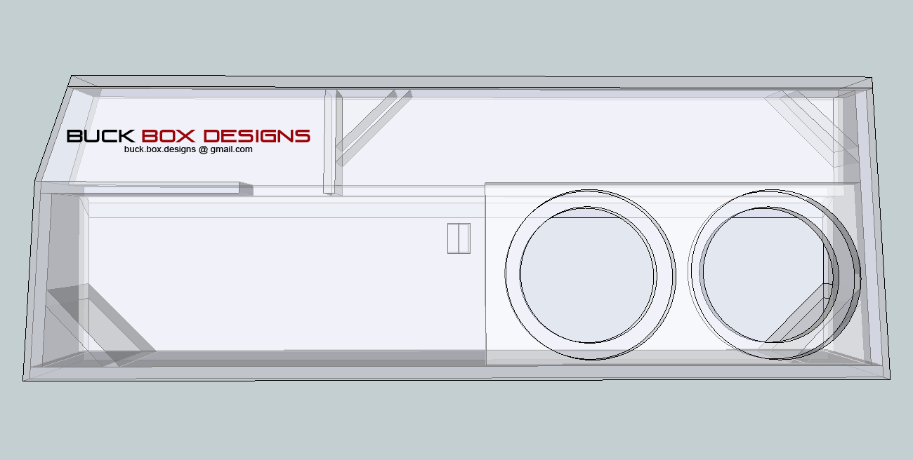

Ported Wedge Box for 2 350w Alpine 10's. Bit a funky box, a little complicated because it's a wedge box and has some contours to the vehicle body.

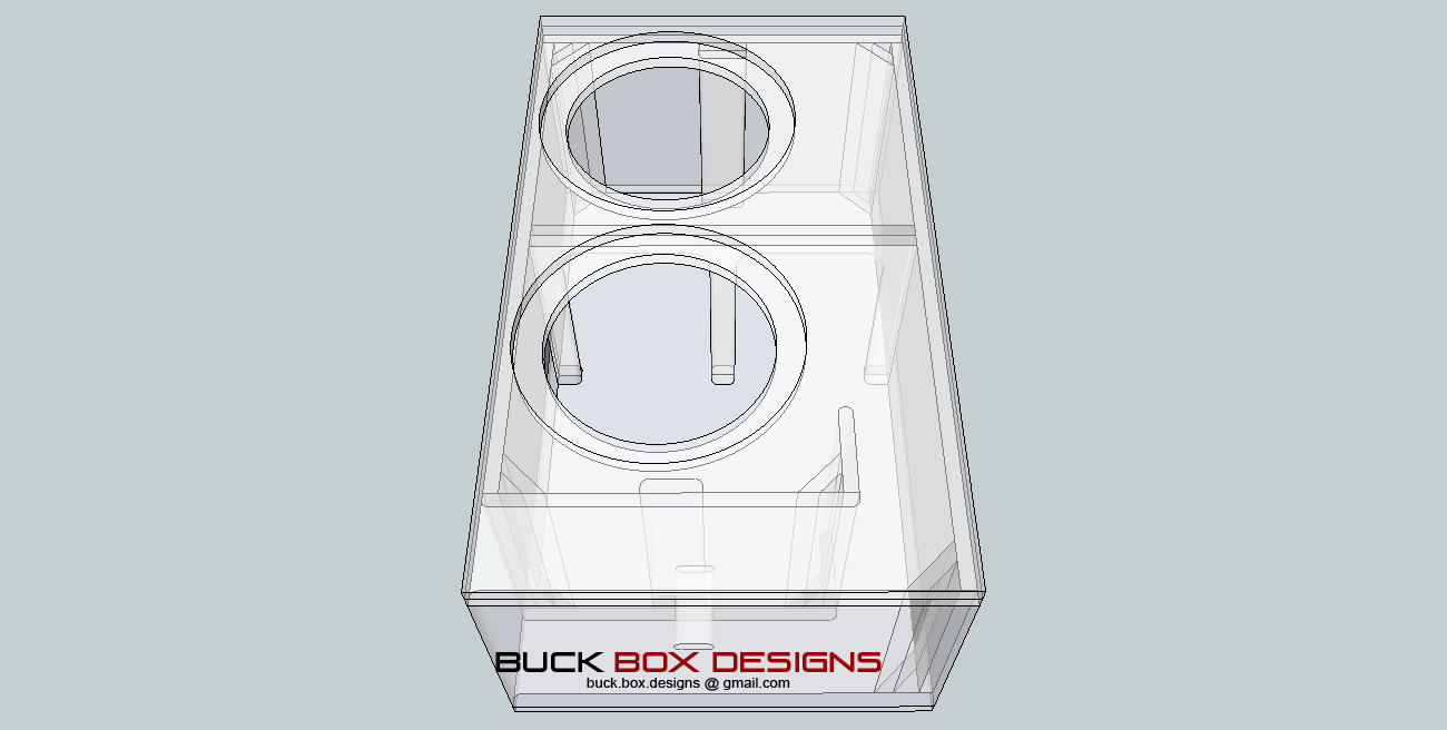

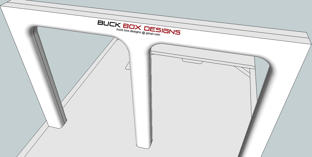

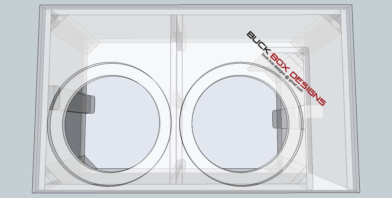

Ok. Buck is continuing to push the limits of my knowledge. I'm going all in, trying to do the best, complicated enclosures I can. I really love experimenting, I'm branching out my skills, combining them, trying to go harder than ever. Has a mild kerf port, too.
So this box is a Hybrid Sealed / Mildly Tapered T-line for 2 Pioneer Shallow Mount 12's (TS-SW30024). These woofers are actually more like 12.5's or 13's, the have quite a large Sd for a 12".

I did raw math on that enclosure, using some reverse non-exponential horn math to aid my tuning process. I hope to perfect my own formulas before too long, so I don't have to spend $$$ on a audio physic program (or try to deal with hornsrep LOL)
