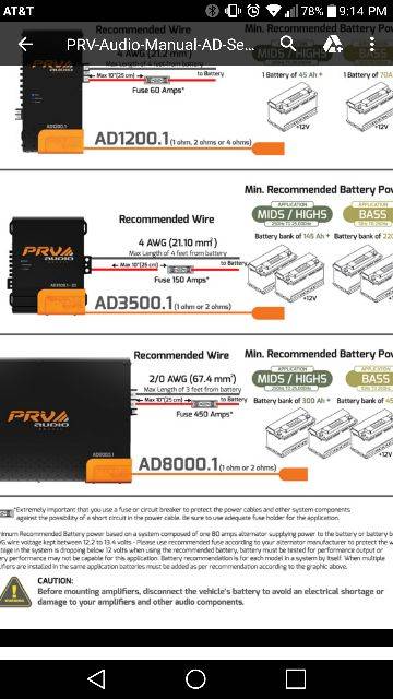

Can the power wire to this amp be 15ft or so? This picture is misleading..
