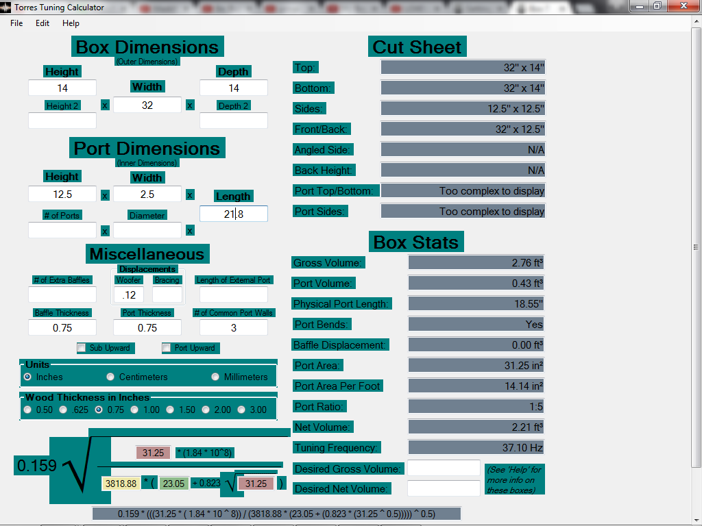

Building a box for a friend in a ford mustang. He has a 12" kicker L7. So i punched in some numbers on 12volt max demensions 14"H x 14"D x 32" W i got 2.75cubes. Port length 2.5"W x 12.5H x 21.8"L should have me tuned at 34HZ. Does this sound right?
nope. Dont use 12 volt unless you know the difference between gross and NET cubic feet because that'll fk up your enclosure.

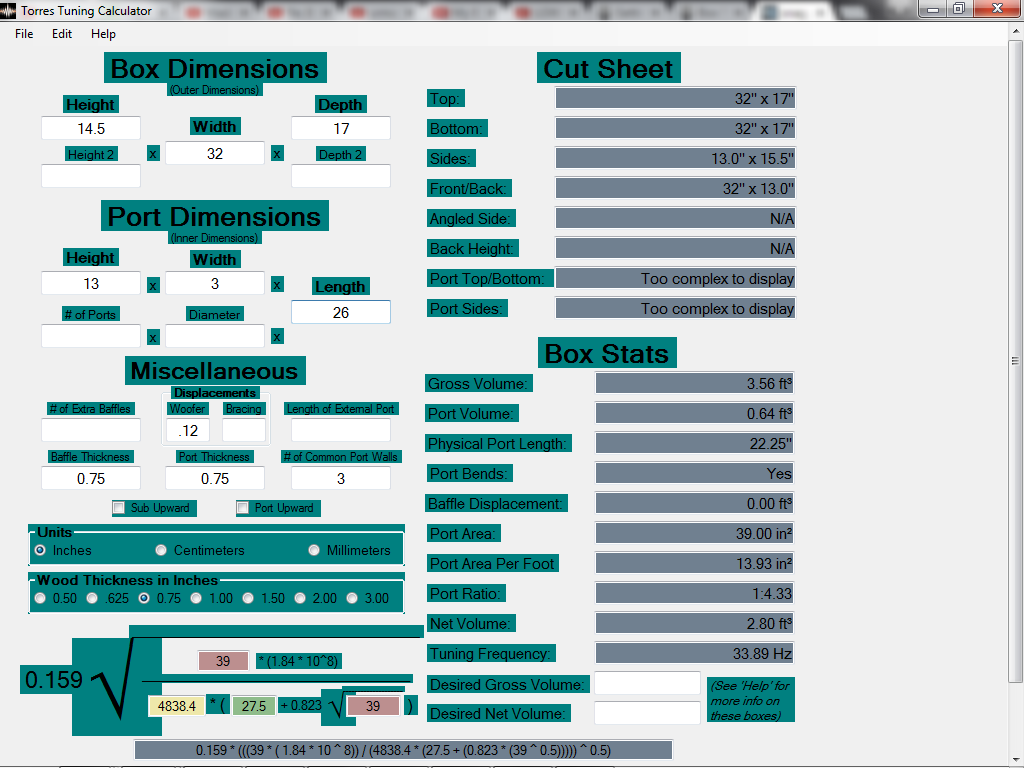

Any idea what my port length should be for a tunning frequency of 34hz. With my max demensions of 32 width 14 height 14 depth with a 2.5 width port by 12.5 height. Also is that app you use where can i get ot from?
It's Torres box calculator.
