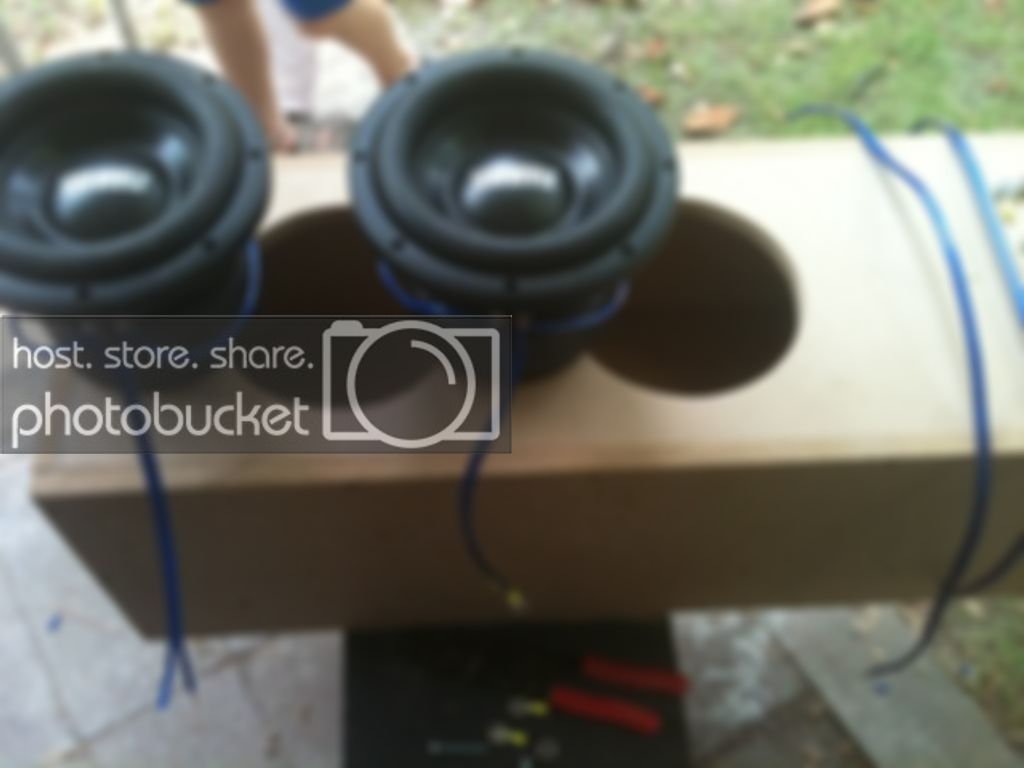

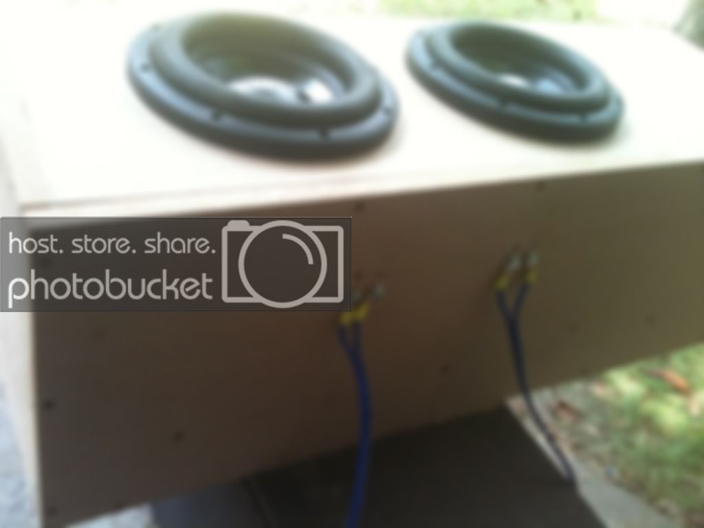

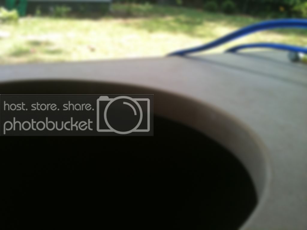

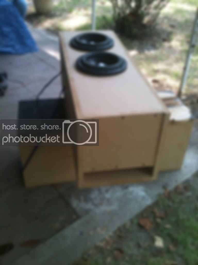

Ask and ye shall receive....

God those SA-8's are beefy...
Heres a quick crappy pic of one sitting next to my old RE SX 12"
Its sounding pretty good though. Nice tight bass with enough low end. I would like it to get a little lower but that may come with a new box design in the future.
How are you liking the overall output? I still have yet to drop in my pair, looking forward to it though. I've already gotten some nasty low end out of one.
After listening to them more today I must say I am very impressed. Great sound quality with this box also.
