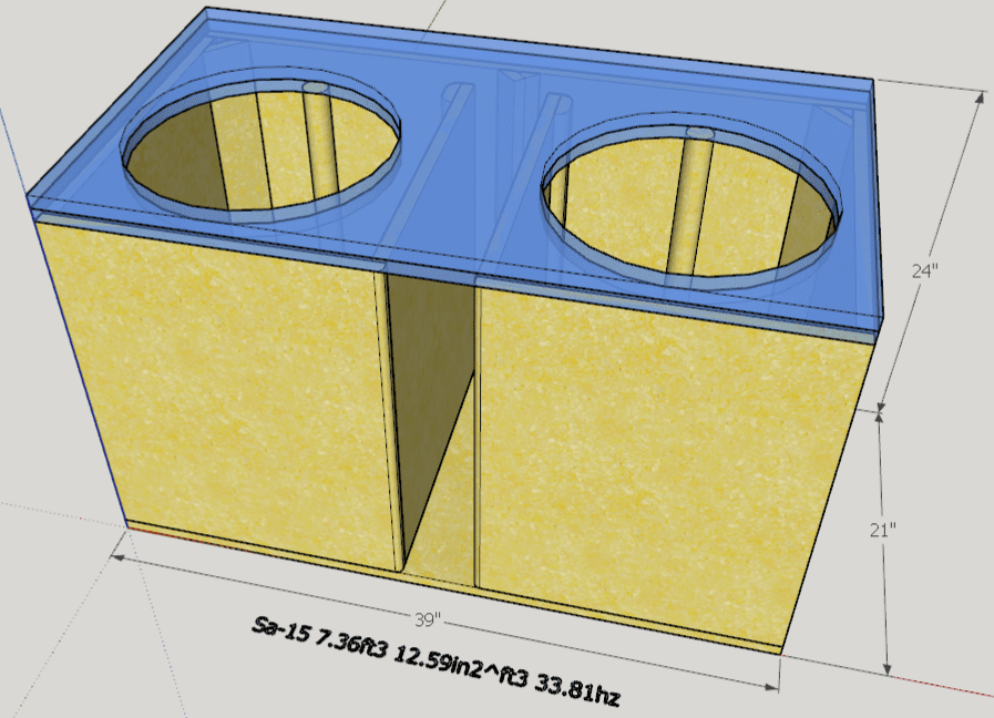

Hi i have 2 sa 15s and i just need a good plan. I can build the box myself. i tried using free softwares but that got me no where. Max the box can be is length 39 inches, Height 24 inches, width 21 inches. Its in a 2010 ford escape if that helps any. I will be pushing them with a crescendo 2k. I want a vented box with port in the front and the 2 subs on top. Any help will be appreciated Thanks.

Everything I design is Winisd modeled... configured for a specific vehicle... sometimes I just post examples of something that might work before all available space or amp power is listed... usually with a low to daily tune.

in suv subs should be up port back @Buck can design the crap outta a box (he charges small fee for his time) he's good i think he just invented a new type of box few weeks ago (can be 6th order or 4th order) send him a pm..

Yeah i can do it if you want me to

You have enough space with the dims you provided
Day off... new job... re-reading old threads and found some time to play around so this is what I came up with...
ought to do ok IMO...
