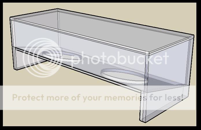

Here is a quick sketch of something you might be interested in...
I don't know why the double wood, but the downfiring sounds pretty nice. But, the problem with downfiring (or so I hear) is that sometimes if it's too close it sounds bad, and the transverse is true, too.
The only place it is doubled up is the legs. With people sitting on it, I would rather it have more support so the legs don't fail.
hell yes. good design. i think this could work out quite well. ill try 2 get some dimensions if u would fit em to it..
