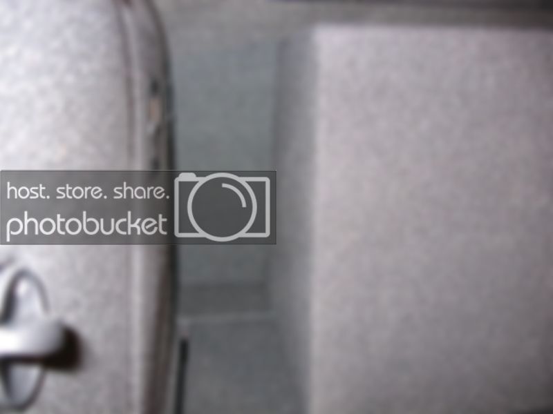

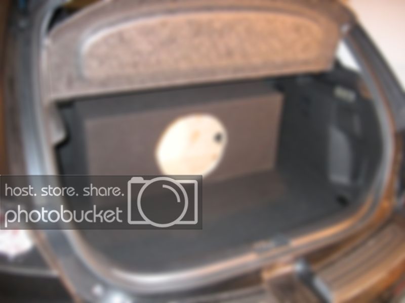

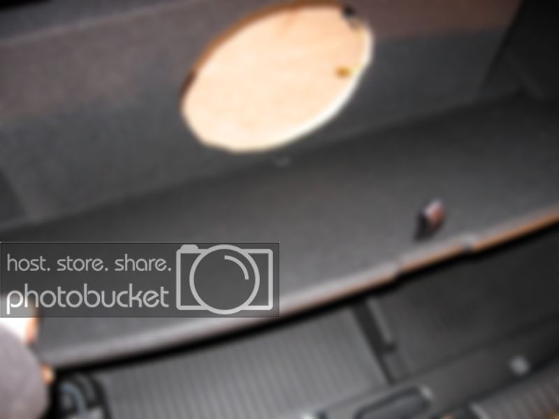

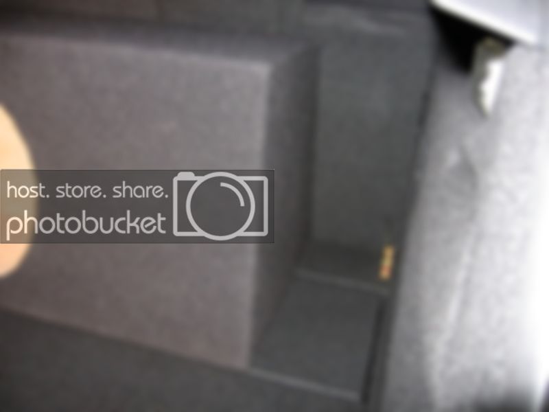

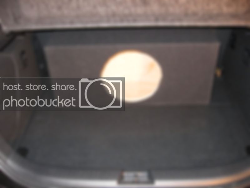

J.J. is a member here lives about 70 miles up the road from me.......built this box to fit in his cargo area. basically built it from pictures and a couple measurements. Its for a JL 12 W6, older model. Basica sealed box, 1.25cf net, has a false slanted back with room to stuff wires under if he wants to hide them. Added bonus was he could access his storage area under the floor without removing the box....got lucky on that as it was not considered in the design. Depth was only 7" so he could maximize his cargo area.
he took the pictures once he got the box home and fitted into his ride.

Did you throw a couple of small braces in it?
Nope...its only 28.750 x 11.5 x 7 inside. I built it out of 3/4" MDF ....trust me...it is very solid. Plenty for his application.
