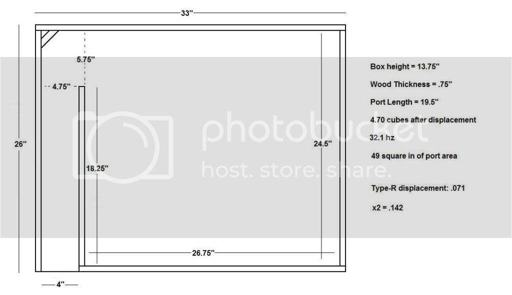

I've been designing a box for 2 12" Type-R's in my small Mustang trunk. This is what I came up with. It's as big as i can go in every external dimension.
Is it enough airspace? Enough port area? And is the end of the port too close to the back of the box? And would I need to do a double baffle?
single baffle will be fine, i built a box for 2 10" mtx 8000's for the trunk of a 2000 gt that was close to the same specs, the problem was getting the box in the trunk after i built it.
thanks. yeah getting this thing in my trunk won't be easy either. I'll have to take out my backseats and then bend some metal.
