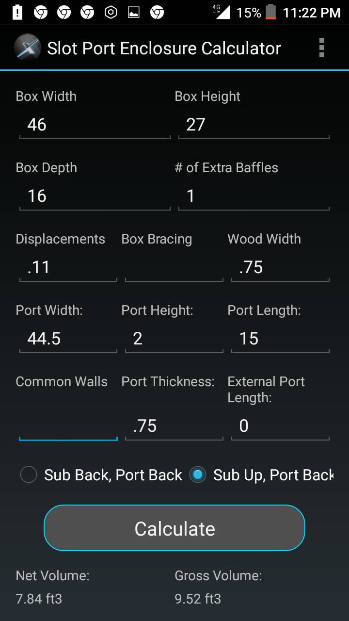

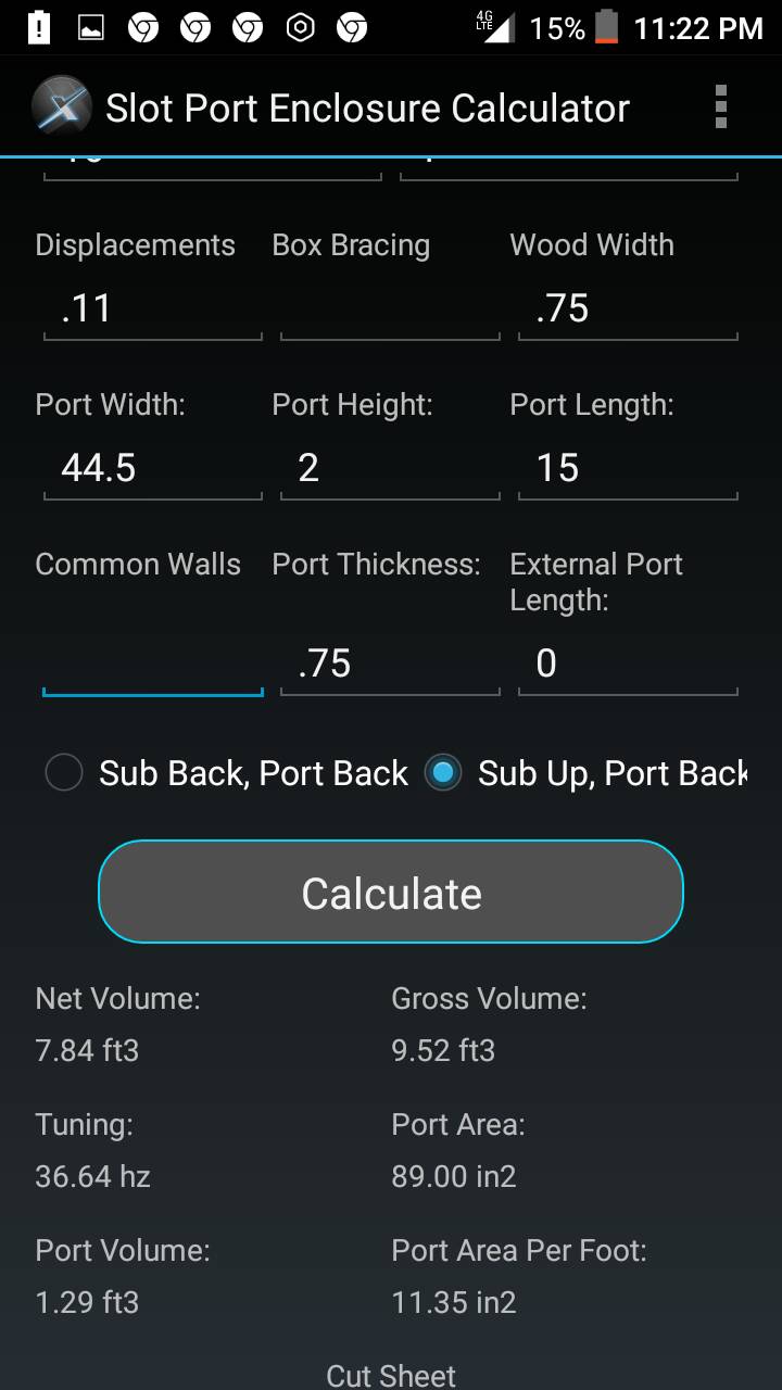

how does this look and how would I factor in common walls and port bracing? Was also thinking maybe a removable port?

Dude I think you've got the measurements mixed around, your port is 44.5" wide port? Either way, that's not near enough port area, I'd at go to around 15.5sqin per cube
