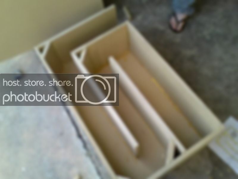

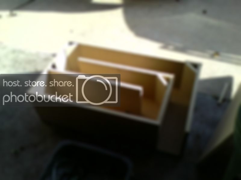

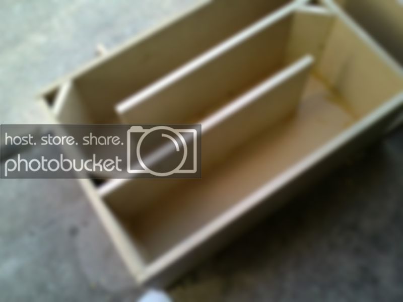

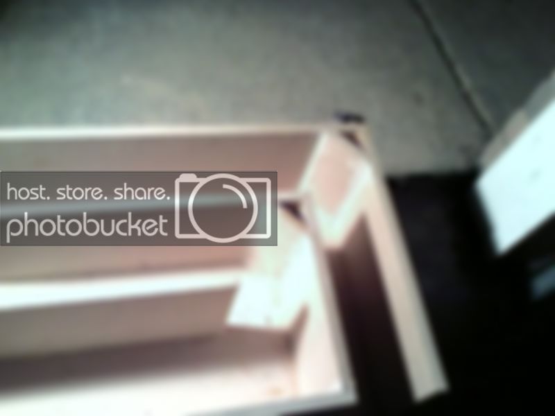

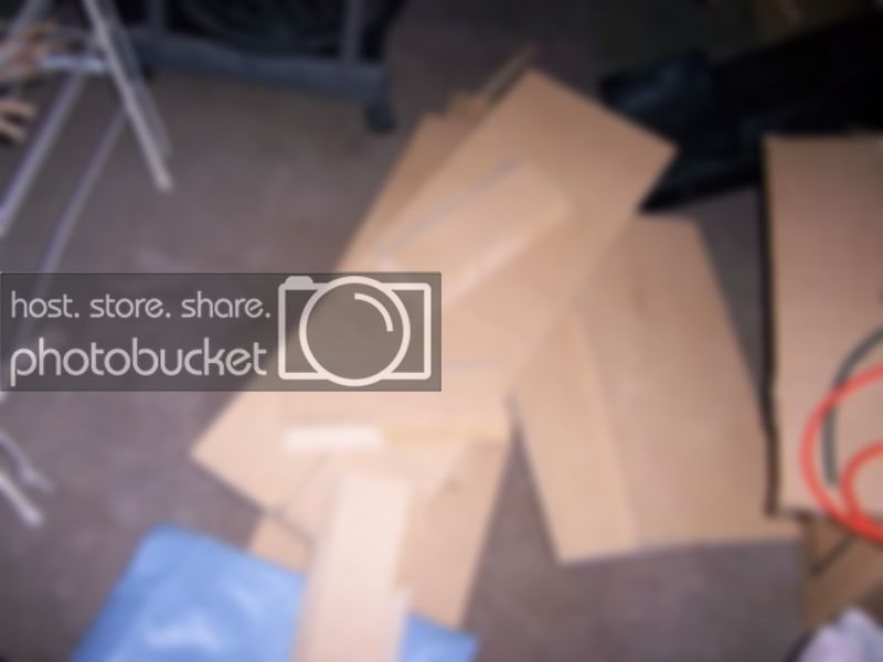

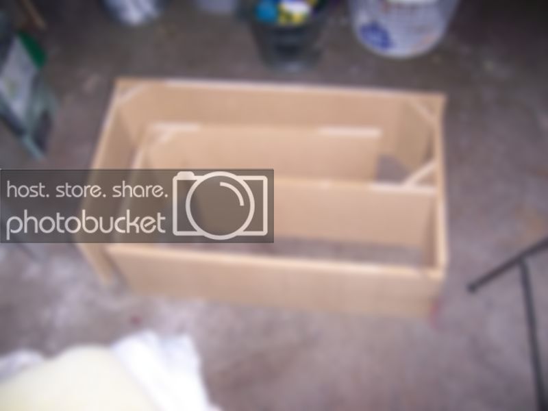

got these from ttb. everything is cut except for the top and bottom piece.

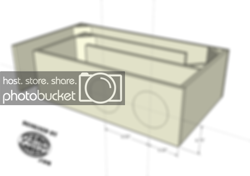

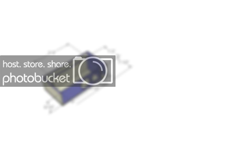

this is another box i designed that i plan on building. i also talked to 80 inches about putting together a bandpass. and i also plan on building a box to dd specs. i hope to have each of them metered to see what is the loudest. and ill keep whichever i like most.

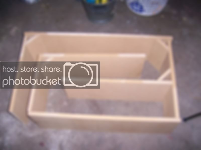

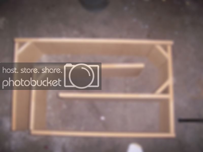

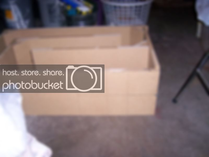

more than satisfied with how everything came out. i used two older left over mdf sheets which causes some problems for me. but not too concerned because like i said im doin a few more boxes. whichever i like the most will be redone with something lighter than mdf.
Is that going to be a tapered transmission line? I can't tell from your ghetto dry fit or from the angle of the sketch. The height of that back piece looks really off. I hope you plan on doing something about that.
If that's a tapered TL, what is it tuned to? The line doesn't look very long, maybe 2.5 meters. That's a tune close to 34hz if I am assuming correctly...
EDIT: New pictures make it appear to be non tapered and the length looks shorter than what I estimated. Let us know how it sounds.
panel height looked off because some of the pieces were leaning to keep them standing up. according to ttb its a tline/bassreflex the length of the line goin down the center would be about 60 inches. i have no clues what that puts the tuning at.
