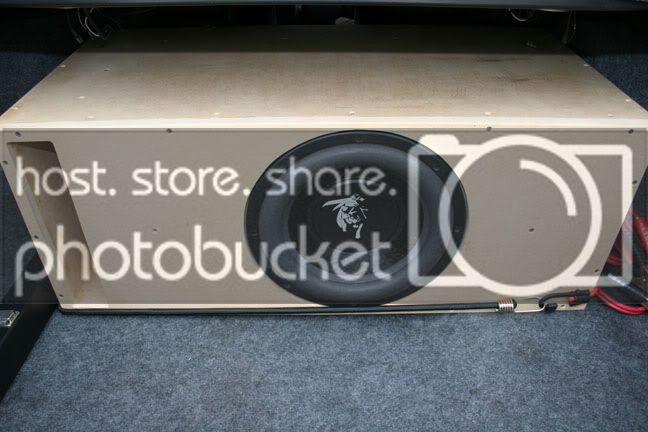

i'd go with 2.5 cu ft tuned to 28 hz. (what i had my brahma 12 in)
tune it higher if you want a little more output.
My Brahma 12 is in 2 CUFT tuned to roughly 31 and it sounds great. I would say any of th 2 CU boxes tuned from 29 to 32 should work well on that page. I'm sure 2.5@28 would be very nice as well if you want to give up that much room. I did 2 cuft for space reasons.
