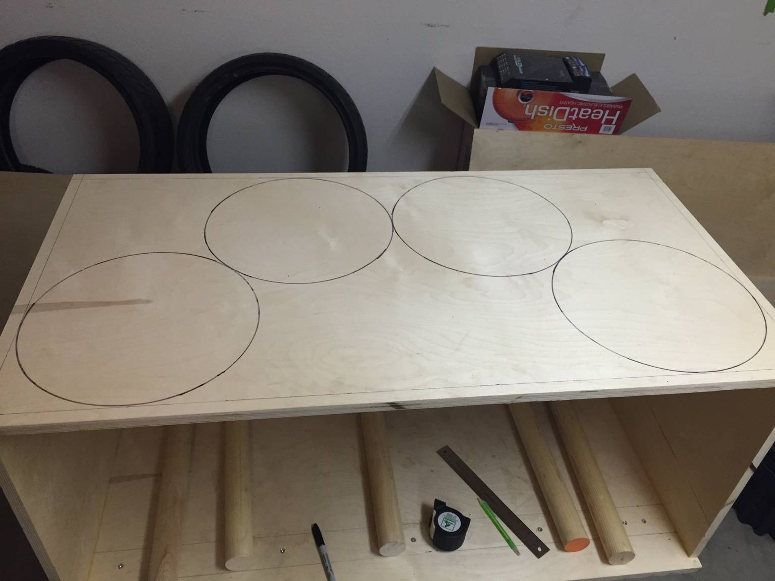

I got the box started today. I'm hoping to have it done by the weekend.
Didn't finish the box like I had hoped but maybe by next weekend.

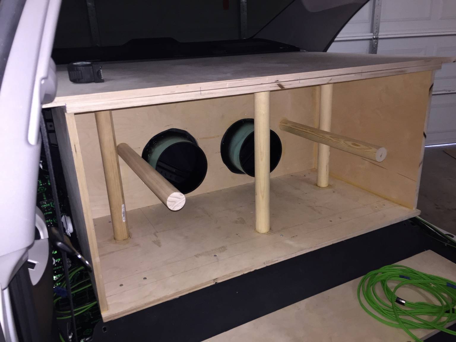

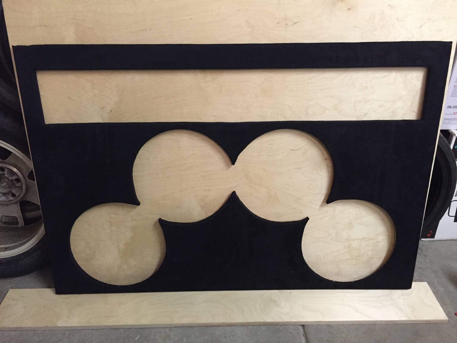

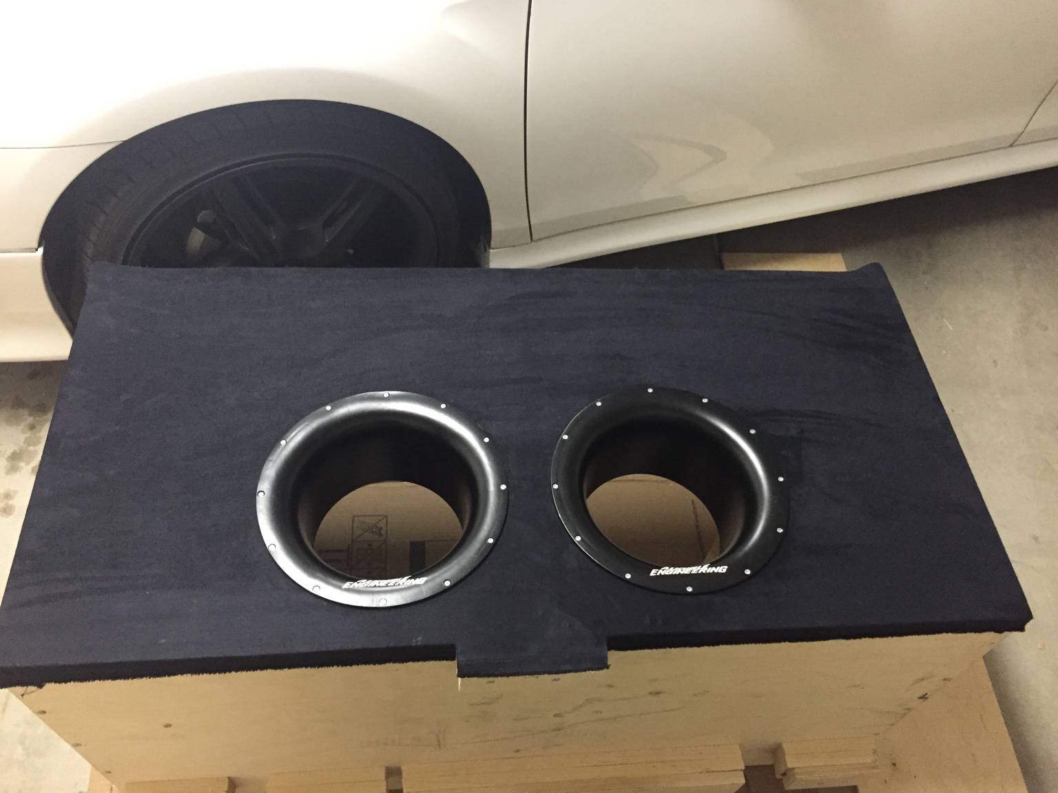

I got the ports screwed in and the back wrapped in suede. I also got the bracing done and figured out sub placement. It is bolted in the car now as well.
I just need to cut the sub holes and get the front and top put on //content.invisioncic.com/y282845/emoticons/biggrin.gif.d71a5d36fcbab170f2364c9f2e3946cb.gif almost there!

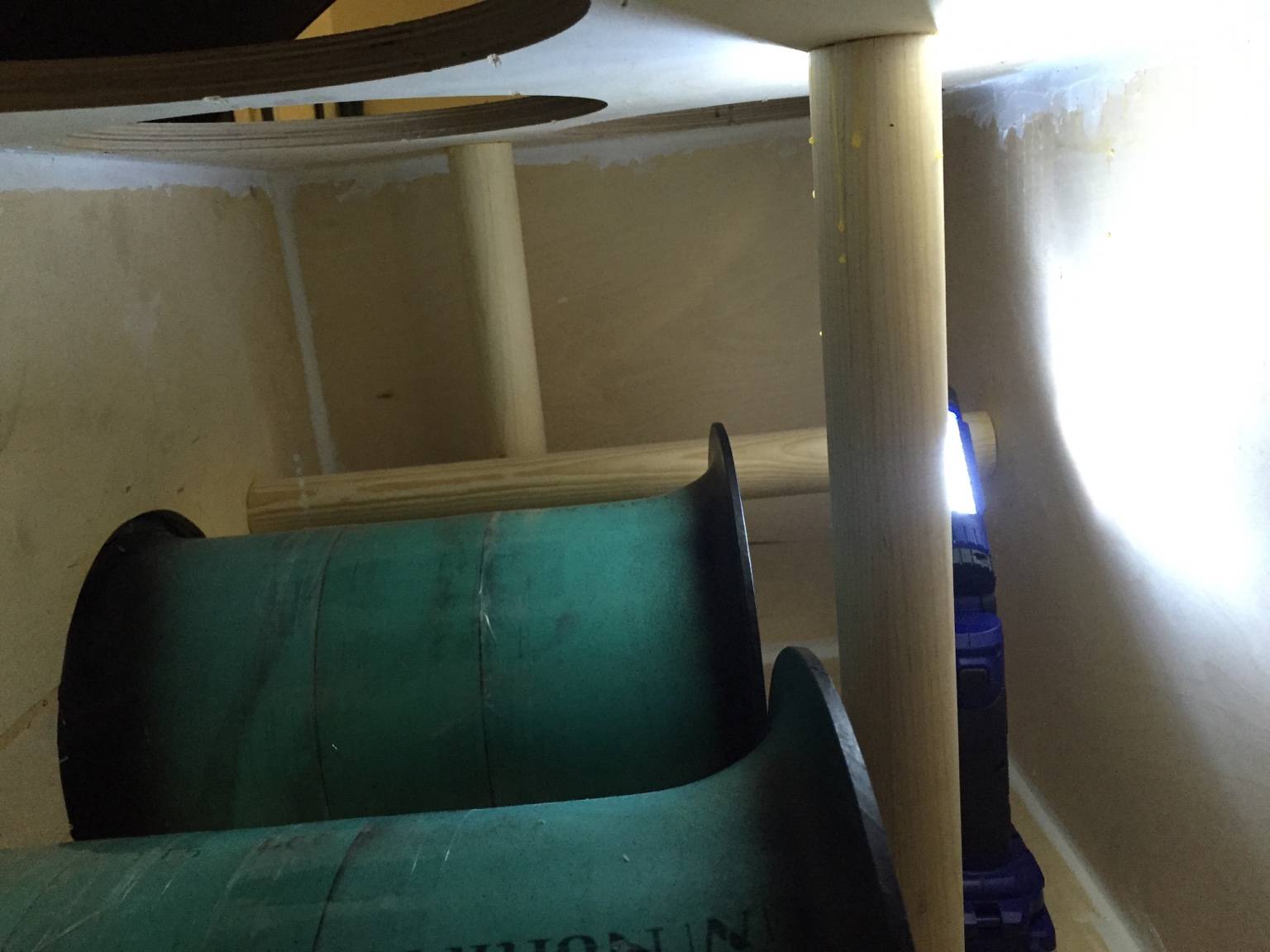

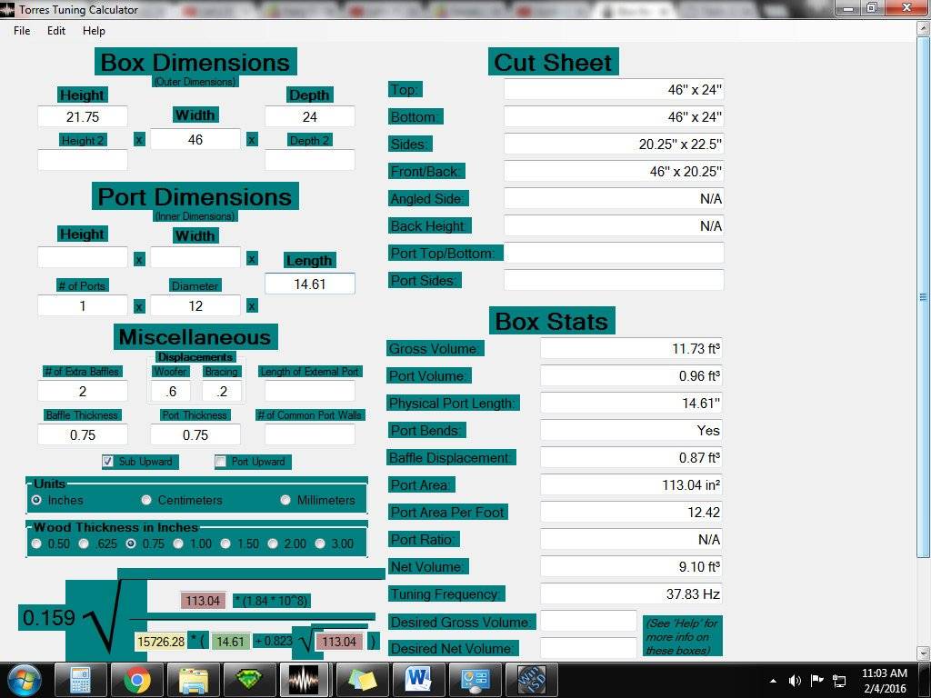

To calculate the port, you actually need to know the space you have AFTER accounting port displacement not before. So that renders most online calculators completely useless and the calculations to get to that point will be a never ending paradox. Gotta use a calculator that does that for you. Your box is currently a lot smaller than projected NET airspace wise and tuned a lot higher. Sub displacement is more around .15 cubes per sub as well.
with 21.75 as outer height and 19.5 as inner height that counts as a triple baffle not a double. You only need one extra one with only 4 12s. These arent 85lb 12s we are dealing with so triple baffle is not necessary at all.
I tweak the dimensions of the box to give me the net airspace I know I'll end up with rather than just plugging in the true dimensions. For example, REs box calculator with a set of dimensions will give me 2.3 cubes. But that's not really my end volume after displacement. So I shrink the box an inch at a time in different directions to find my port length at 2 cubic feet. It's pretty simple once you get the hang of it. BTW your right, if you do othing but plug (huehuehue) your numbers into the calculator you'll never get proper volume or tuning.

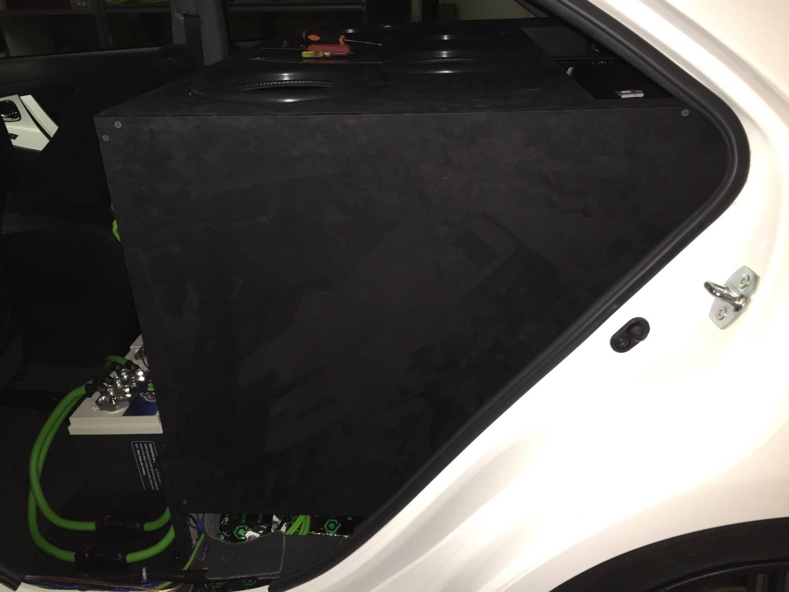

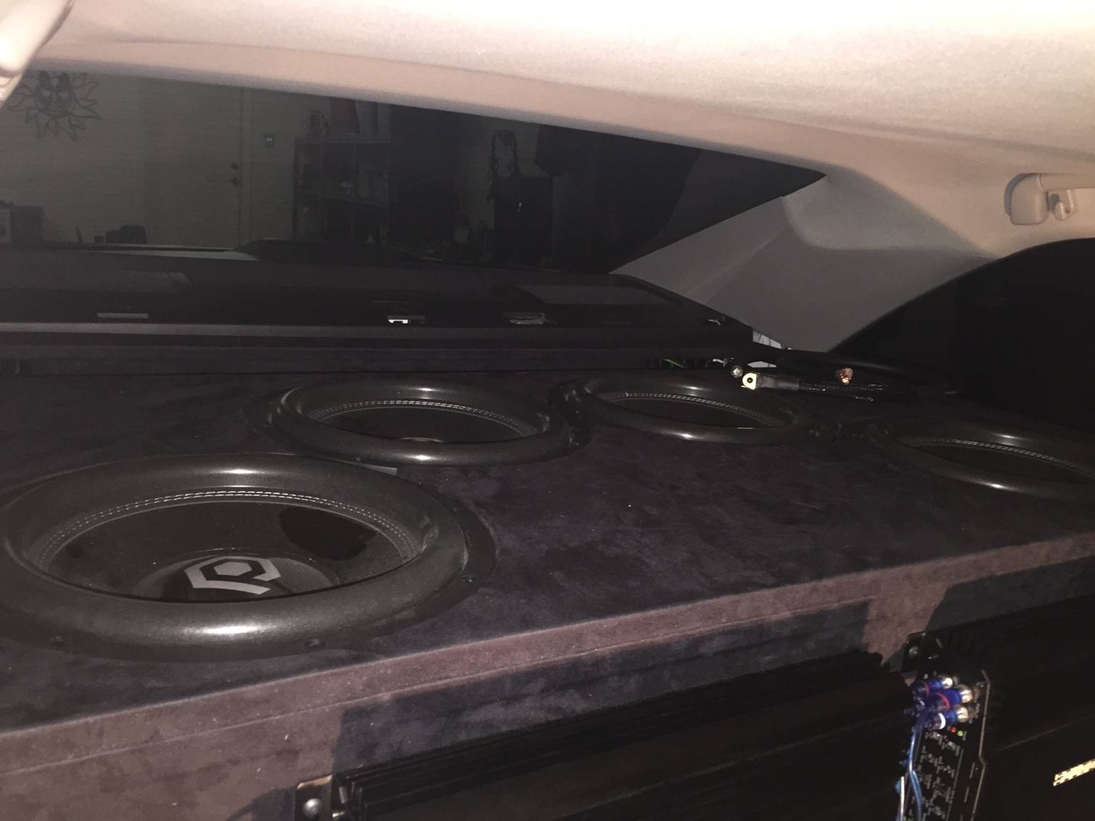

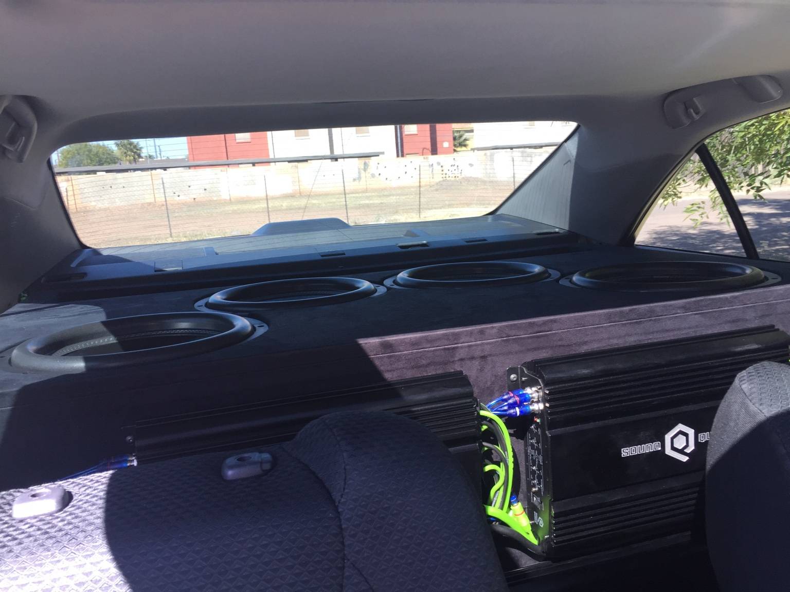

The box is done and slams pretty good //content.invisioncic.com/y282845/emoticons/smile.gif.1ebc41e1811405b213edfc4622c41e27.gif
Just need to make the side beauty panels this weekend and bolt down the front of the box (the back is already bolted down but the box still moves a little more than I'd like)
Inside, all sealed up and the top is glued/screwed in place

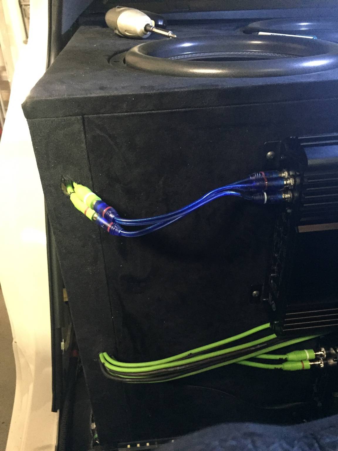

Top beauty baffle
All done

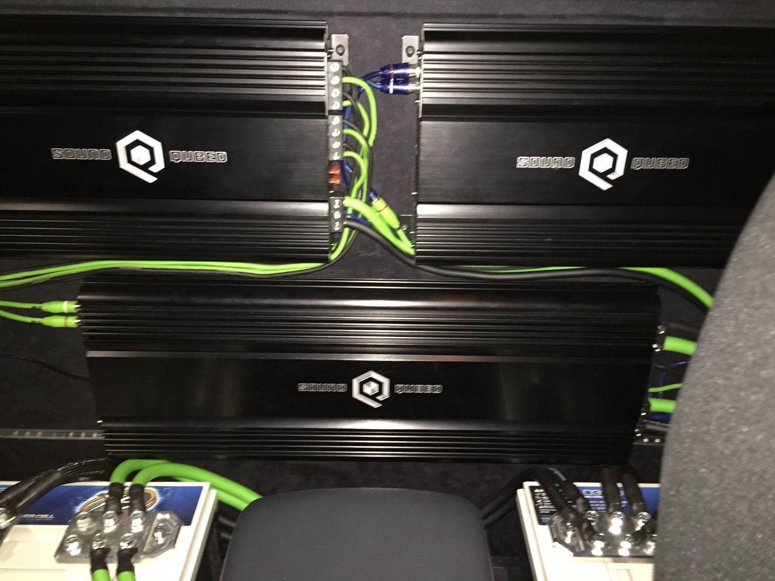

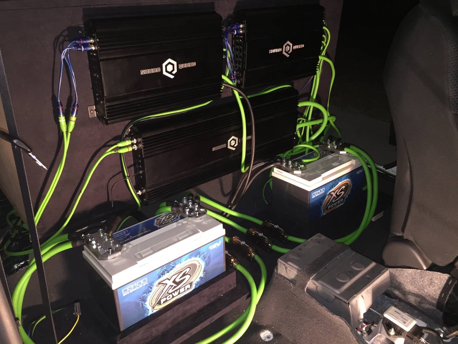

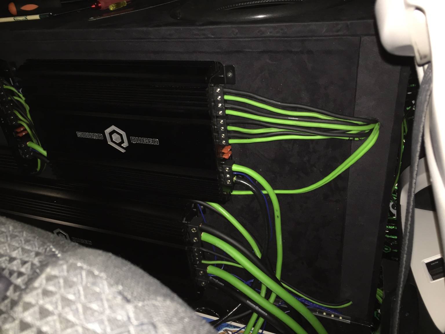

Still need to clean up wiring

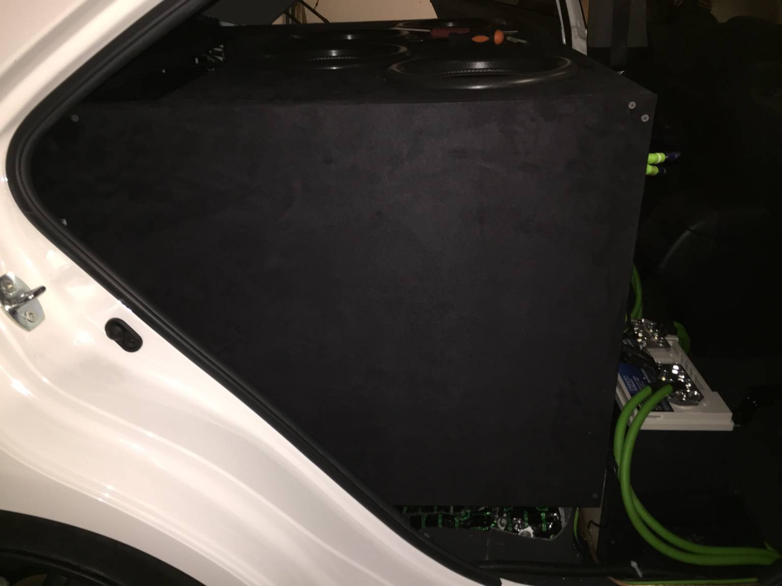

And the back

Here are some finished pics of the box to close off the thread
