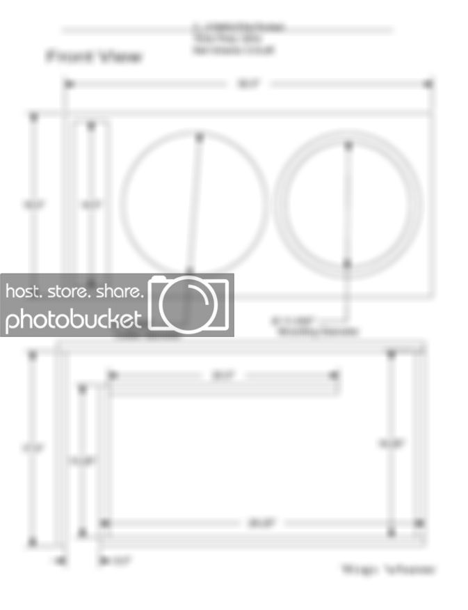

I would run your subs off od a 1000/1 and the box needs to be 3 cubes tuned to 32. Sounds great and gets loud. That is what I have mine at. If you want a blueprint I will send you one. Just let me know.
This will get you bumpin. I have basicly 2 of these boxes put together and love the sq and the spl I get. Trust me you won't find a better box for sql for these subs. This was designed in conjunction with JL Audio tech's. Enjoy.
oh and fyi you might want to extend the 17 inch side to 17.75 and double up the face. These have already broken my face piece. That is a weak point in this box but an easy fix.
