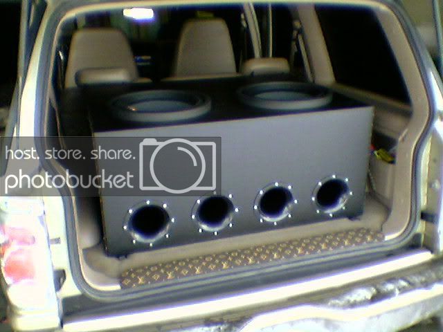

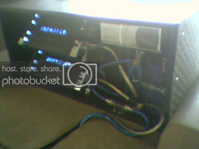

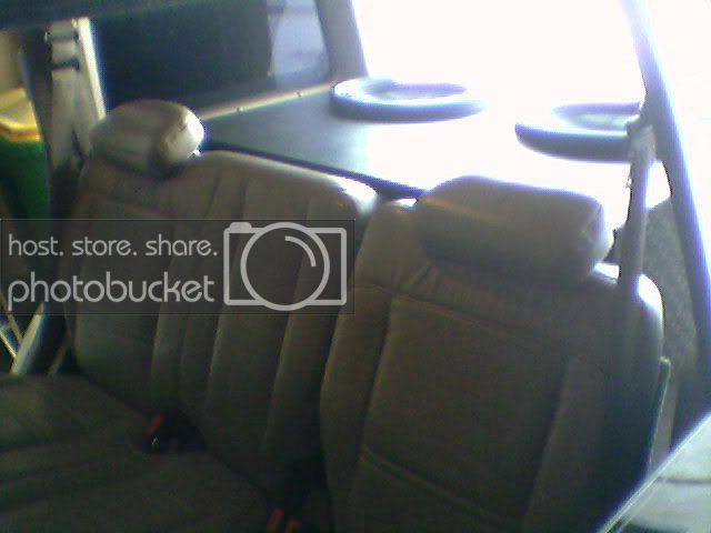

2000 explorer build. this box is 7 cubes net. this turned out well:
I had a pair of TI 15's.
Did 7.5 cubes after displacement. 190 sq inches of port. Tuned to 33-34 hz. They worked well in that box.
Put 'em on a 2500d. Shit got LOUD:cool:
