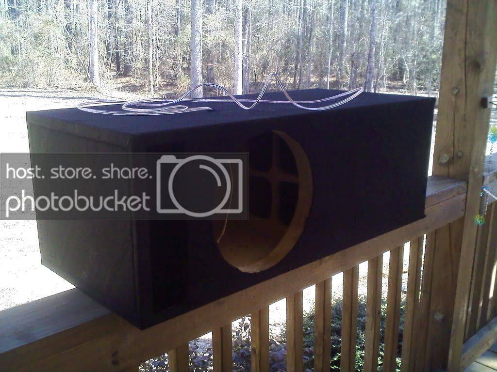

here is a build that i did for a sundown SA 12"...i went in a mustang, in 2cubes at 30hz

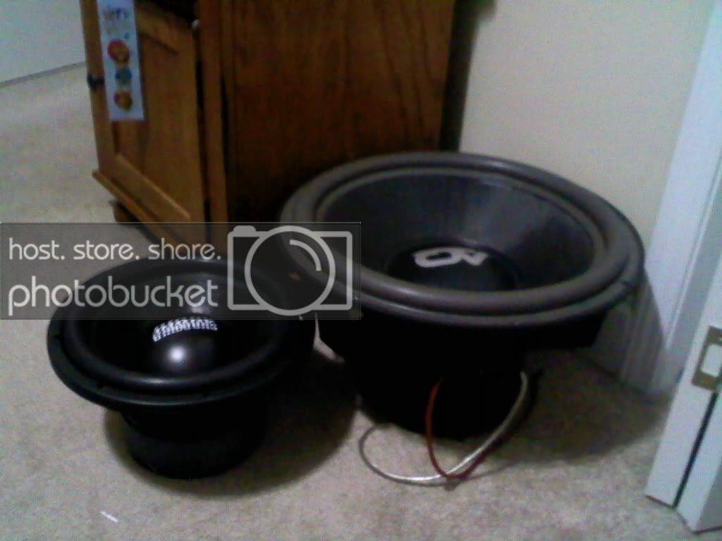

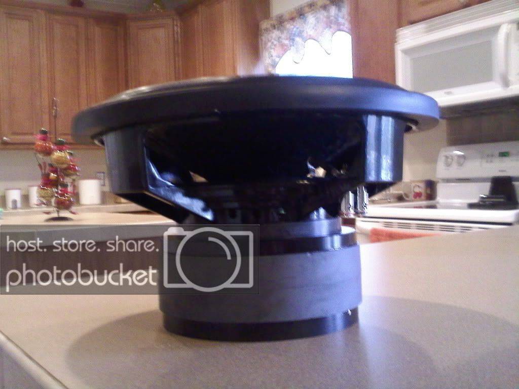

here are some pics of the sub

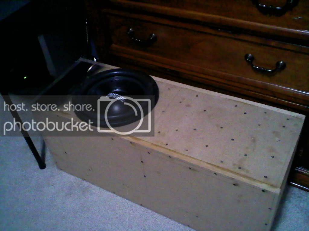

next to the hdc318

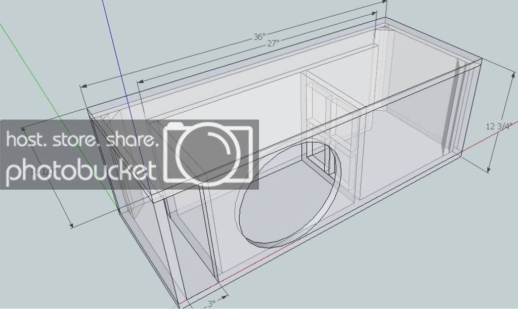

here's the design

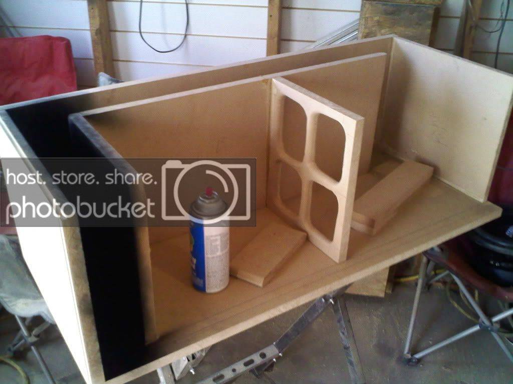

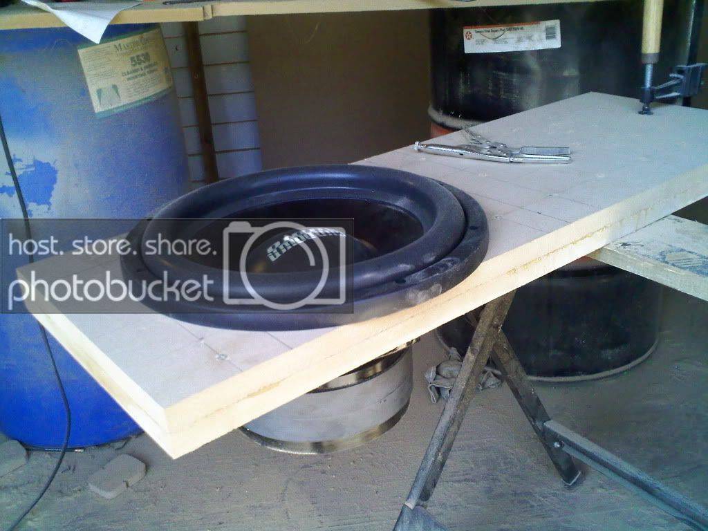

the pieces
some progress

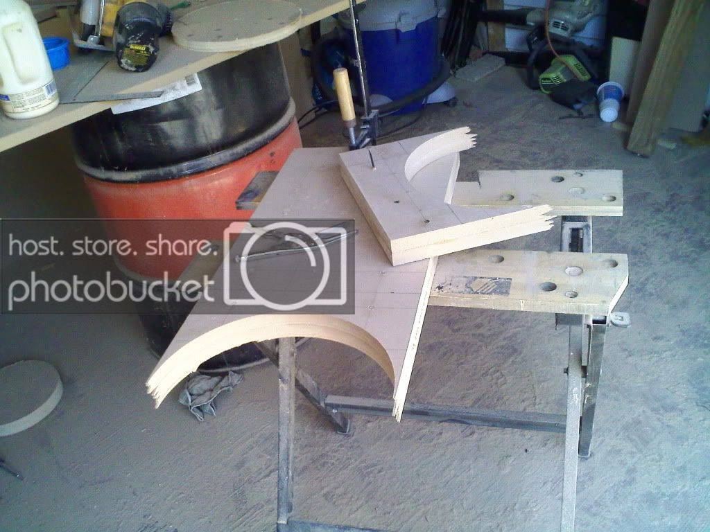

making the double baffle
had an accident //content.invisioncic.com/y282845/emoticons/frown.gif.a3531fa0534503350665a1e957861287.gif

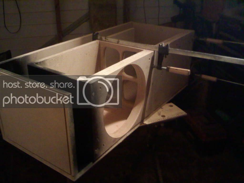

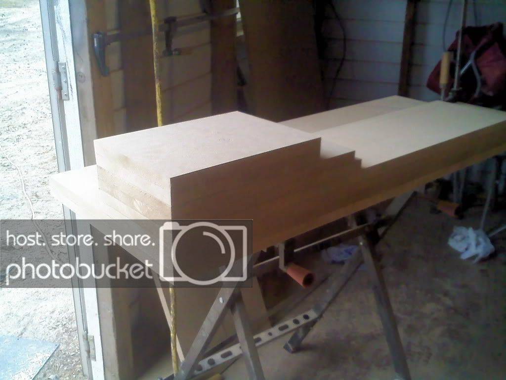

makin more progress
i didnt feel like buying a rabbet bit for the router, so i just set the depth and thickness on my table saw and just make cuts along the edges....i think its twice as fast as using the rabbet bit, but not all boxes have the same size grooves...thats about the only downfall to it..
