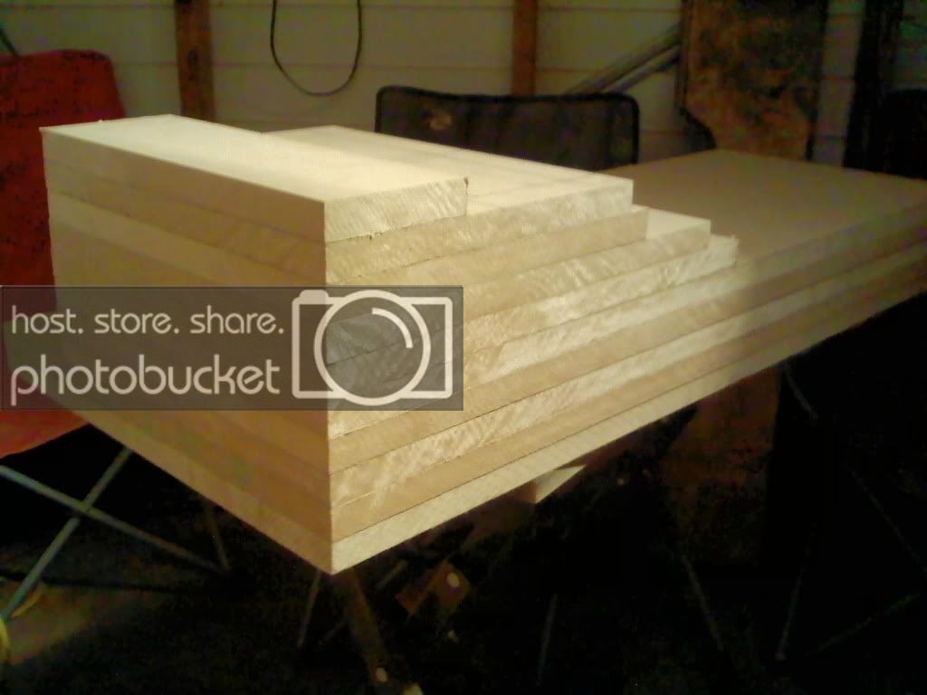

here's a build for a 12" Fi Btl that will be going in the hatch of a 92 camaro running off of an AQ2200
box is 1.8cubes after displacements at 32hz

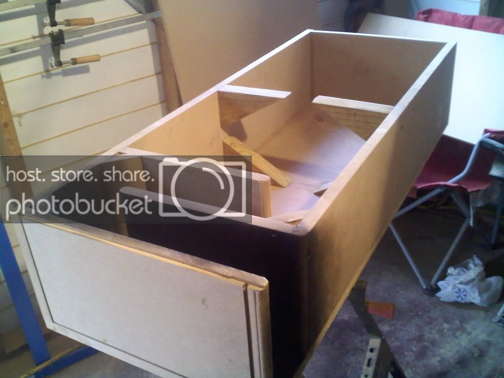

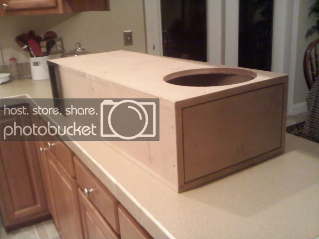

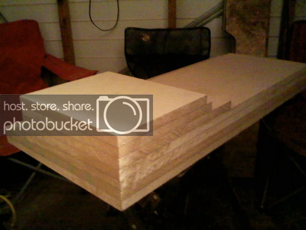

pieces...

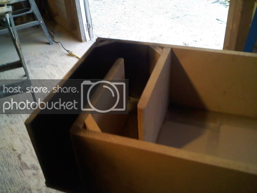

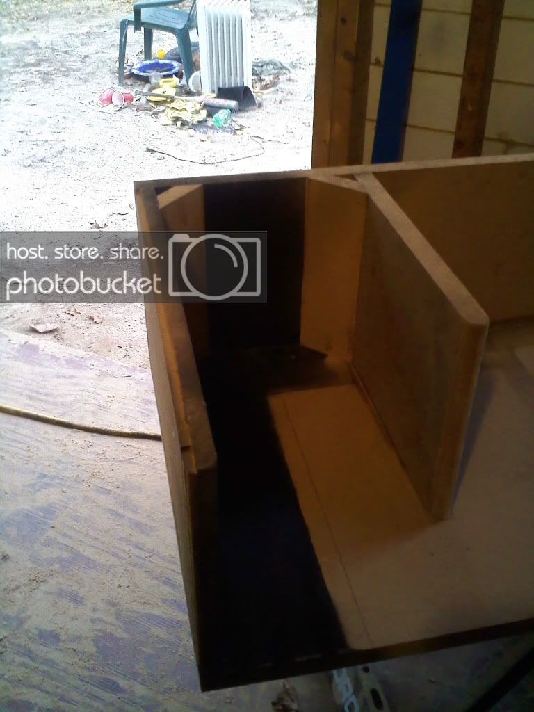

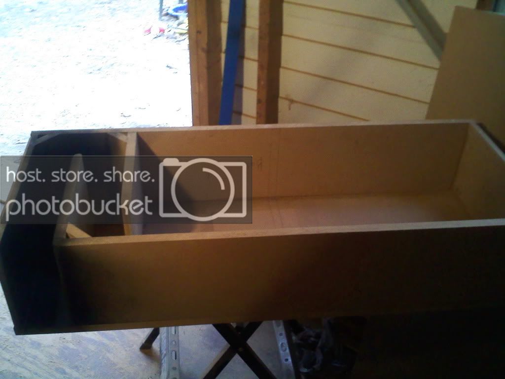

assembling and painting the port
45's in the corners

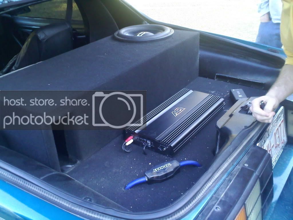

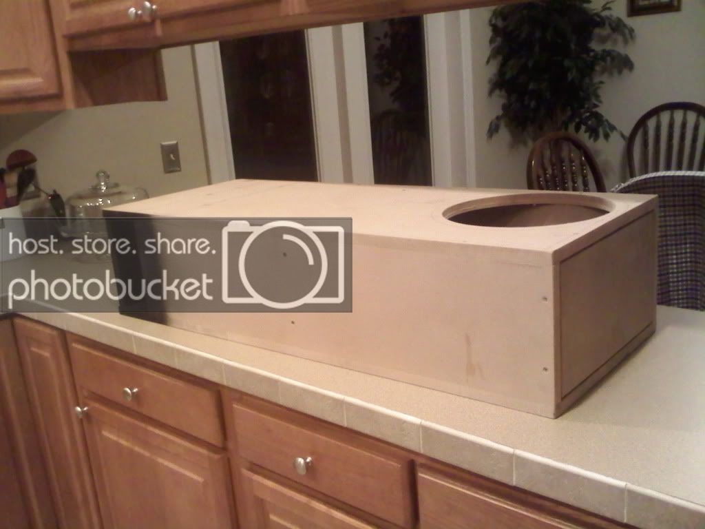

well it wasn't too clean in the car (had a lotta wire shavings everywhere).....but as far as sound goes, man this 12" got down.....before, he had a 12" AQ on the same amp, and it was very loud running off of about 2000wrms (gains set with dmm) and port firing up with sub, instead of to the rear like now.....but this btl is only running off of about 1500wrms and it is as loud if not louder than the AQ...i'm thinkiing firing the port to the rear did the trick....after he upgrades his electrical, i told him we'll crank it up to its full potential...
