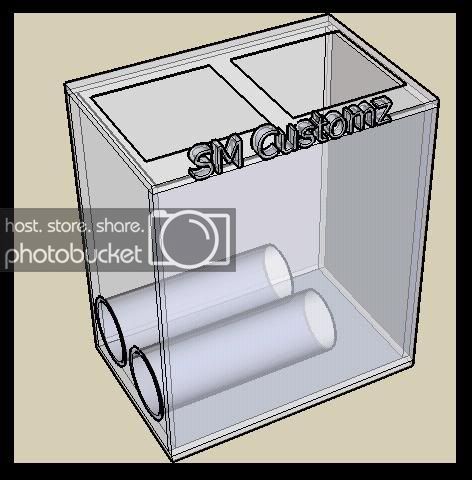

each sub will get around 3-3.25ft^3. i will have more precise measurements once i design it.
you can choose what you want the tuning. i was going to do either 32or33, but its up to you.
idk which way you would want the ports to fire. they can either be on the front back left of right.
i can get your a price quote after we get all the little details worked out.
for now, i will make a design and put it into a sketch for you.
let me know what tuning and where you want the ports firing.

ok subs will need to be facing towards the roof i suppose unless i should have the subs facing towards the windshiled and the aeroports facing the roof w/e will be the loudest and tuning the same for that what ever is the loudest
~5.75ft^3@34
That volume takes into account some bracing as well. Including a double baffle.
Whatcha think?
~5.75ft^3@34
Whatcha think?

not meaning to sound dumb but whats a double baffle
and also whats the price looking to be for this build
and one more thing i forgot to mention towards the back of the box there has to be a 2-3 inch cut it it bc there is a little hump in the floor when i remove the console i will take pics and get the exact spot it is
and if u can shoot the design in my messages so i have it for later once i get the subs and amp so i can make sure i am able to get u to build it for me
thanks
double baffle means that whichever board the subs are mounted to is double up. so instead of 3/4" of support, you have 1 1/2".
im glad you tell me about the little hump now haha. no big deal we will figure somethin out.
