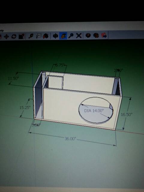

lol im sorry. I would say 30hz if that's any good or what would you recommend ? I want push 1500w into it or whatever my incriminator can throw at it.
these can go very low.
I just saw in the thread you posted rap r&b so 30 is too low. 36-38 would be much better. I'll model something up for ya. To get a quicker response on here use the "reply with quote" when you reply and I'll get notified of the reply.
Sent from my SCH-I605 using Tapatalk
OK thank you . I also like my reggae and dub so thought 30hz would drop nicely.
Would the tuning you recommend also give me those wobbles n lows.
Reggae rarely evergets below 35hz. Tuning to 30 wont get you anywhere your music choice
Excellent. OK I look forward to your help //content.invisioncic.com/y282845/emoticons/smile.gif.1ebc41e1811405b213edfc4622c41e27.gif
5 cube, 75-80 square inches of port 24-28" port length. That would be my go-to for low-ish tuned single 15. Go smaller if you need, keep big port area, and lengthen the port as needed to maintain mid 30hz tuning. If you need to play whale songs you'll need to tune lower and will probably need to sacrifice port area or it'll be the port taking up 50% of the gross volume of your box.
Thanks again. Can I use the re box calculator now to get the dimensions and cut sheets. I have no idea how to use any other programme I'm afraid. I'm just good for the building lol ?
I've never used the RE calculator, so might want to double check any math it gives you, a lot of folks on forums report that it's not accurate. That said if you KNOW your volume and port width/depth it's probably adequate to give an accurate cut-sheet. Also if you're off by say 10-20% on any dimension you probably won't even hear the difference.
Hey thanks for all your time. Let's get to building.
Download torres box calc on desktop or Xplicit audio app, these are more accurate. I have one sketched up already that's 3.5 net tuned to 36 if you want to use it.
Yes. I'll download those. If you could give me your sketch up with cut sheets that would be excellent Thanks. I'll play around with it.
I'll get you the cutsheet. Pm me.
