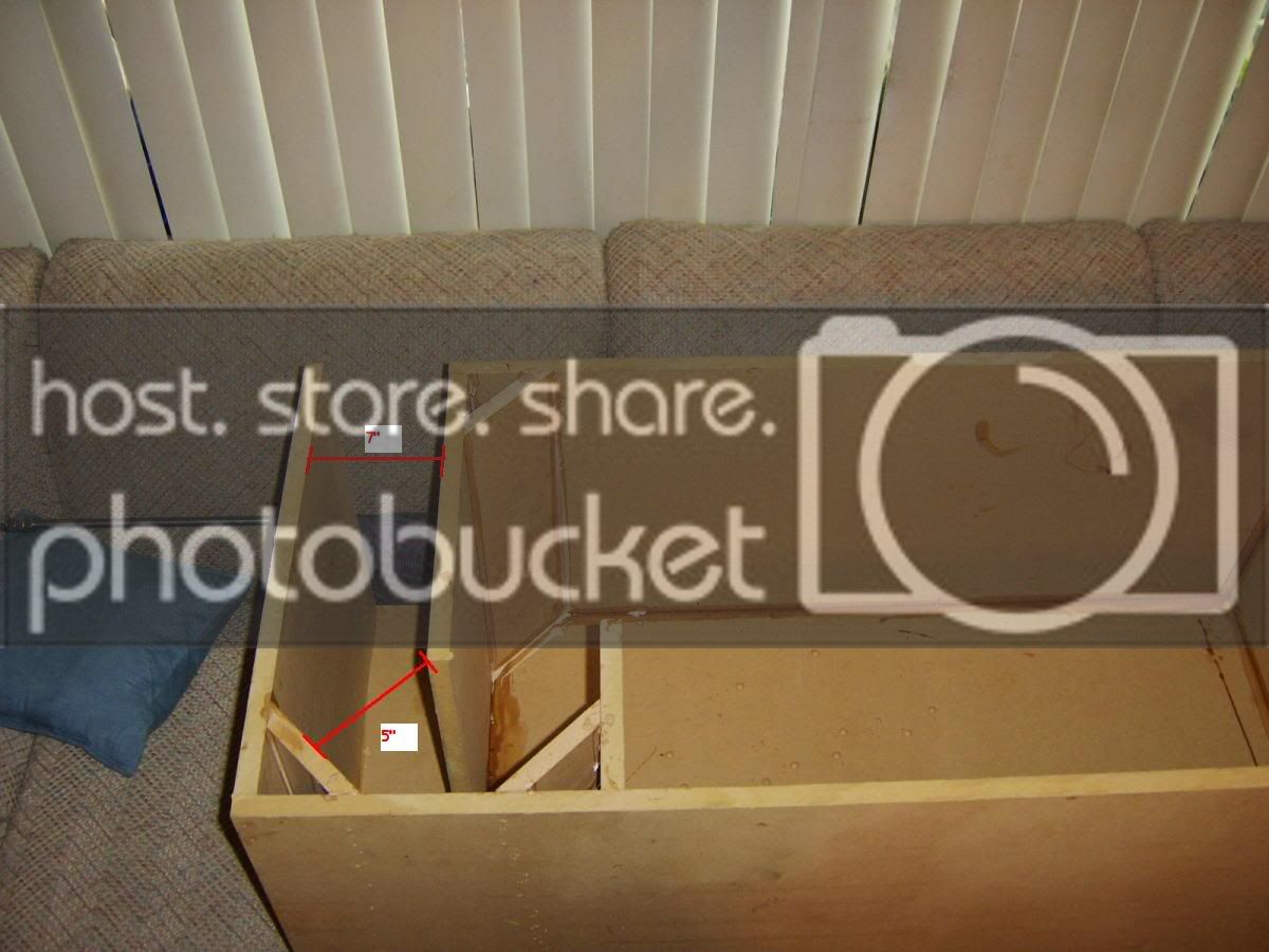

Well i use AutoCAD to design my boxes so i can acutaly draw a line down the center of the port, yes thats how you determine your port length,,,, u use the 45's that large because from the angled face of the 45 to the port bord is 5" which is my port width if i didnt add the 45's from the corner of the box to the port port is like 7" .... but its all in how detailed you look at it i think putting 45's in to make the port the same width through the length of the port is good and it adds for good airflow
alright, let me try to get this straight. From the 45 degree angle face to the wood it is 5". Then the width from the front view of the box would be 7". So what would you use to calculate the actual port length 5" or 7"???? I hope i am getting this, lol:eek: . Here is the pic that you posted earlier, to show you what i think you were talking about...is that right?
the enclosure looks good. if you realy wanted to get the best airflow out of that port, you should of gone with the L shaped port. every time air has to do a 180* turn it slows down and the result is lower port tuning and not as linear. the best port is always a strait port, so is best to go with the lest amount of bends.
