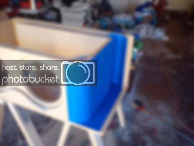

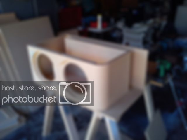

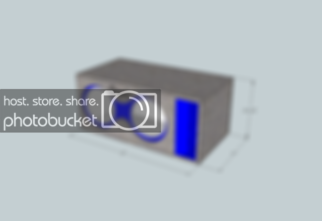

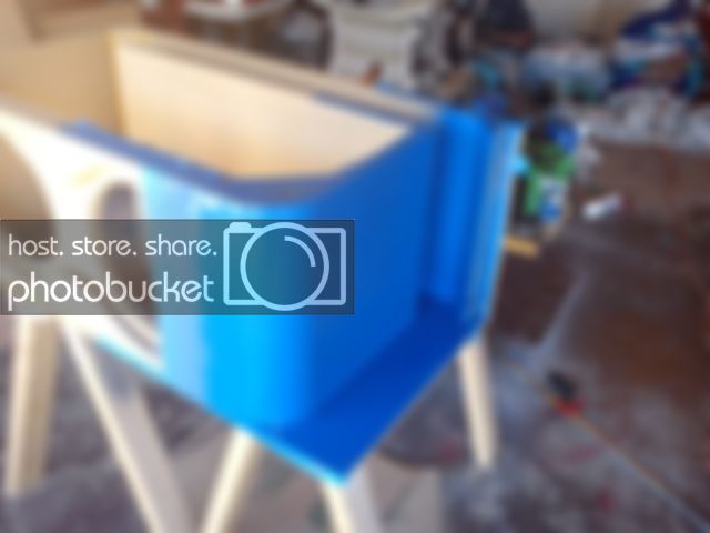

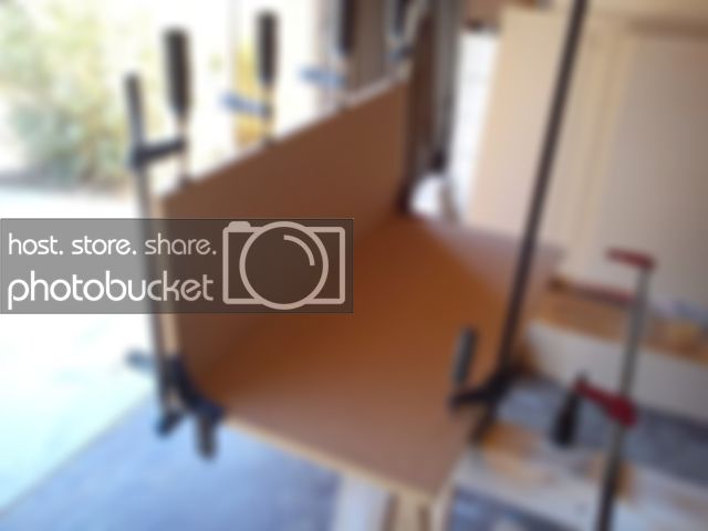

Box is for two SKAR VVX-10's they will be getting 1k rms EACH! BWAH! hence the size of the box. its 2.25ft^3 @ 30hz iirc

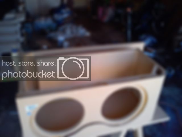

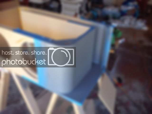

Back is on

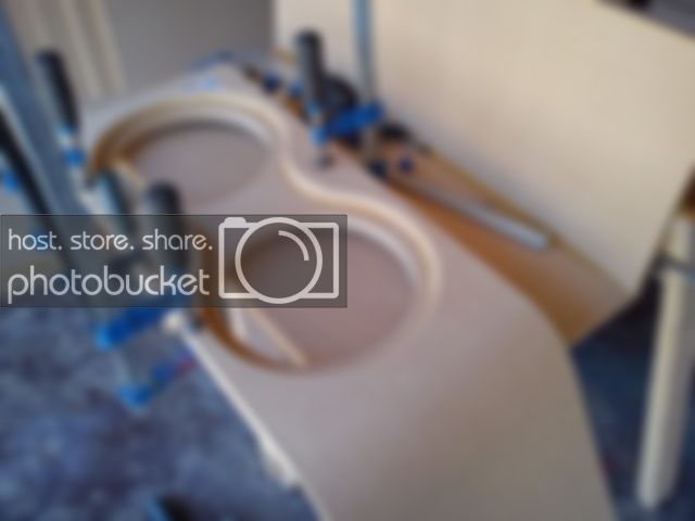

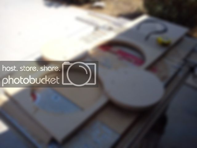

baffle #1

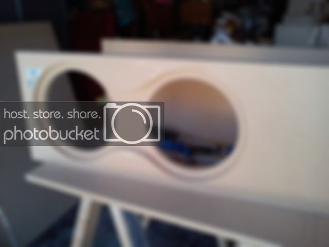

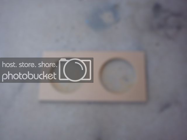

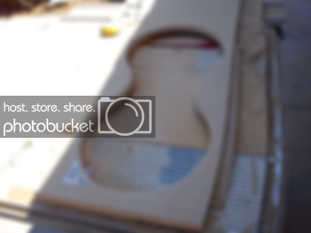

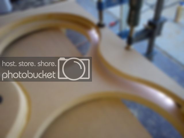

Notice in the design the organic shape of the baffle? well here is how you do that.
using the cutouts from the first ID cutouts line them up and screw them into the BACK of the baffle! that way there is no holes on the front!

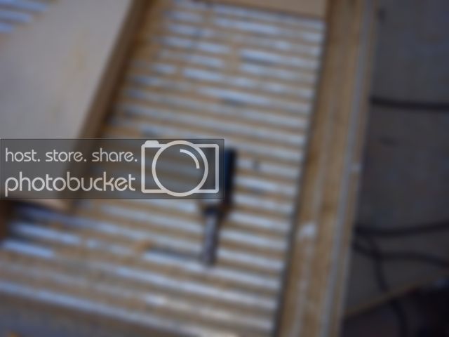

then use a bit like this on your router.

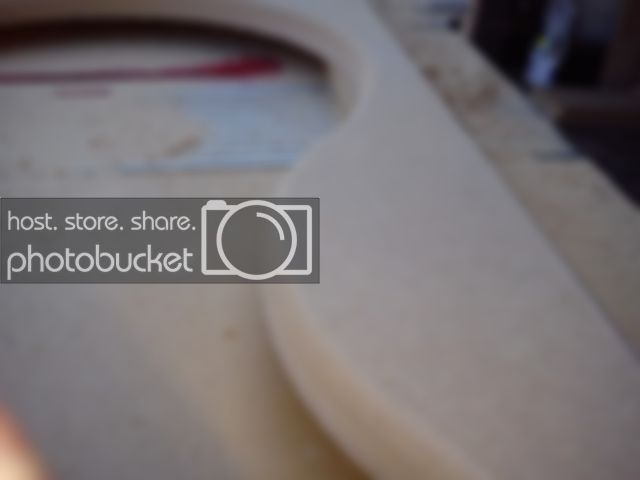

run it along nice and slow. keep a steady hand and you should get a little something like this when done
nice roundover done

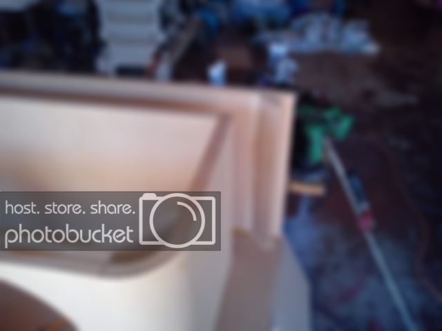

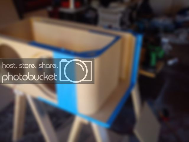

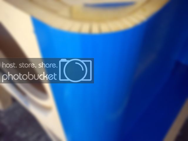

This build will have WHITE led's also to add a little subtle glow to the subs. i did so by using the same router bit (trim bit) and a fence secured to the back to cut the notch for the LED strip that i make. then i used the same router bit and trimed away the excess on the little hump so the LED's can shine through
