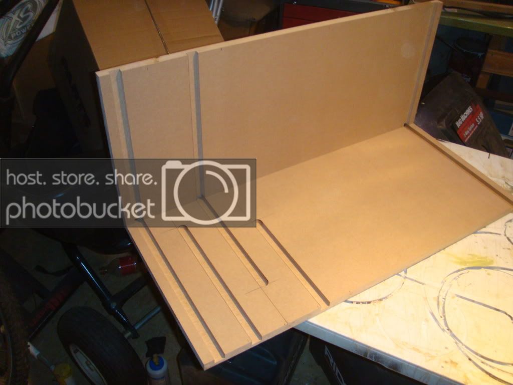

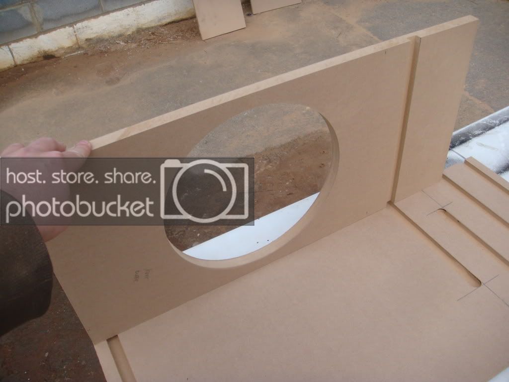

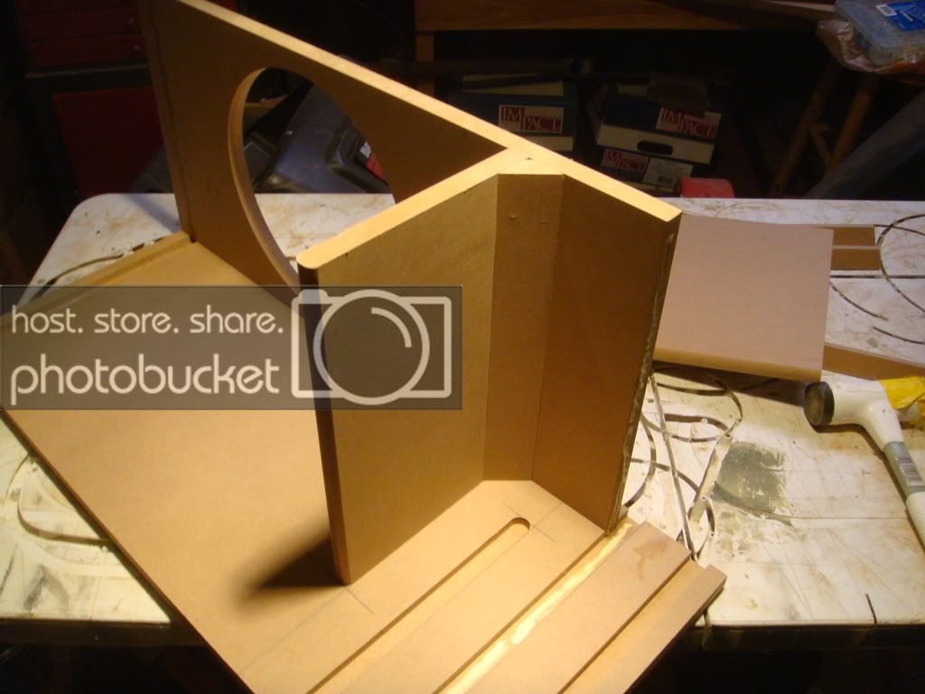

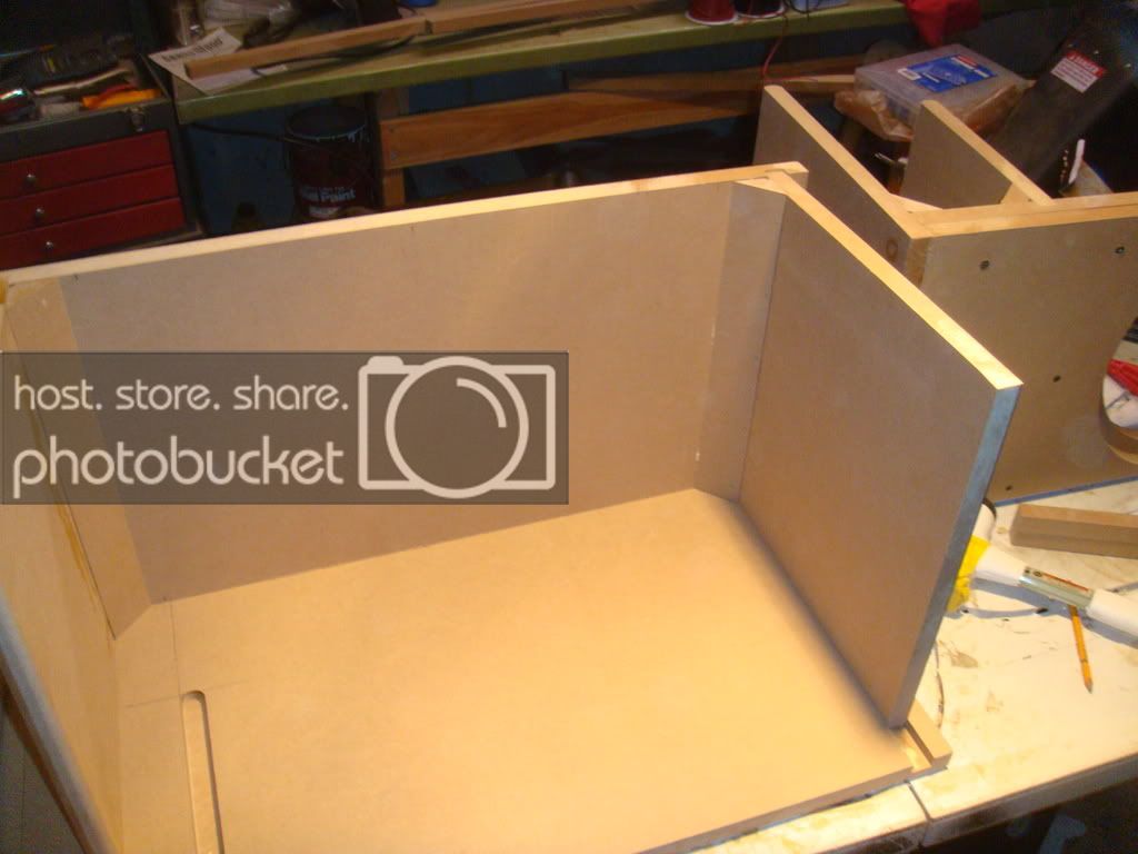

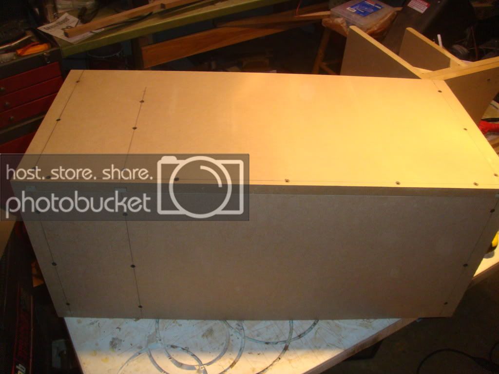

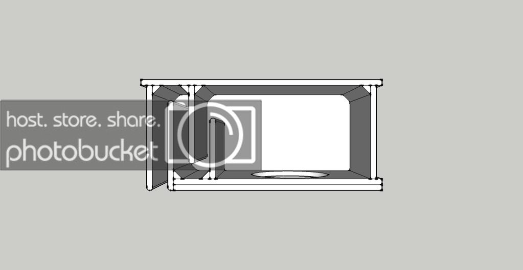

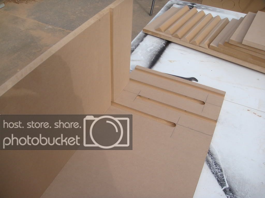

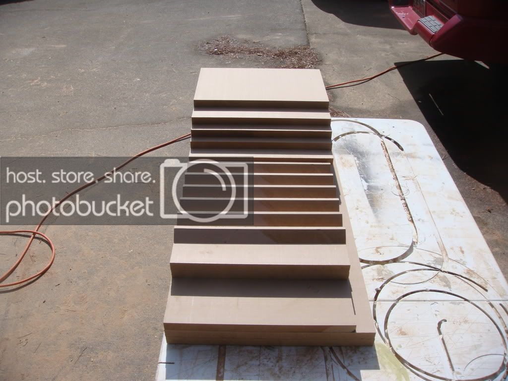

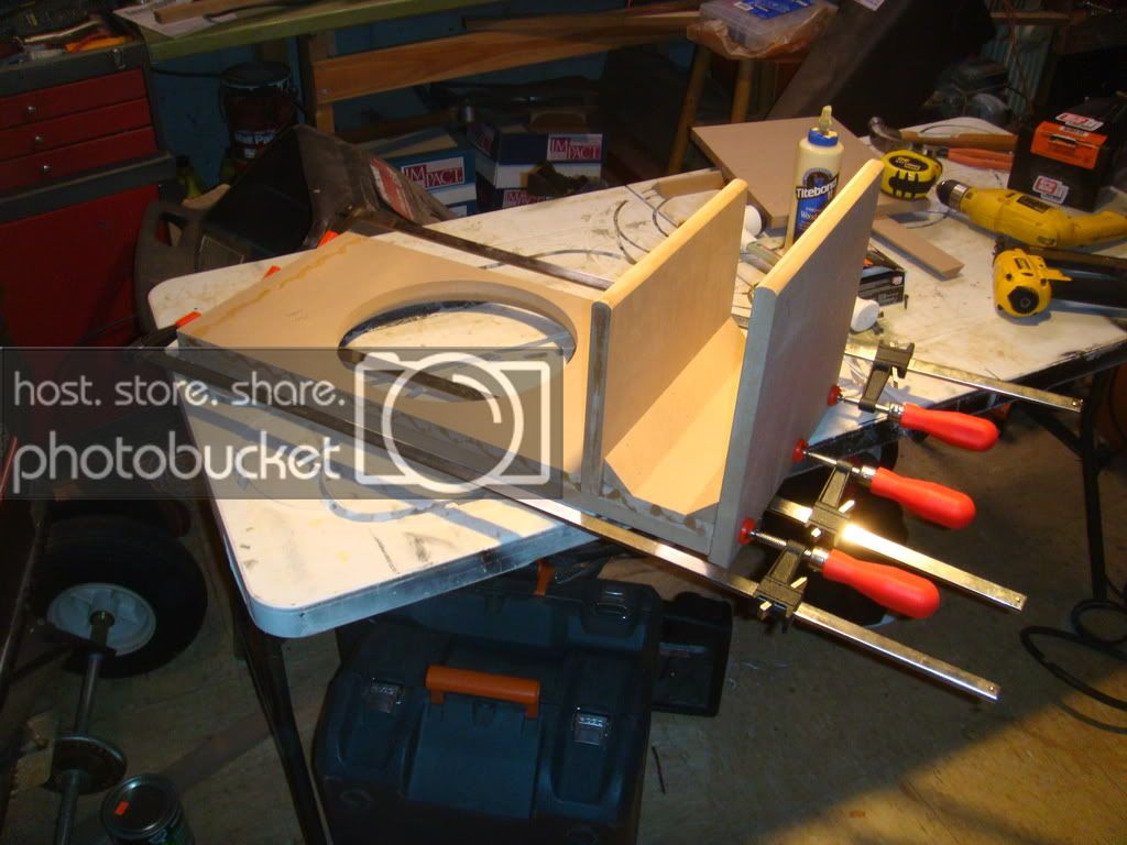

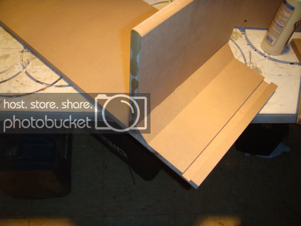

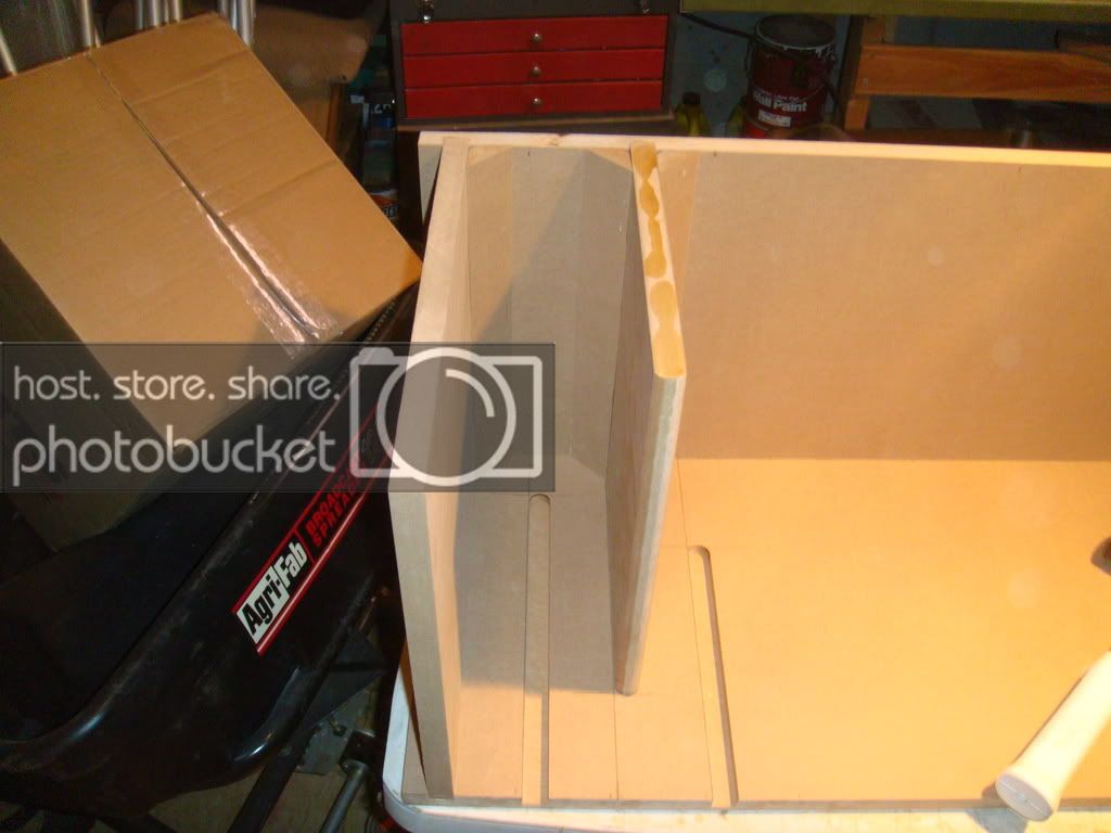

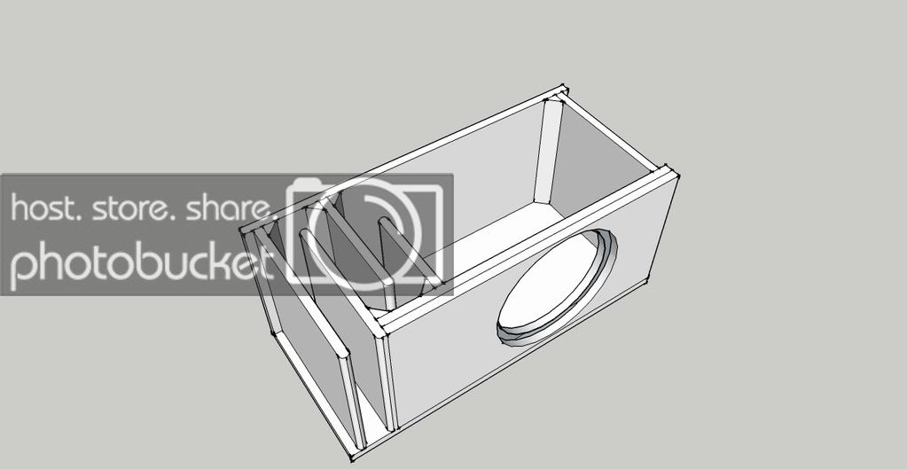

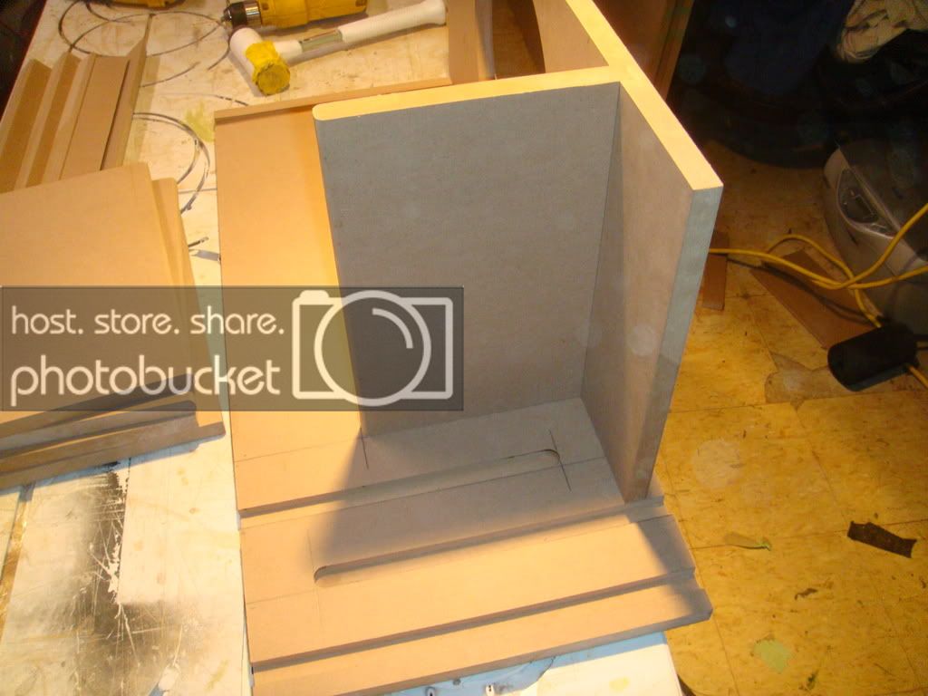

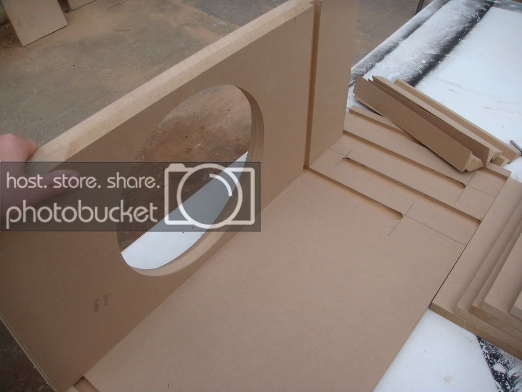

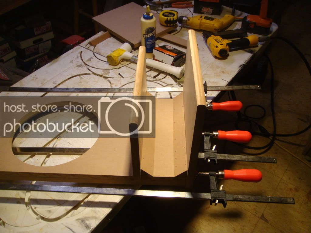

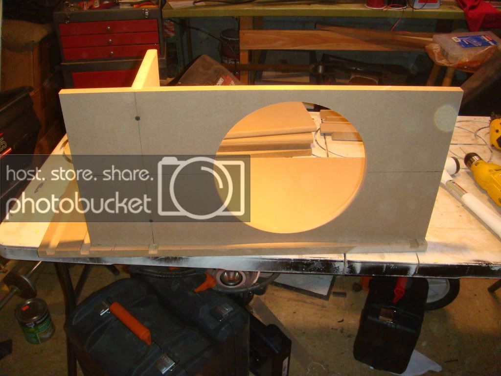

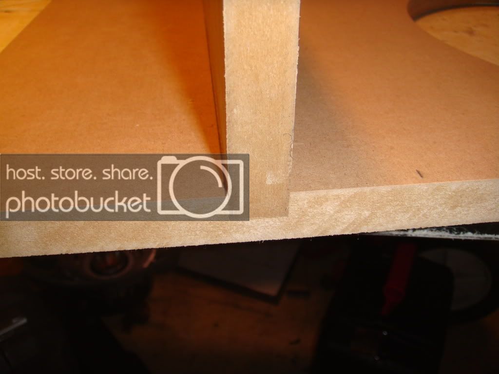

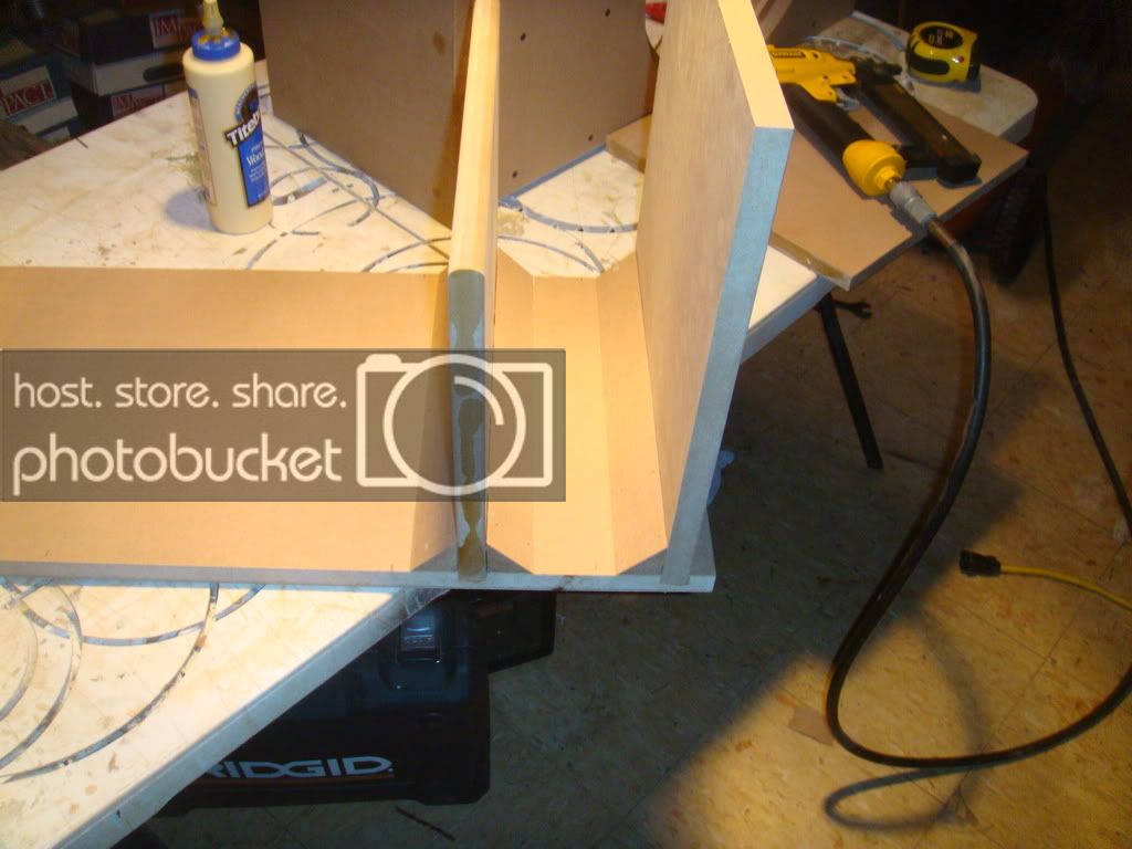

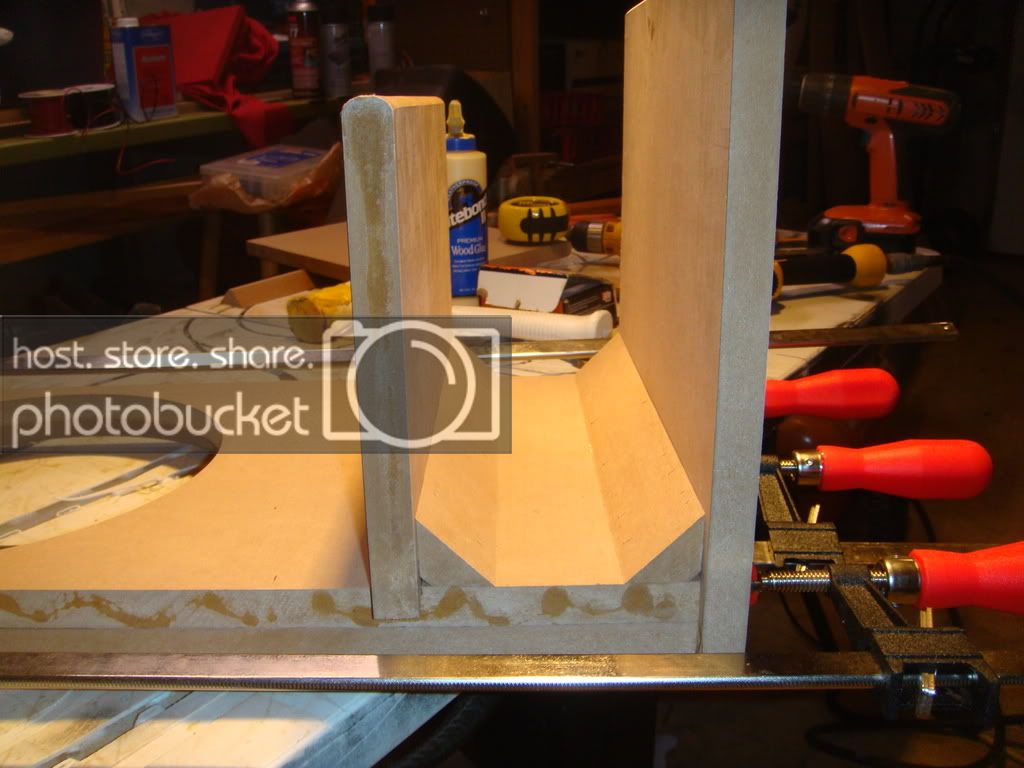

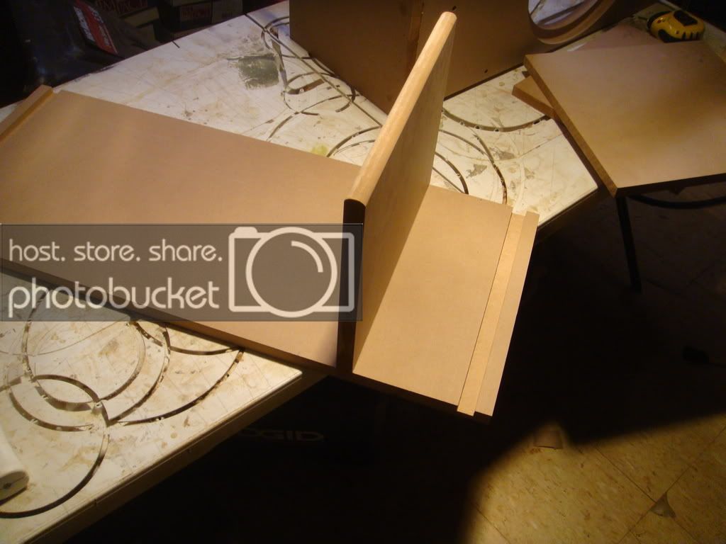

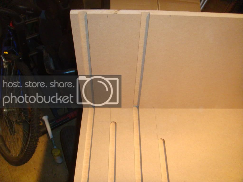

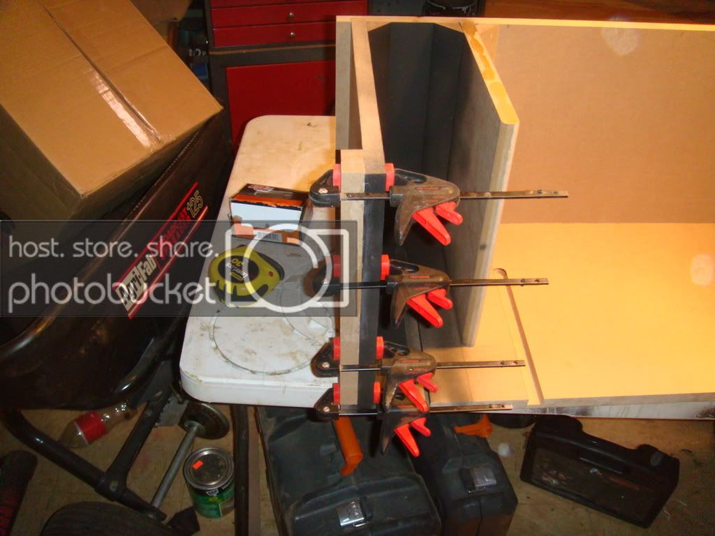

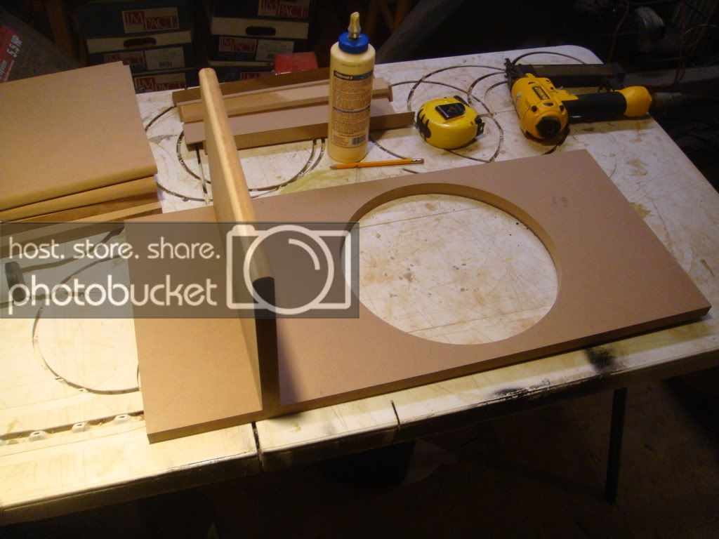

Ok everyone build is for Zman3's single 12" Fi BL. This will be going into a 99 BMW M3, so space is tight. The box is 2.0 cubic feet after all displacements. Box will have 28 square inches of port tuned to 30Hz.
Here is the design...........
i hope hes got some power for that bish.. that box is very small he should down grade to a bl it will probably do a lot better
Yep, the box is for a BL. //content.invisioncic.com/y282845/emoticons/biggrin.gif.d71a5d36fcbab170f2364c9f2e3946cb.gif

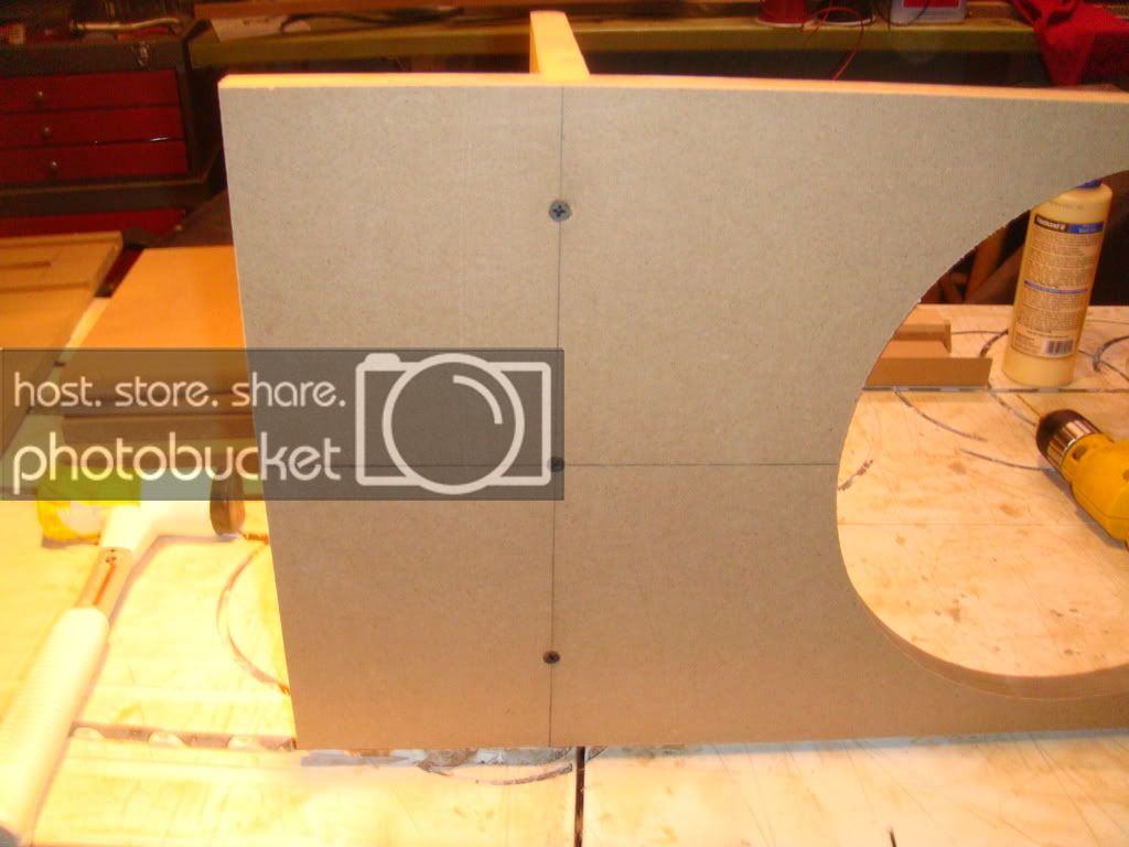

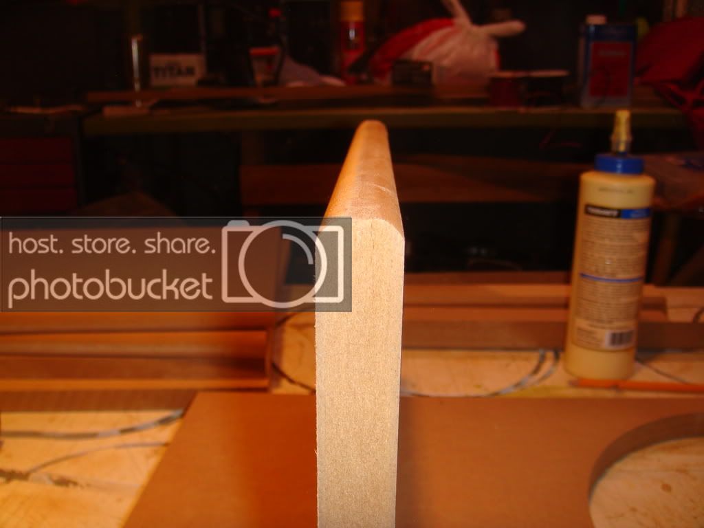

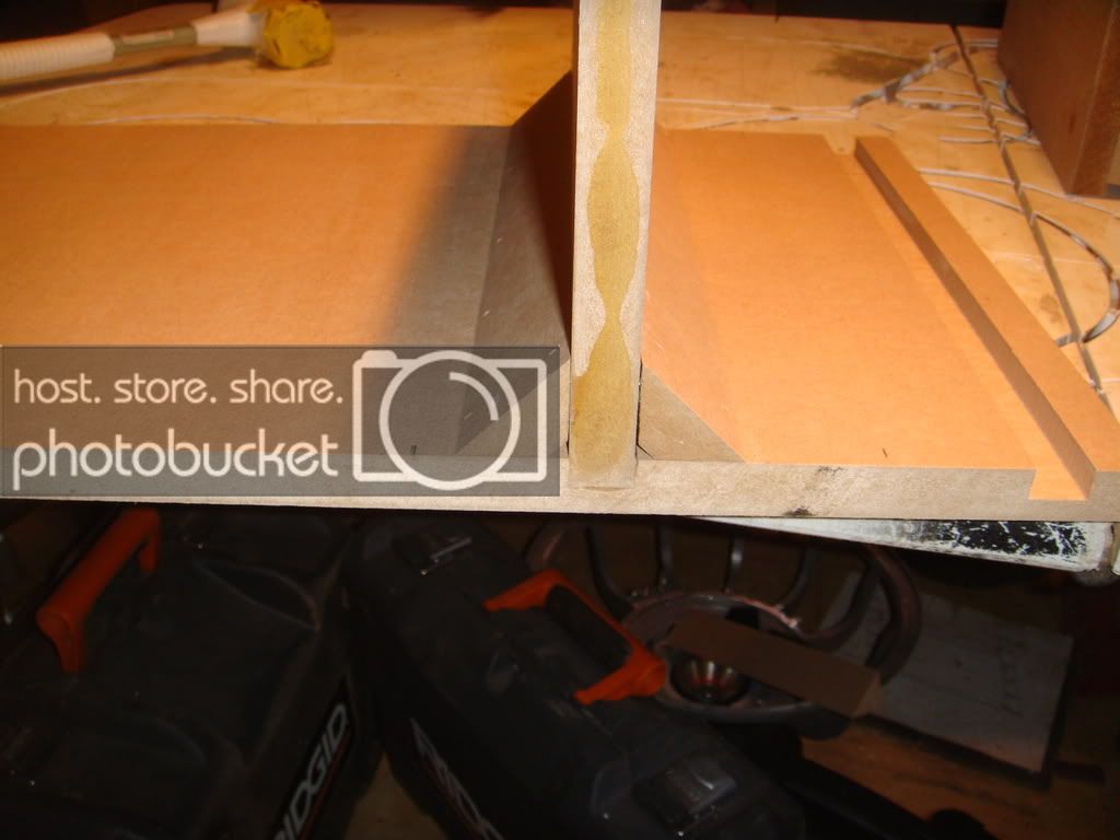

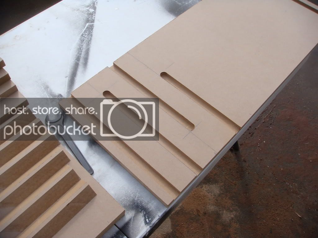

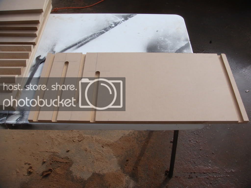

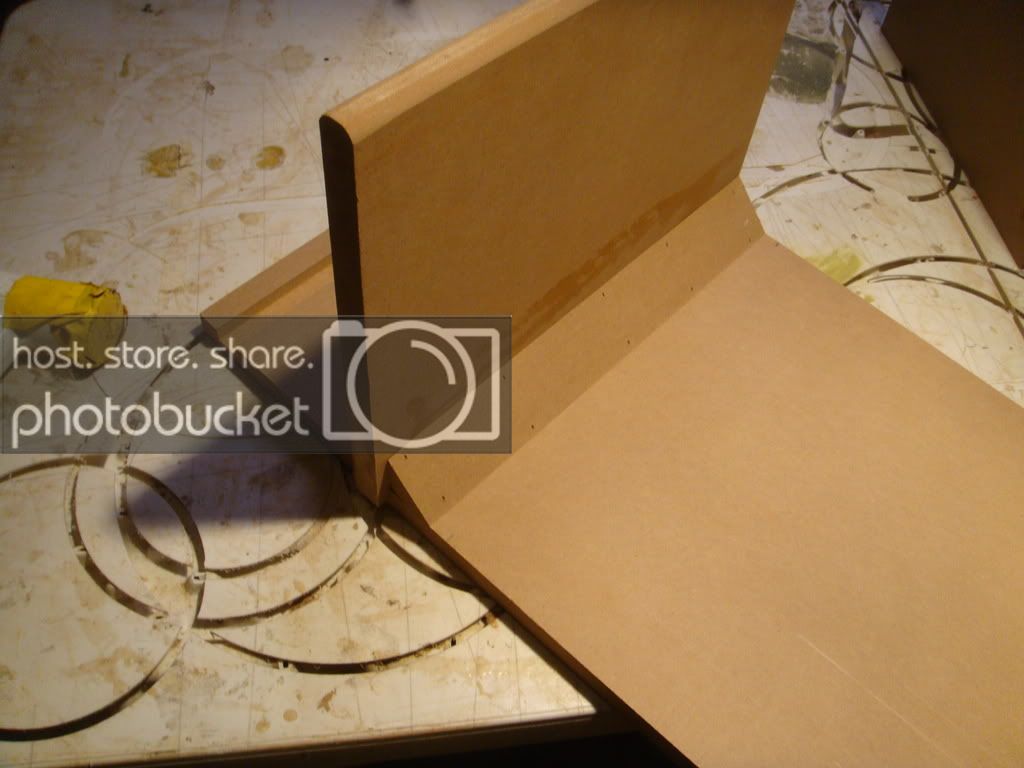

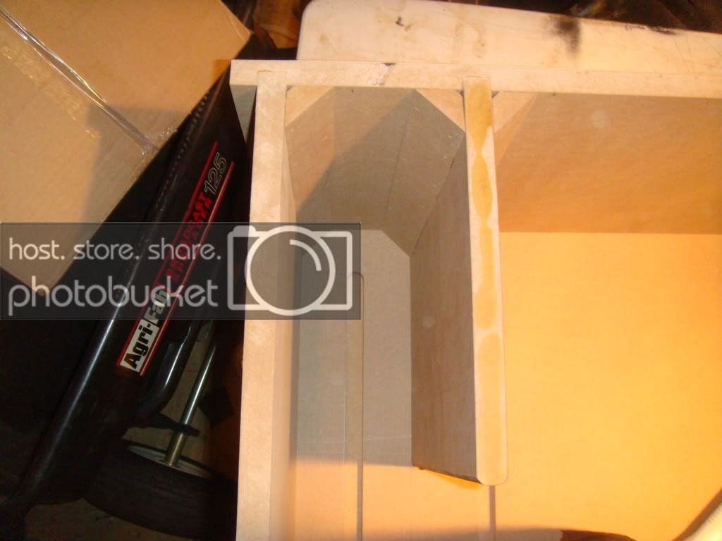

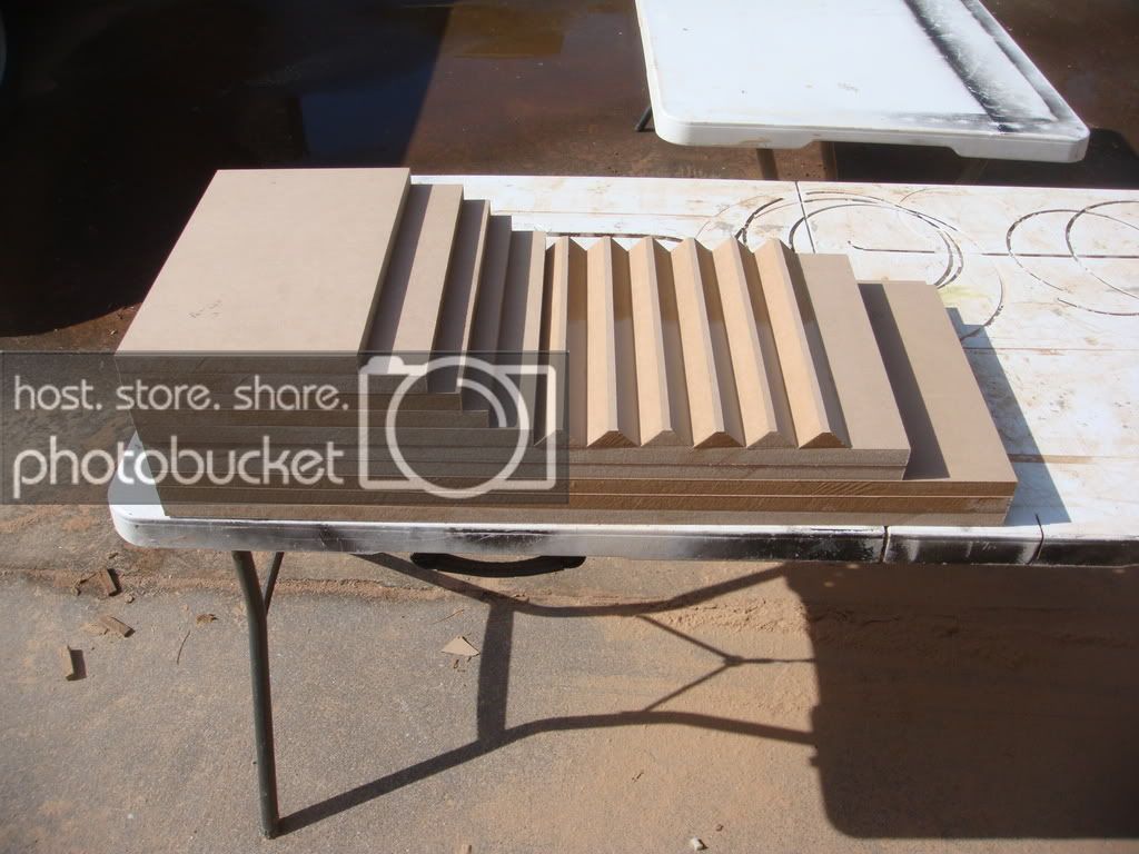

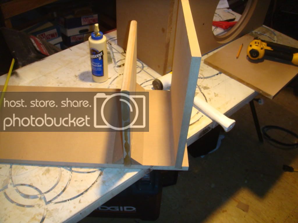

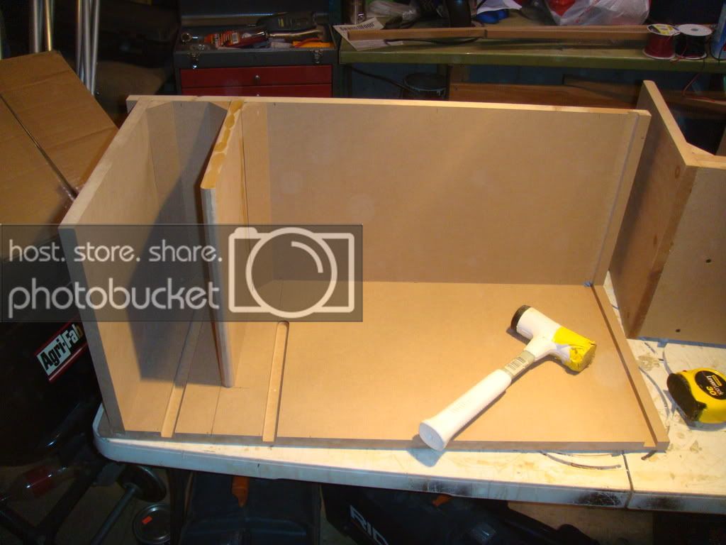

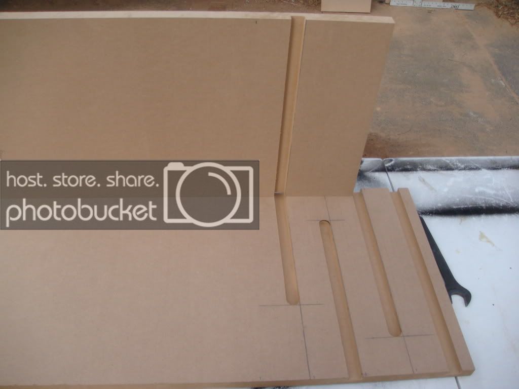

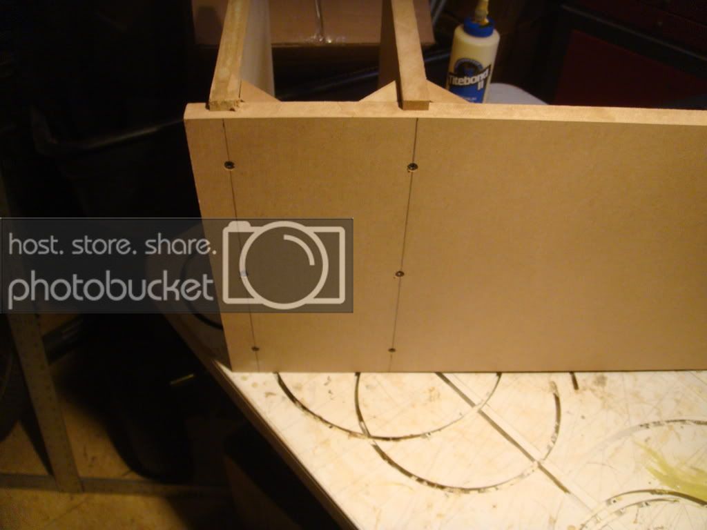

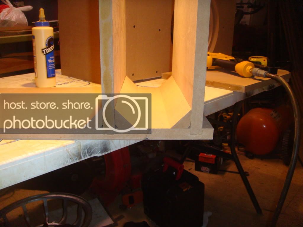

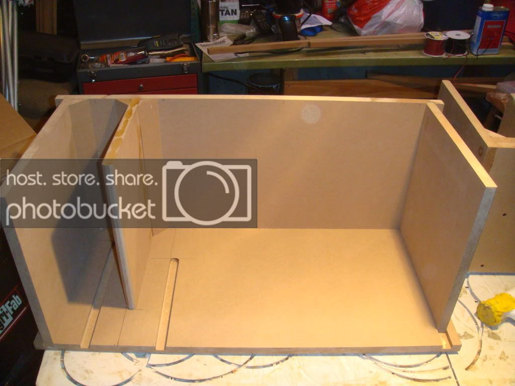

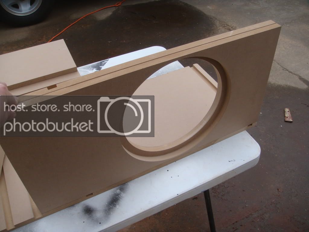

I love that inter locking design. Usually I laugh at boxes without screws. But this one is extremly nice, and should hold together quite nicely.
Thanks, yep I am the same way, there is olny so much wood glue can hold so thats why I use screws as well.
