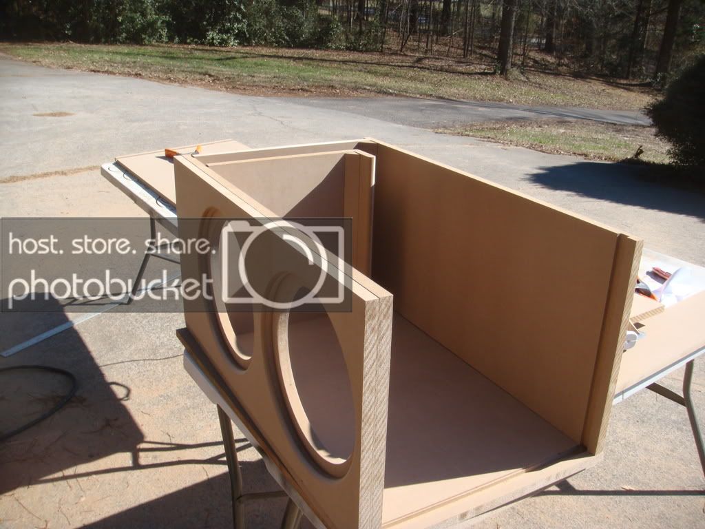

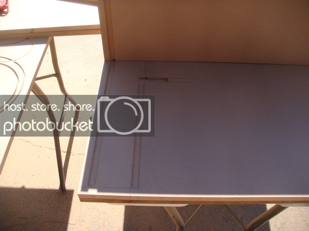

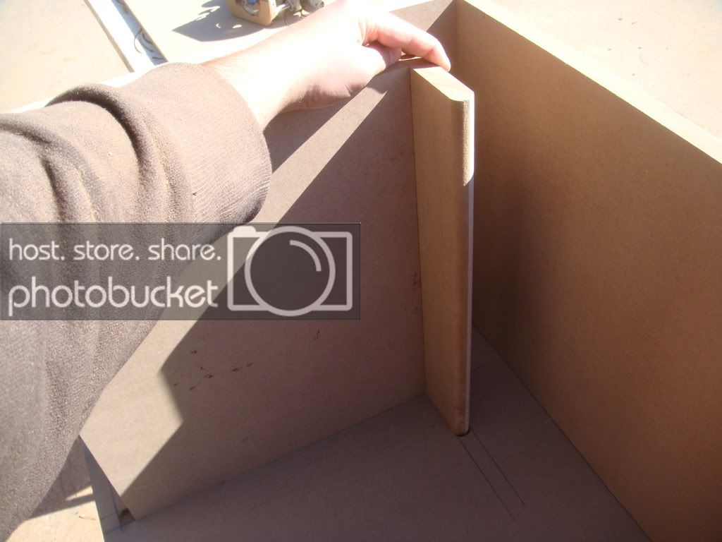

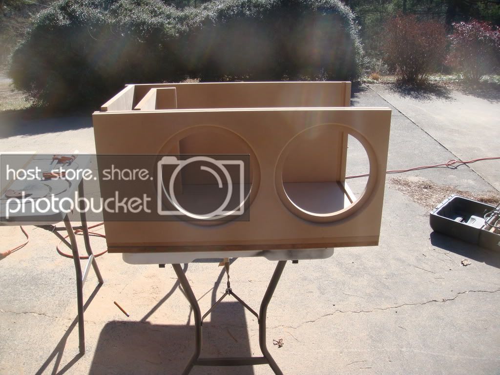

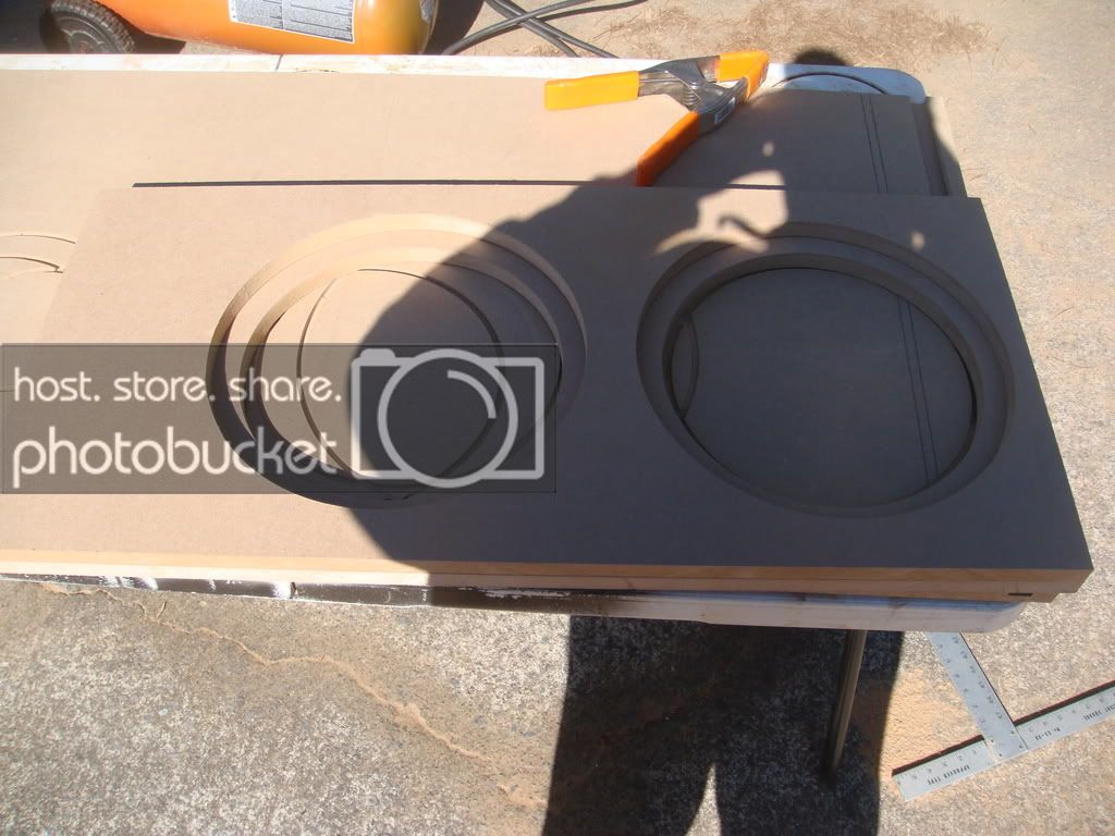

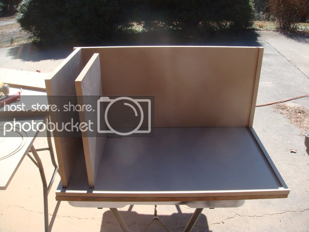

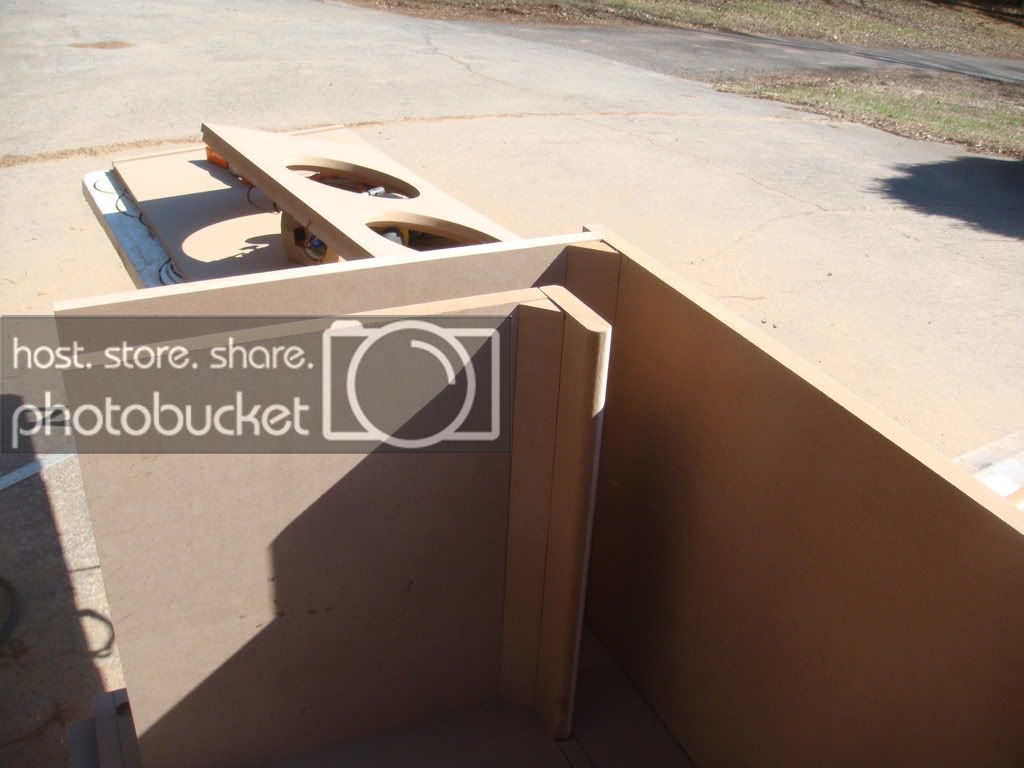

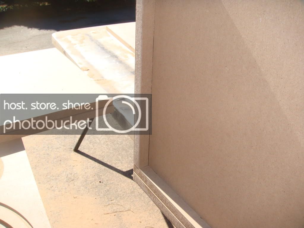

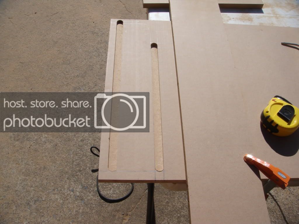

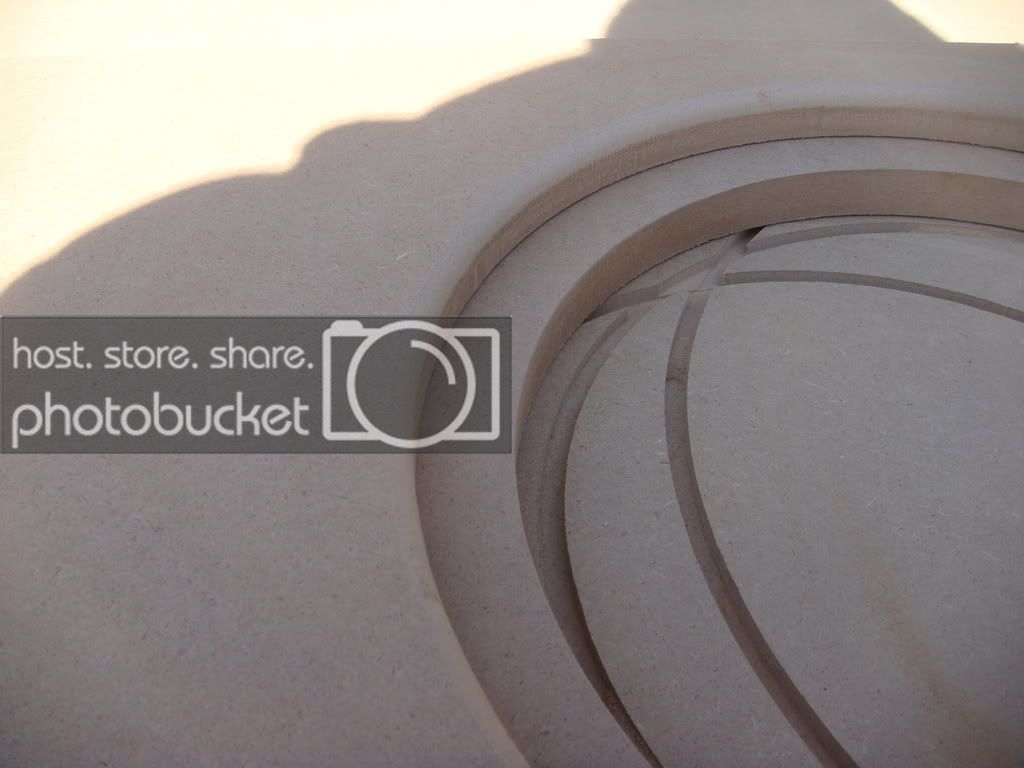

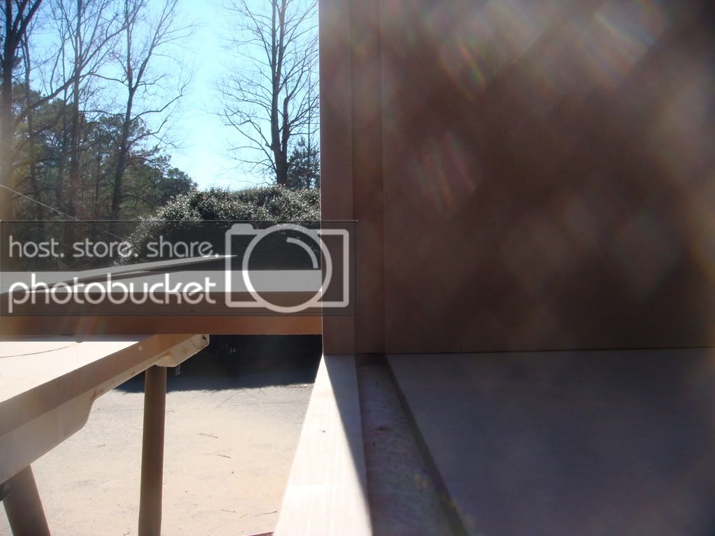

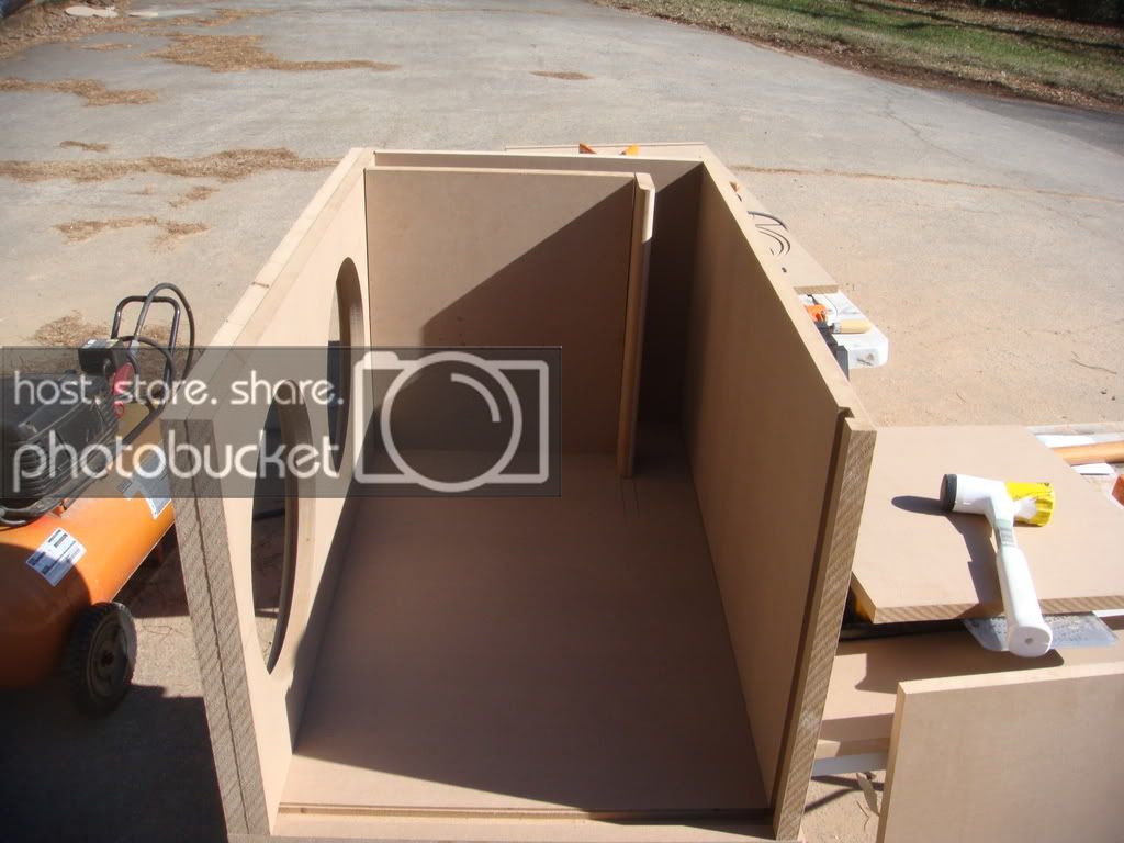

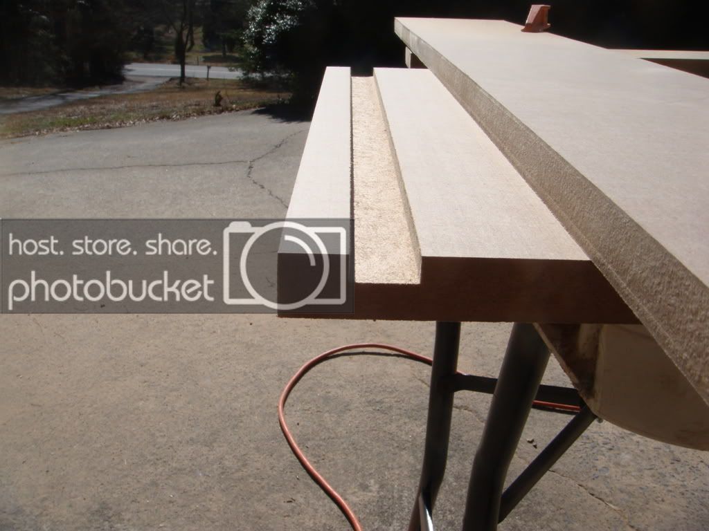

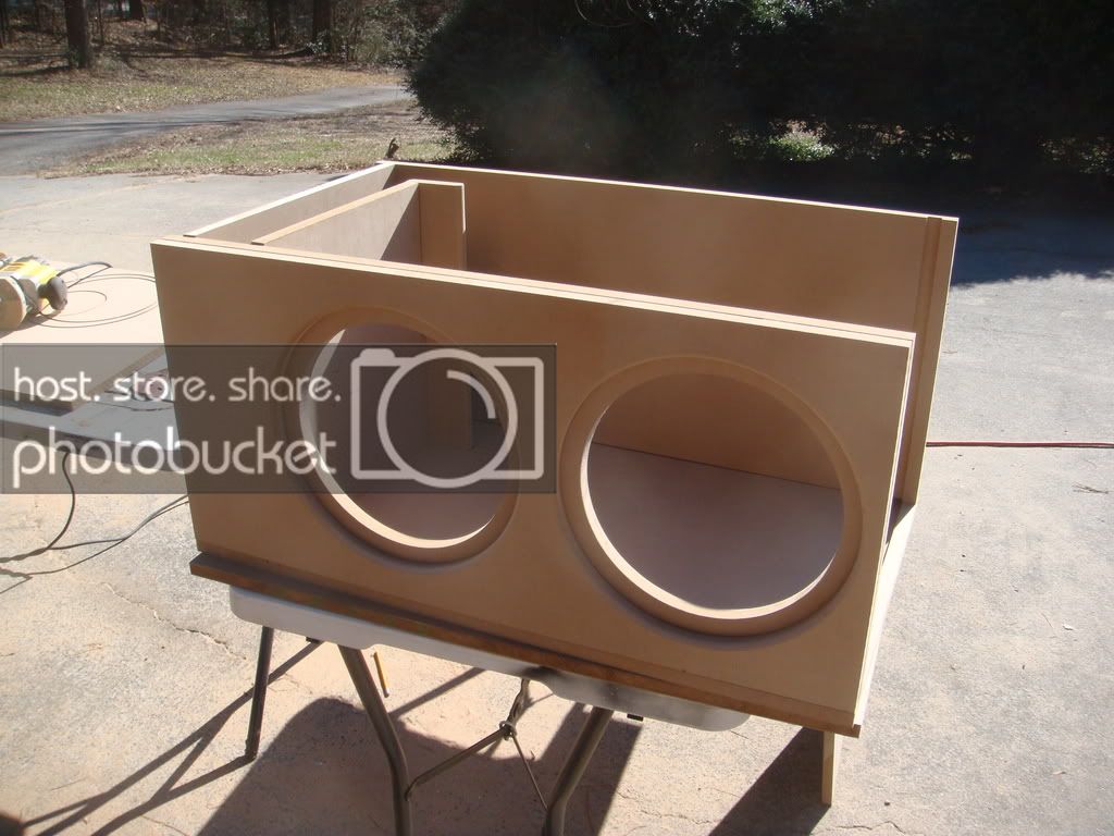

Ok guys I will be building a box for Zachfeen (caraudioforum.com) two 12" Alpine type R's. Box will be 4.5 cubic feet with 45 square inches of port tuned to 35Hz. The box will be going into a 2003 Honda Civic hatchback. I will upload some pictures of the design here shortly. Stay tuned.................
Ok, after talking to Zach and he did some more measuring so this is what we got.
Box is 4.15 cubic feet after all displacements.
Port is now 52 square inches still tuned to 35Hz
He is the design......
