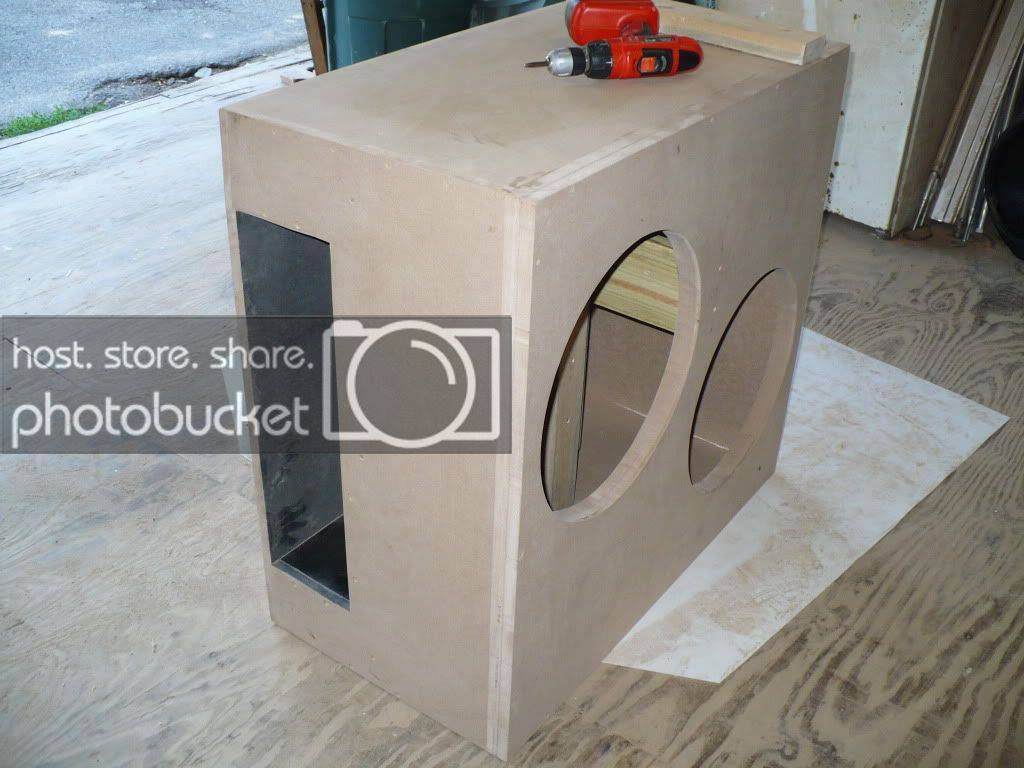

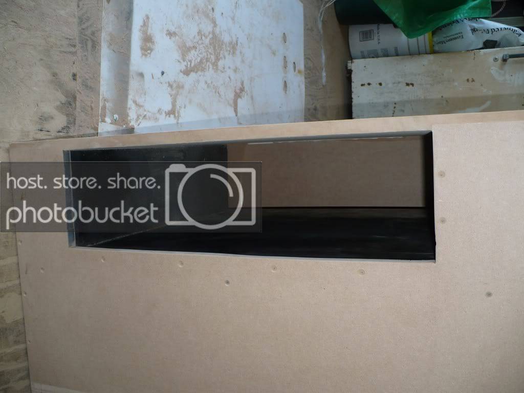

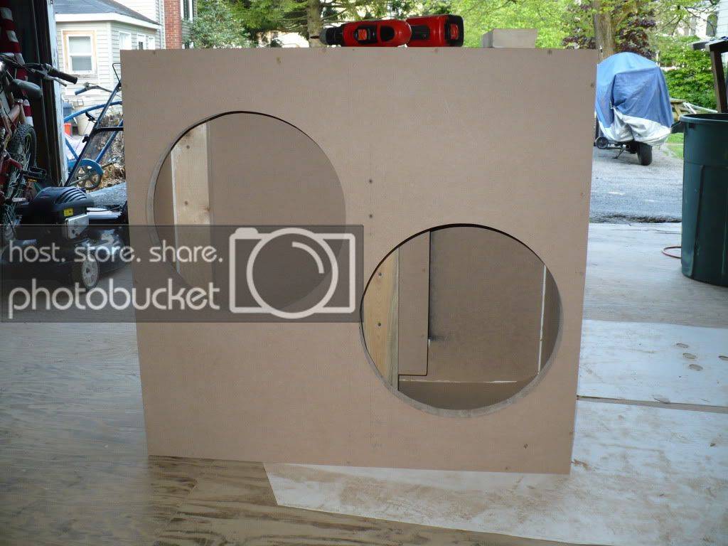

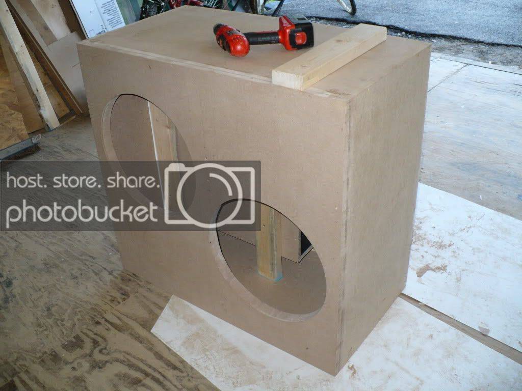

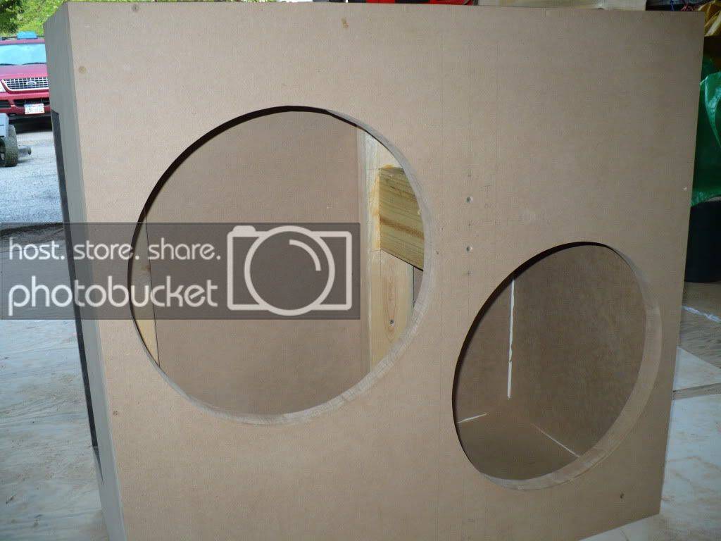

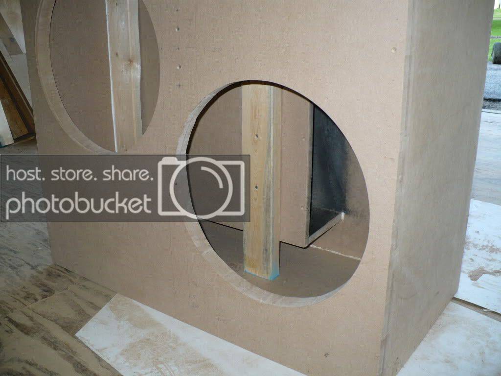

More pics. I need to add the last brace to the back wall. Do you think that is enough?
lol if you had to ask if thats enough bracing you have no idea what your doing im sorry
2 18in subs and the box is just 1 layer 1/2in or 3/4in mdf in spots id use no less than 2 3/4in layers on //content.invisioncic.com/y282845/emoticons/frown.gif.a3531fa0534503350665a1e957861287.gif
I have boxes for 8in subs that are built better and this is for 18s
come on man ever wonder why boxes that are prefab are so hated?
also your asking if more bracing is needed?
each brace takes away internal volume im sure you told yourself at this boxes build begining that you would leave enough room for however many braces others told you to install inside the box?
newsflash box started on paper at 4cft tuned at 35hz ended at 3.6cft tuned to 42hz, lol
lol if you had to ask if thats enough brasing you ahve no idea what your doing im sorry
2 18in subs and the box is just 1 layer 1/2in or 3/4in mdf in spots id use no less than 1 3/4in layers on //content.invisioncic.com/y282845/emoticons/frown.gif.a3531fa0534503350665a1e957861287.gif
I have boxes for 8in subs that are built better these this is for 18s
As I said earlier, the entire box shoud be double layered.
This was built with 1 1/2 trupan:
I've never built a box for two 18"s so you're right, I don't know how much bracing I'll need. This is a build for a guy who couldn't find anyone local. I'm hardly charging for labor.
I planned for bracing in the design.
This box is hardly prefab. You can brace a box well enough to not warrant double layered panels. I'm not saying my box proves this theory, but it can be done.
I would like to see your boxes that are better built. You're all talk.
