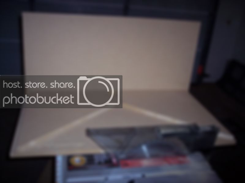

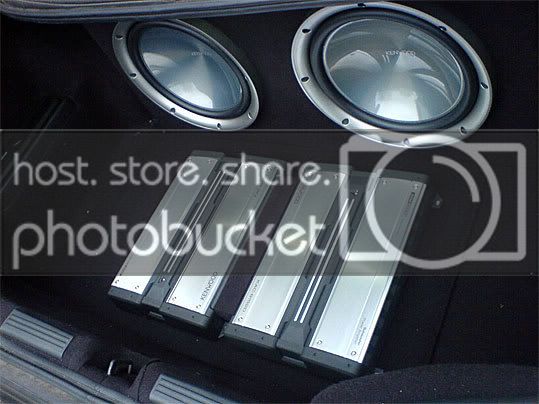

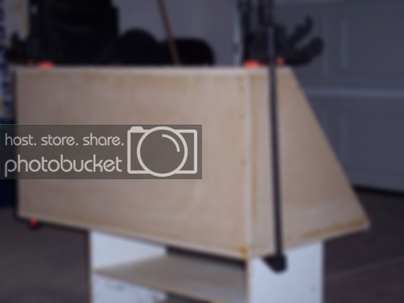

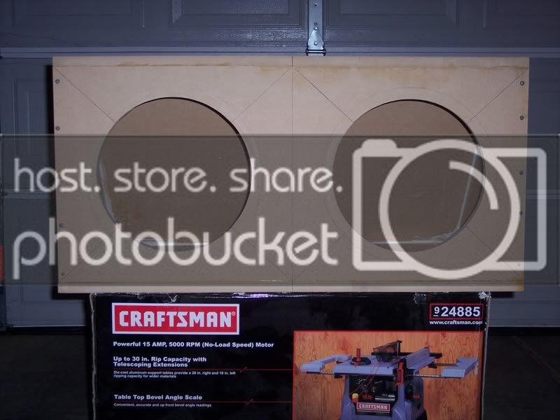

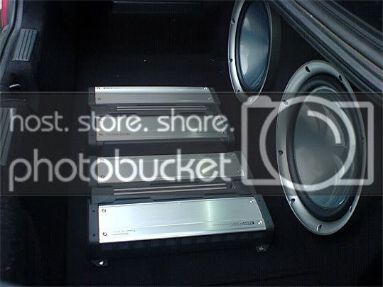

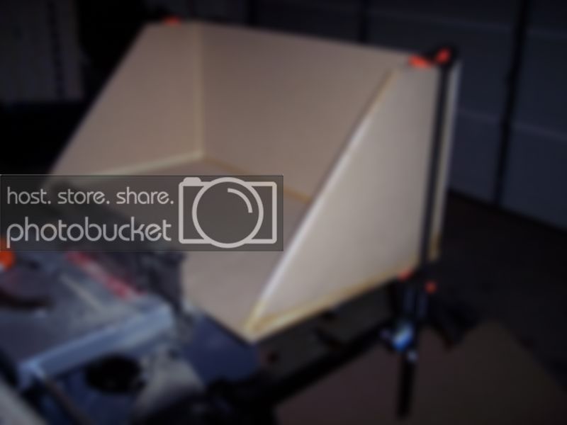

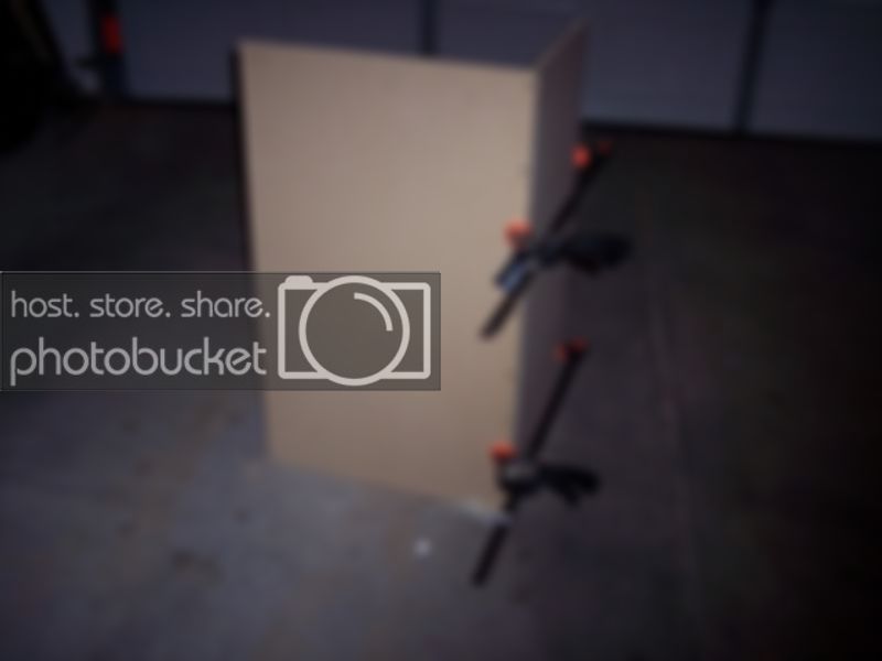

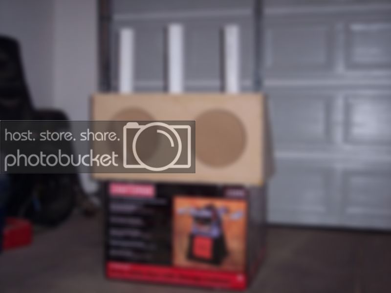

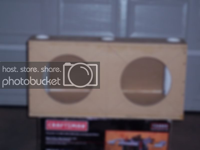

box build for VolkRacking. box is 2.95 cubes tuned to 36Hz for a 1995 Acura Legend Sedan. 2 12in Kenwood's
Originally Posted by jmanpc
thats a small enclosure for 2 12's
that is as much space as he was willing to give for the box. manf recommended 1.5cu ft per sub. it was 2.95 after displacment of ports and subs
Originally Posted by Immacomputer
How much clearance did you give the ports from the bottom of the enclosure? It doesn't look like much....
hard to tell from pics but clearance from ports was at least 4 inches. box height was 18 inches and ports were 13inches
