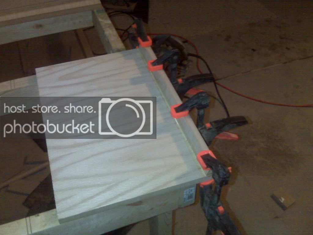

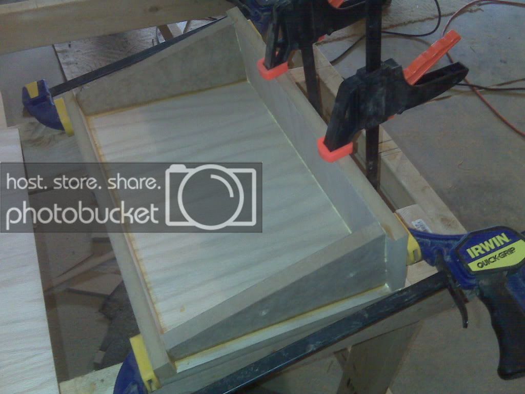

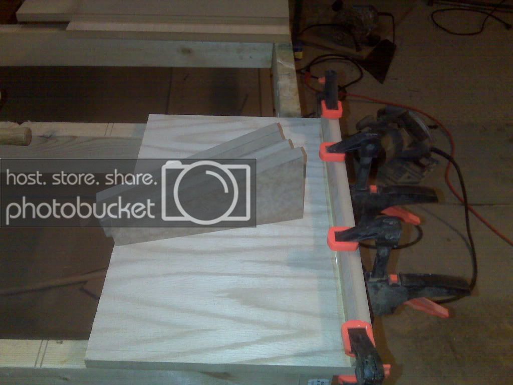

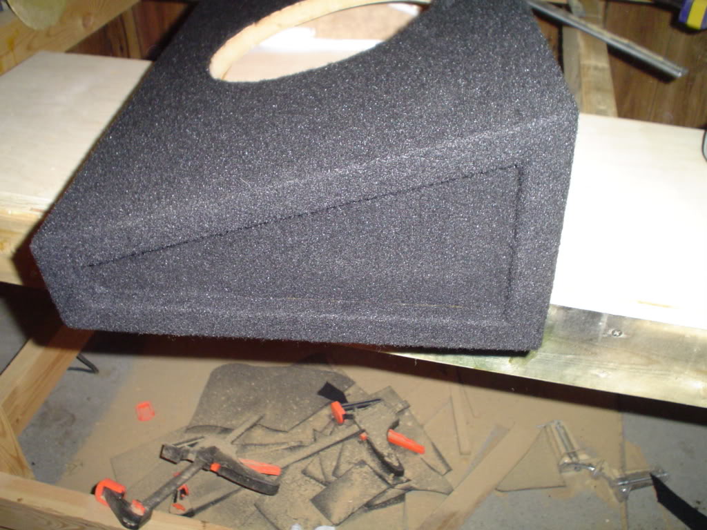

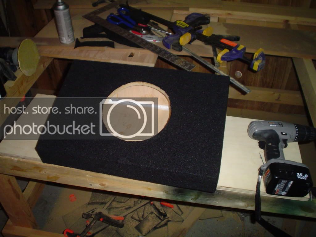

Build for Xyxyll for his MR2. One box is finished ...still need to make the other one
looks nice. is that birch?

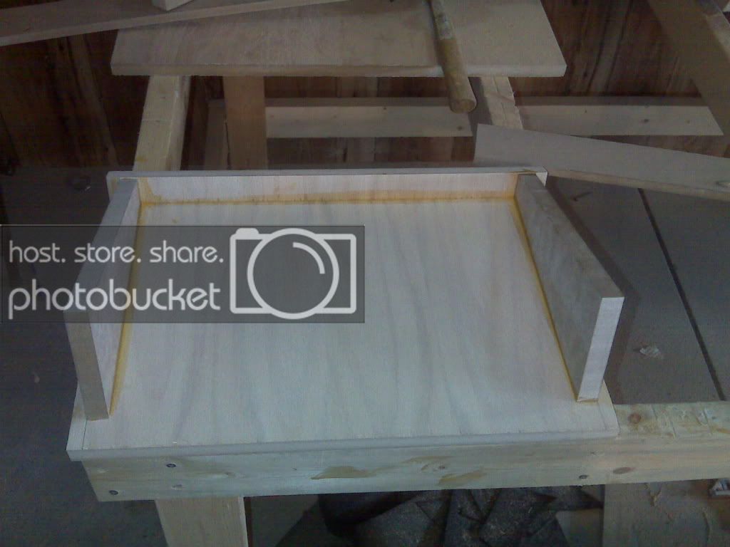

no its actually mdf with oak veneer.....they ran out of the smaller sheets of MDF and i didn't have a truck available to score full sheets

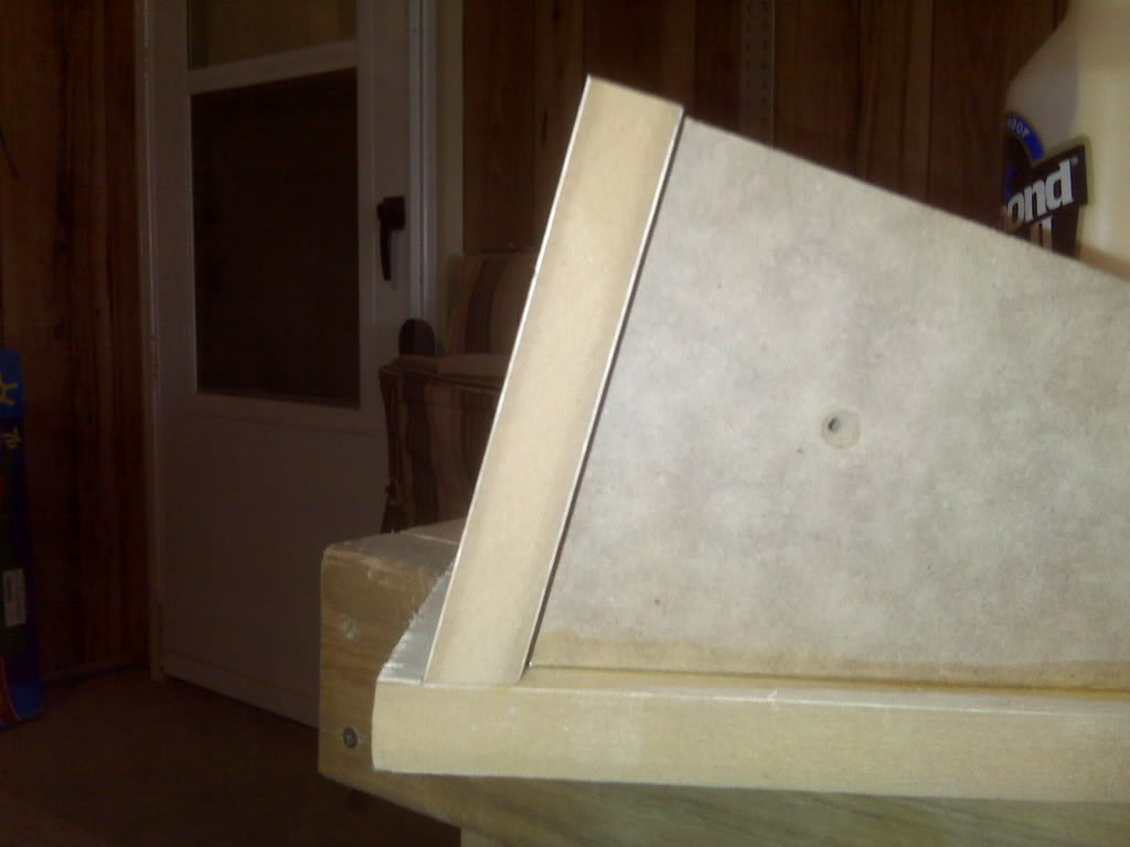

btw...it doesn't show but the holes in the side pieces are from where i screwed the end piece together so i could use one for a pattern with my router and flush trim bit. I filled the holes in afterwards with glue/MDF dust mixture.
i do the same thing with a flushtrim, but i just use a clamp and move it as necessary, i use to do the same but found this easier
