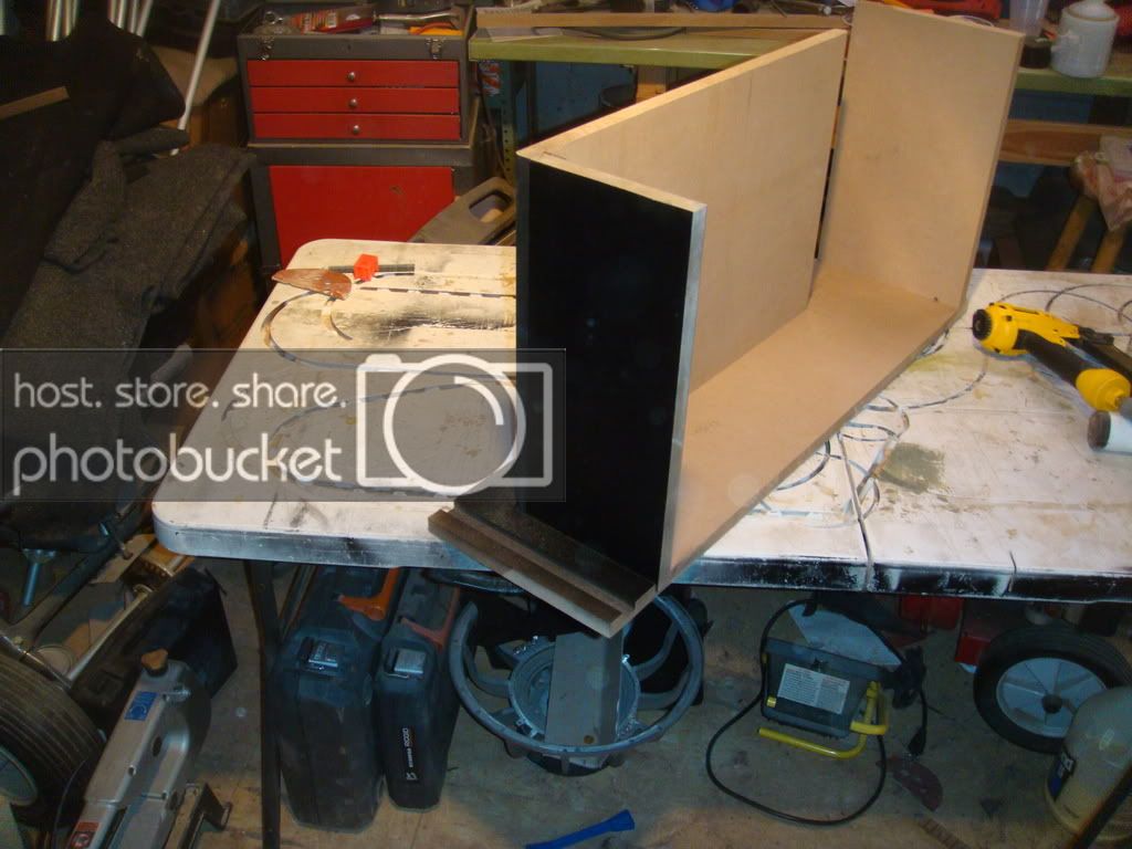

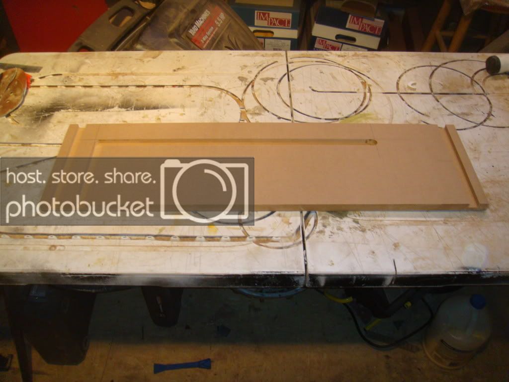

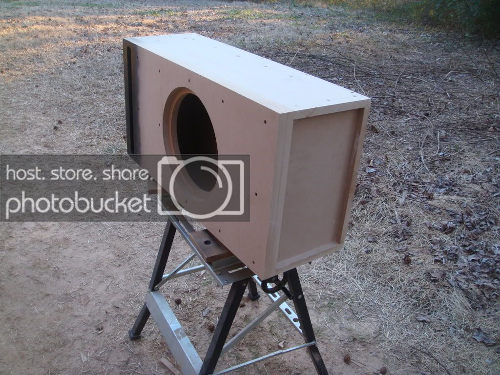

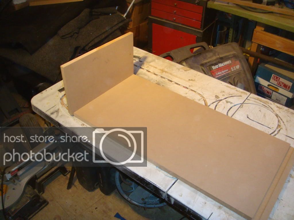

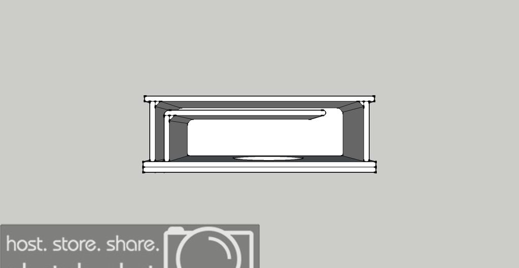

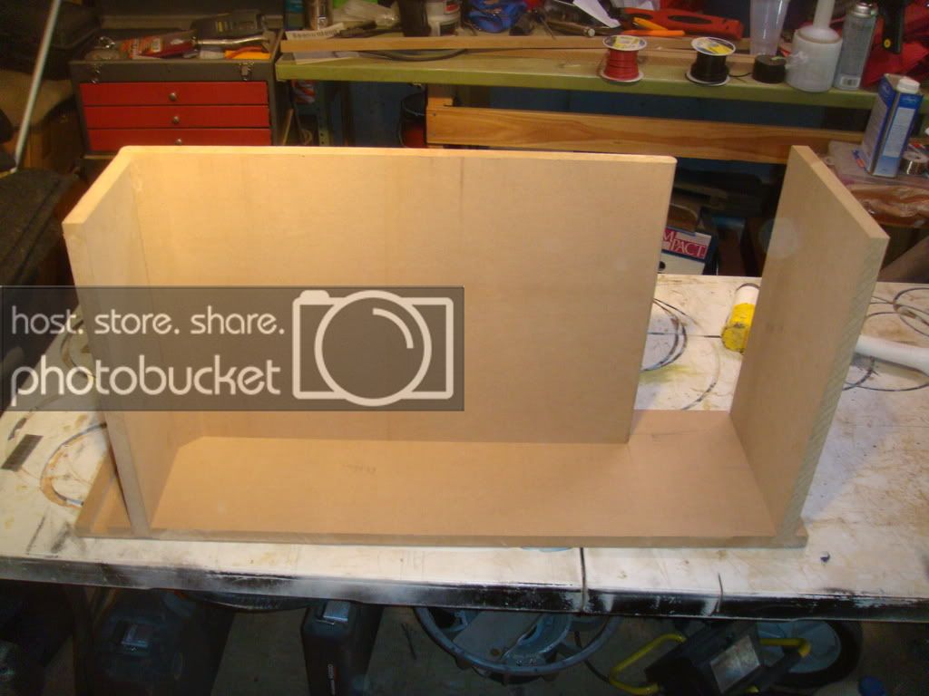

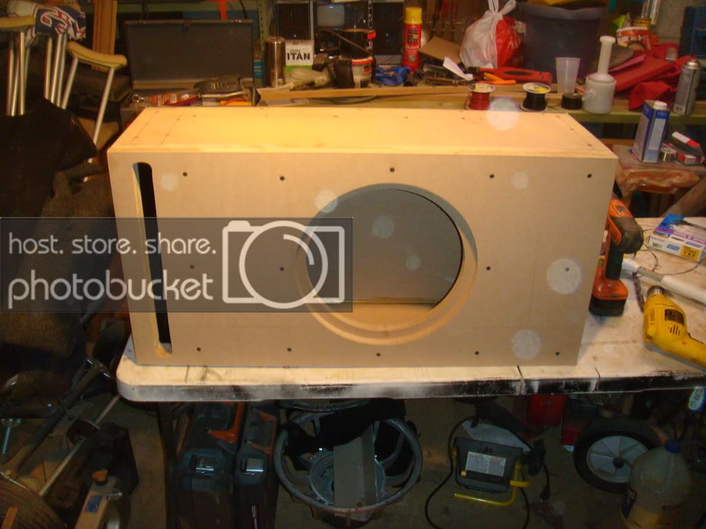

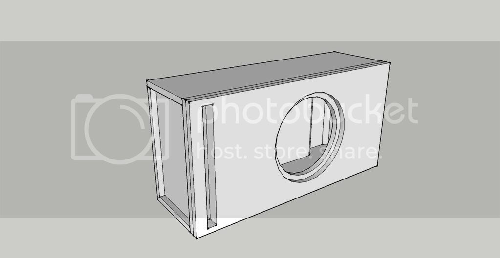

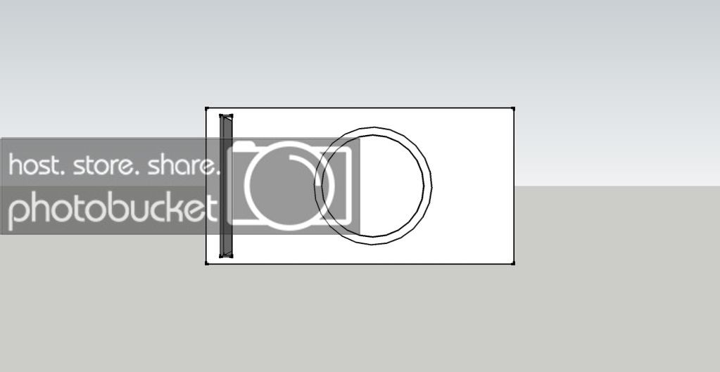

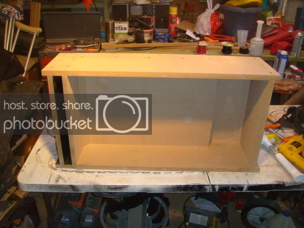

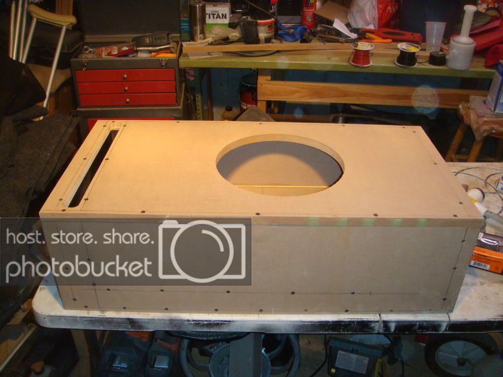

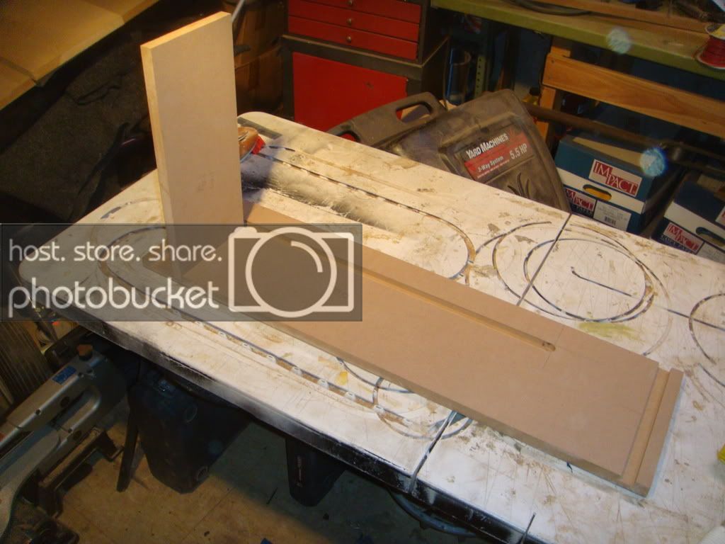

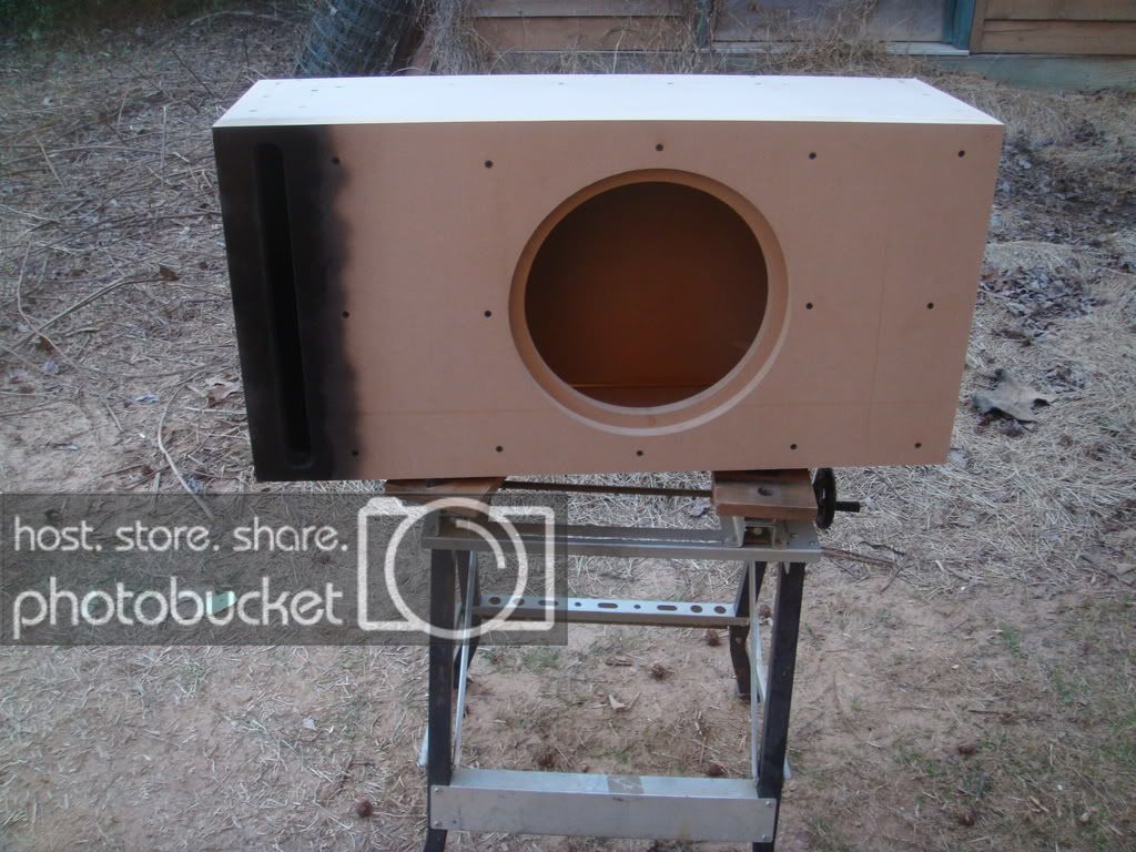

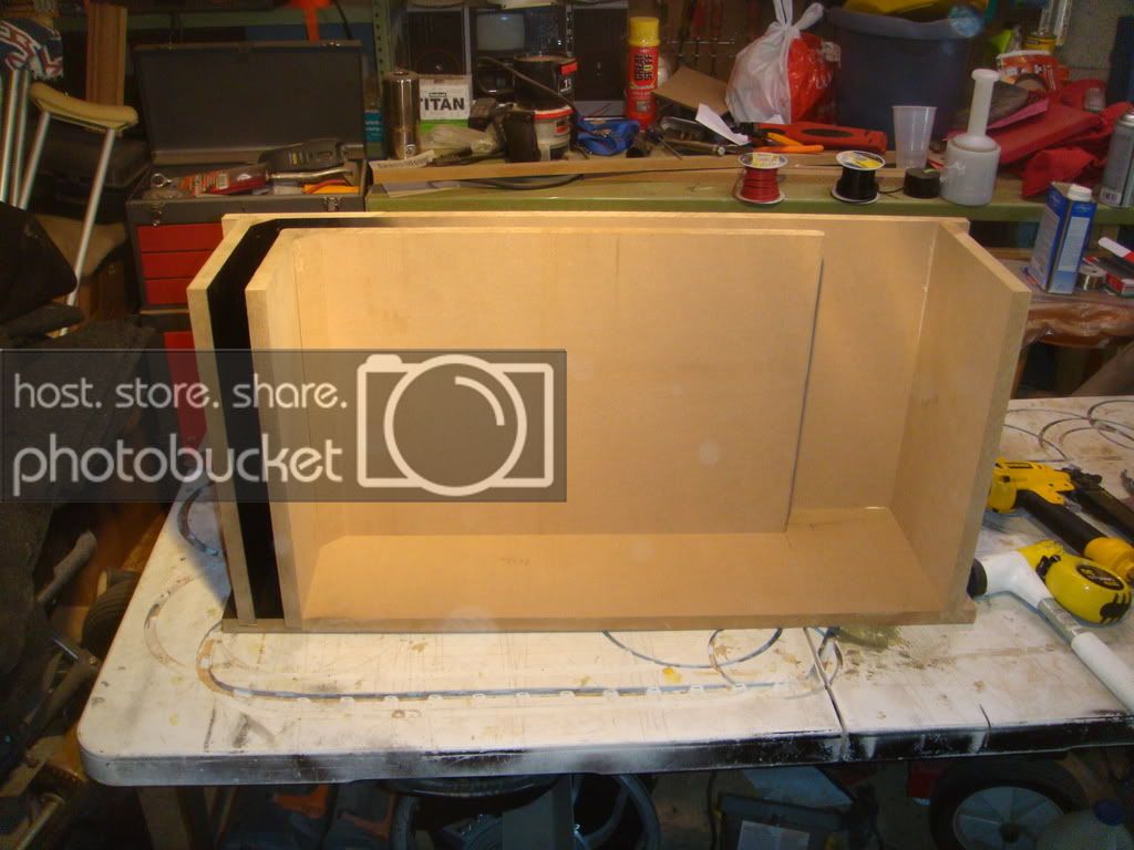

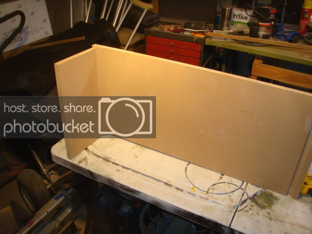

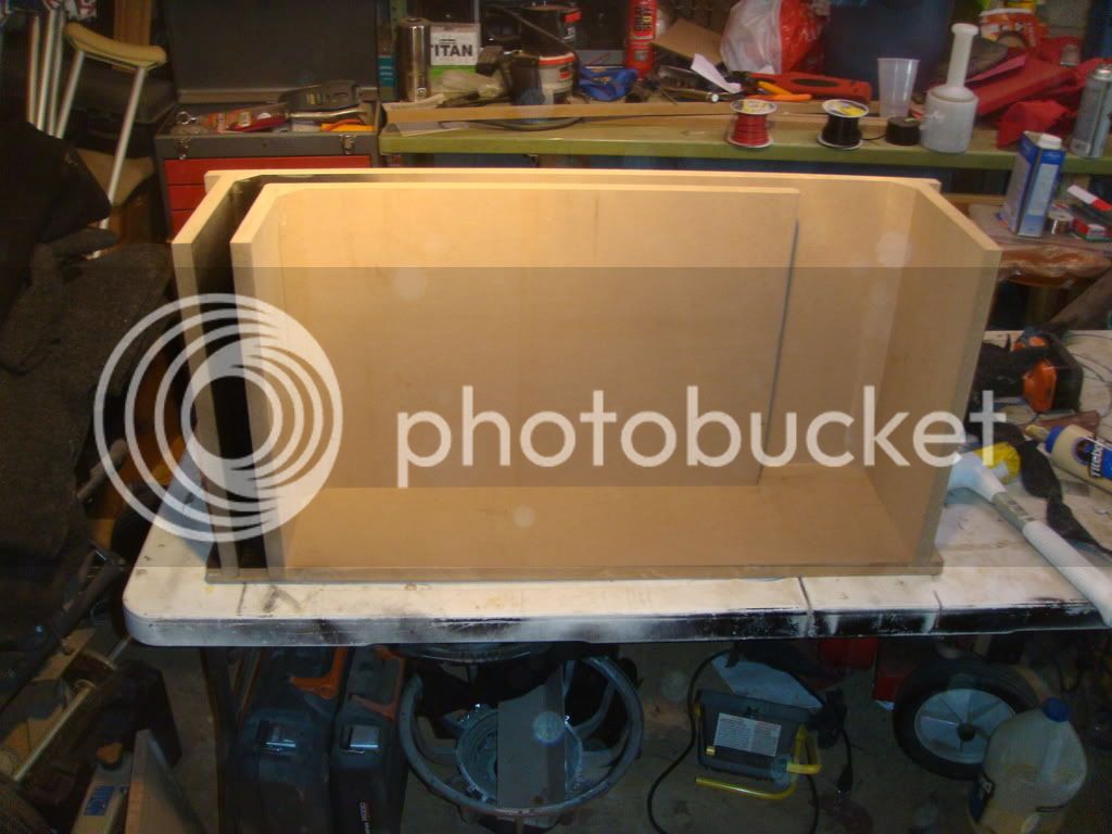

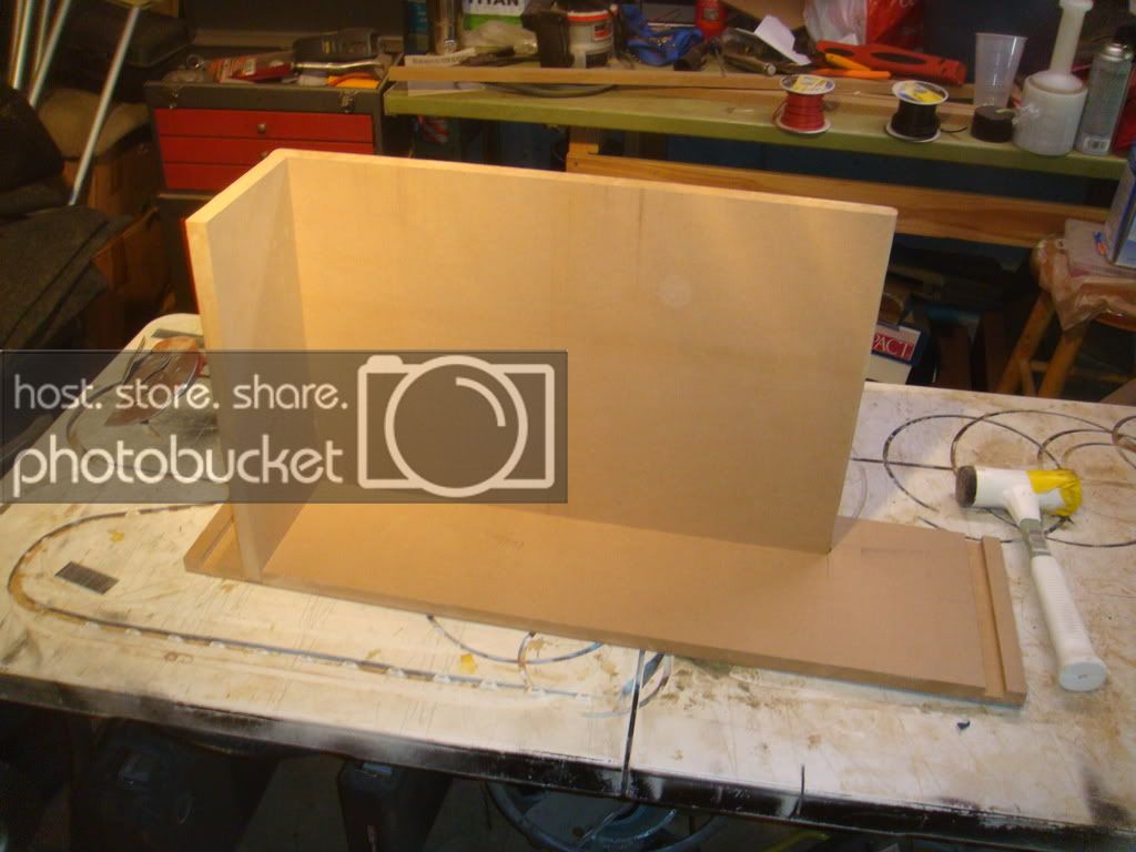

Ok everyone this box is for toohuge's single 12" Image Dynamics IDQ. Box is 1.55 cubiuc feet after all displacements. Box will be tuned at 30Hz with 18 quare inches of port.
Here is the design.................
More to come later.............
Not trying to be an ass, but the port doesn't look very wide at all. Is this box going behind a seat in a pickup truck or something.
The guy I am building it for wanted to take up as little space as possible because he takes his three dog with him alot, so I took the height up to the back seat and the width as far across as I could to make the depth as little as possible. The port is 15" x 1.25"
