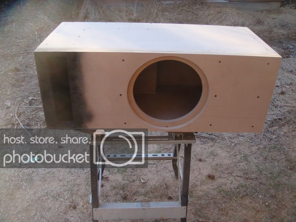

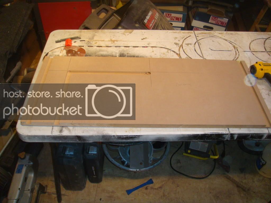

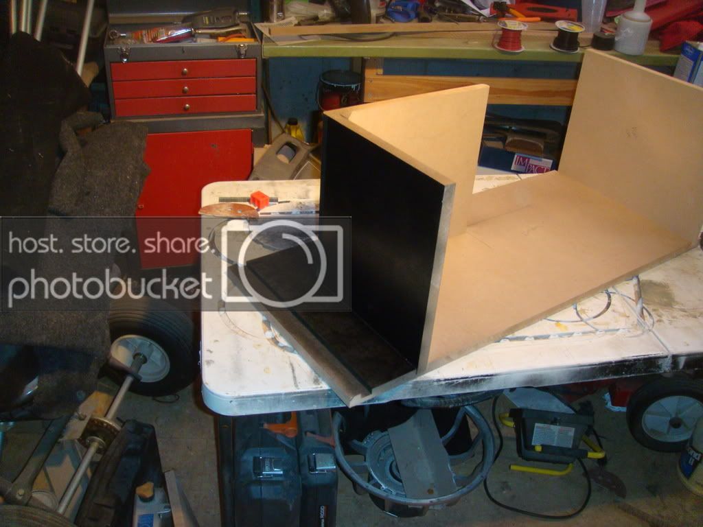

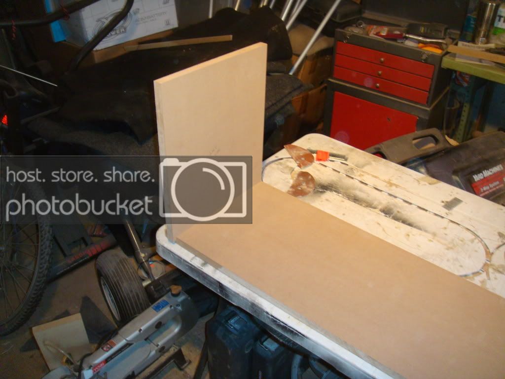

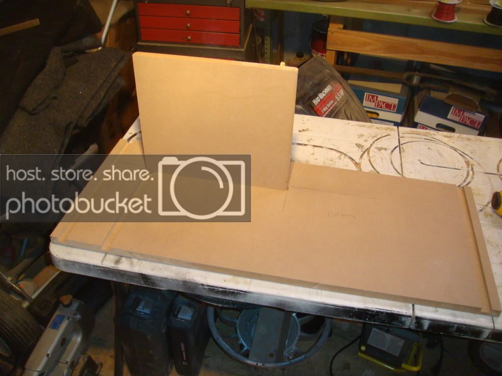

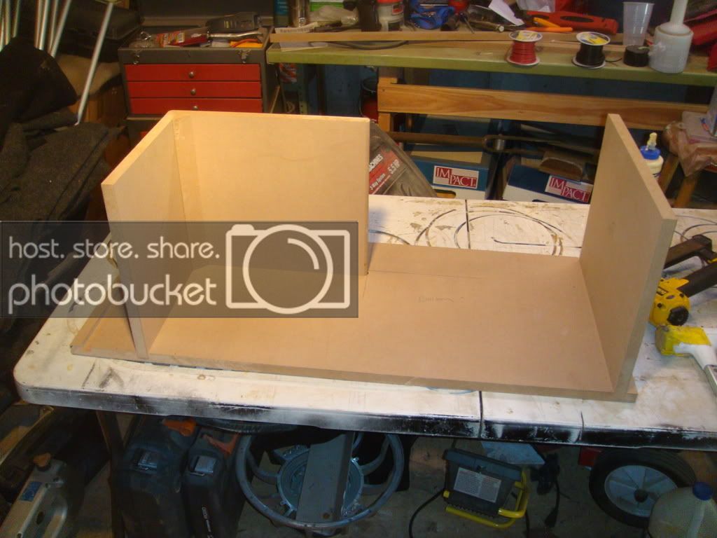

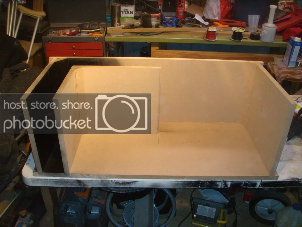

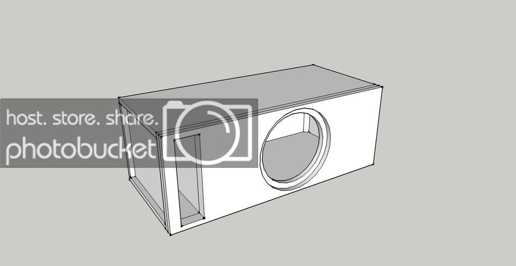

Ok everyone this box is for Atk2008's single 12" Alpine Typer-R. The box will be 2.50 cubic feet after all displacements. Box will have 40 square inches of port tuned to 35Hz.
Here is the design..............
More to come...................
