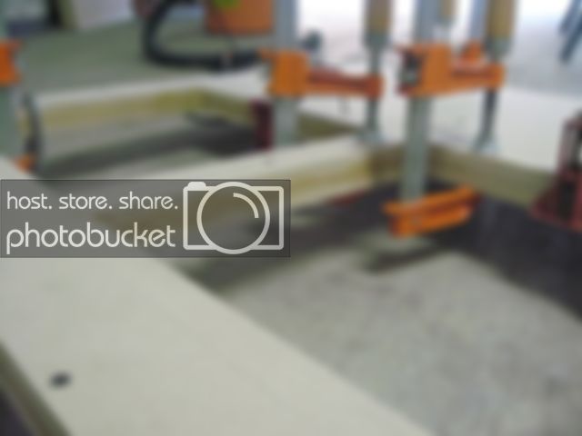

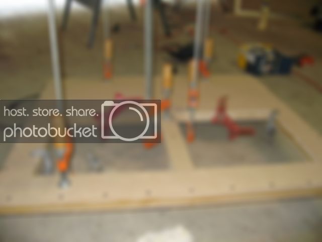

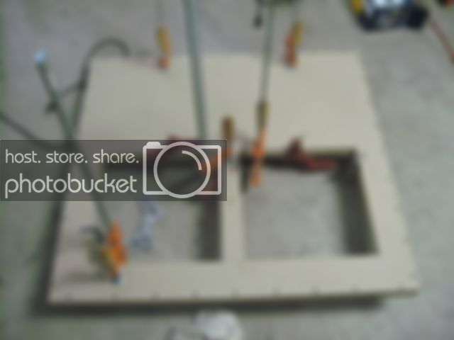

here's some snapshots of the double baffle:

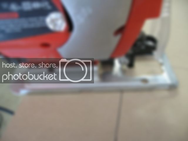

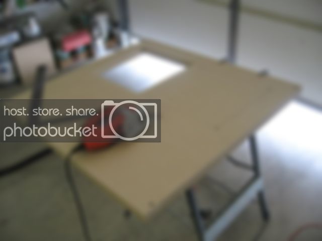

to do the cutout i screwed both piece together on all four corners so they won't move around.

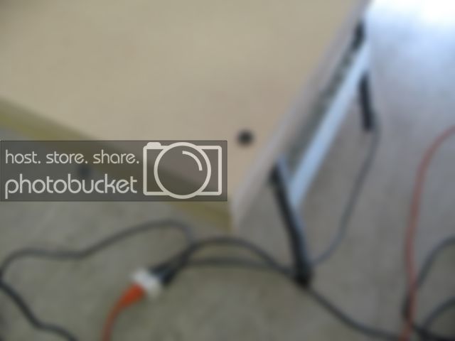

and to do the cutout, i used a drill bit big enough to clear the jigsaw blade and drilled the corners of the squared cutout.
then glued them together:

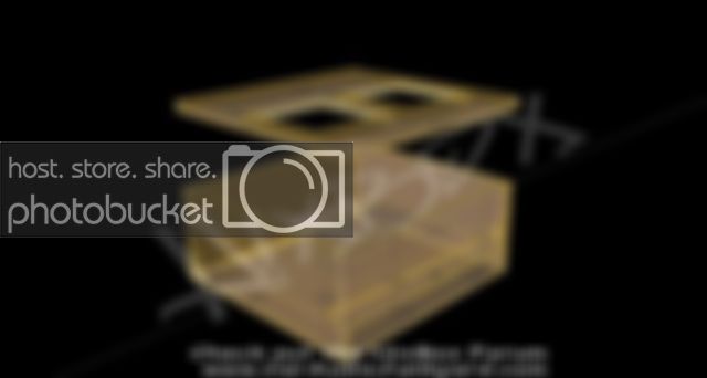

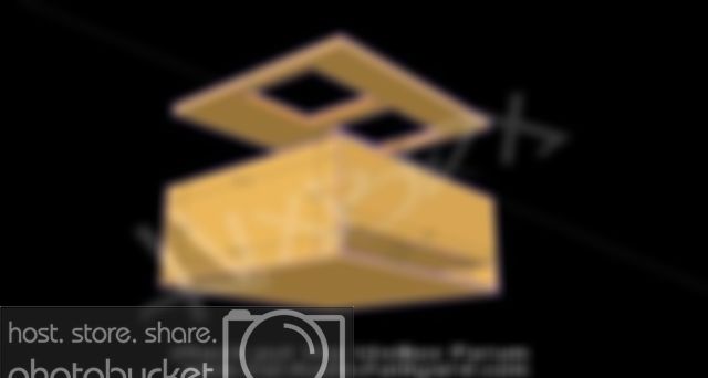

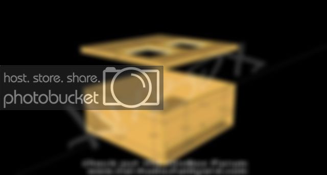

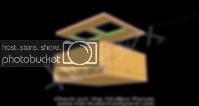

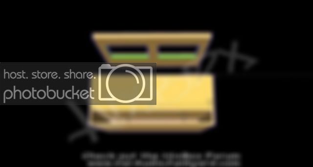

here are some pics of the design i did for him that they made beautiful
2x 4.25" x 36 " port angle piece optional
Square Prism Box Parts
2 Top, 1 Bottom: 35 © x 37.5 (b) in
0.75 (thick) in
1 Front, 1 Back: 14.5 (a) x 36 (d) in
0.75 (thick) in
2 Sides: 14.5 (a) x 35 © x 0.75 (thick) in
port
27.25 x 36" x .75"
This design was well thought out. Great overall design.
oh and the optional port angle pieces should be 36" long not 30". only typo i found.
