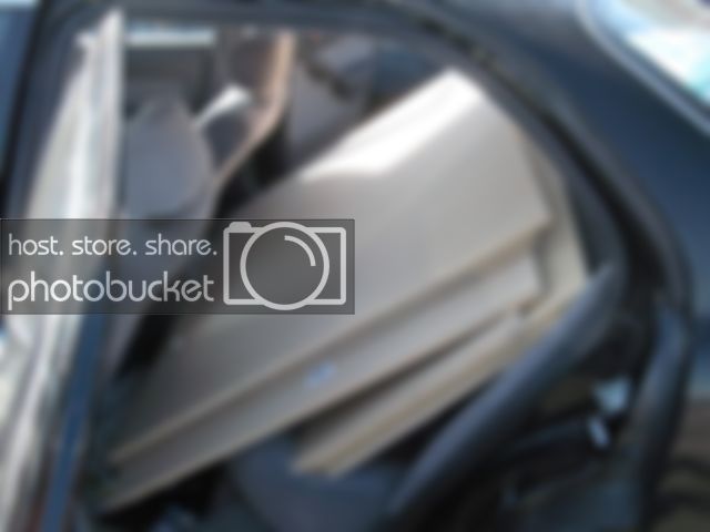

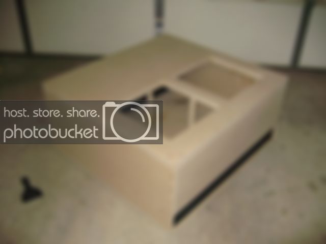

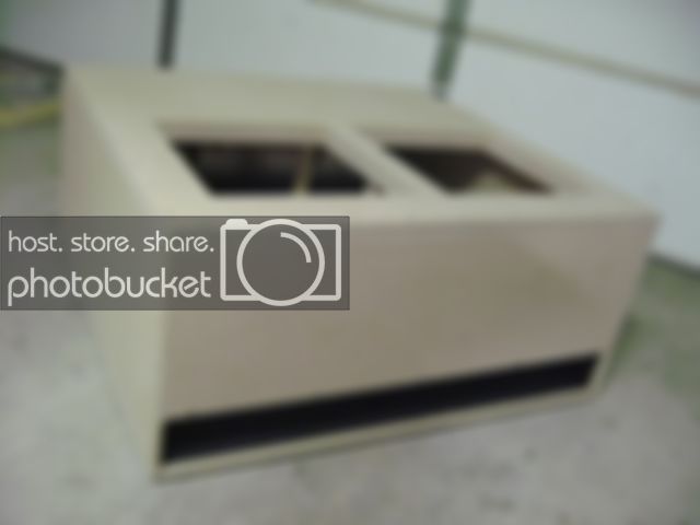

9 cubes @ 35hz = biggest i've ever built. rounded corners/port & double baffle.
needed two sheets for this sucker. I almost couldn't fit it all in my 96' camry:

the dimensions are 37.5 wide x 35 deep x 16.75 tall iirc
almost broke my back moving that thing around

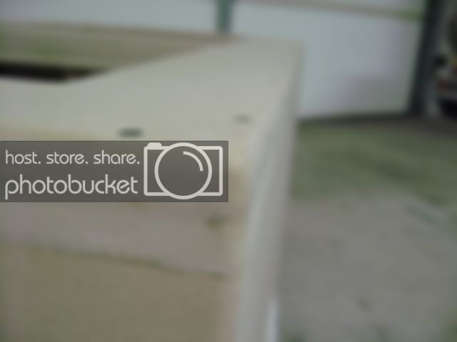

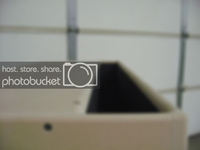

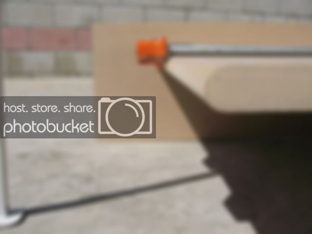

rounded port: I like the roundnesses //content.invisioncic.com/y282845/emoticons/yumyum.gif.0556df42231b304b9c995aefd13928a8.gif
rounded edges: 1/4" for the edges and 1/2" for the port.

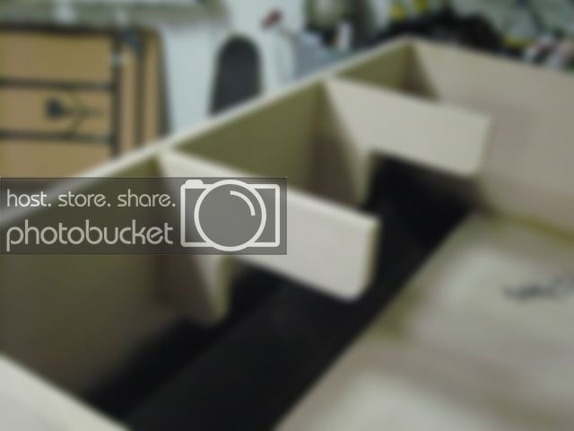

extra bracing for the back piece and baffle. and you can kind of see the slanted corner port piece in this pic.
