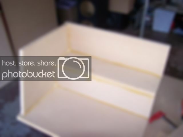

This will be a fun build! it will consist of a ported box for a Macdaddy 12" and on the left section a hidden amp rack with a hinged door all wrapped in black vinyl. The vehicle is a Ford ranger. forgot what year, either an 06 or 05 lol.
Box: 1.75ft^3 @ 32hz
gotta be exact!

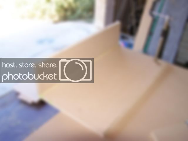

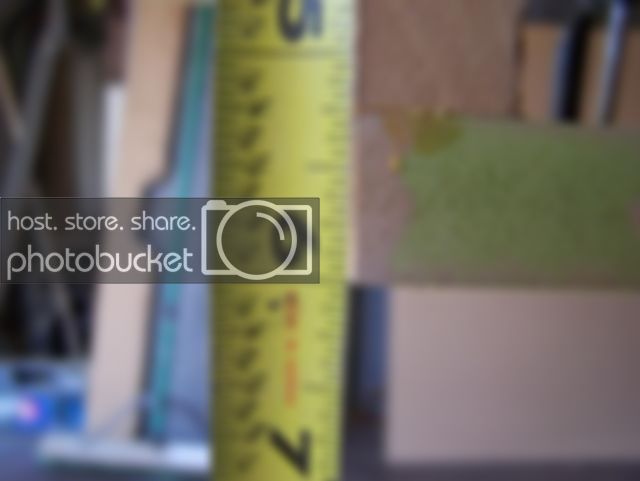

1/4" inset for the vinyl insert to be placed for later.

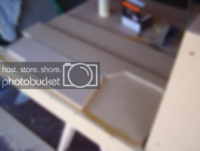

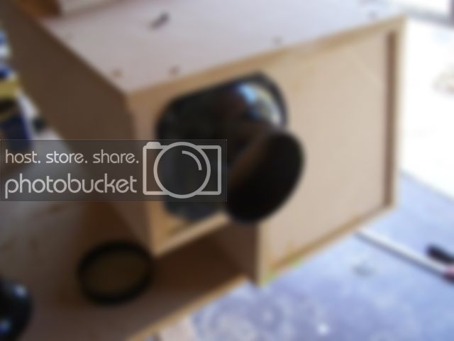

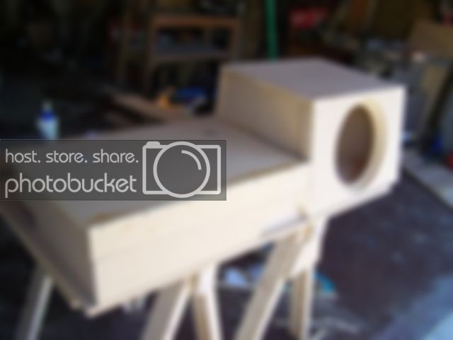

port will be internal this is to show placement.

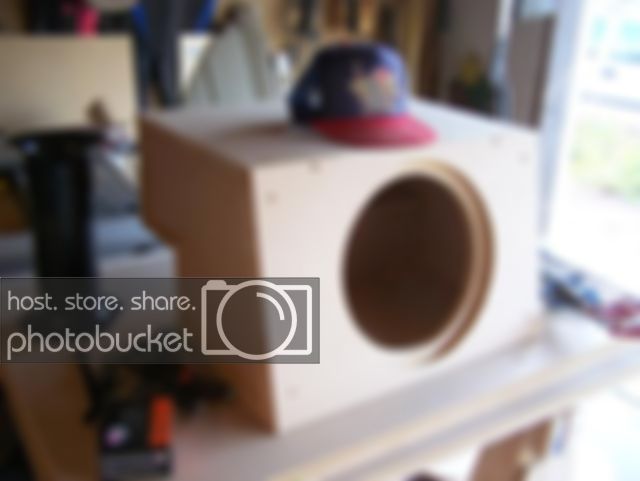

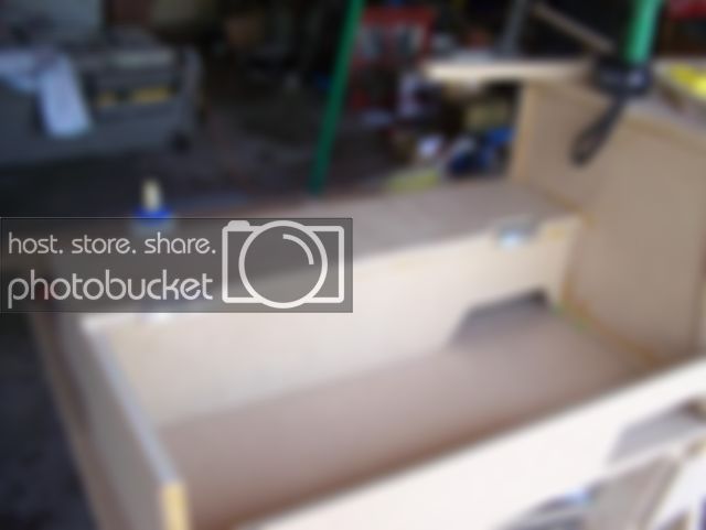

alright here is a good update on the box so far, got a bit of work done between this and doing an install:

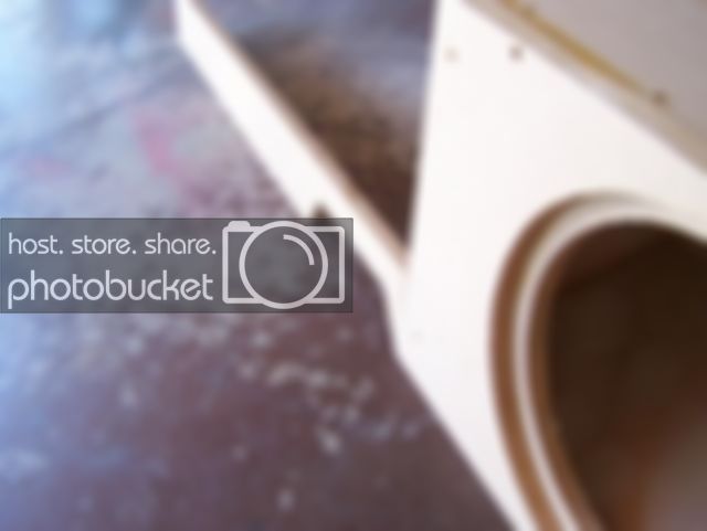

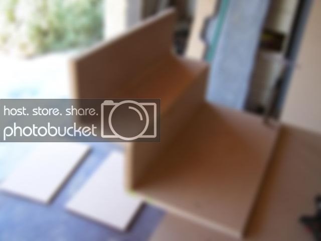

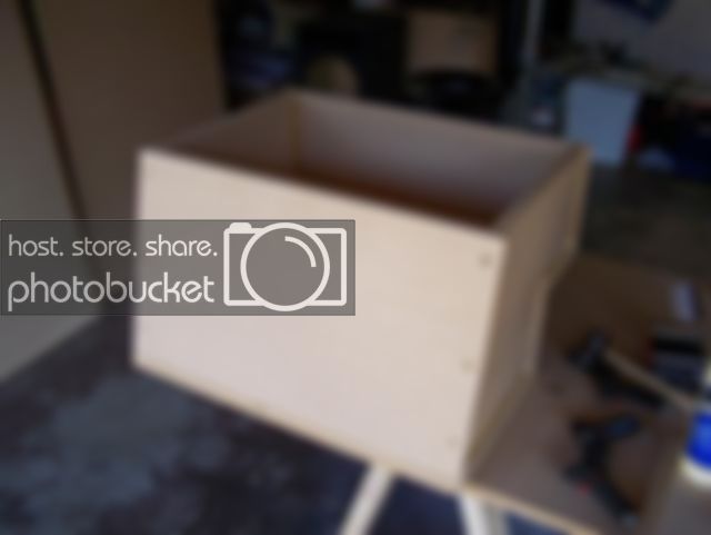

all pieces laid out
dry mock up

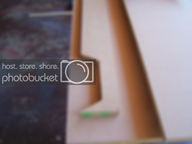

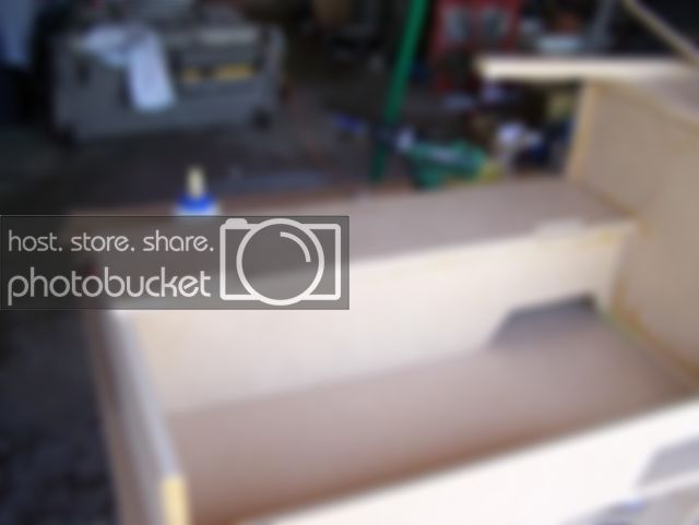

cut this out to allow for airflow to the amp. some is better than none.

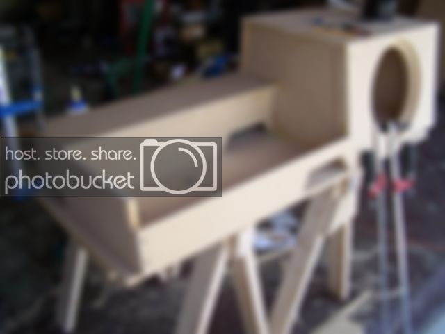

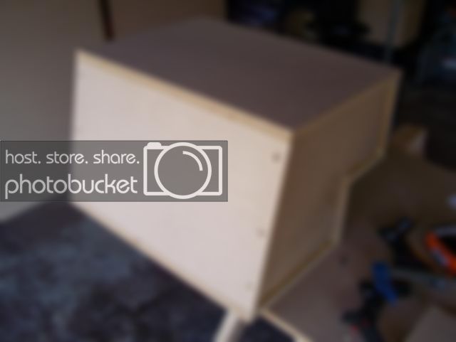

another update

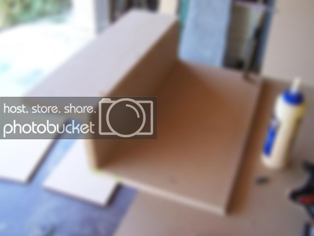

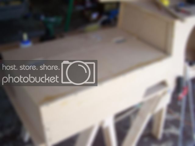

got the back put on

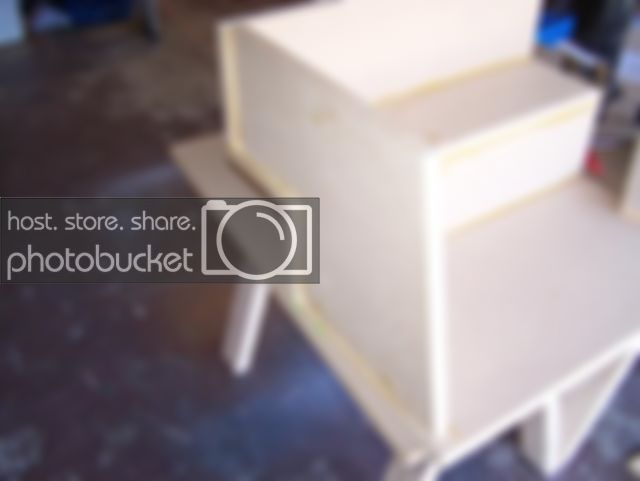

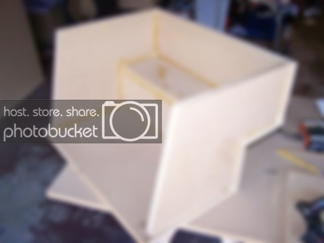

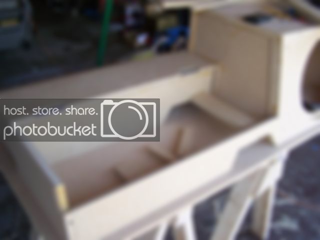

upper deck and front attached

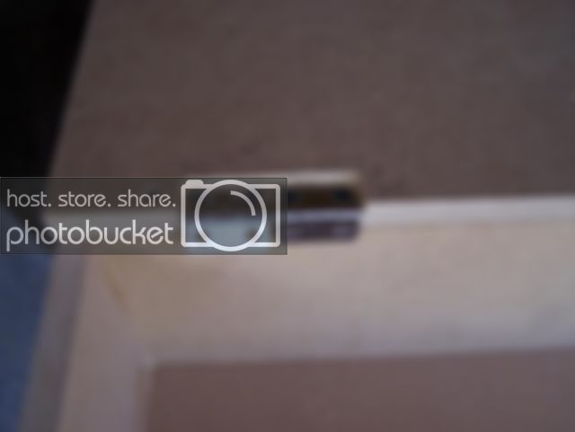

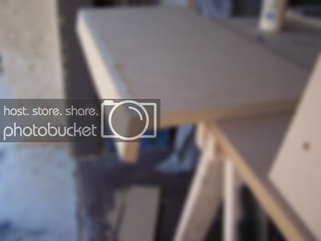

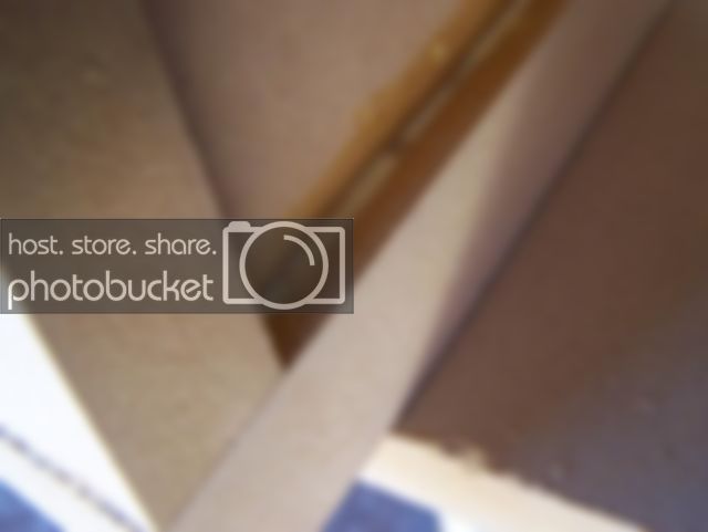

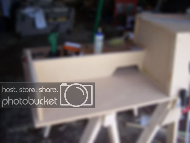

notched the top to allow for the hinges

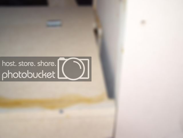

please note: Blocks where placed below to hide the screws shard ends

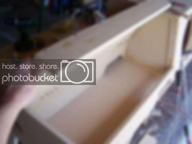

center support/ base for amp to be mounted to.
