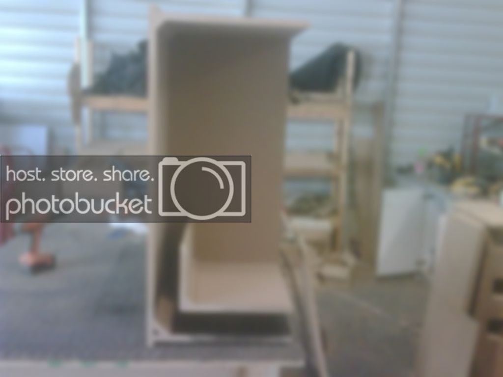

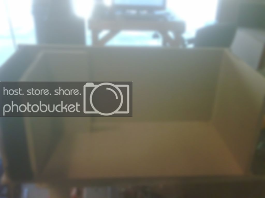

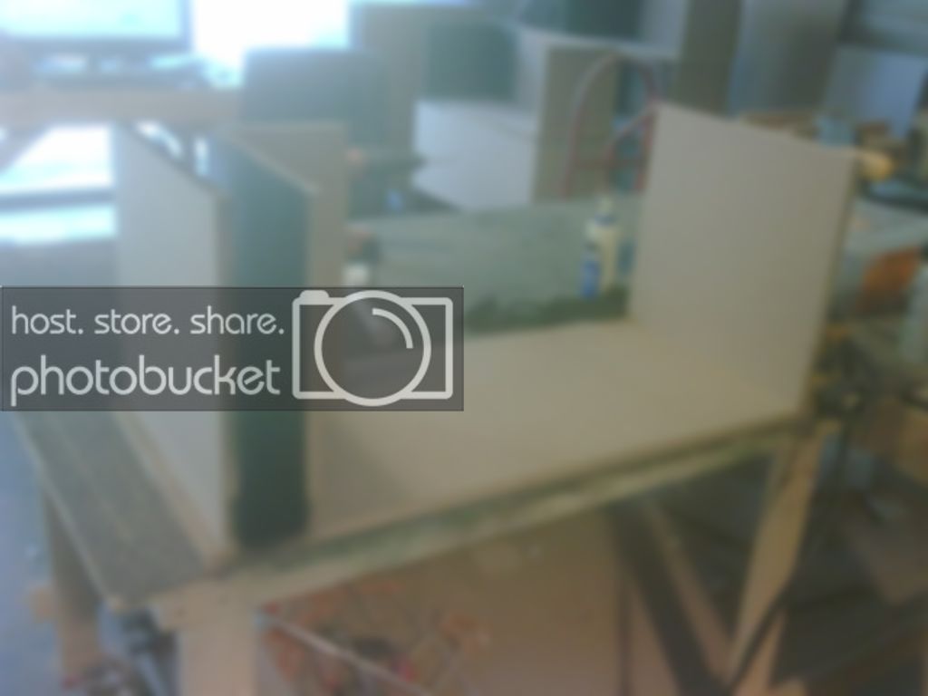

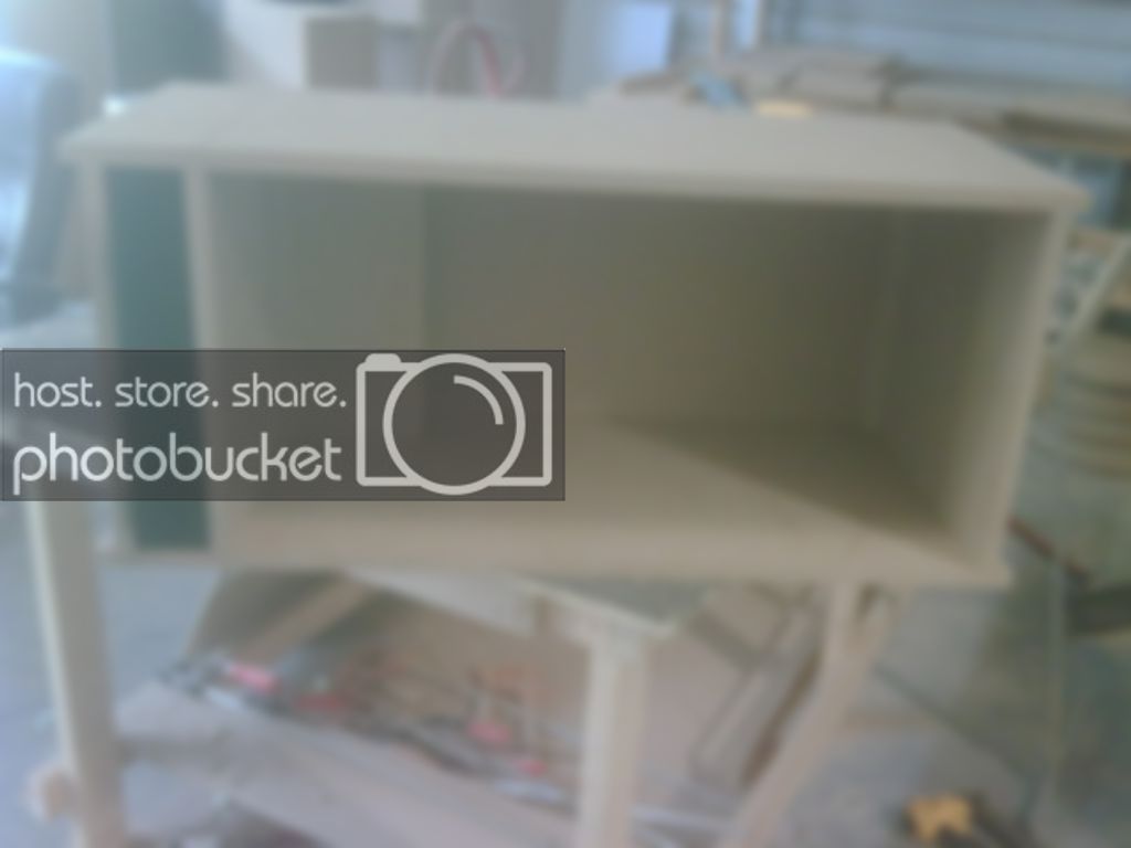

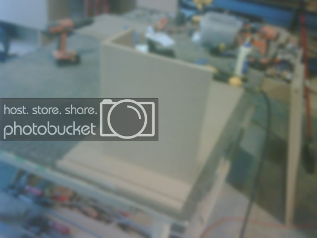

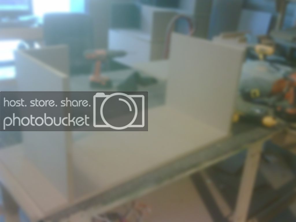

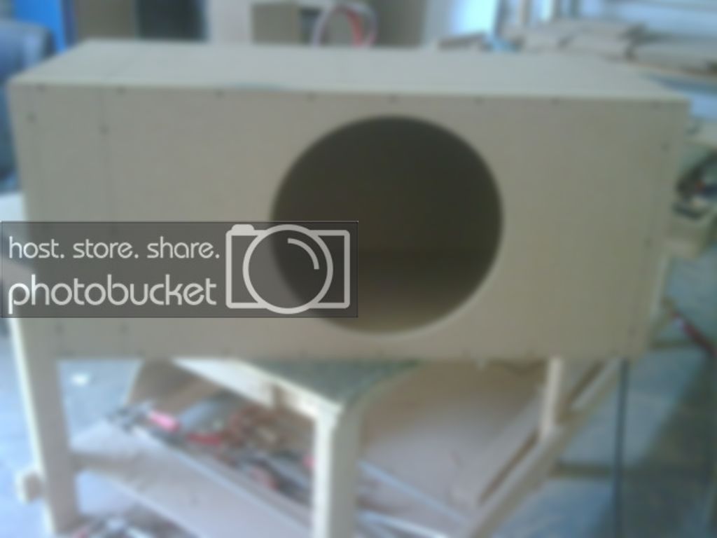

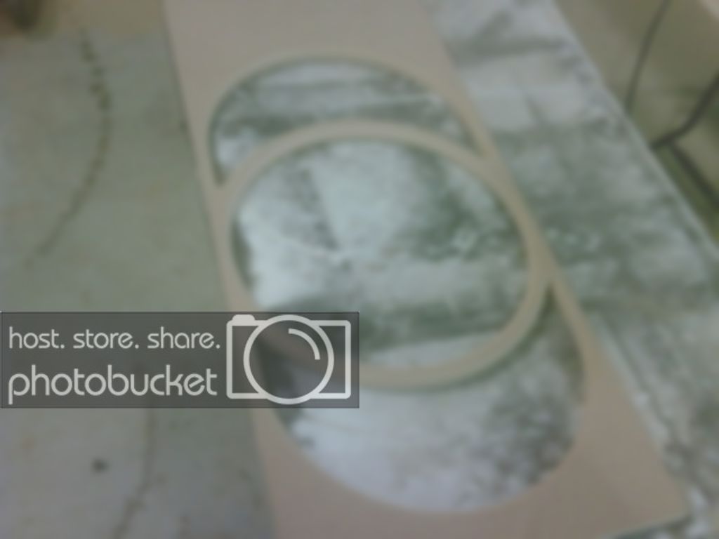

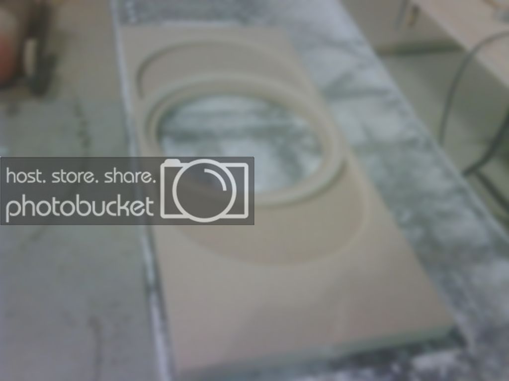

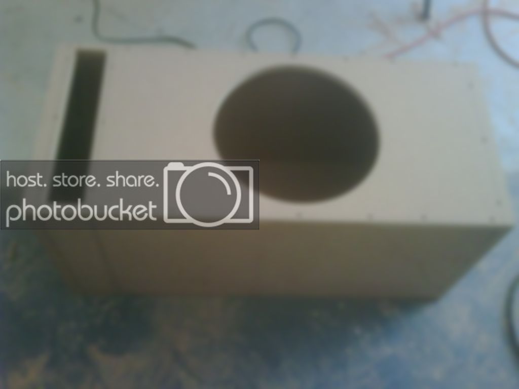

Ok everyone this box is for Santoro300's single 15" Fi Q.
Box is 4.0 cubic feet with 47 square inches of port tuned to 35Hz

It will be finished up this week. It was put on hold.
Nice box I need to come by the shop again sometime //content.invisioncic.com/y282845/emoticons/biggrin.gif.d71a5d36fcbab170f2364c9f2e3946cb.gif cool stuff there
