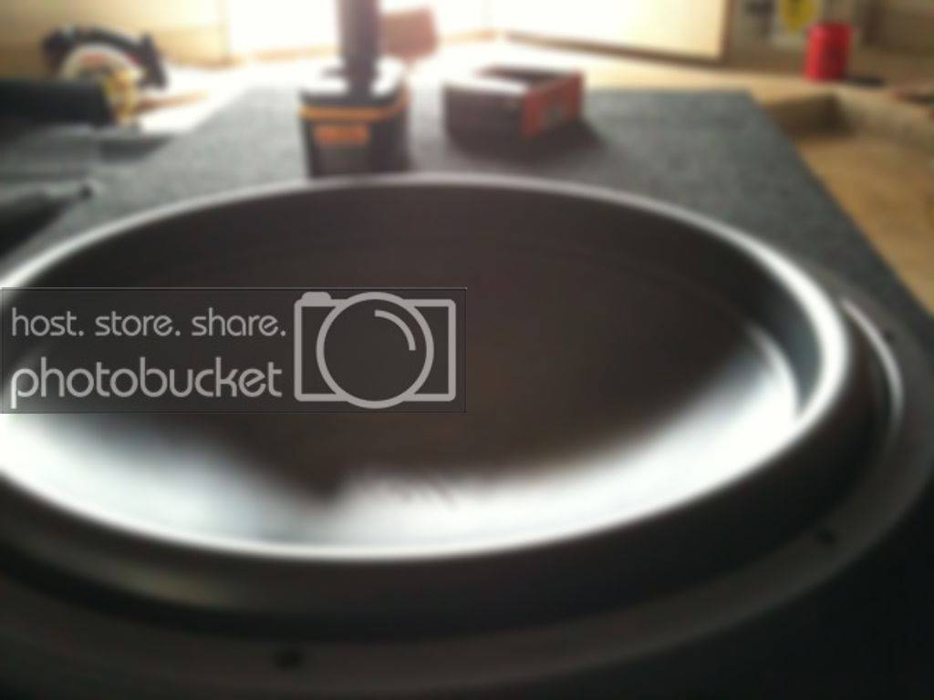

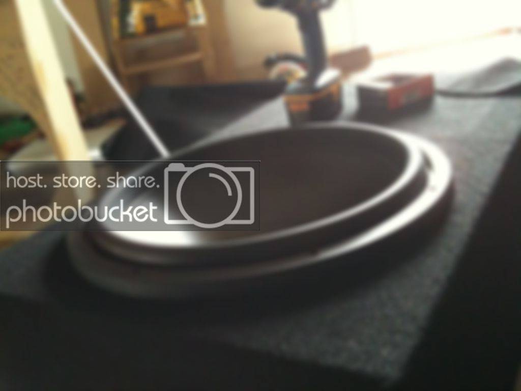

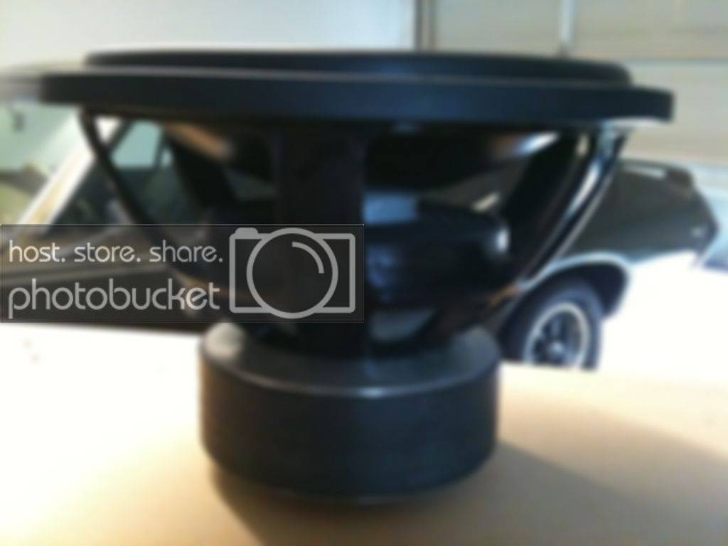

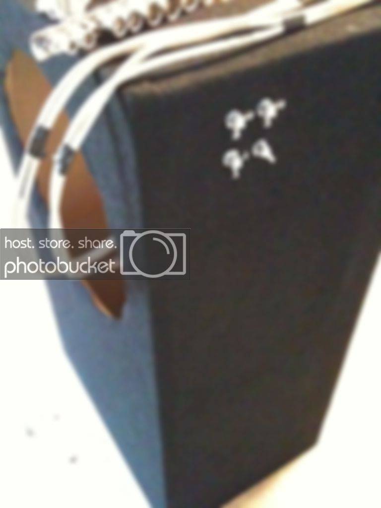

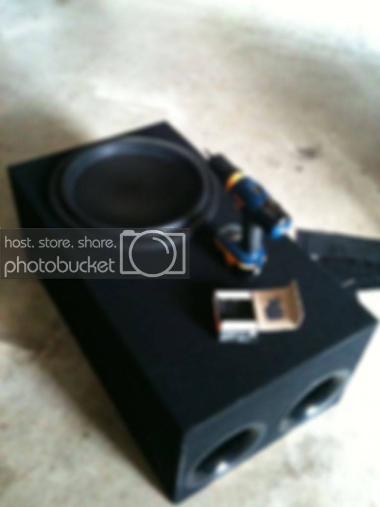

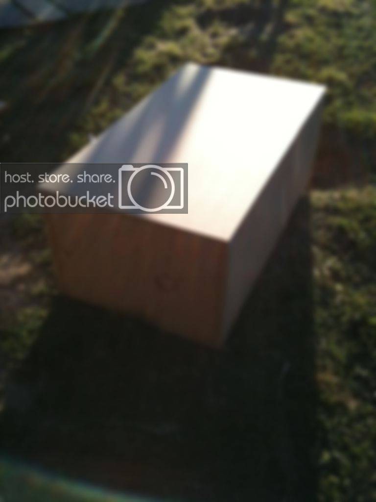

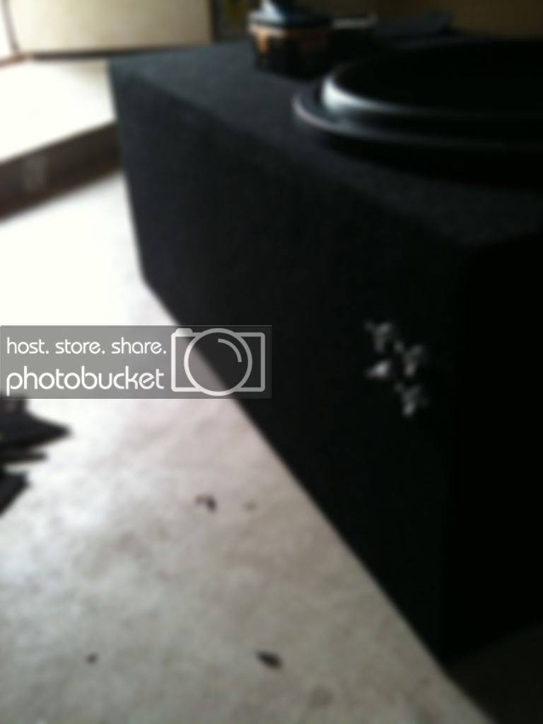

Box I built for my lms 18, all equipment will be in the trunk. Sub up, ported to passenger side. 4.8 cuft w/ a pair of 6" aeros tuned to 36 hz. Bulk pack of damp pro covering the entire trunk area coming soon, should be here today or monday.

Why you tune it so high //content.invisioncic.com/y282845/emoticons/frown.gif.a3531fa0534503350665a1e957861287.gif lol nice tho man! Im building my box for pair of 12 5400s today
Yea it sucks but I can only fit about 5.5 cubes in my trunk, using the 2 aero's I would have to have like 24" long port, if I only used 1 wouldn't be enough port area. It sounds good It just doesn't hit the low lows. I may design a new box after this one with a slot kerf port.
Ya if u plan to run 4k to it you can make the box smaller. Im running my 12's in 2.2cu net each. @ 32hz //content.invisioncic.com/y282845/emoticons/smile.gif.1ebc41e1811405b213edfc4622c41e27.gif Nice shit tho. Pictures dont do justice to how beefy those motors are.
Big mutha humpa. High tune 36Hz is to cry. You cheat self out of whole octave.

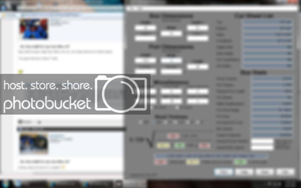

lolz, you're nuts. I bet you have shelves full of baskets and motors. How does this look.

I'm sure that would sound just fine, hard to tell without an actual model of it. That doesn't tell me anything about FR or mechanical/thermal performance. Myself, if I owned that driver and I were to use it in a vehicle, I would go large sealed. Especially if I had 4K at my disposal. We all like different things though.
