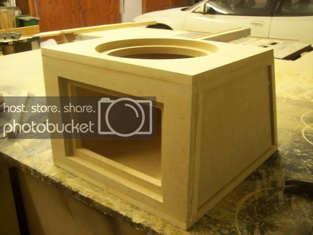

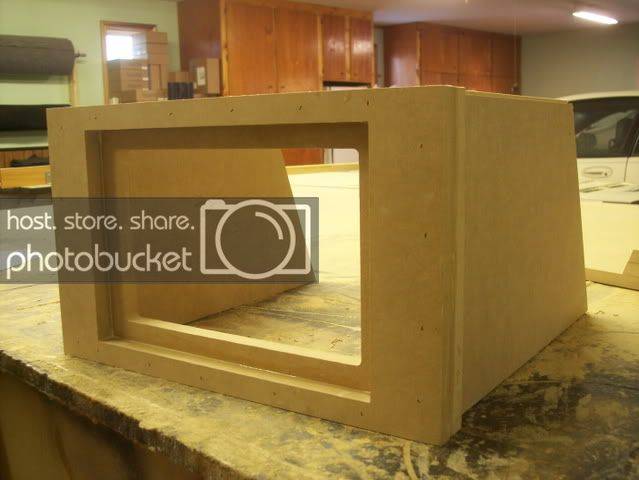

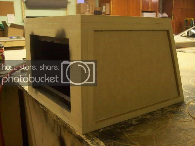

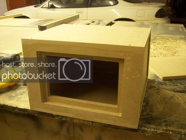

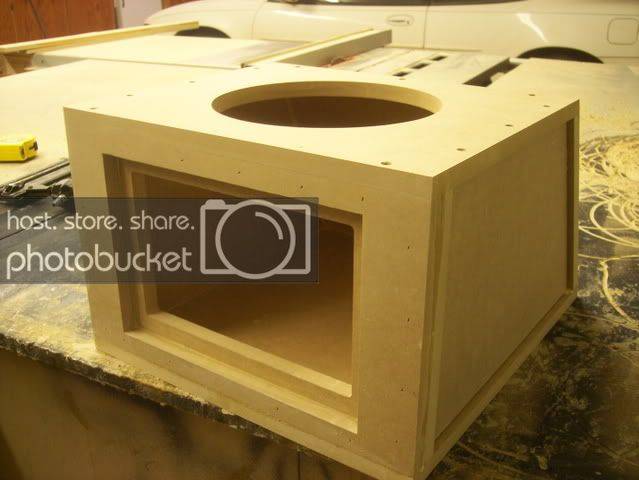

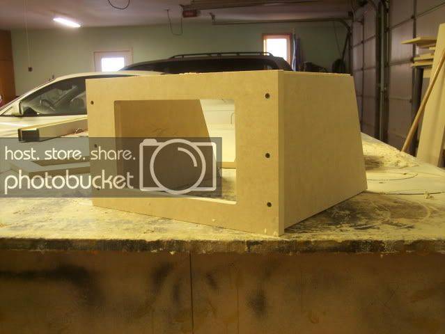

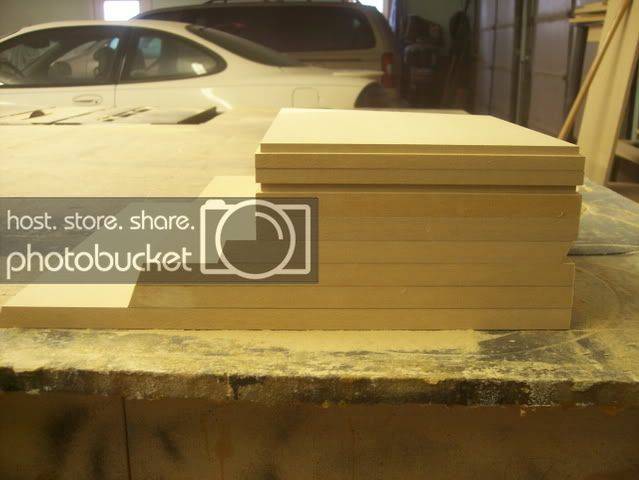

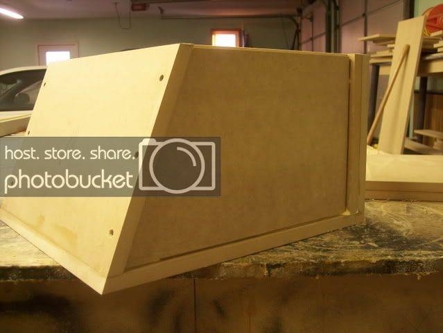

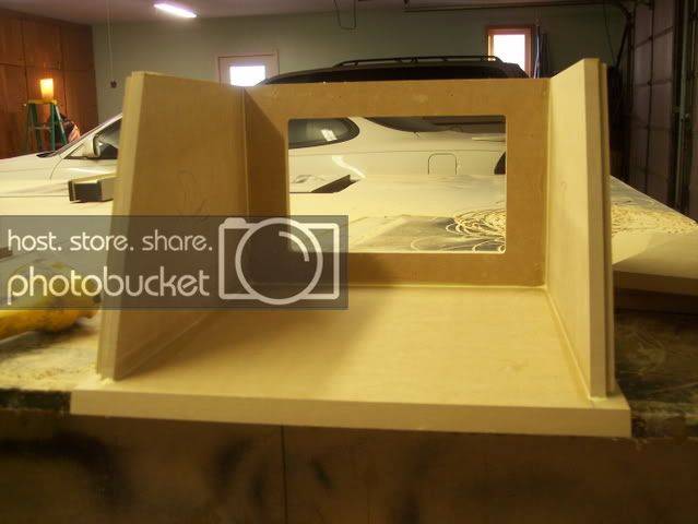

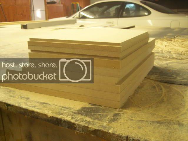

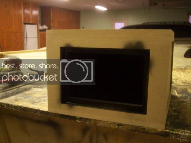

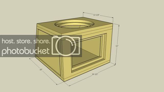

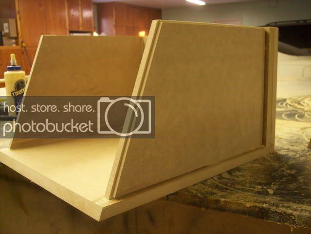

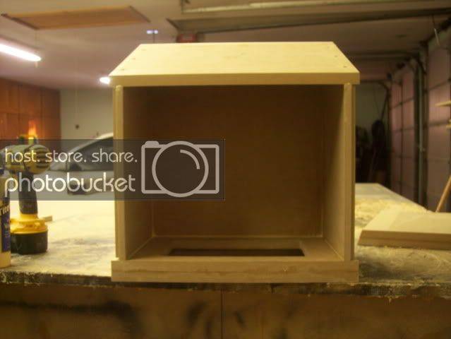

Box will be sealed, with a plexi window, double baffle, and black carpet. Also, the inside will be painted black.
Volume is 1 cube for a 10" TC Sounds LMS4000
i wanted to do a plexi box for my 5200 cuz its got a custom painted basket but i figured it would be wayy to hard....i like the window idea nicely done
I know it sounds cheesy, but is there gonna be any neons or LEDs in there? I think it would look nice //content.invisioncic.com/y282845/emoticons/smile.gif.1ebc41e1811405b213edfc4622c41e27.gif
Jesus do you do anything half-assed? lol A simple sealed box using rabbit joints? Niceness.
Doesn't look like rabbit joints to me , looks like a rabbit for tucking carpet //content.invisioncic.com/y282845/emoticons/smile.gif.1ebc41e1811405b213edfc4622c41e27.gif
