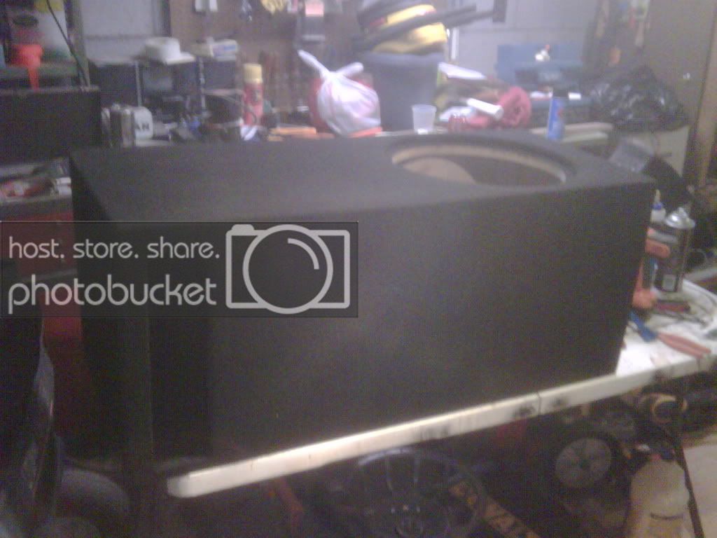

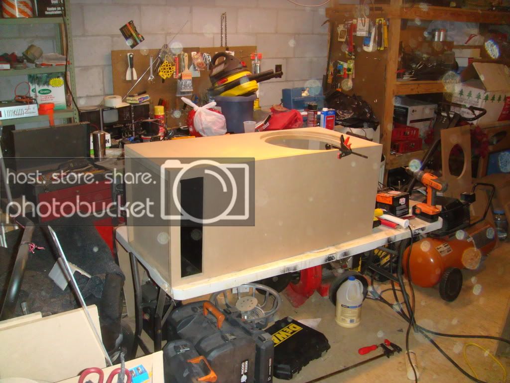

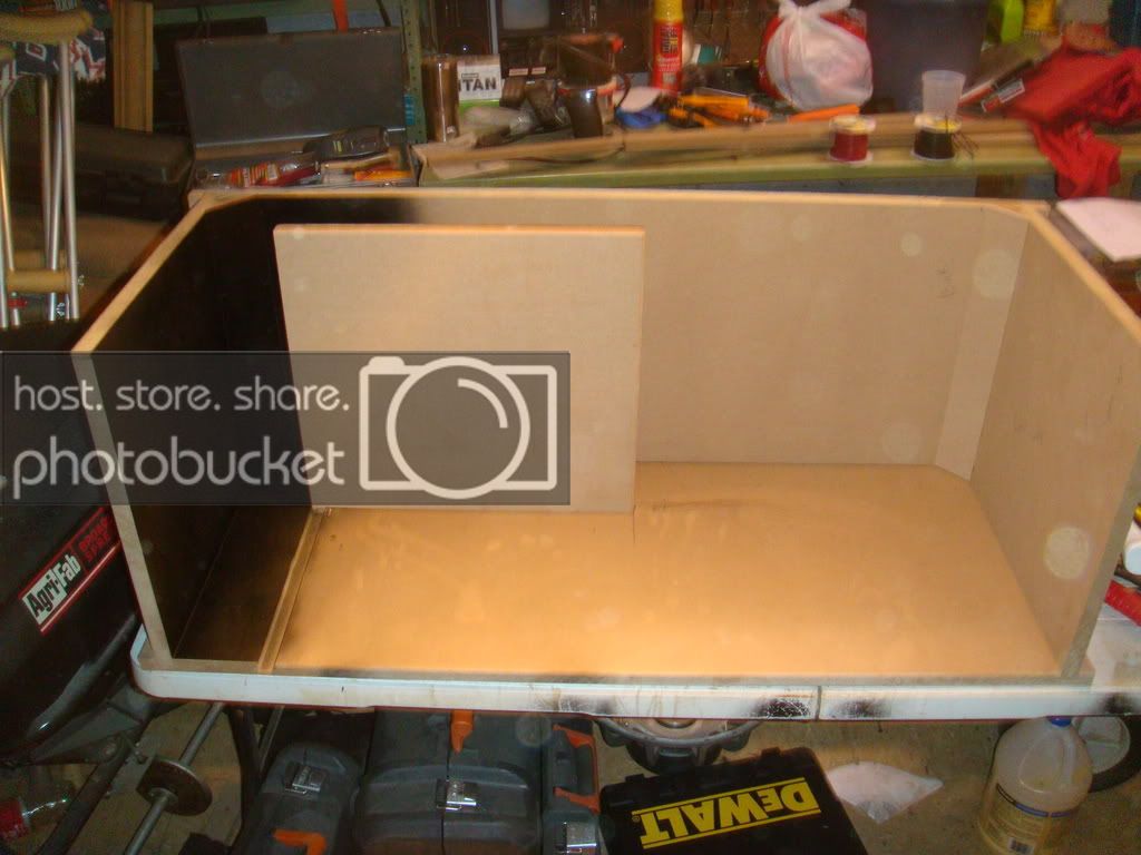

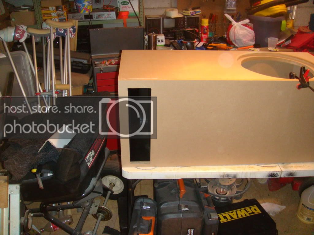

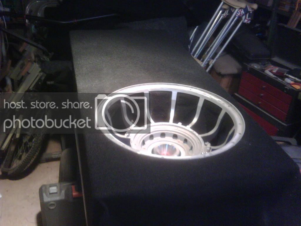

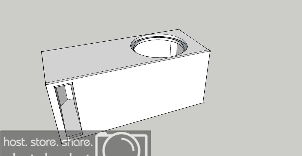

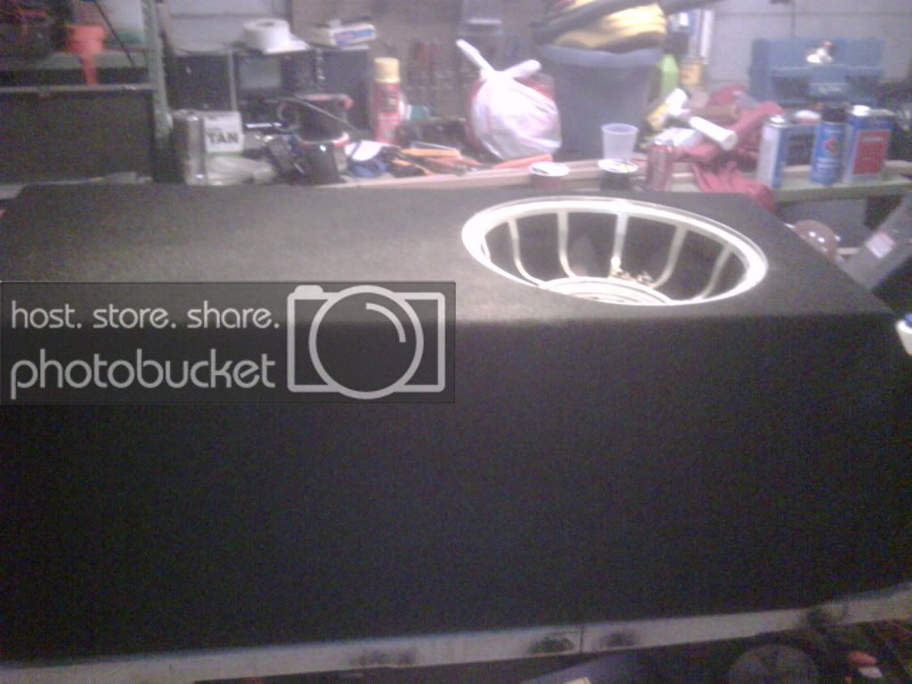

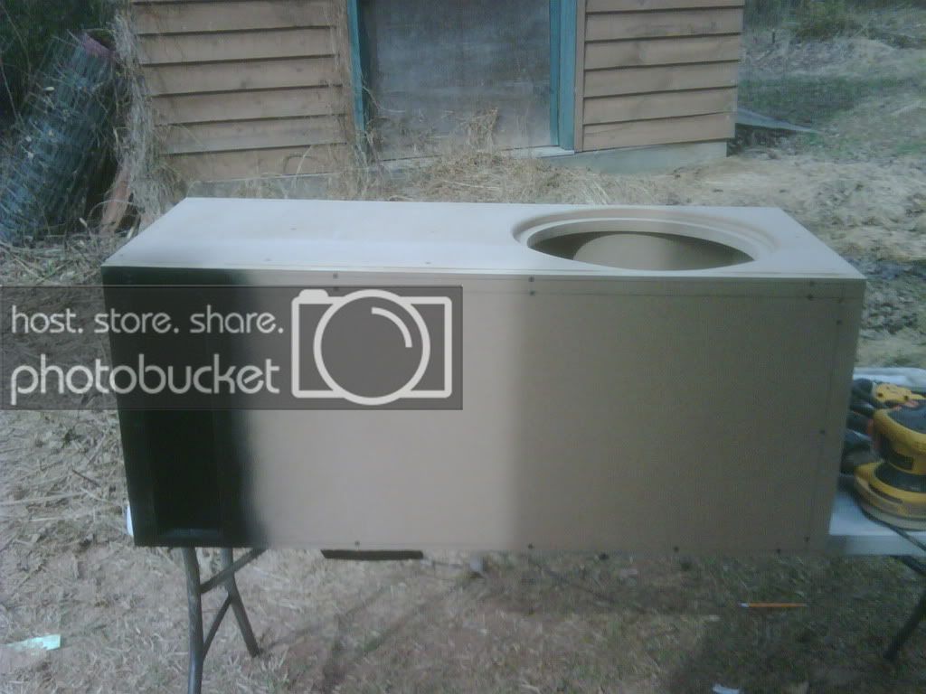

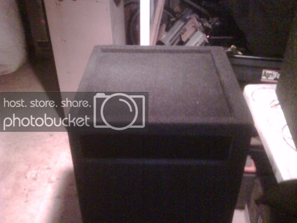

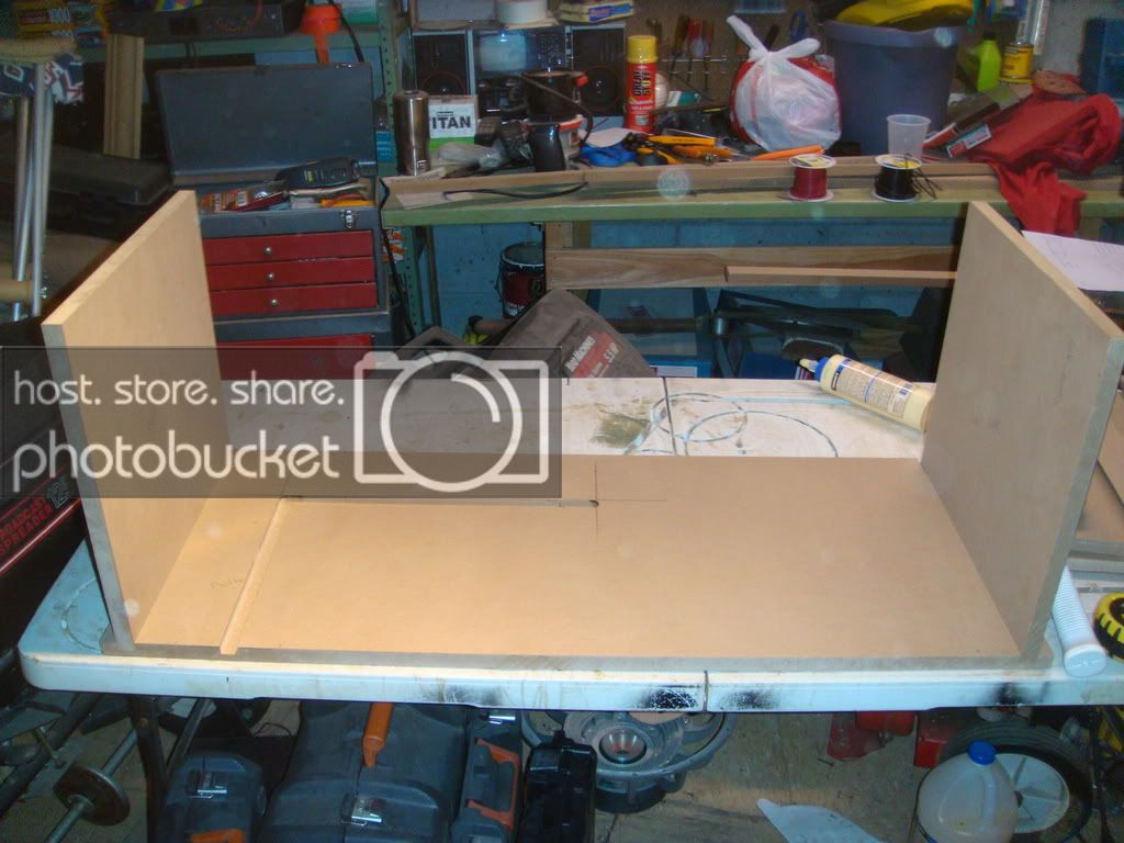

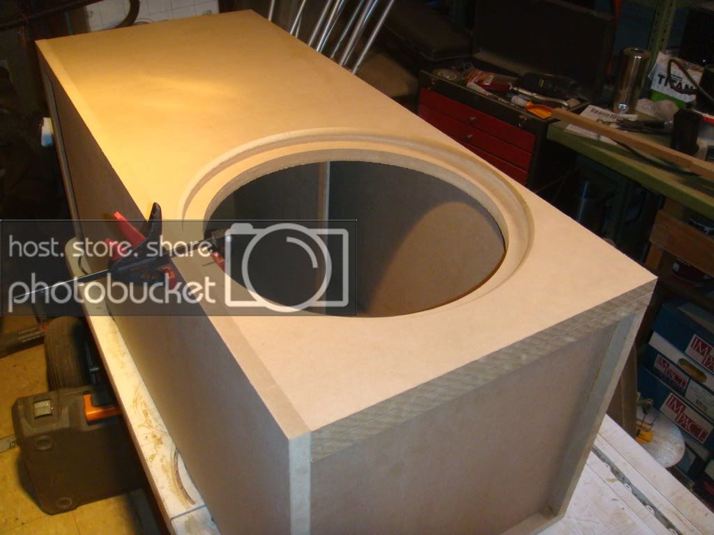

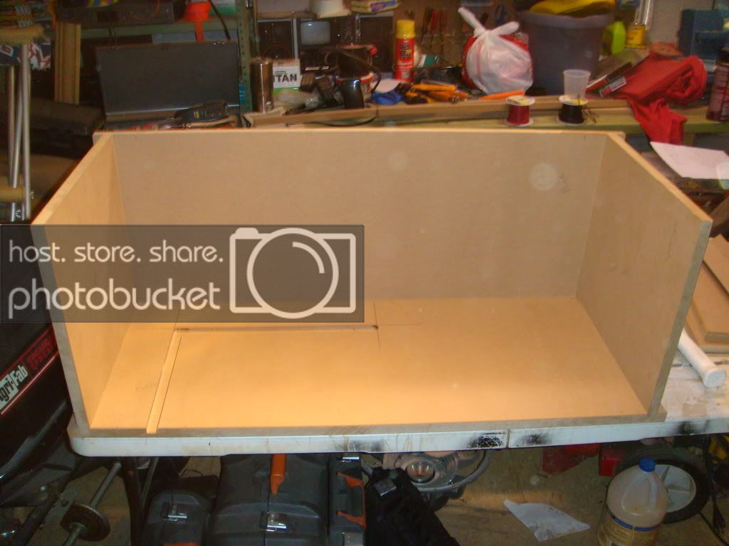

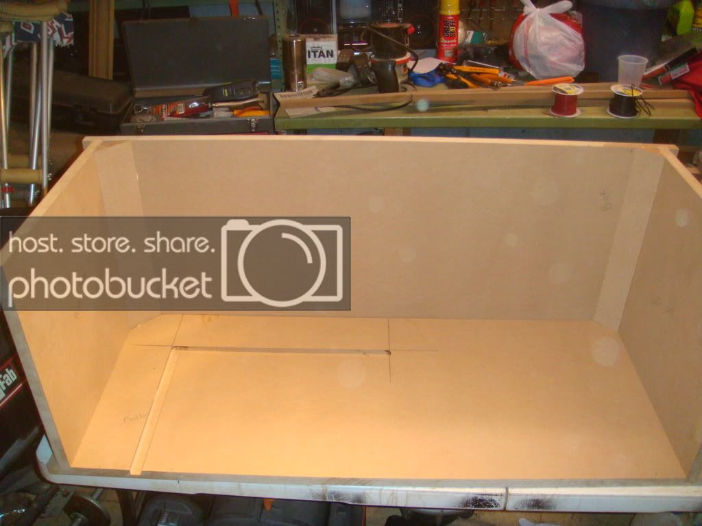

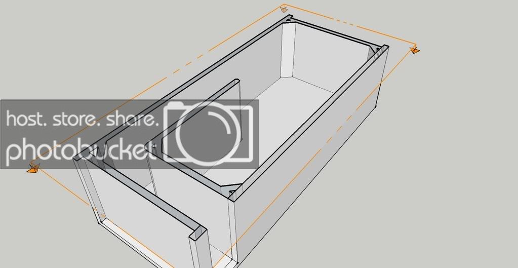

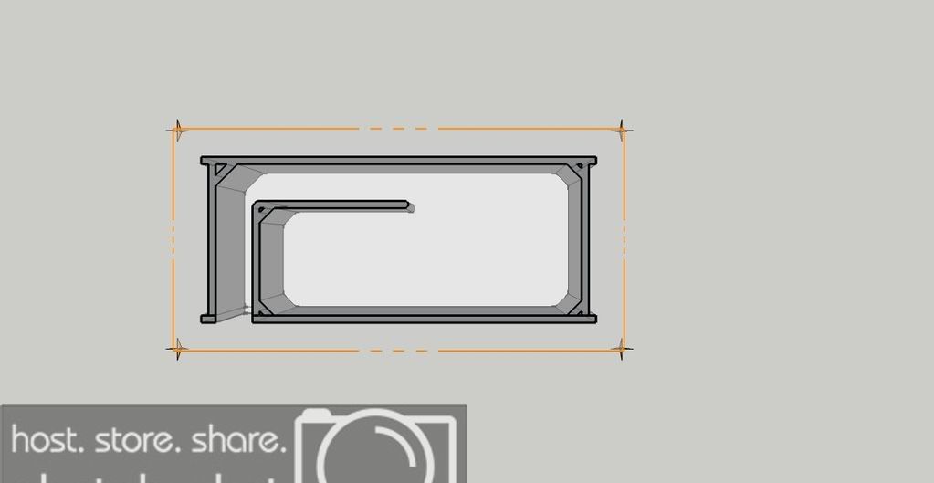

Ok everyone this box is for jshak07's single 15" Sundown Audio NightShade. Box is 3.16 cubic feet after all displacements. Box has 55 swuare inches of port tuned to 36Hz.
Here is the design..............

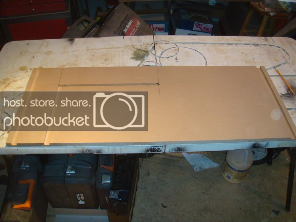

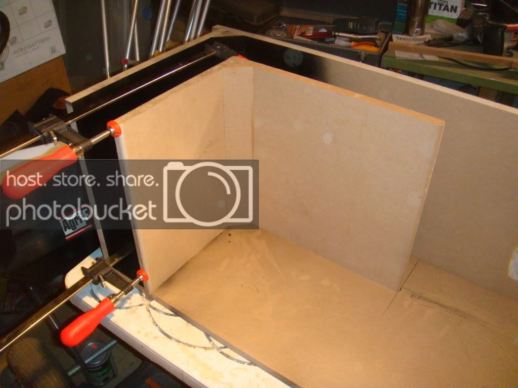

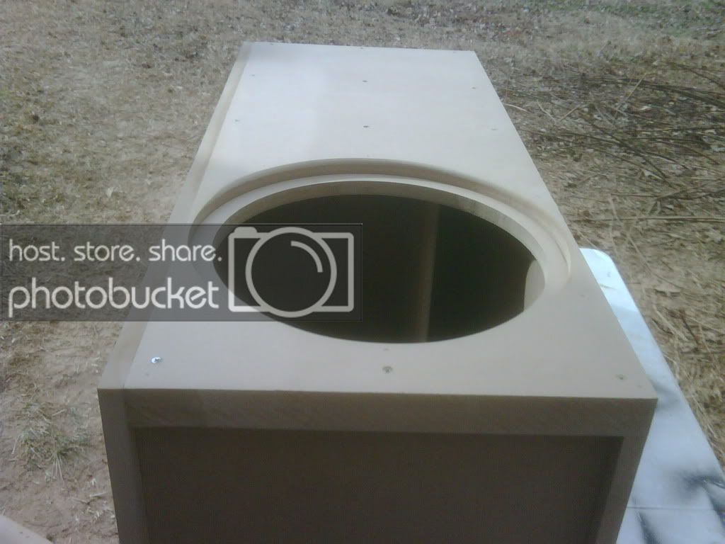

As you can see in this one I have to recut the front panel. The collet on my pattern bit shifted so it messed up the cut. I will be getting that taken care of tomorrow.
Nice Mike! Youve been building a TON of boxes lately lol! When you want your demo of my stuff //content.invisioncic.com/y282845/emoticons/biggrin.gif.d71a5d36fcbab170f2364c9f2e3946cb.gif
looks great man.. cant wait to get this and get it hooked up!

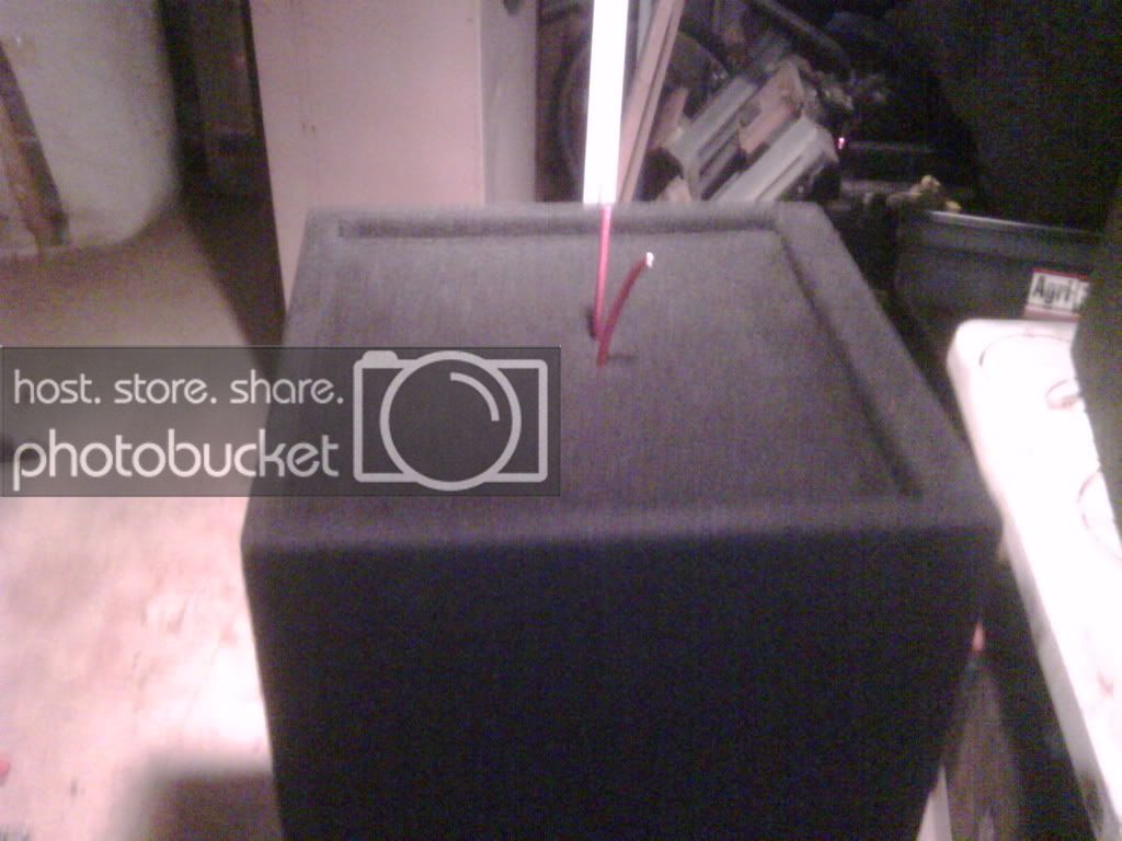

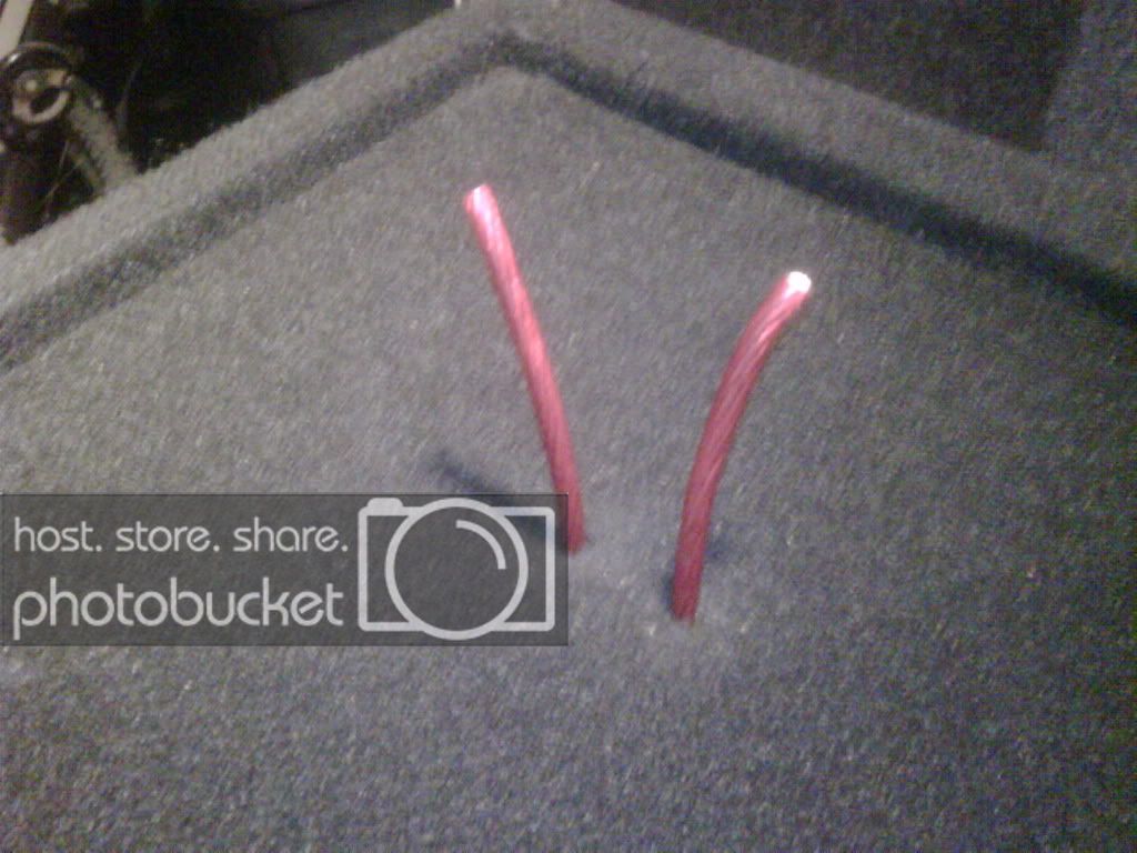

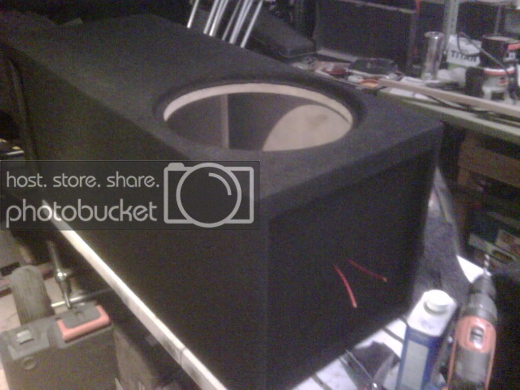

When you do get it, and you go to run your new 8 guage wire in the box push the wire I provided into the box and fish the new wire from the outside in. Post up some installed pics once you have it all in.

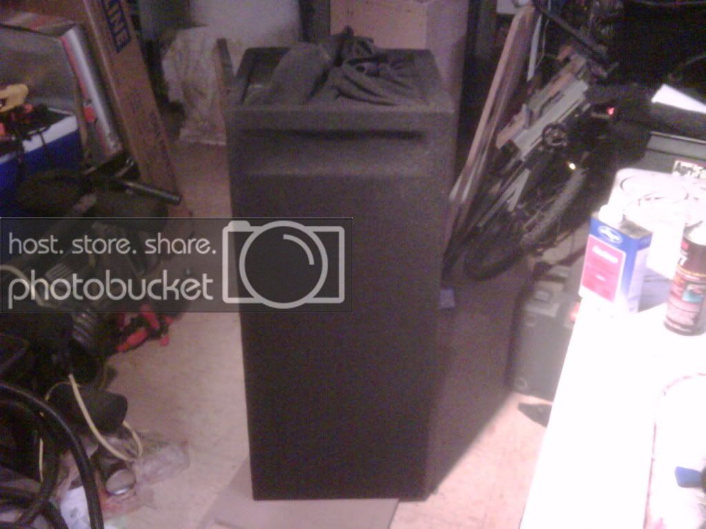

very nice man! im going to be posting a build log once i start on that enclosure i posted in your other thread!! also how come you did not wrap a piece of mdf and place it in the square cutout?? thats how i have always done it but you know what the way you did it saves a SHIT LOAD OF TIME! i might have to do this!
