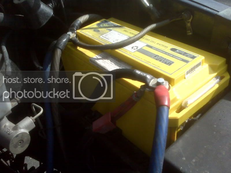

I have a stinger spv70 in the stock battery tray in mine, it fits like a glove, you just gotta trim the sides, ill try to get a pic tomorrow if u need it. good luck, im currently about 4 gran deep mine and still not done lol.

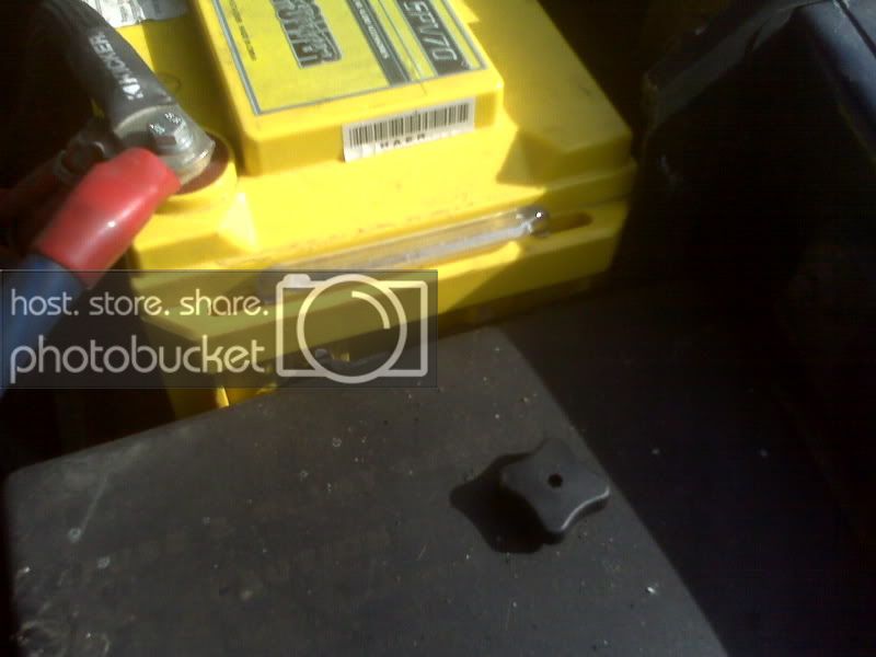

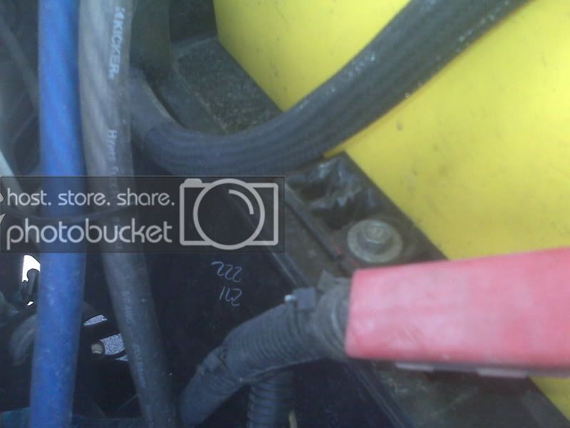

Also I took a few pics of the battery, if you look under your hood you can see i trimmed the angled plastic on the side of the battery tray and you can use the stock hold down, the SPV70's fit like a glove and theres a forum member selling a bunch dirt cheap. Camera phone pics, sorry.
