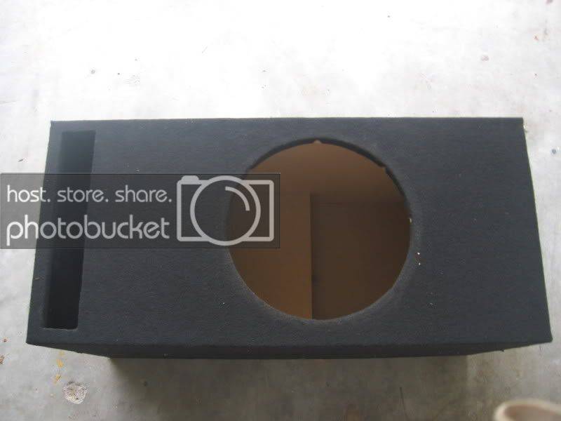

Box is for a 12" Fi Q. Specs are 2.2cf @ 32hz with 31.25inches of port area.
Anyways on to the build..

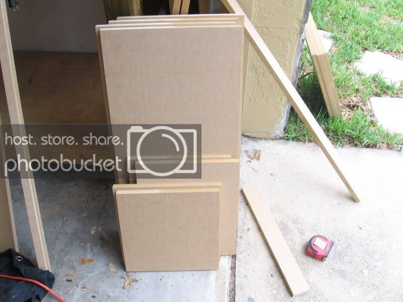

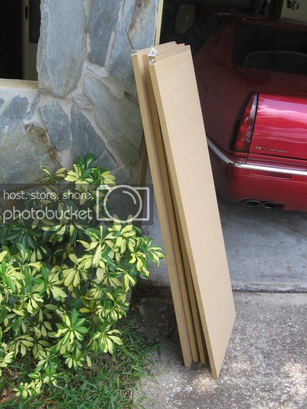

16x24 sheets of MDF FTW
Pieces all cut (those 16x24s make it a breeze)

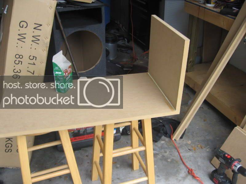

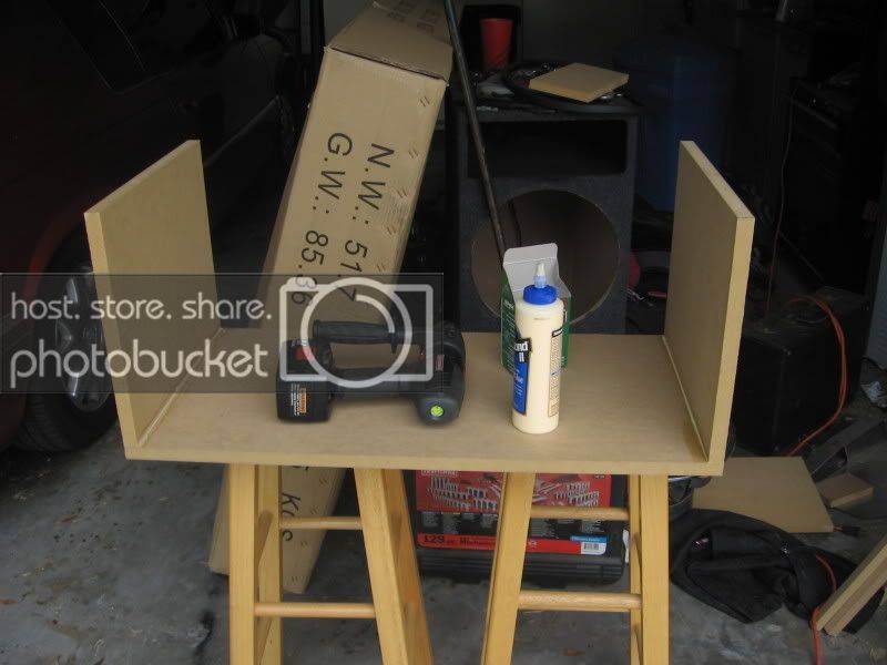

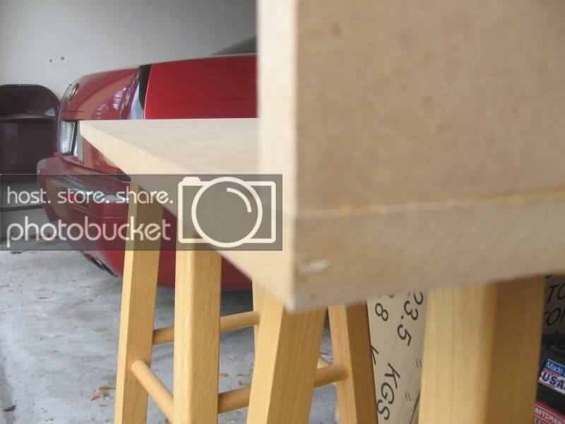

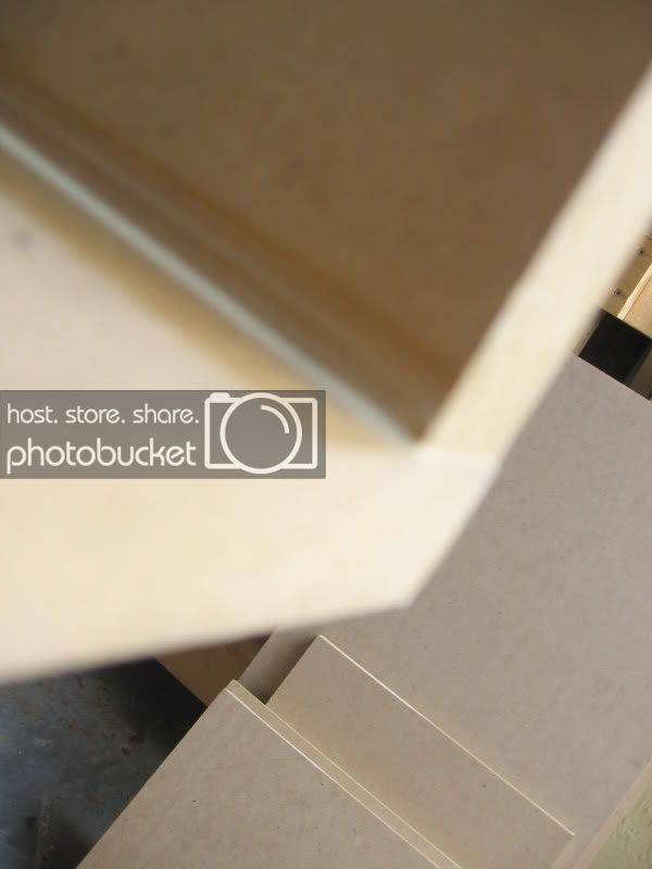

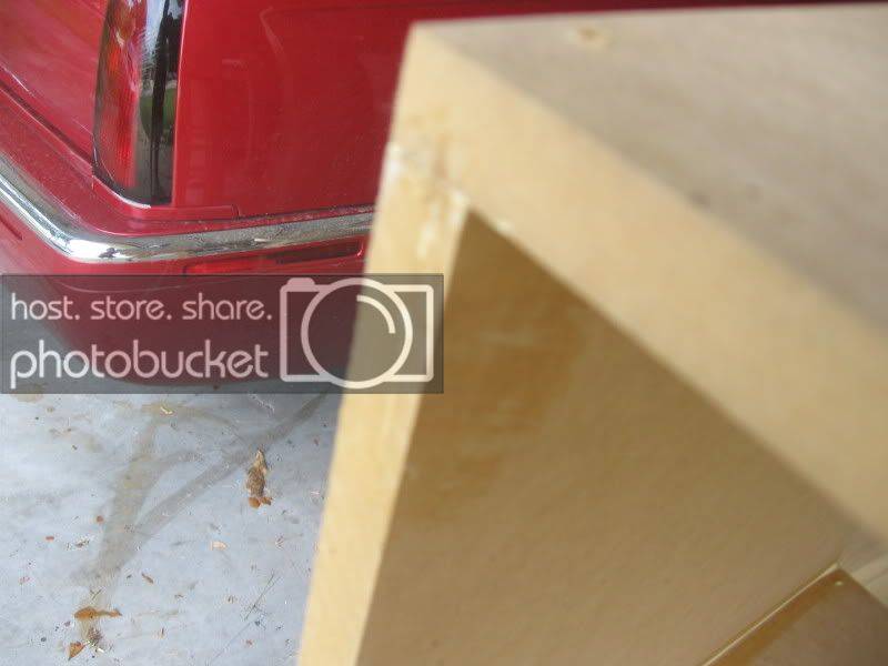

I remember there was a thread on here about corners, heres how they should look ; )
Sides uppp

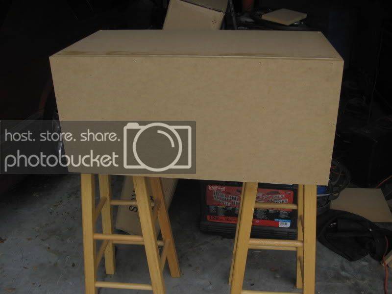

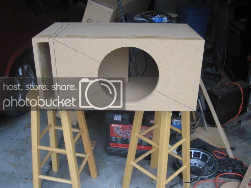

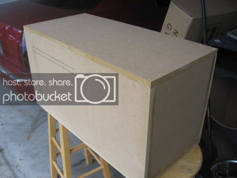

I forgot to take a picture of the top on, o well. Front now on..

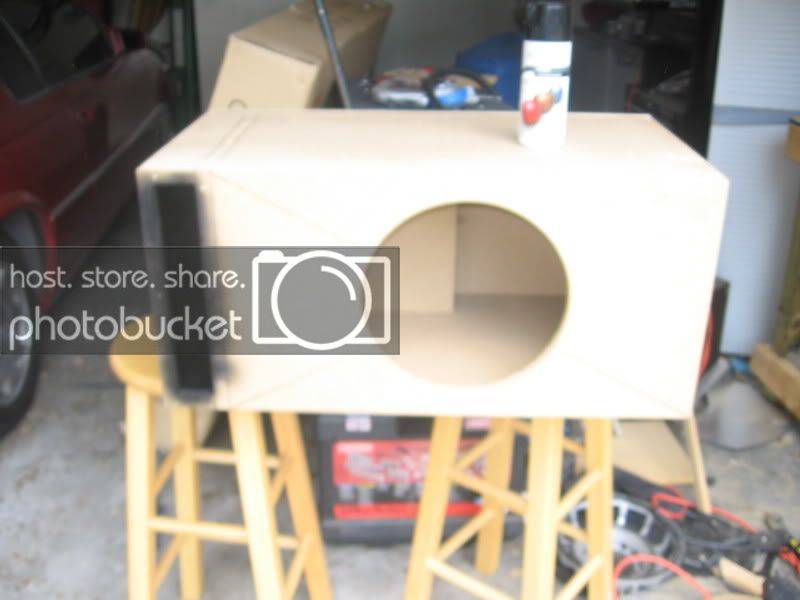

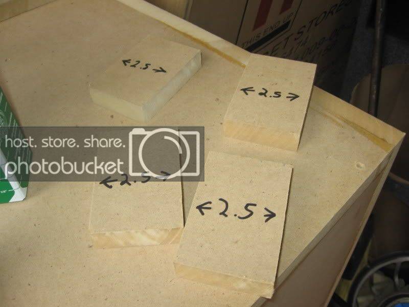

My handy dandy port spacers .... cut these and a nasty storm was about to come in so I stopped here for today.

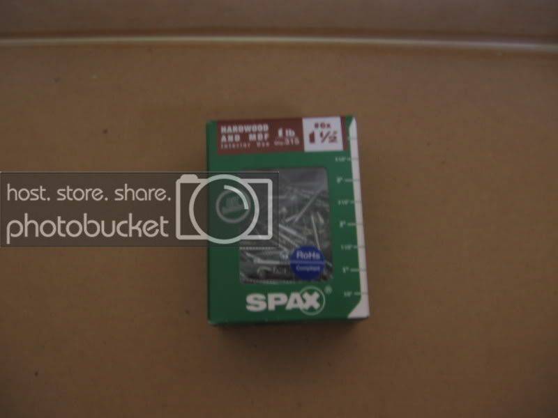

PS: Last build everyone wanted to know what screws I use, well here is a picture, I highly reccomend these screws over anything. They pre-drill them selves so no splitting, they countersink by them selves and are designed soley for MDF.
