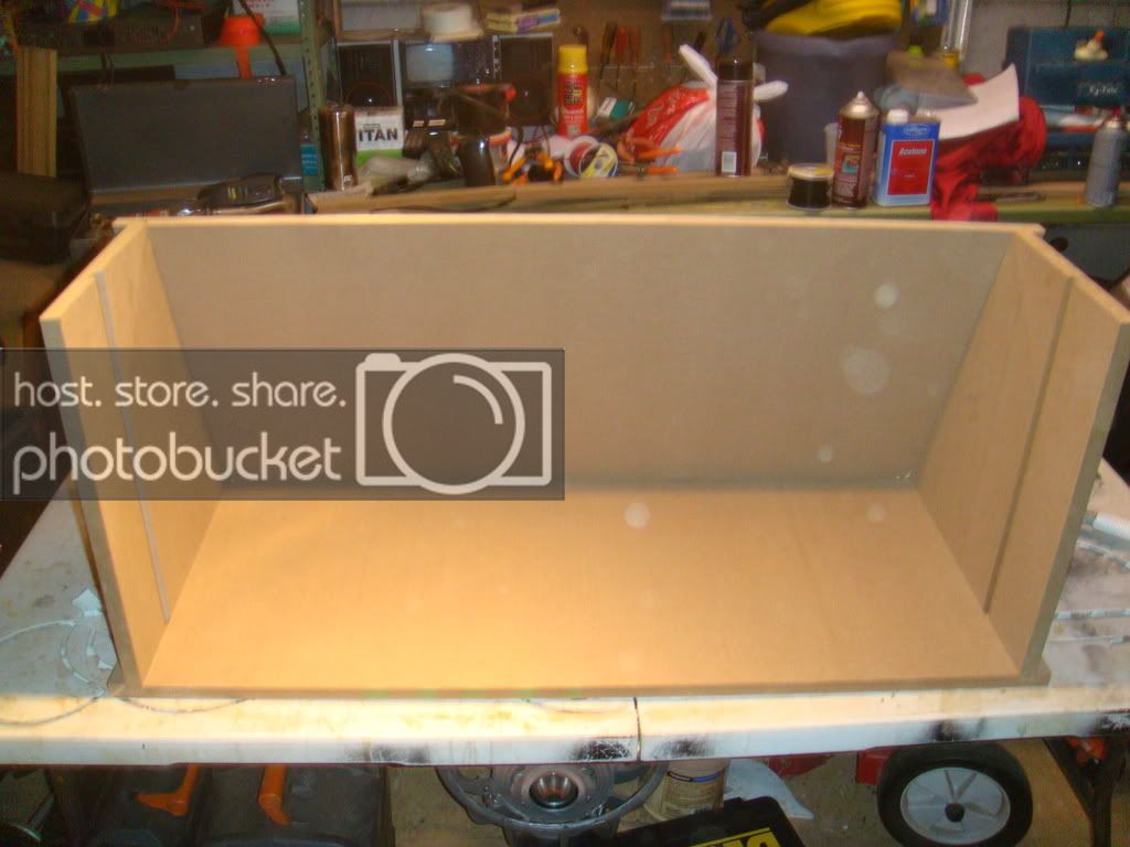

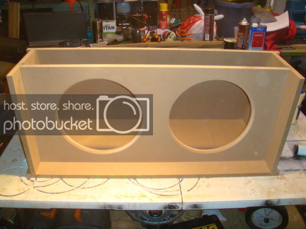

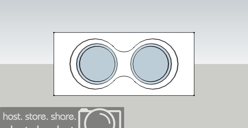

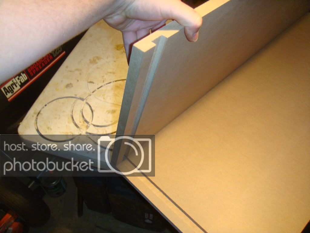

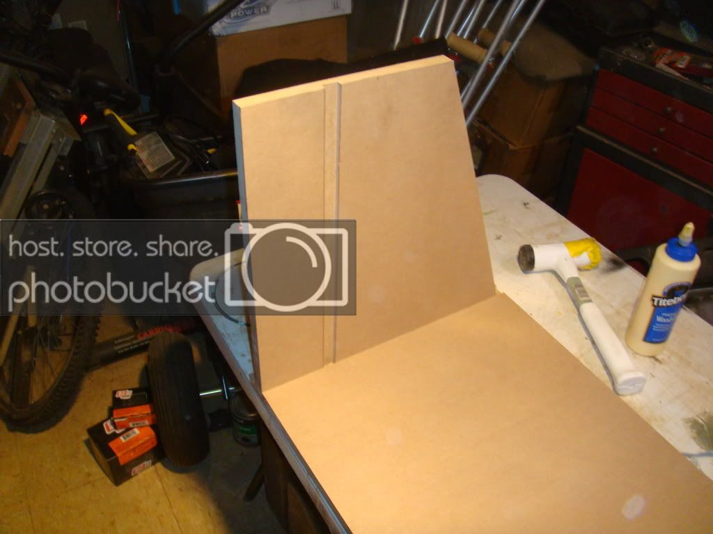

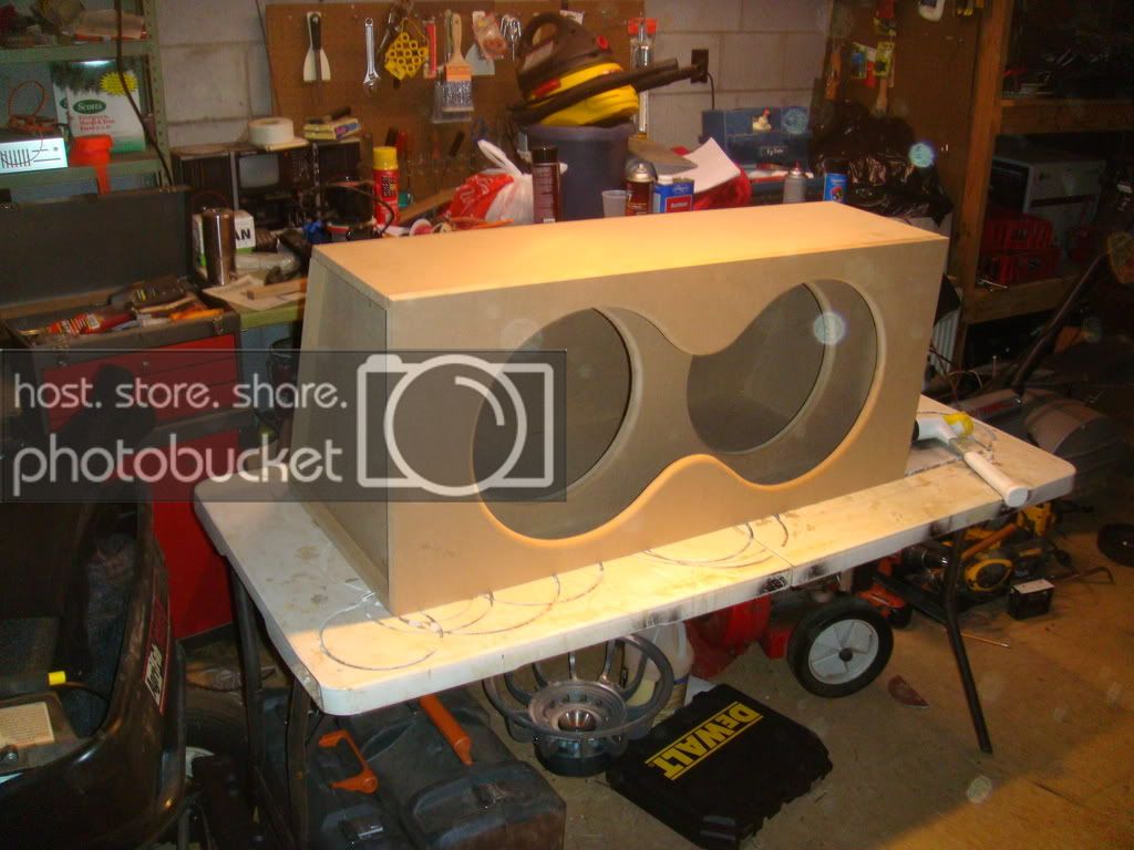

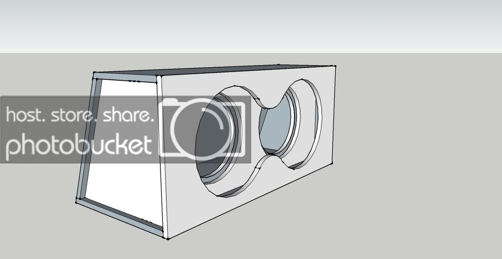

OK evreyone this build will be for joshualittle's 2-12" ID MAX subs. The box will be 2.6 cubic feet sealed after all displacements. I am going to be doing a two tone suede on the box. I will be using Pacific Blue and Blueberry suede.
Here is the design...................

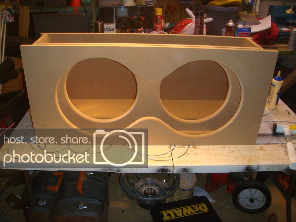

Subs will be set 3" in the box and have a vanity panel......

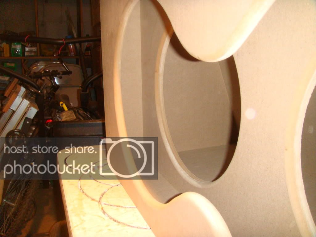

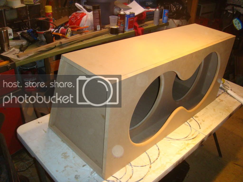

Will having that beauty panel in the front away from the subs cause any weird issues? Like cancellation?
I think he said it's 4'' in front?
Either way, nice job on it!

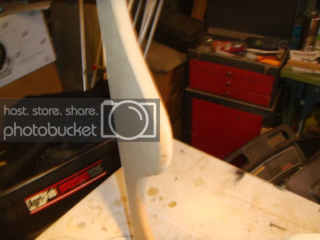

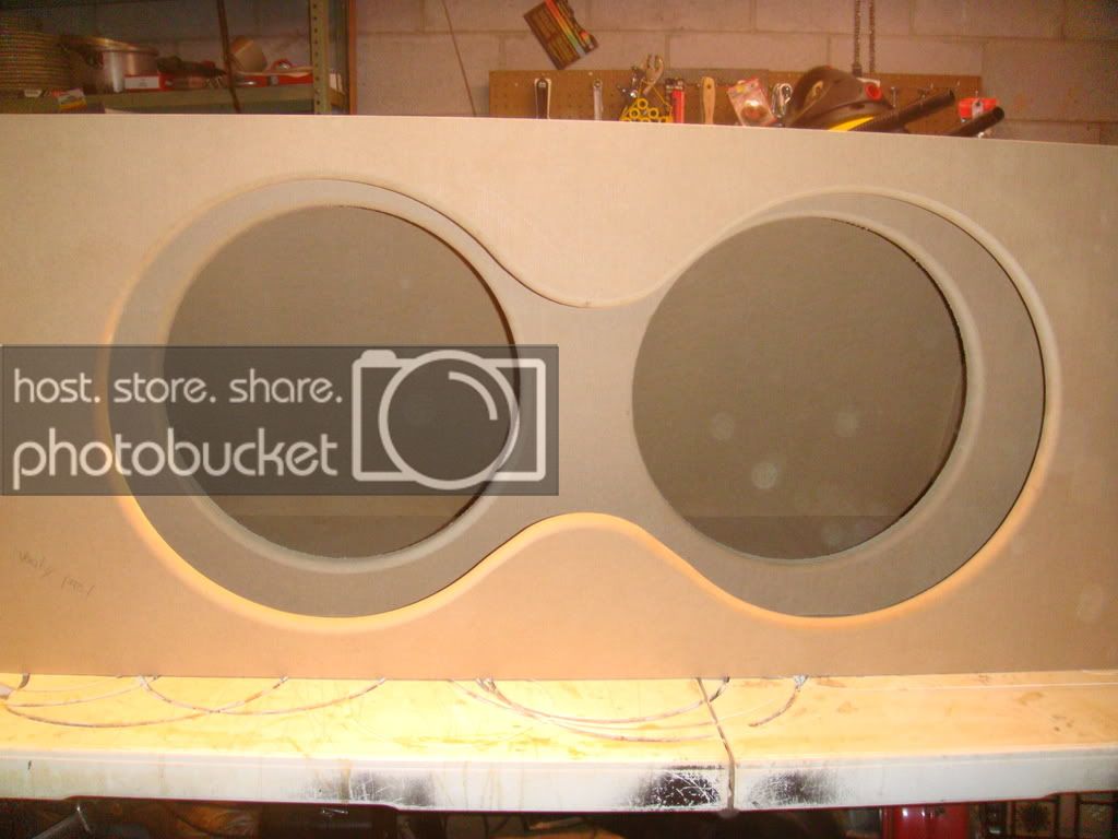

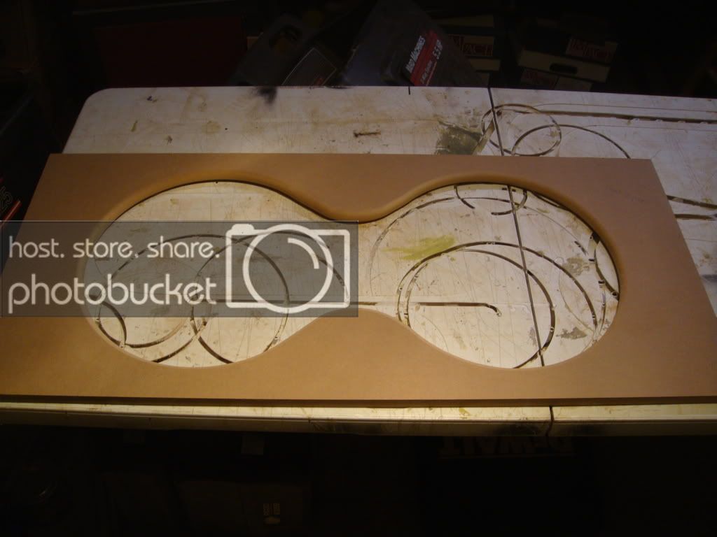

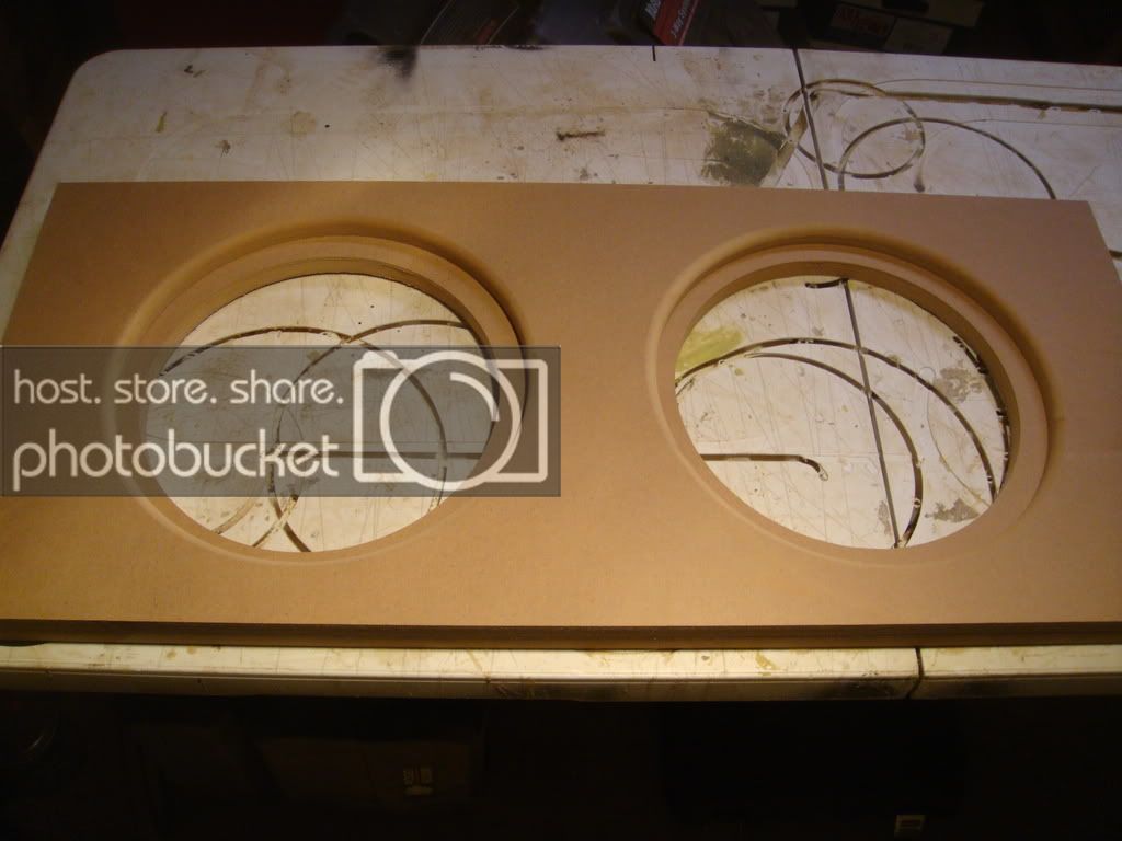

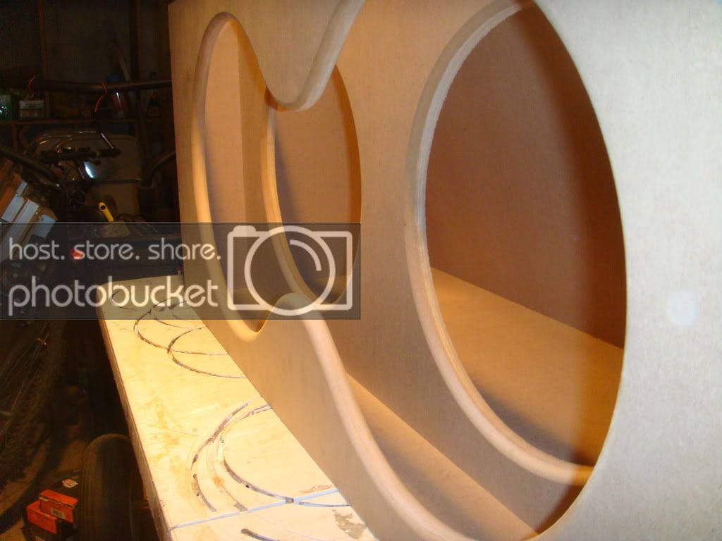

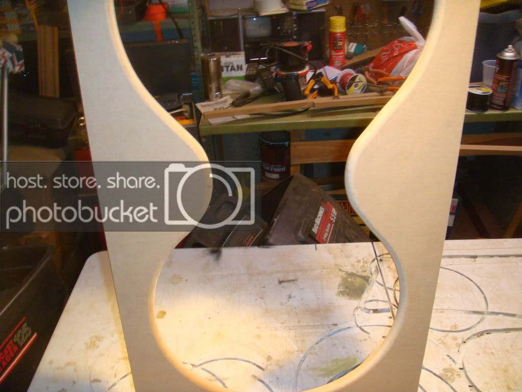

What did you cut the outside crazy curve piece with? a jigsaw?

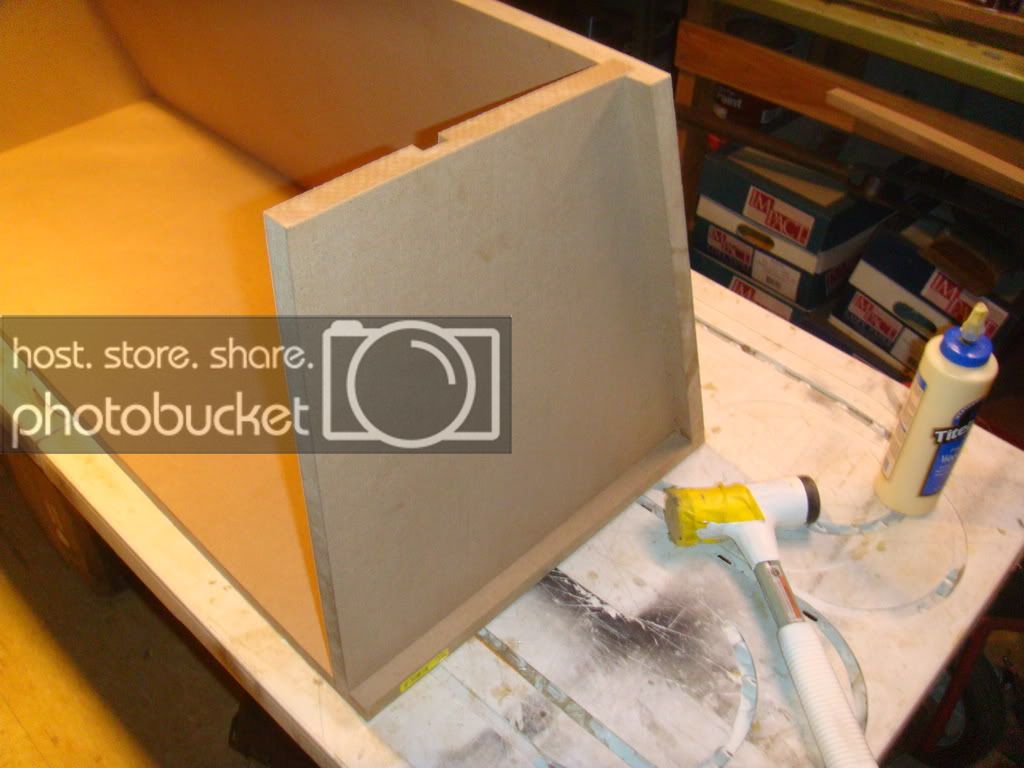

Nope I used my router and my circle jig. Then I took a roond over bit to it. I didn't put the inner baffle in because it is a tight fit and I didn't want to have to take it out and put it back in.
