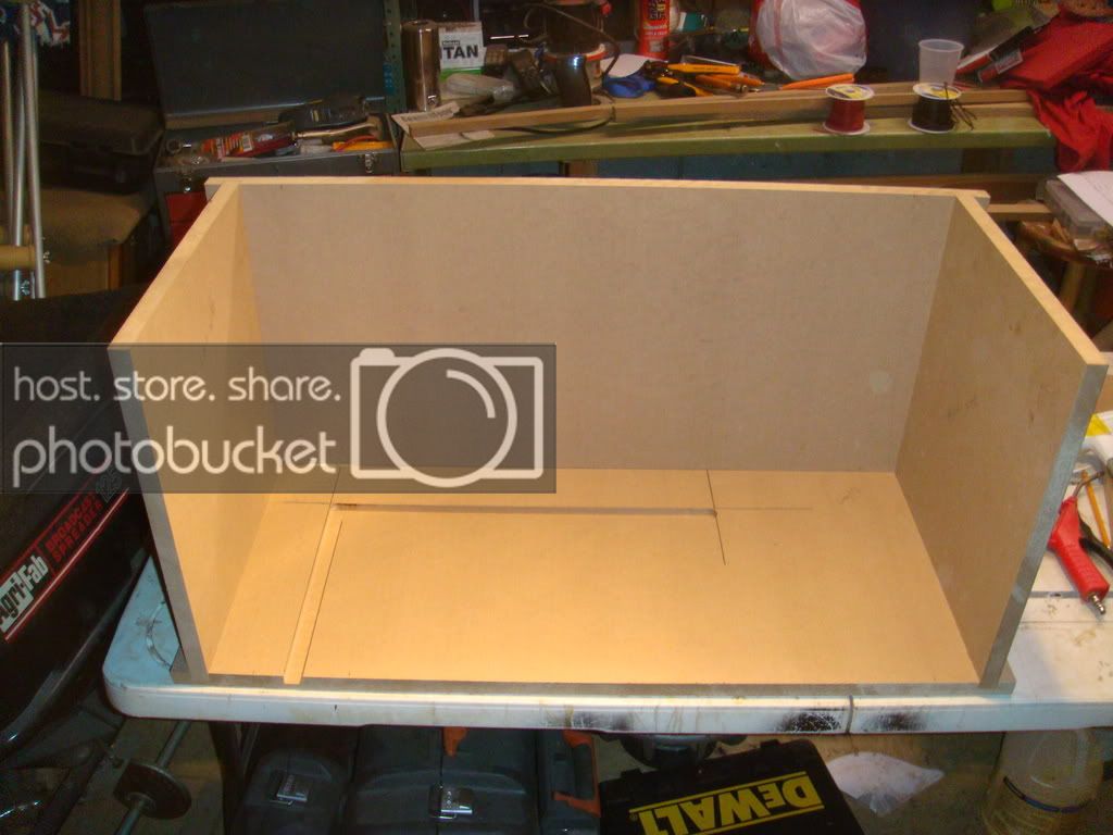

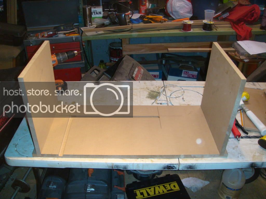

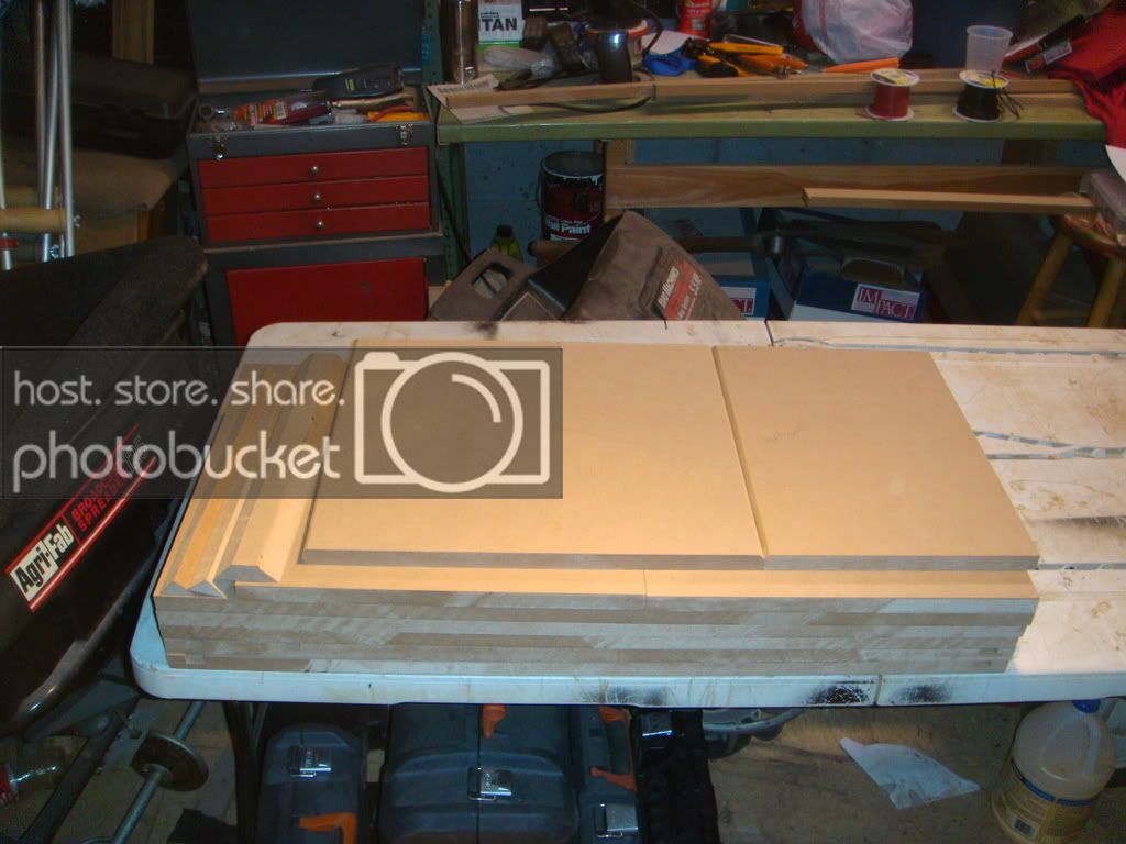

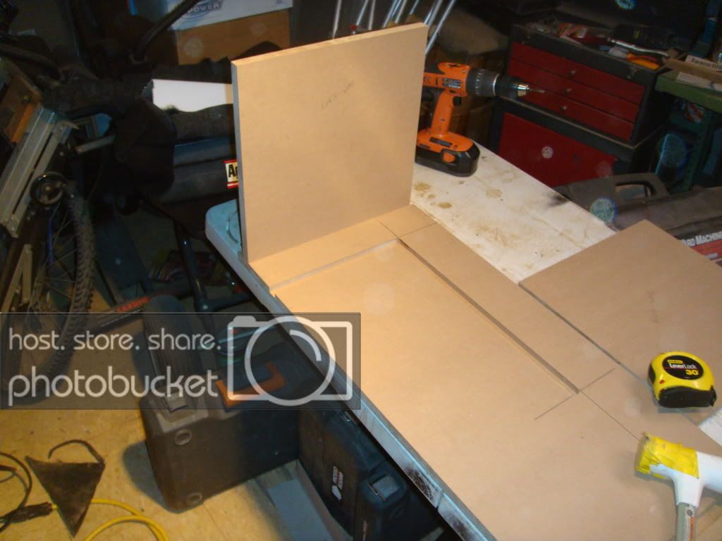

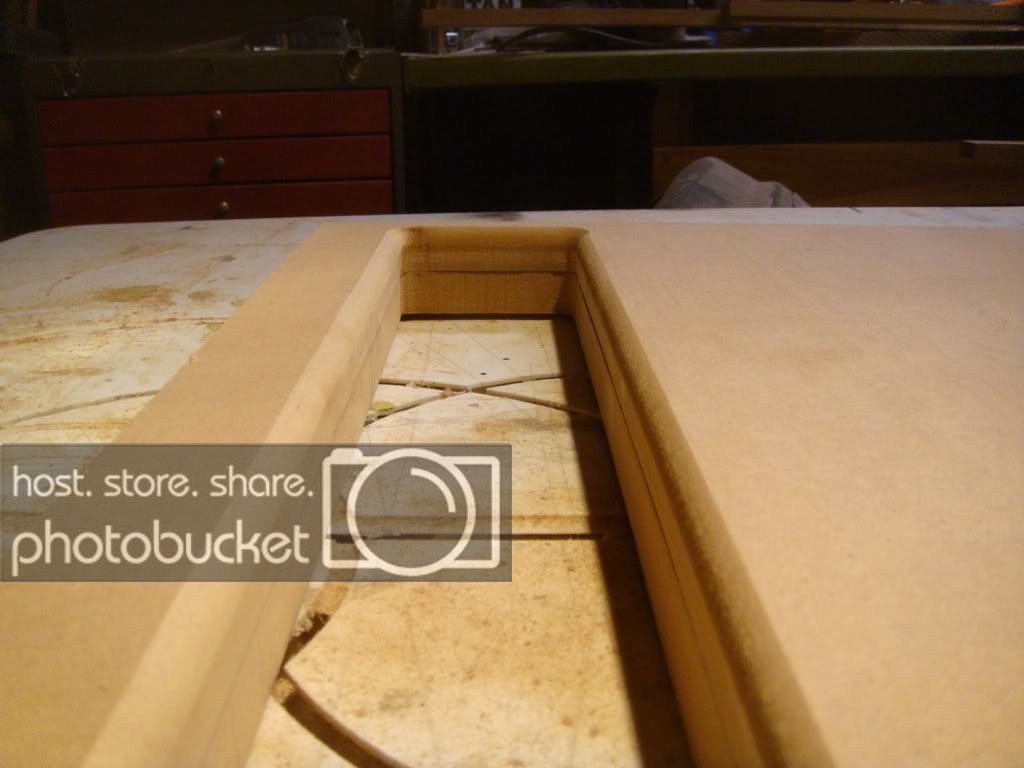

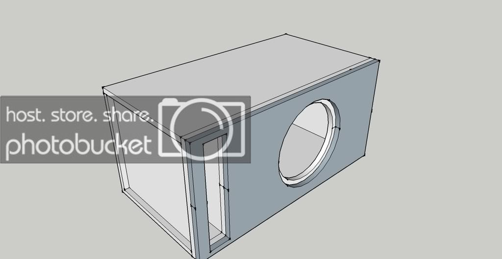

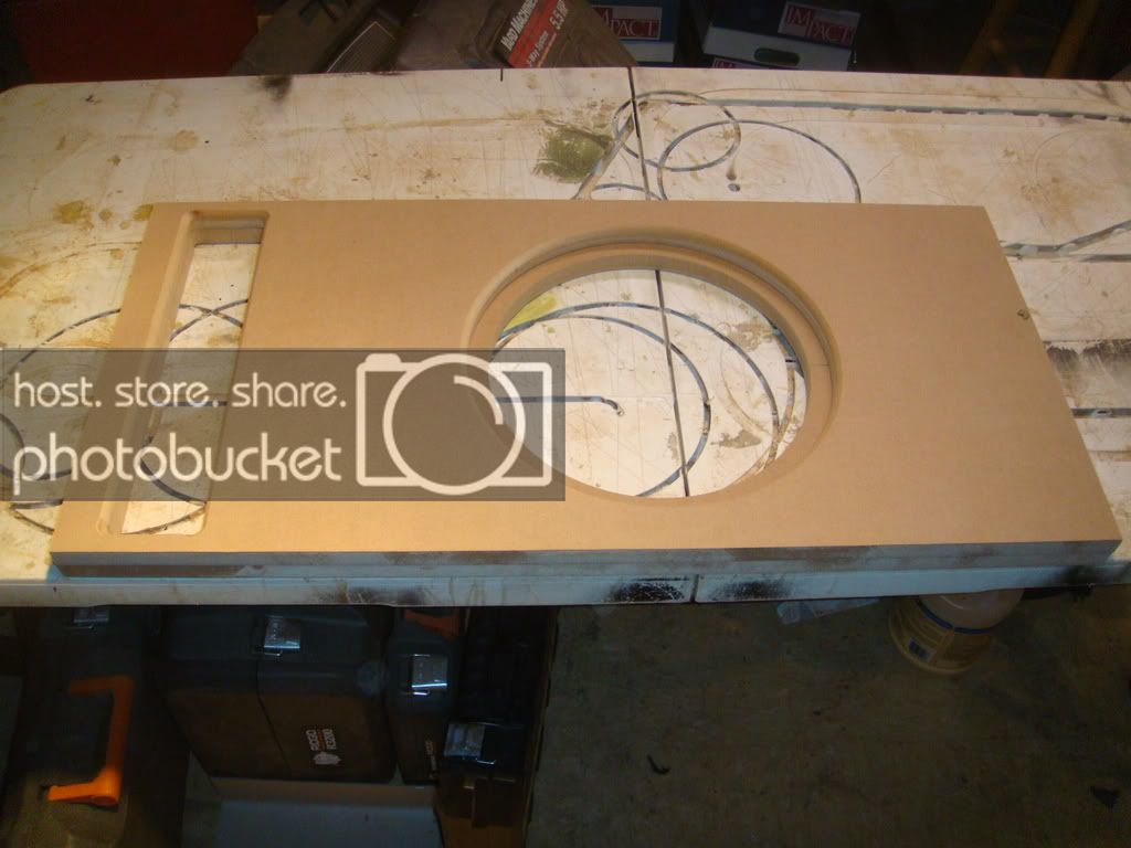

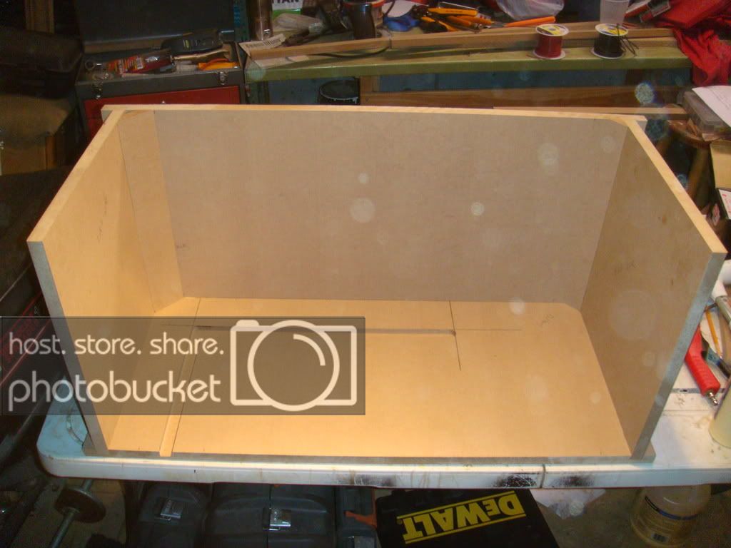

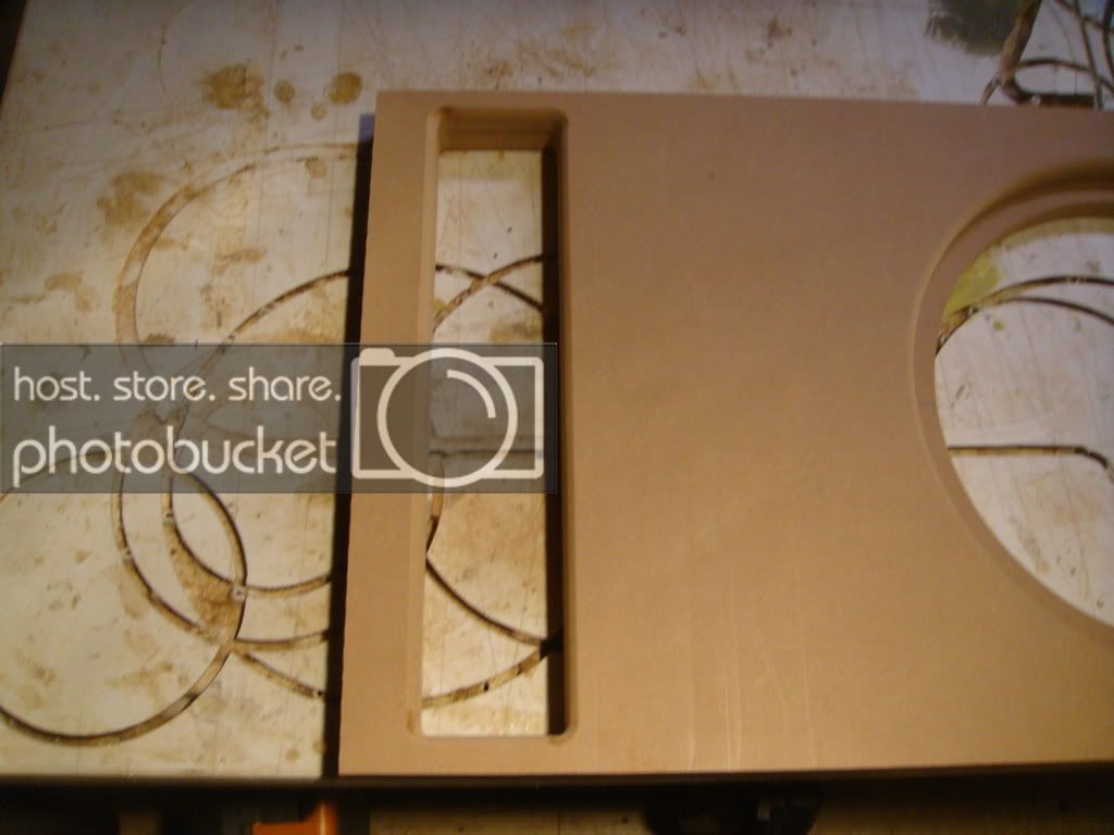

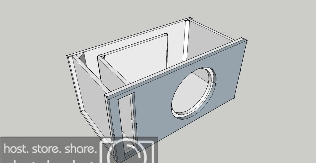

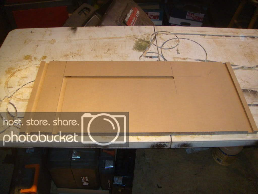

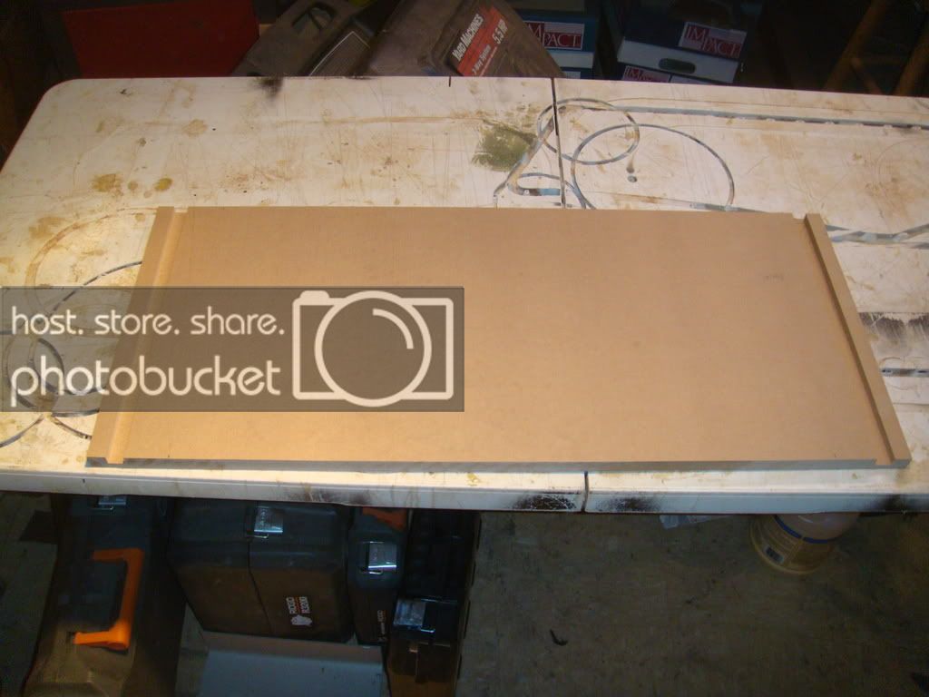

Ok everyone this will be forDJSEVEN's single 12" Fi BTL. This will be going into a 2000 Hyundai Elantra. Box will be 2.75 cubic feet after all diplacement. Box will have 44 square inches of port tune to 33Hz.
Here is the design................................
Nice Job! Thats similar to what I like but the sub far right. //content.invisioncic.com/y282845/emoticons/wink.gif.608e3ea05f1a9f98611af0861652f8fb.gif
