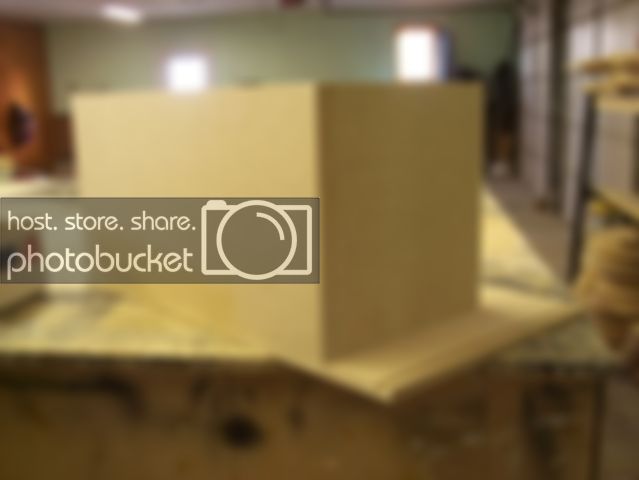

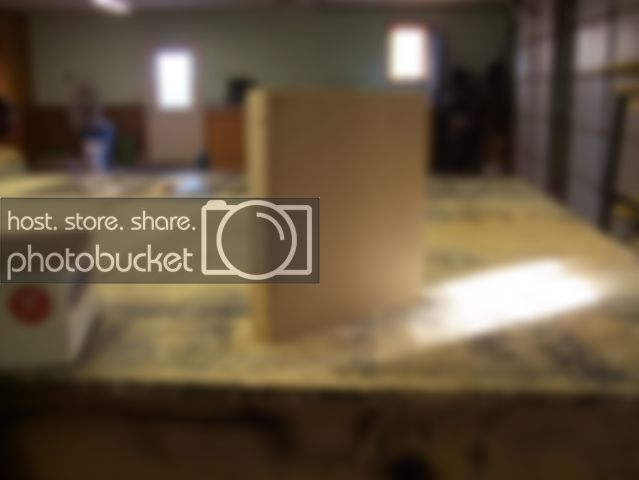

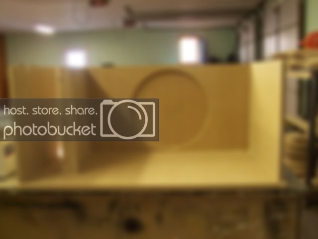

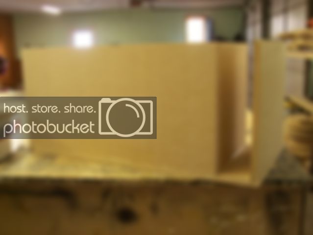

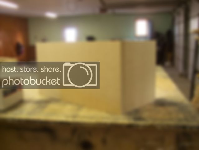

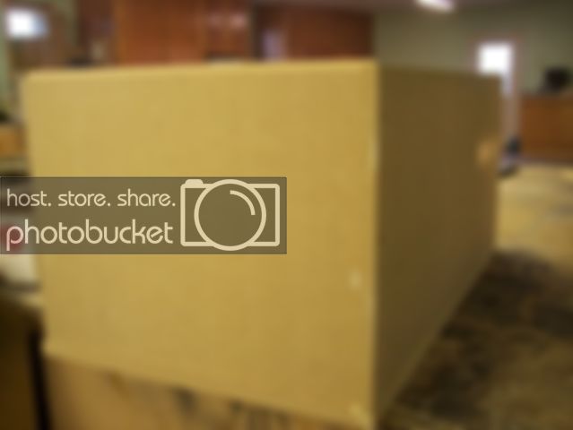

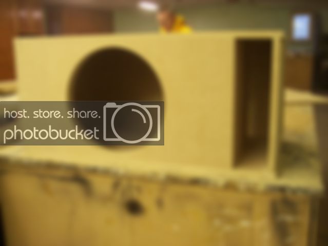

4.5 cubes @ 40 hz for a DD9515. Double baffle, and will be left bare...
Should finish it up tomorrow, didnt get time tonight...
is that you in the yellow
LOL does that dude look 22?
your stuff always looks good man. Have you ever shipped an 8 cubic ft box?
Thanks, 8 cubes... dont recall exactly... As long as we can get it under 150 lbs we are cool, otherwise we have to look into freight...

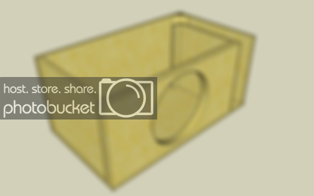

whats the outer dimensions of that box? if you dont mind me asking, if you cant tell me that, can you at least tell me how tall it is?
Its 17" tall. I hate to give out much more info then that, because Chris paid fmy designer for it. If you need to get a design made, you can contact my designer, Dylan@fishercustoms.com.

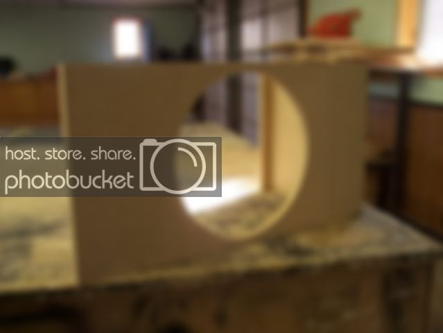

Why not have the double baffle wall tie into the sidewall instead of the double baffle overlapping the side wall? The same could go for the port wall. There would be surface area for the bond this way.
You could gain a little bit more surface area that way. But there is actually a couple reasons I do it this way, some being related to the business aspect.
One is, structurally, will it make a differece? Most likely not.
So if your gains are minimal, with a little more time involved.... thats where the business part will step in...
But I do see your point //content.invisioncic.com/y282845/emoticons/smile.gif.1ebc41e1811405b213edfc4622c41e27.gif
Being a spl guy I like every little bit of strength that I could get:) I would hate for a strong sub to blow a wall out.
Im not to worried about getting a wall blown off. If it hasnt happened in the first 150ish boxes... I dont really see it happening //content.invisioncic.com/y282845/emoticons/wink.gif.608e3ea05f1a9f98611af0861652f8fb.gif
But I see what your saying, a little extra strength never hurts, but in this instance, I dont think its necessary.
