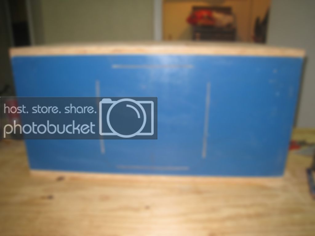

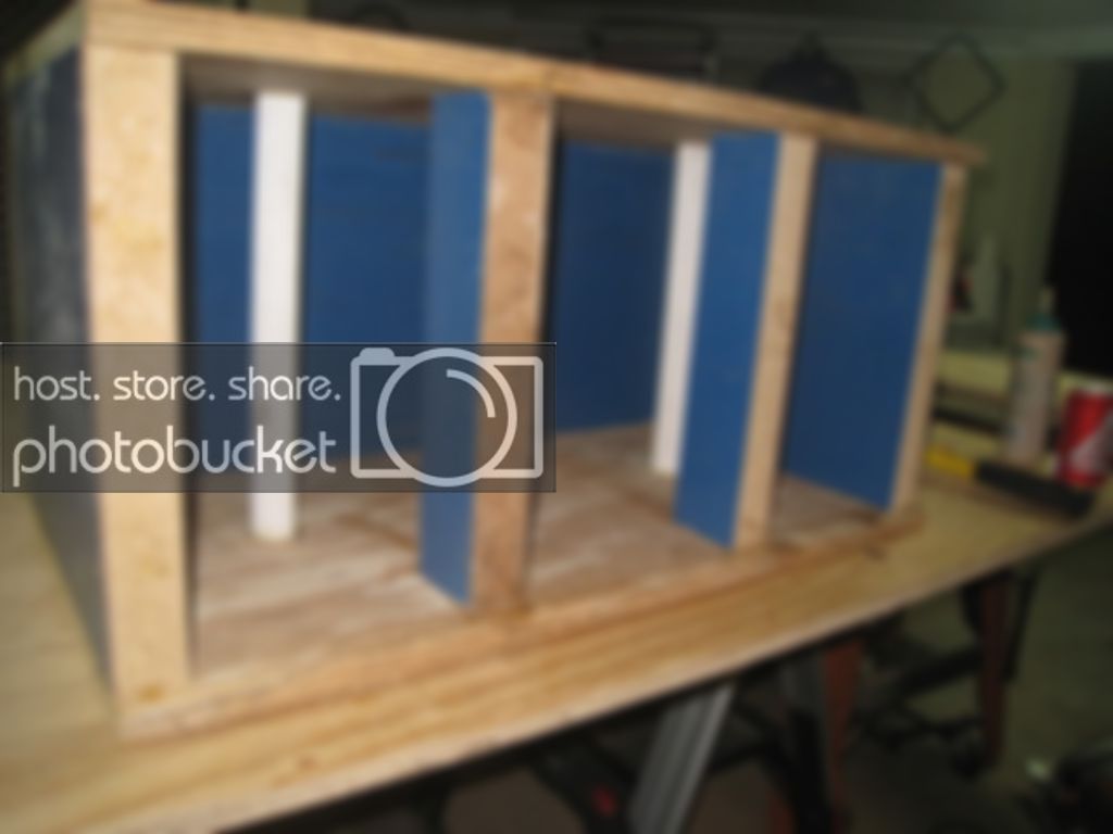

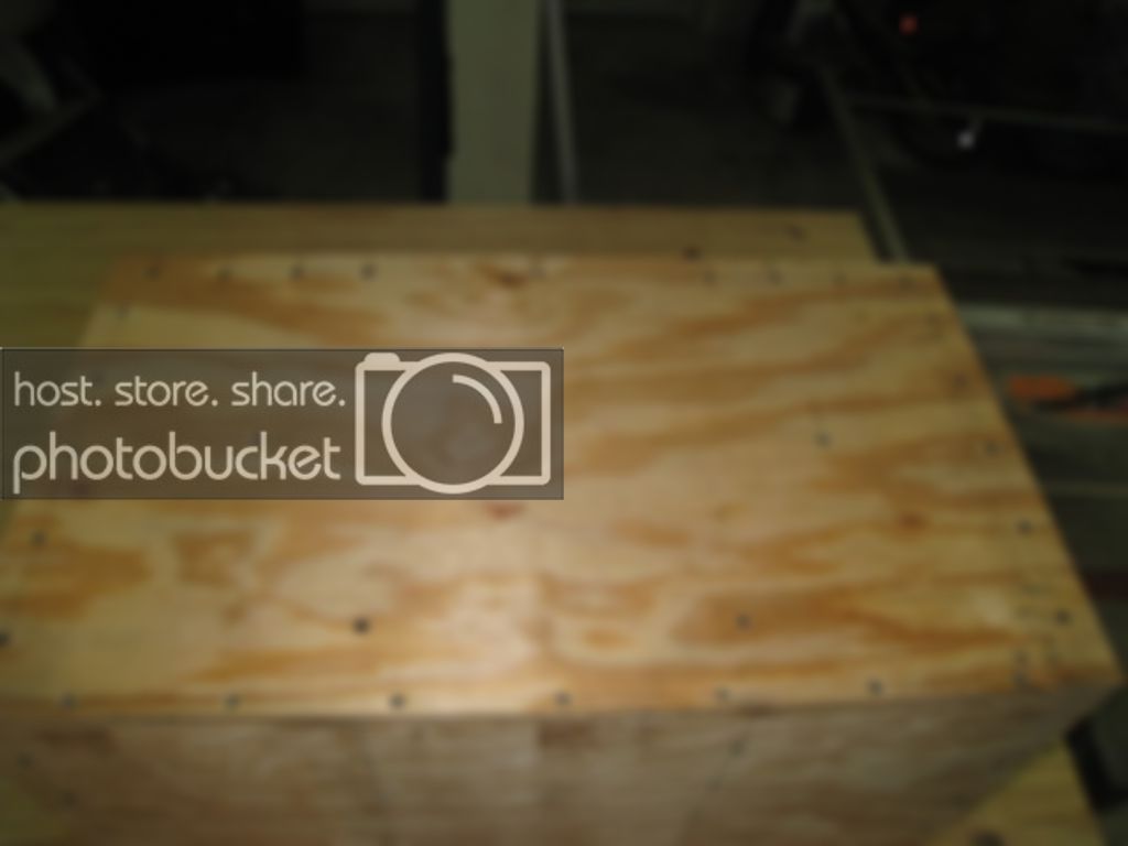

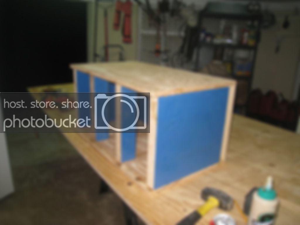

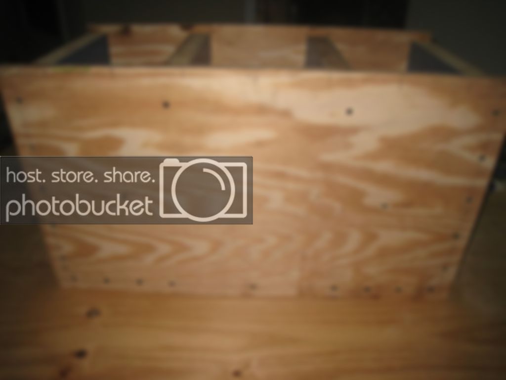

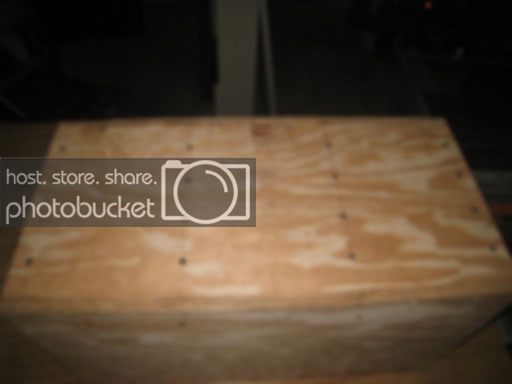

box build for a 12" solo X
kmanian
It is for a trunk, it will be sub back 2-4" aeros up through the deck.
Working on an Island sucks sometimes, there was no mdf or birch available. So in with the 3/4" a/c plywood. it was actually heavier than mdf, a real bastard to move around by myself. It's cool though, I am going to resin the box tomorrow so the ply monster will go away.
I am working towards 3 ft tuned to 38hz
more pics will follow tomorrow.
