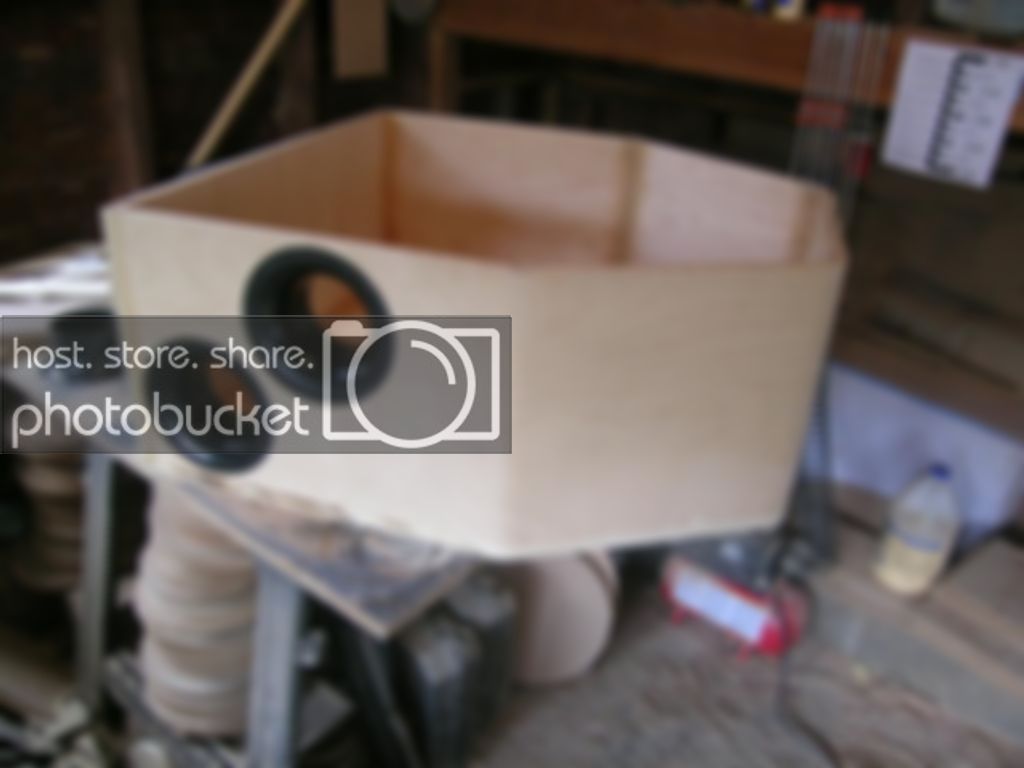

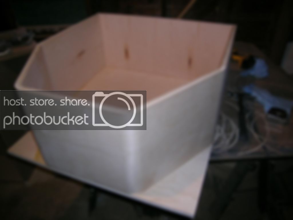

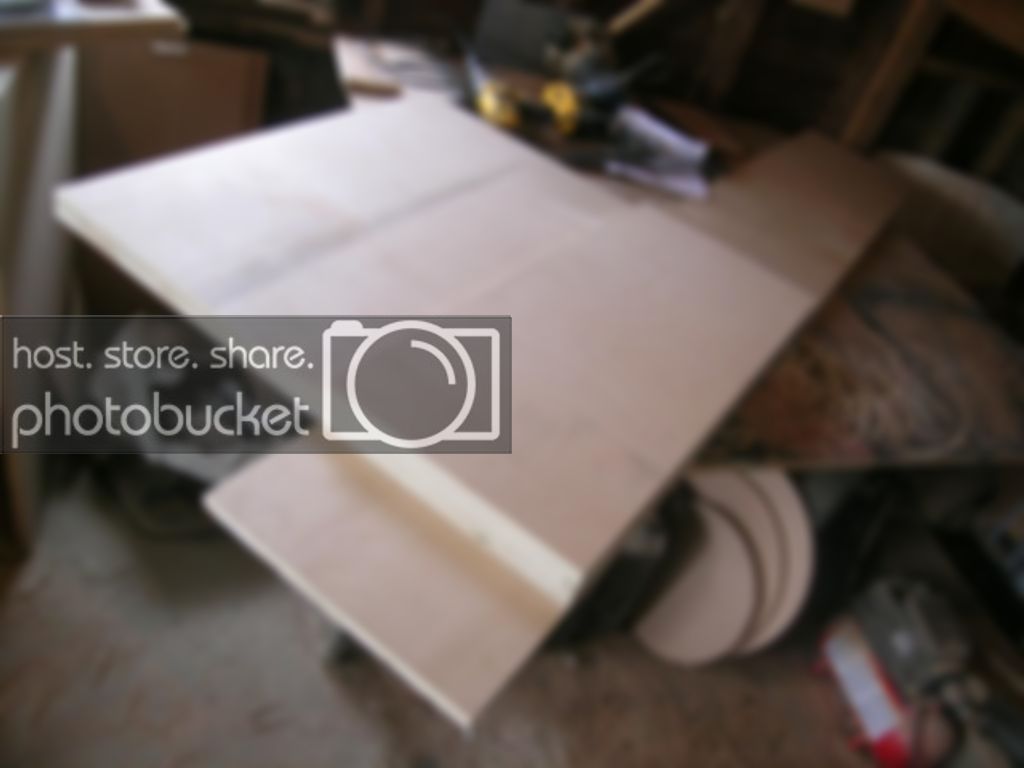

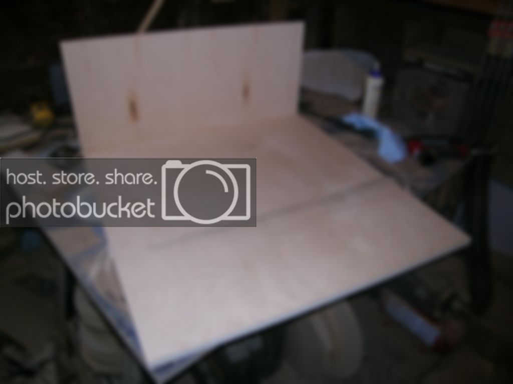

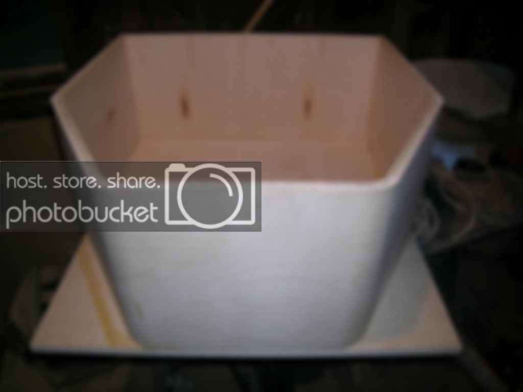

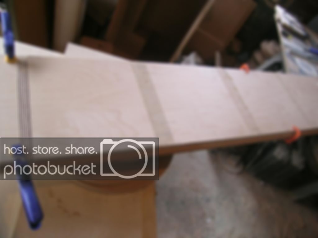

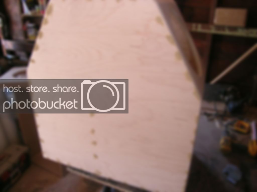

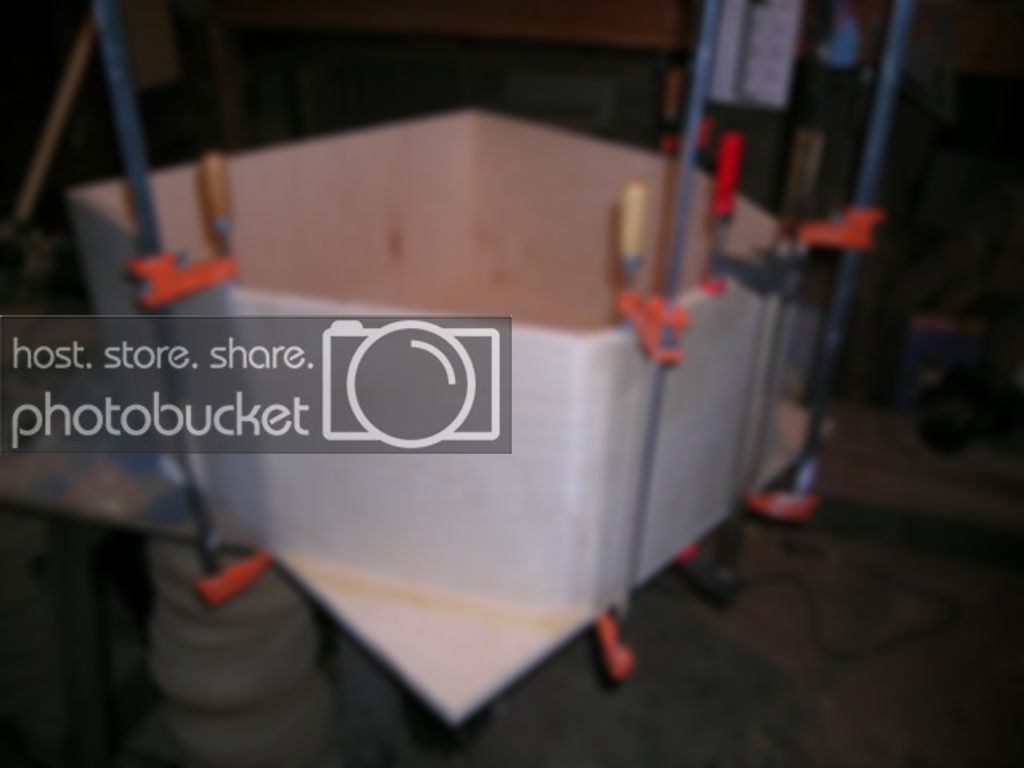

OP SPY 5,000+ posts CarAudio.com Veteran 5,239 4 NY Jun 11, 2009 Thread Starter #2 Update, Applied resin and mat to the kerfs and resin to all the seams flush trimmed the bottom pannel Holes cut and flush mounted for the ports and a test fit Holes cut for the subs

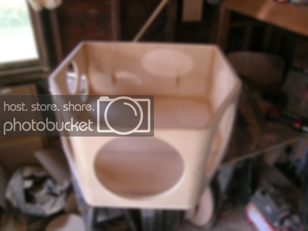

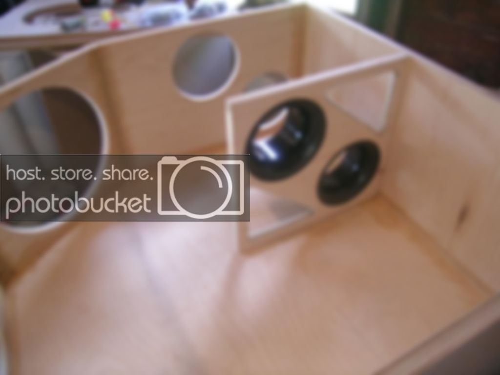

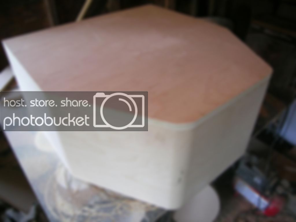

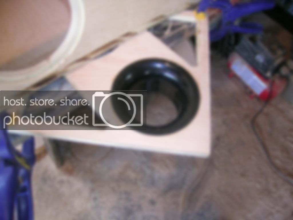

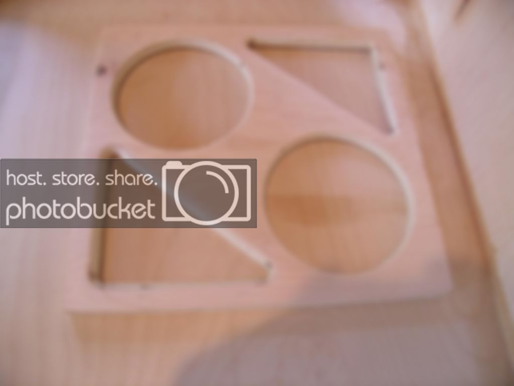

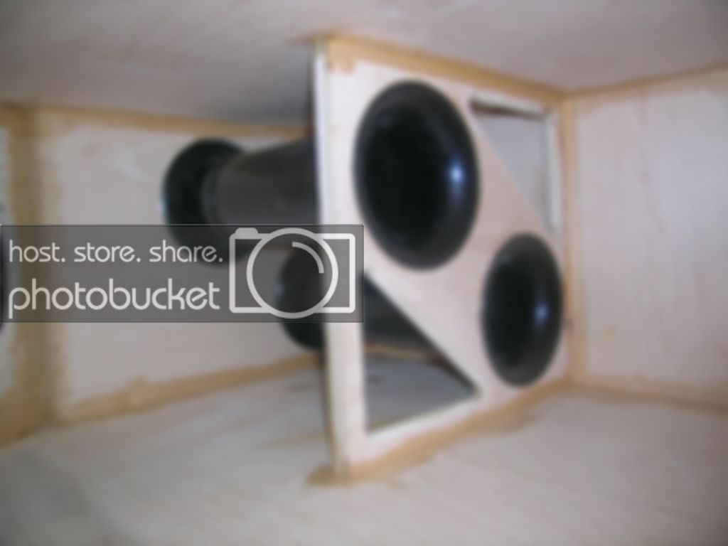

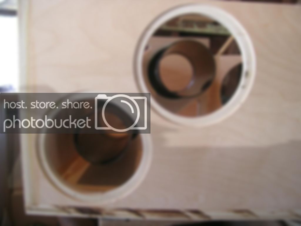

OP SPY 5,000+ posts CarAudio.com Veteran 5,239 4 NY Jun 11, 2009 Thread Starter #3 I decided to place a brace at the internal end of the port. then internal flairs were attached to the brace the I installed the brace and installed the port tubes installing the top flush trimmed the top rounded over the top and bottom another shot of the internal brace and ports filled all the fastener holes with wood filler sanded the entire box smooth D

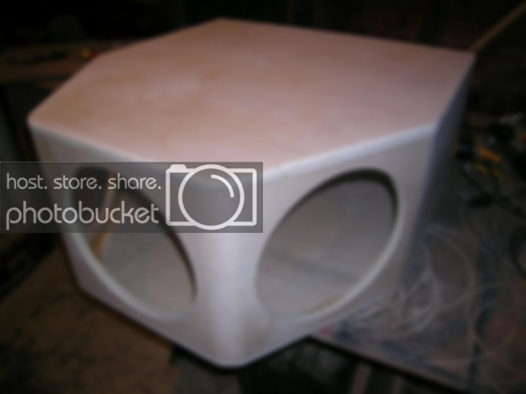

OP SPY 5,000+ posts CarAudio.com Veteran 5,239 4 NY Jun 11, 2009 Thread Starter #4 installed the outer port flairs flush mounted applied fiberglass resin to all inside joints and now it's ready to ship //content.invisioncic.com/y282845/emoticons/biggrin.gif.d71a5d36fcbab170f2364c9f2e3946cb.gif

da box king 10+ year member CarAudio.com Veteran 4,793 0 Portland, MI Jun 11, 2009 #8 amazing....one my favs as of lately hope the motors dont touch?
DonH 5,000+ posts ..... 6,288 44 So Cal Jun 11, 2009 #9 looks good! besides that burnt *** cut! lol... but why only 2 aeros?

9 93dakota 10+ year member CarAudio.com Elite 662 0 Ohio U Jun 11, 2009 #13 lookin good I like the Brace....And like D...Man said y only 2 aeros?
subzero 5,000+ posts CarAudio.com Veteran 6,940 135 Chandler, AZ Jun 11, 2009 #14 amazing....one my favs as of lately hope the motors dont touch? Click to expand... X2
